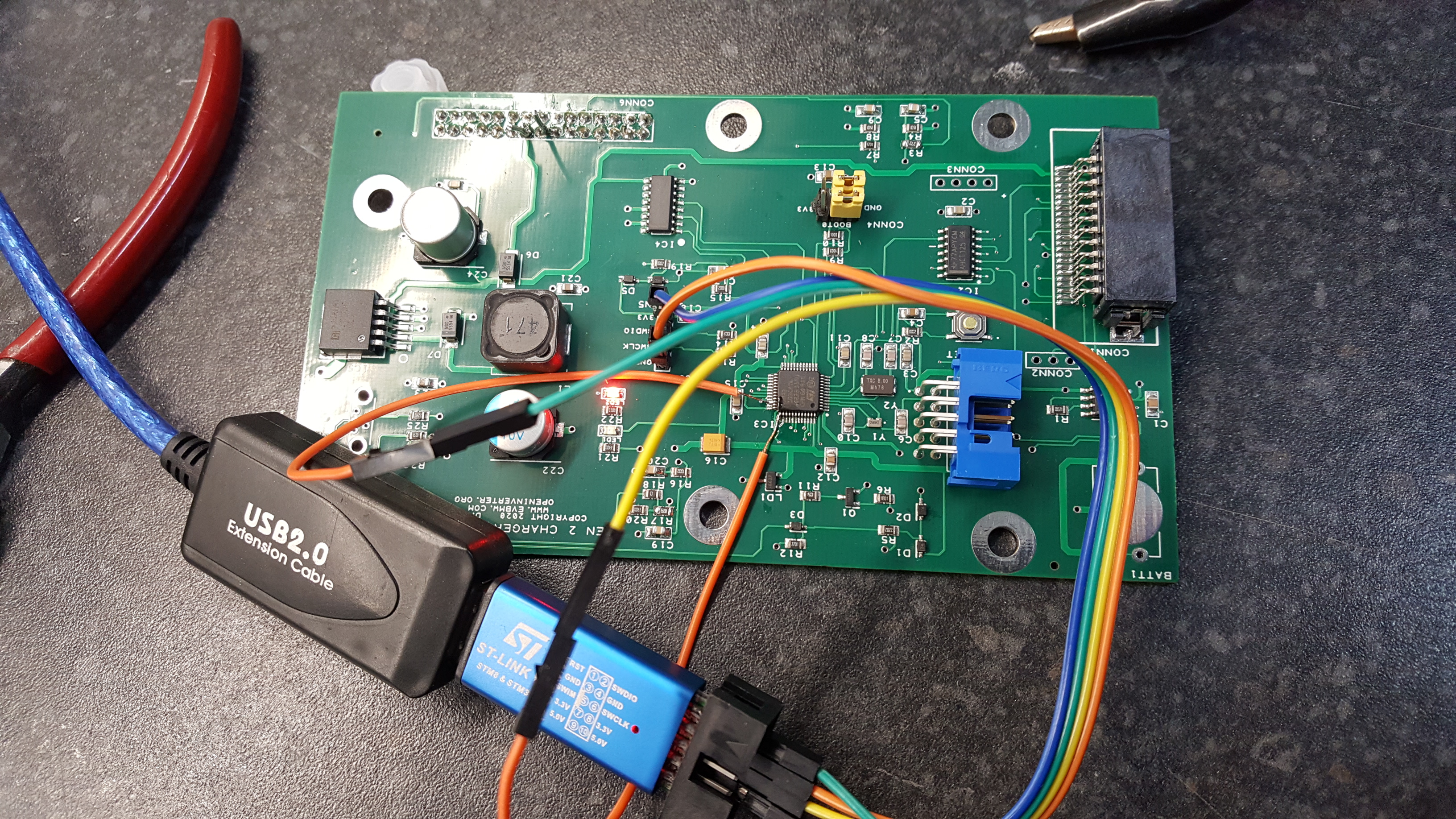

Kinda bad news on the charger board. I done screwed up. Connected the SWD port to the wrong pins on the micro! Fortunately, a misspent youth of chipping playstations allowed me to connect to the right pins and upload the inverter bootloader and test program. CAN and IO are working but will need to re layout the board to correct this and some other errors. Not disappointed as this was my first go at using the STM32F103C8T6 and also first JLC board. I'll be putting up a new thread soon for software developement on the new board which will be a nice comedy show as I get to grips with C++ and STM32
Only took me a week to get an led blinking and CAN transmission working.
