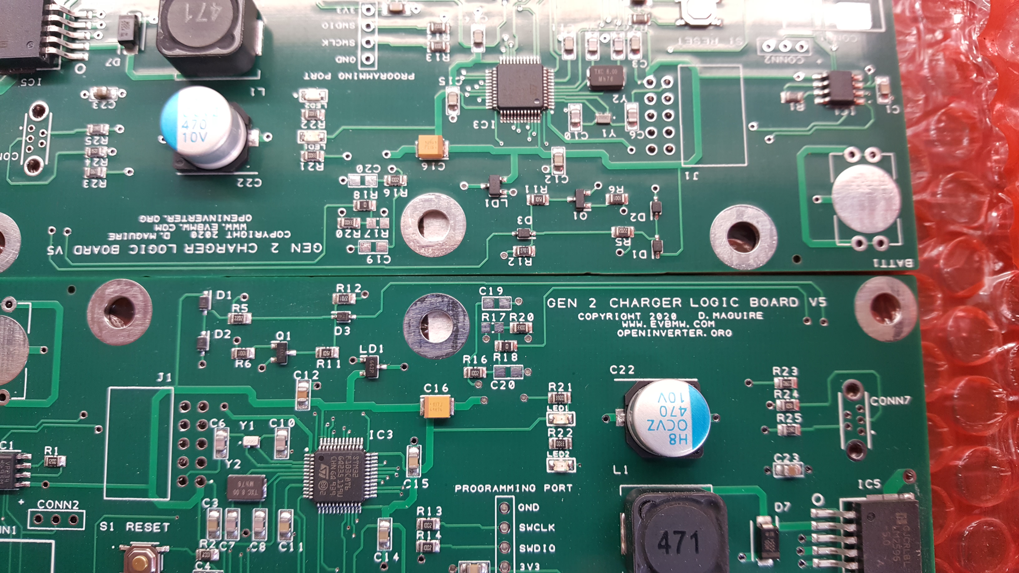

First batch of prototypes have arrived from JLCPCB. Initial observation is that this is top tier board building. As good as anything I have ever seen in my career and better than anything local who have charged a hell of a lot more.
I'd like to appeal for some calm in relation to the whole JLC build. I won't be responding to anymore "DAMIEN! WHEN ARE YOU RELEASING THE JLC BOM AND PLACEMENT FILES!" type of emails or messages on here or otherwise. The boards will be tested. Errors if found corrected. Webshop and github will then be updated and videos made. The vast majority of people are great and appreciate the effort involved but some seem to think I'm their personal design engineer. Newsflash! I'm not.
Now in relation to the webshop we'll be making a few changes. There will be three tiers of board available to buy :
1) Board direct from JLC as I receive them with listed smt placed, unprogrammed and untested. This will replace the bare boards currently on sale.
2) Board direct from JLC as I receive them with listed smt placed, programmed but untested. This gets around the need for programming the micros.
3) Board with all components both listed smt and non listed smt and through hole placed, programmed and tested.

Kinda bad news on the charger board. I done screwed up. Connected the SWD port to the wrong pins on the micro! Fortunately, a misspent youth of chipping playstations allowed me to connect to the right pins and upload the inverter bootloader and test program. CAN and IO are working but will need to re layout the board to correct this and some other errors. Not disappointed as this was my first go at using the STM32F103C8T6 and also first JLC board. I'll be putting up a new thread soon for software developement on the new board which will be a nice comedy show as I get to grips with C++ and STM32 :) Only took me a week to get an led blinking and CAN transmission working.
