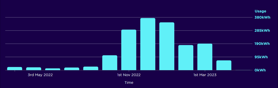

You caused quite a spike in my consumption!

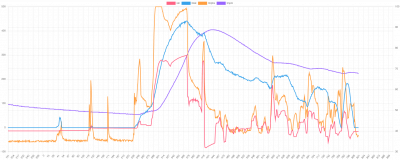

What is limiting the charge rate on the longer sessions over 70% SOC? Is the pack overheating?
I found with my LEAF30 even with fairly high battery temperatures it would keep charging fairly quickly upto around 90% SOC after which it dropped off a cliff. It would run full power to around 80% (~45kw) then taper from 45 to low 30's from there to 90%. After that it really dived.

SciroccoEV wrote: Mon May 01, 2023 9:09 pm You caused quite a spike in my consumption!
TBH thats impressively low even with the spike! With solar and a battery i rarely dip below 10kwh a day! When i'm charging its usually over 30.

Aragorn wrote: Wed May 03, 2023 9:29 am What is limiting the charge rate on the longer sessions over 70% SOC? Is the pack overheating?
The 30 kWh Leaf for some reason has a nicer charging curve than the 40 kWh. It allows 70 kW till 45%, then 50 kW till about 60%, 30 kW at 70% and then it drops until it reaches like 12 kW at 90%. If you plug in at higher state of charge it is different and allows more power even at 90%. It seems they don't want to stress the battery with prolonged high charge current.

Ah interesting, the so-called "rapid-gate" 40kw leaf. I guess your using the original LEAF 40 BMS so its following the same curves.
The start of the thread mentioned paralelled 24kwh packs, i presume that changed at some point, i've not yet read thru the whole thread! :)

Paralleling never happened, couldn't be bothered. With the fan and exhaust tunnel cooling there is no more rapid-gate.

Aragorn wrote: Wed May 03, 2023 9:37 am TBH thats impressively low even with the spike! With solar and a battery i rarely dip below 10kwh a day! When i'm charging its usually over 30.
I have a total of about 4kW of PV and 5kWh of storage with a 2.5kW inverter.
The only EV I currently have in use is the 2007 AC G-Wiz with 14 modules from a 2011 Leaf. This does about 500 miles per year of local running around. A significant proportion of the winter load is the dehumidifiers running in the workshops.
I've exported as much as 20kwh a day in the past. Looking at adding another couple of battery modules.

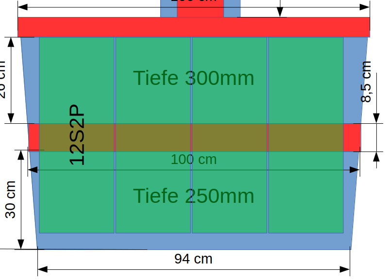

Just checked the dimensions of ID3 modules and it seems the 55 kWh pack would easily fit in the fuel tank space in 2 layers:
Will wait and see which offers come up in the coming 2 years.

johu wrote: Tue May 16, 2023 7:53 am Just checked the dimensions of ID3 modules and it seems the 55 kWh pack would easily fit in the fuel tank space in 2 layers:
Very good! You have to be carefull though as the fuses inside those modules are rated to 750mA. I need to cut off the corners of one module now as i managed to burn some fuses there...
I now have 8x ID3 12S modules and i intend to put them in Peugeot. My design showed i could easily install 6 modules in front battery box which would only leave 2 modules to put in the back. 8-)
The idea is to fit those modules onto a flat alu plate carrying structure. This way modules would be firmly mounted onto both sides of the plate which would leave me to install the plate into the front box onto its mounting points. Of course an engine hoist would be needed for that as the whole pack would weigh close to 200kg!
But the benifit of that configuration would be to easily cool the modules through the alu plate of the sandwich.
On the other hand 12S modules are becomming scarcer as Poles are selling them to Ukrainians en masse to use them for solar.

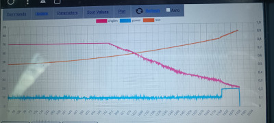

Today I tested some charging, I have different soc limits for AC and DC charging now. DC charging I usually don't want to limit in case I'm doing something while charging but AC charging should be limited to 80% or so. Before I always needed to remember to raise that limit.
I used rich mans charger for the heck of it and it charged nicely at 10 kW (well, the power is not really steady...)
Decided to record the charge power limit (cell temp was 20°C and rose to 25°C). 70 kW till 50% then hitting 50 kW at 60%
Didn't manage to transfer the proper screenshot to my phone.
Someone warned me about liion cells straight charging from autotransformer (120hz) and charger with no pfc function. There was a study about negative effect of jagged current delivery of charger with no PFC. I will try to find it again and post it here... That is why i dont use my 3phase EMW charger anymore.
