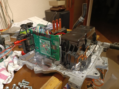

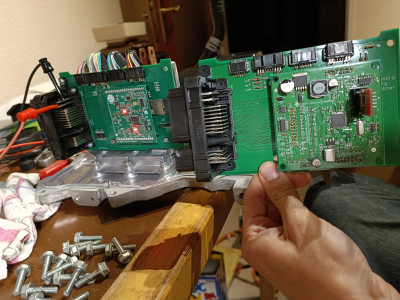

Today I was victim of my own code. I did some test driving in Touran which includes flashing new firmware from time to time.
So flashed firmware (wasn't parked in my own driveway, of course) and afterwards had no CAN comms, no parameters on wifi etc. Ok, no problem I thought I'll just flash again. Nothing, again nothing and again...
So towed the car back home. Flush coolant, take charger and aux inverter out, remove inverter and put it on the table.
When I opened it and powered it I found the alive LED blinking happily. WTF?
Tried again, no parameters via wifi. So plugged in a serial cable and restarted. What do I see?
In other words, instead of getting the inverter out I would have just needed to type "enableuart 0" into the custom command field. Maybe time to remove that feature, don't think it's being used.
So not sure what happened here, terminal is disabled when nodeid is anything other than 1 but apparently id had value 0.Disabling terminal, type 'enableuart 0' to re-enable
