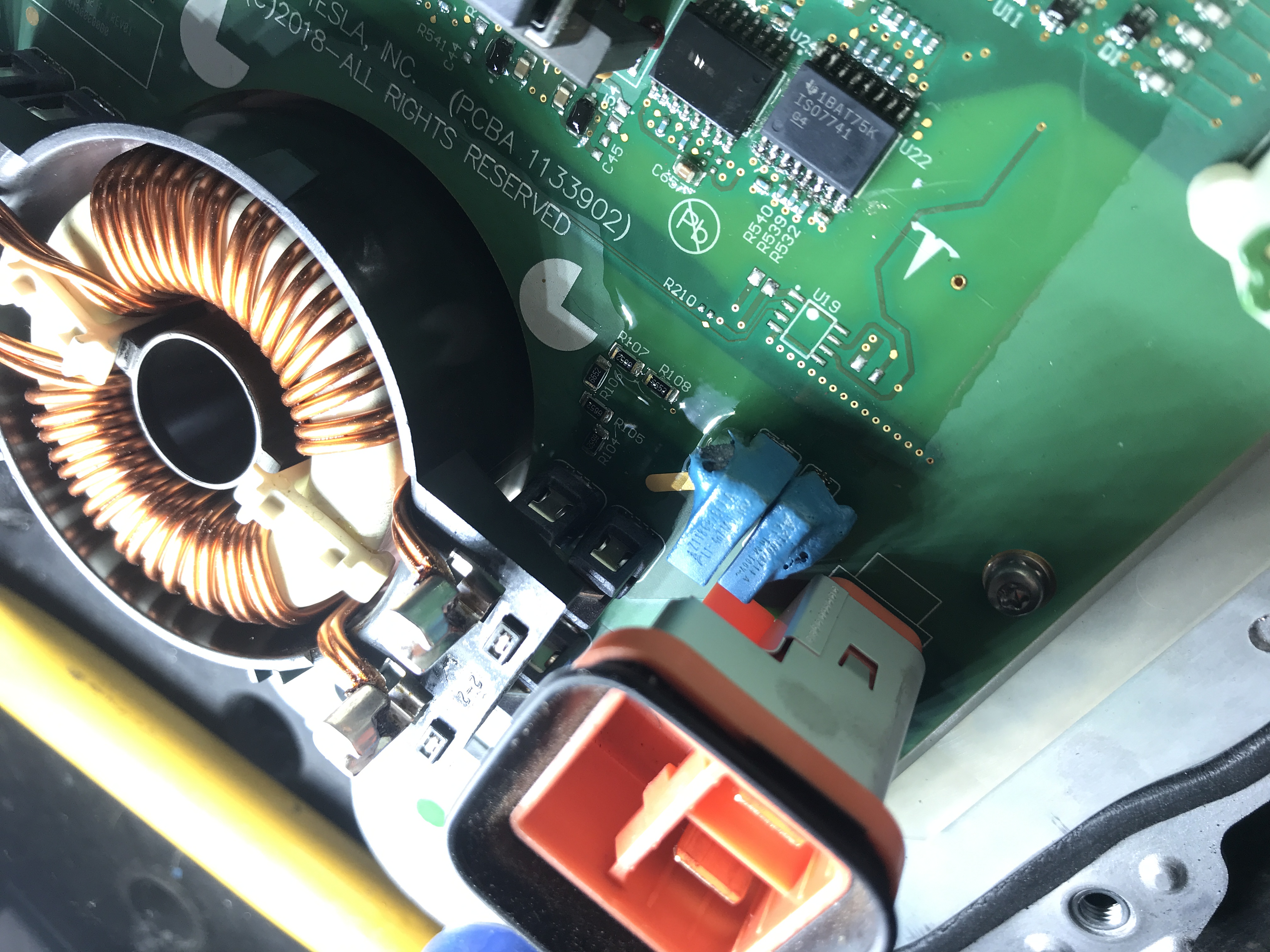

Well, your friendly neighborhood moron (that would be me) finally got a new ISO7741 isolator, and in the process of installing it accidentally melted other components. Does anyone have the part number for C24 and C272 (the two blue parts melted in the image below)?
- Posts: 1078
- Location: Raleigh, NC, USA
- Has thanked: 234 times
- Been thanked: 271 times
Bumping this up; anyone have these part #s or have/could take a photo of the components?P.S.Mangelsdorf wrote: ↑Sat Oct 01, 2022 10:44 pm Well, your friendly neighborhood moron (that would be me) finally got a new ISO7741 isolator, and in the process of installing it accidentally melted other components. Does anyone have the part number for C24 and C272 (the two blue parts melted in the image below)?

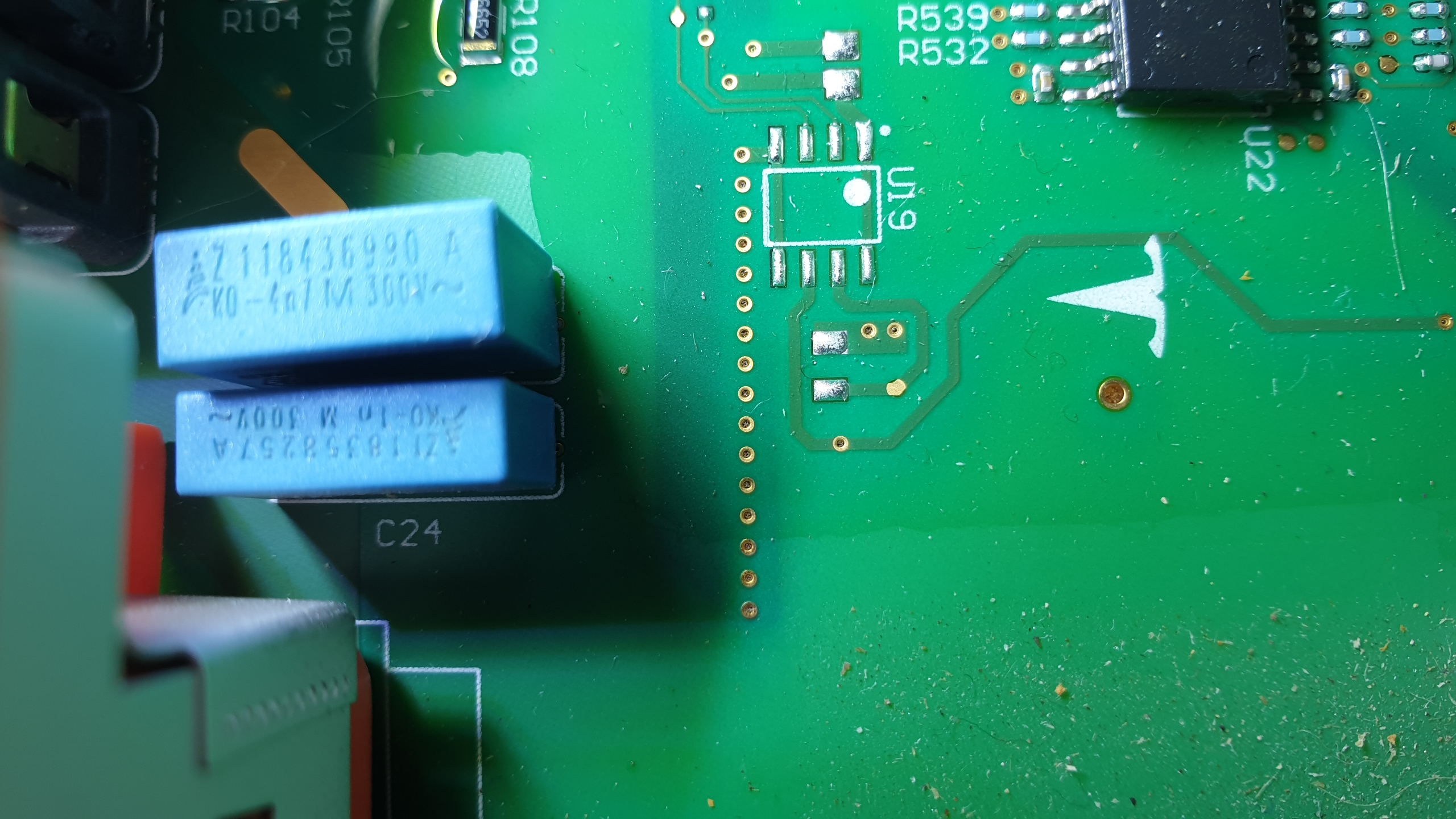

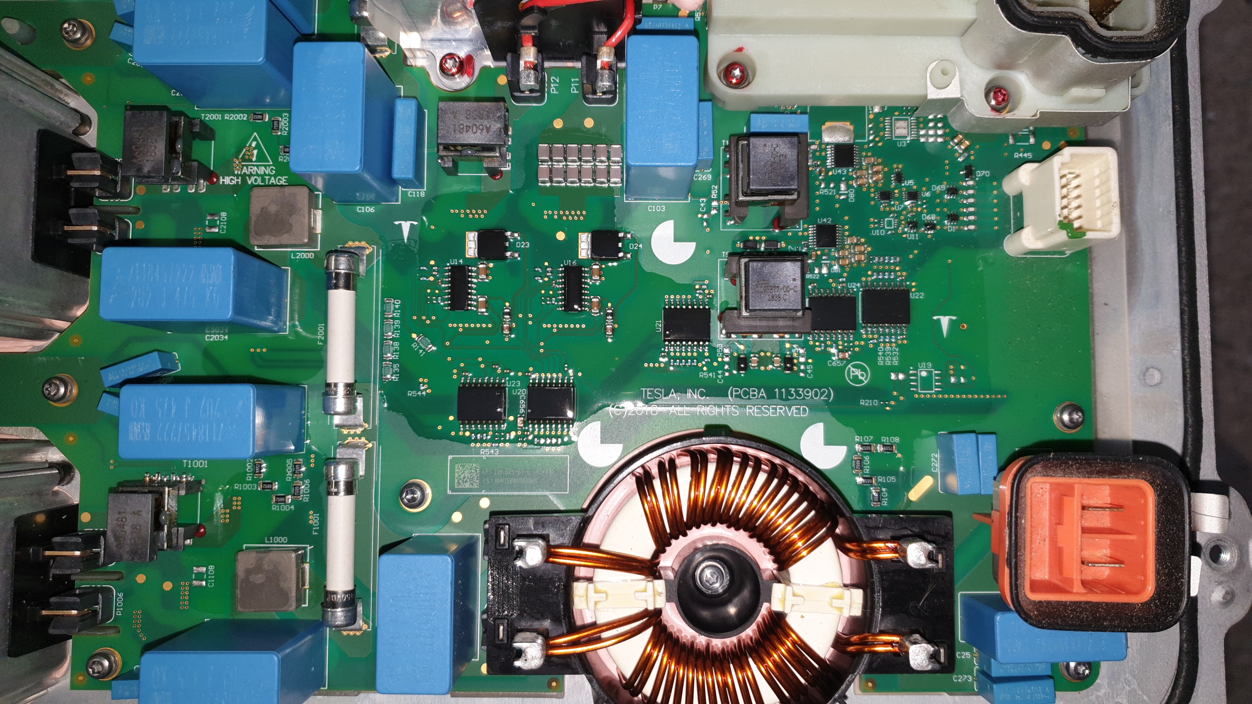

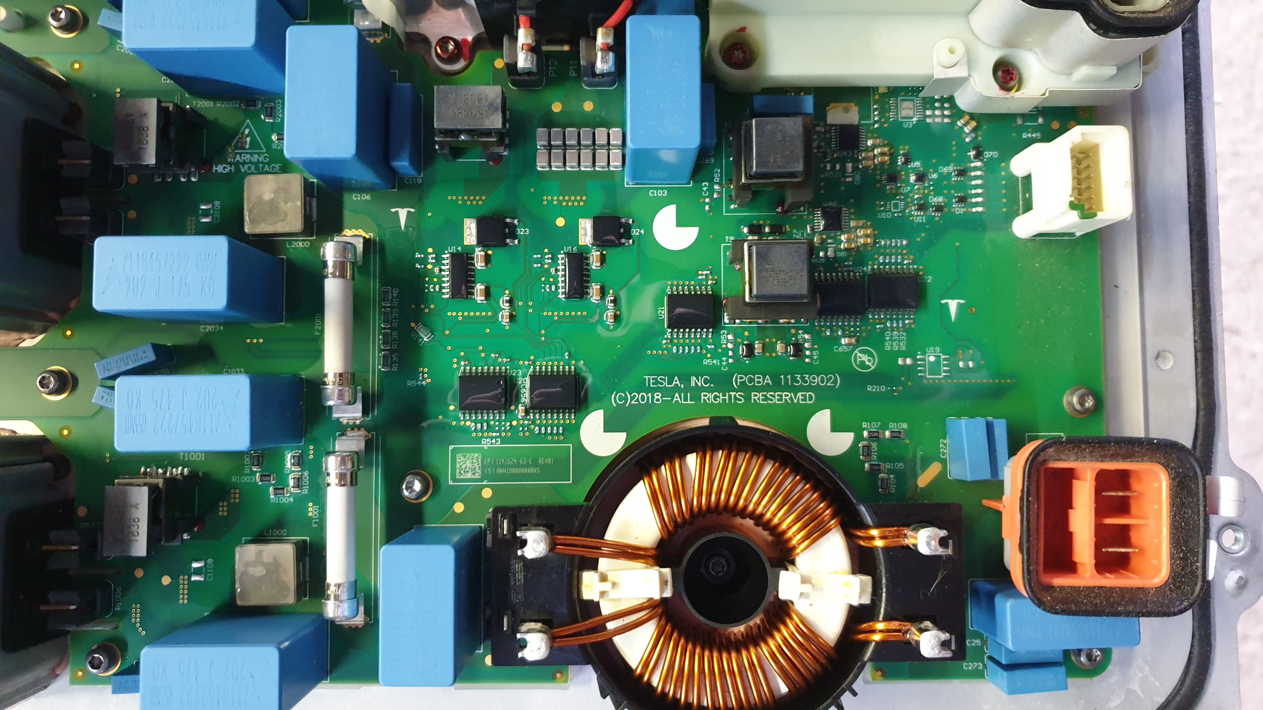

Hope these help. Sorry. Got distracted by a leaking kitchen roof!
- Posts: 1078
Thank you! Hope the leak was easy to find and the damage minimal.Jack Bauer wrote: ↑Fri Oct 21, 2022 12:34 pm Hope these help. Sorry. Got distracted by a leaking kitchen roof!

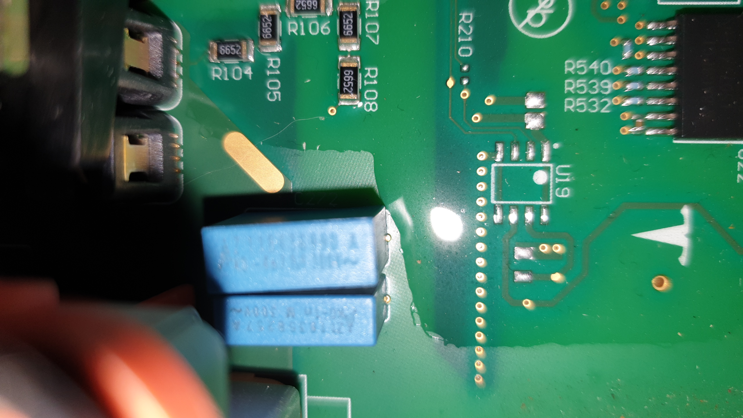

I read the numbers as follows, anyone care to take a look at the photos and confirm what I'm seeing?
Z118436990 A
K0-4n7M 300V ~
Z118358257 A
K0-1nM 300V ~
- Posts: 54
- Has thanked: 85 times
- Been thanked: 4 times
Looks right to me, not sure the Z or A would mean anything but their definitely in the picture

Ok so I'm working on decoding these. They're definitely capacitors, and I've figured out the following (for the first one):
300V ~ is clear = 300V AC
4n7M appears to = 4.7nF with a tolerance of +/- 20% (the M)
Anyone know what the K0 indicates?
- Posts: 3661
- Has thanked: 10 times
- Been thanked: 335 times
They are just X caps for providing some emi filtering. Just make sure the replacement has the same value and at least the same voltage rating and you are good to go.
