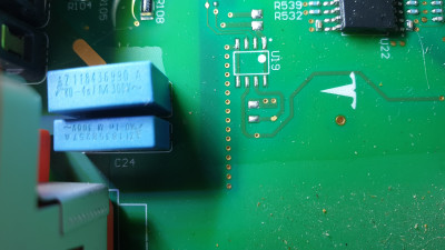

Well, your friendly neighborhood moron (that would be me) finally got a new ISO7741 isolator, and in the process of installing it accidentally melted other components. Does anyone have the part number for C24 and C272 (the two blue parts melted in the image below)?

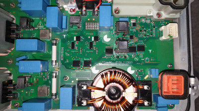

Bumping this up; anyone have these part #s or have/could take a photo of the components?P.S.Mangelsdorf wrote: ↑Sat Oct 01, 2022 10:44 pm Well, your friendly neighborhood moron (that would be me) finally got a new ISO7741 isolator, and in the process of installing it accidentally melted other components. Does anyone have the part number for C24 and C272 (the two blue parts melted in the image below)?

Unfortunately no, I'm still hoping someone that has theirs open or is willing to open it can share the part numbers.
I've gone through my pre-mistake photos and others' photos and videos and cannot find a clear image.

I'll take some pics today of mine as I have a few jobs in the barn (cough I mean workshop)

Not to be a pest, but any chance you were able to take the photos and/or grab the part numbers?Jack Bauer wrote: ↑Sun Oct 16, 2022 9:47 am I'll take some pics today of mine as I have a few jobs in the barn (cough I mean workshop)![]()
- Posts: 4007
- Been thanked: 1139 times

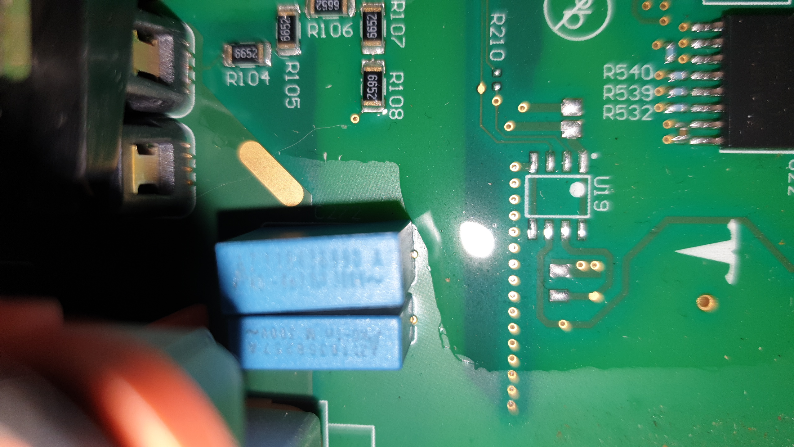

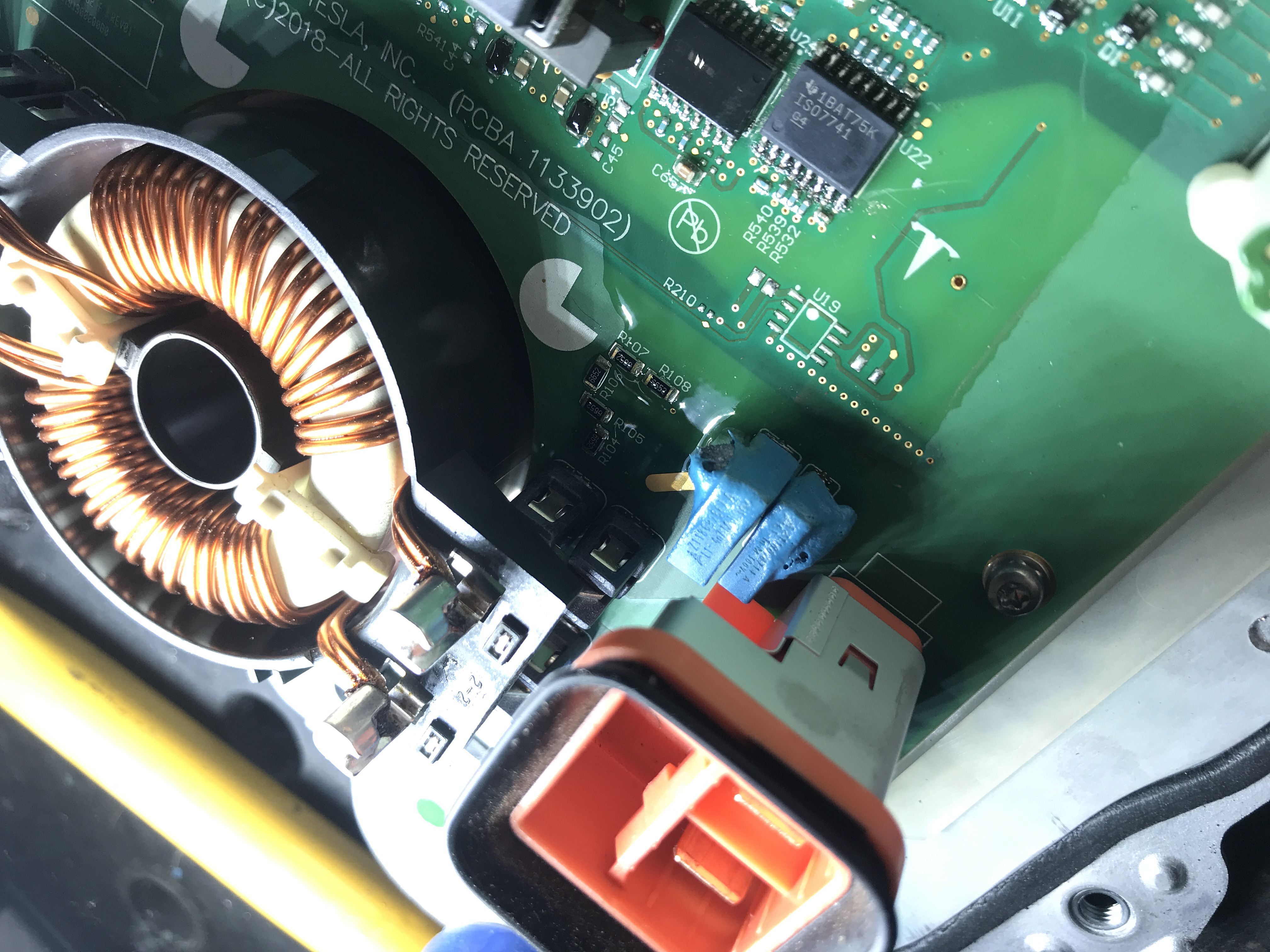

Hope these help. Sorry. Got distracted by a leaking kitchen roof!

I read the numbers as follows, anyone care to take a look at the photos and confirm what I'm seeing?
Z118436990 A
K0-4n7M 300V ~
Z118358257 A
K0-1nM 300V ~
Doig5710

Looks right to me, not sure the Z or A would mean anything but their definitely in the picture

Ok so I'm working on decoding these. They're definitely capacitors, and I've figured out the following (for the first one):
300V ~ is clear = 300V AC
4n7M appears to = 4.7nF with a tolerance of +/- 20% (the M)
Anyone know what the K0 indicates?
- Posts: 4007
They are just X caps for providing some emi filtering. Just make sure the replacement has the same value and at least the same voltage rating and you are good to go.
