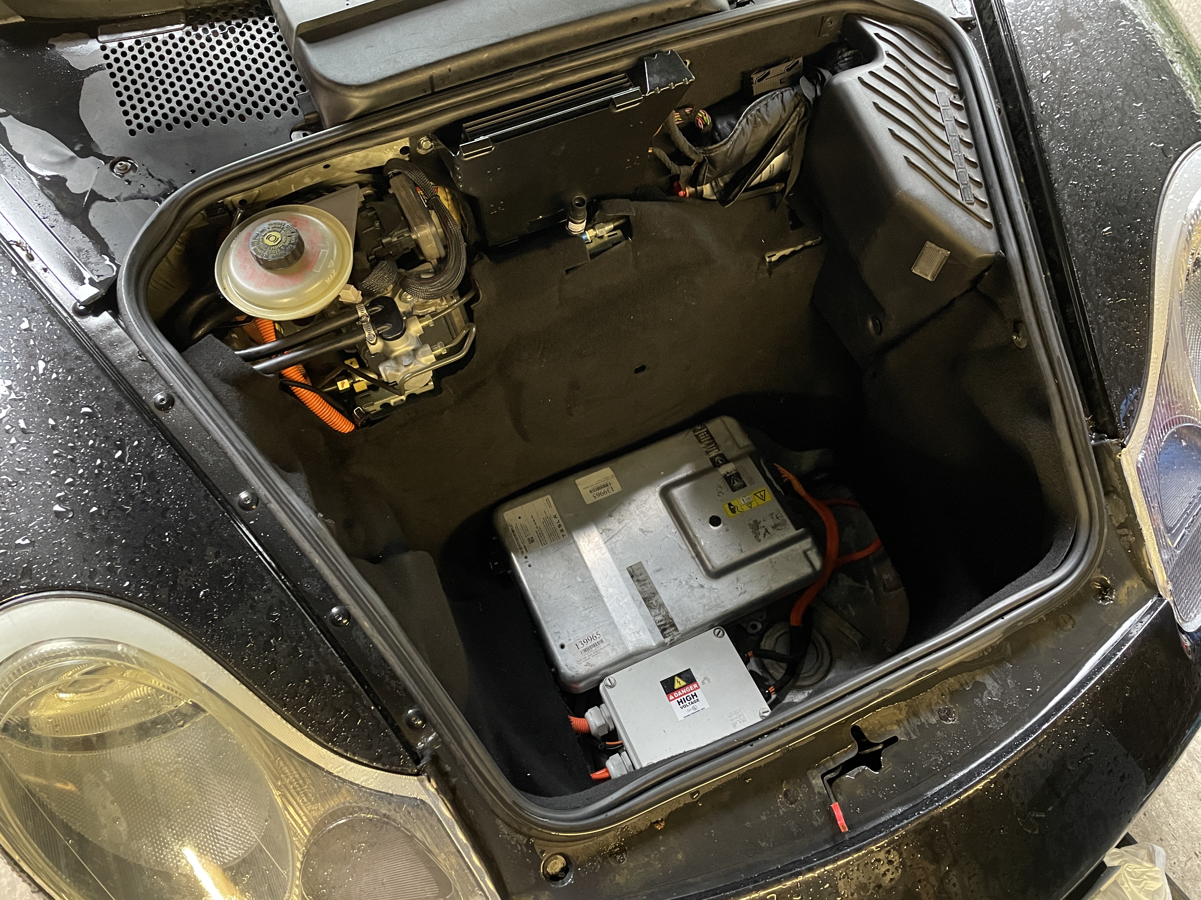

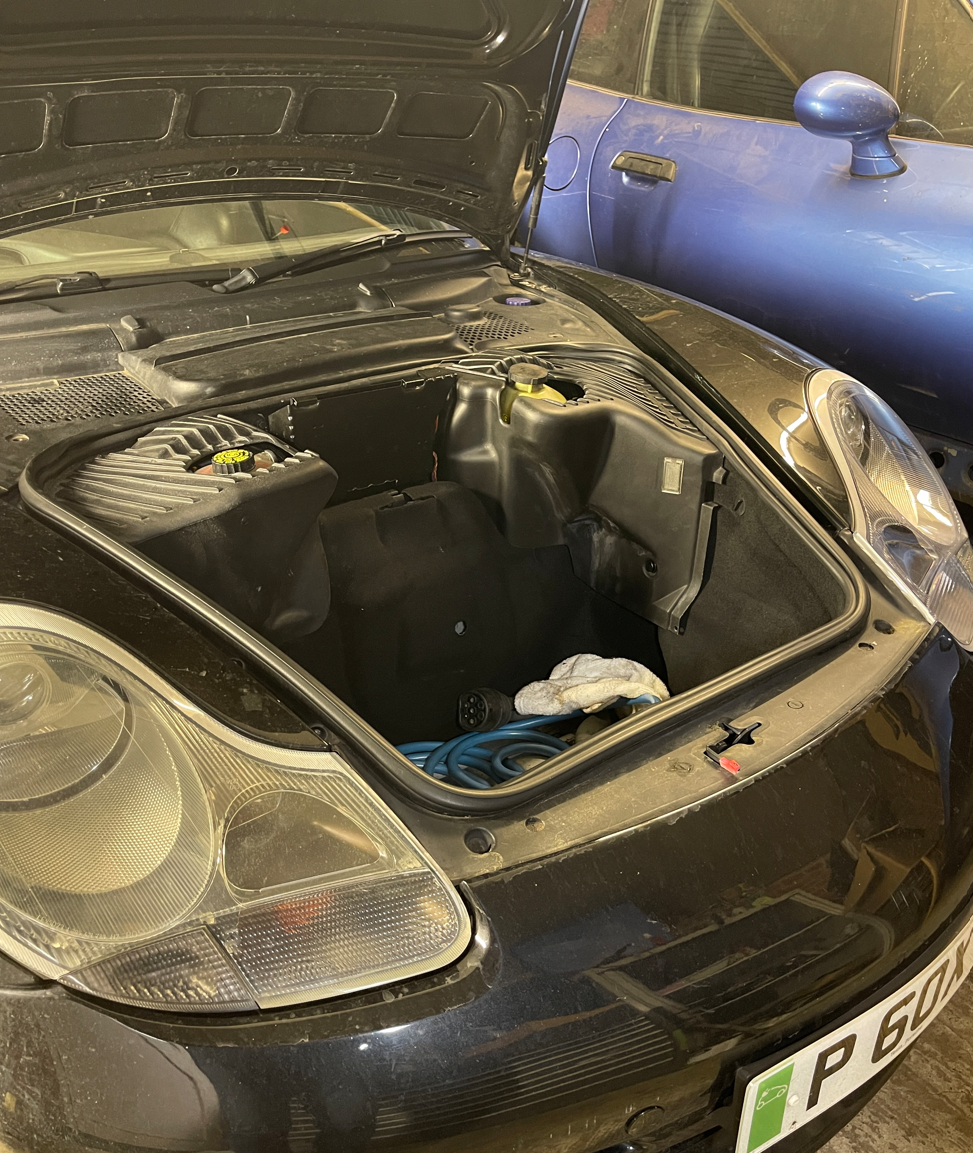

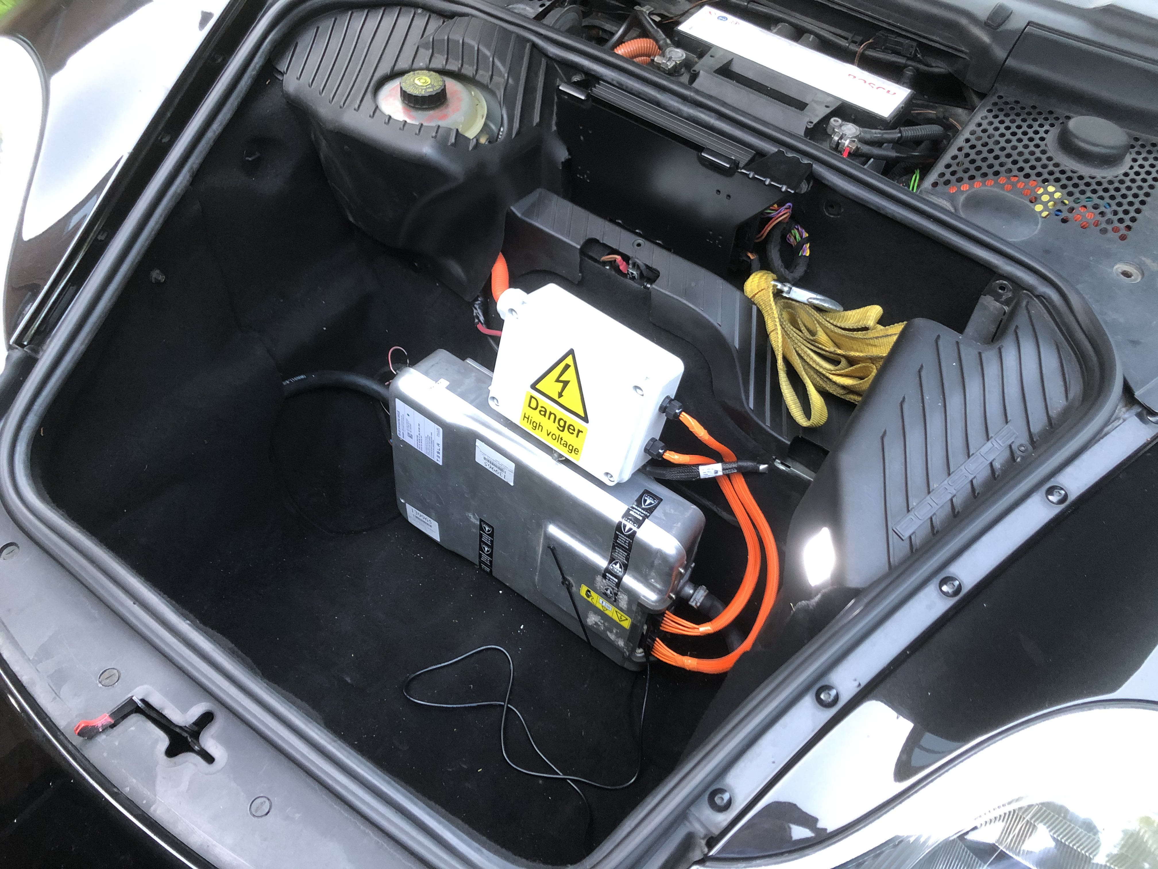

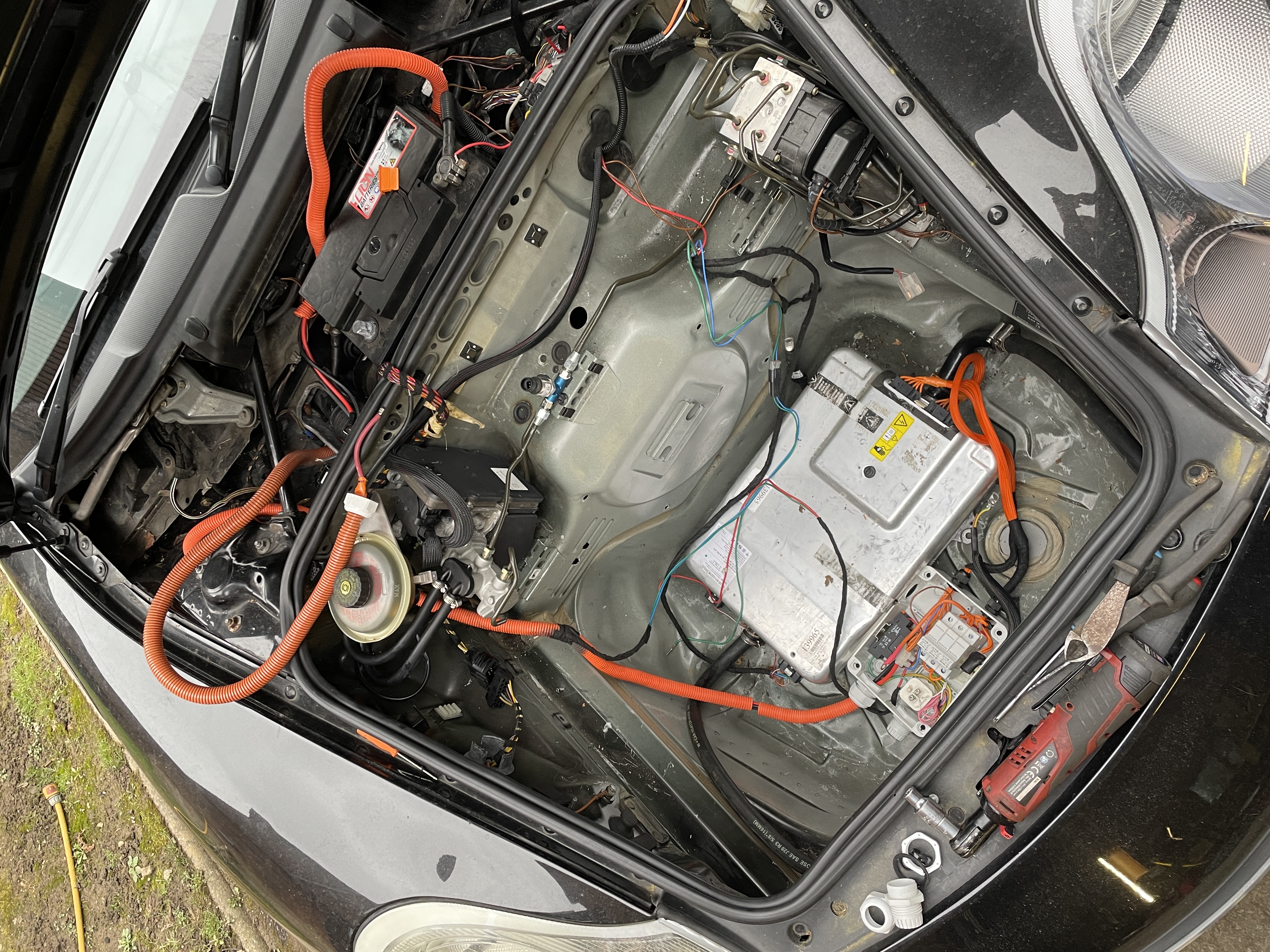

Update time:

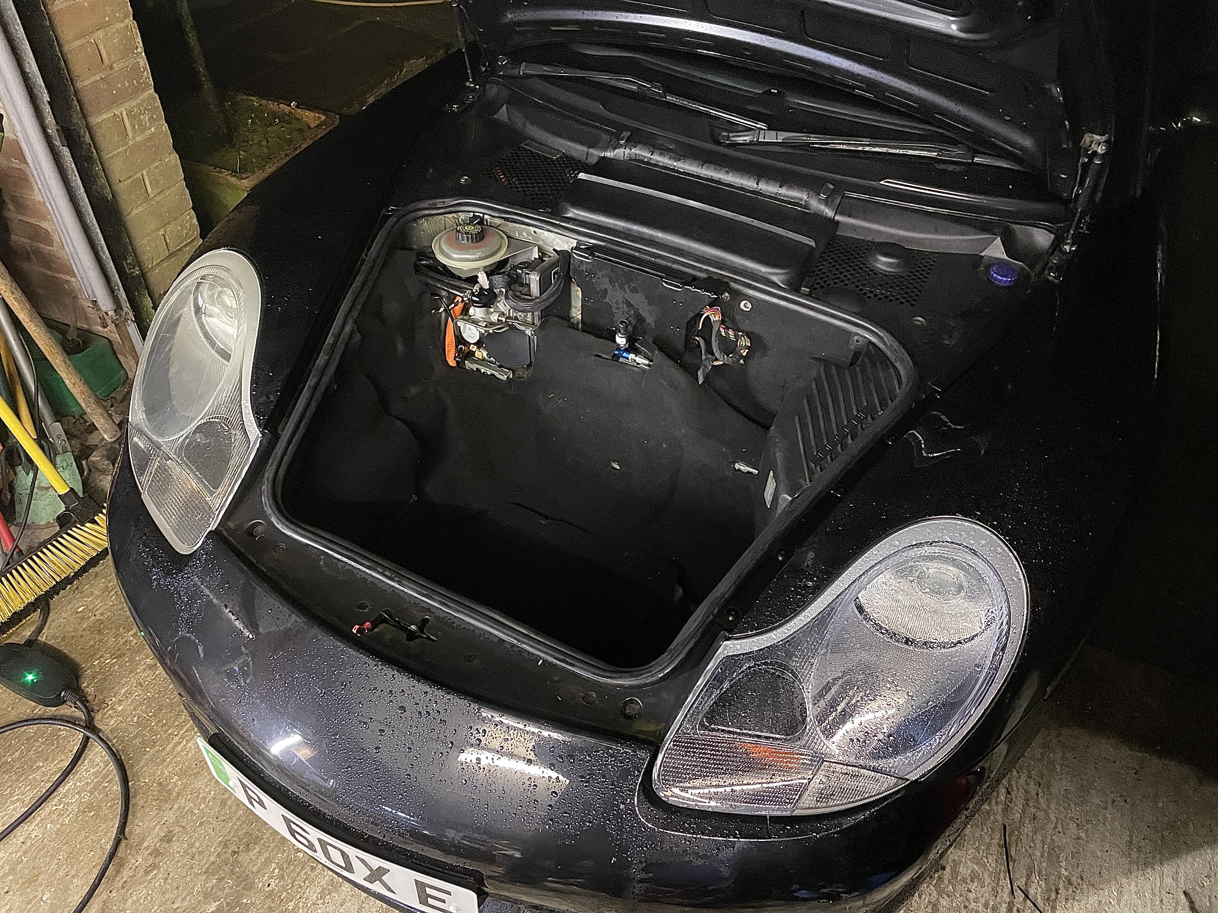

Charger relocation
I have now moved my Tesla Gen 2 charger and front HVJB to sit horizontally in the front luggage compartment. There are several benefits for doing this versus my original arrangement:
1) There is a perfect size niche towards the rear of the Porsche 996 911 and 986 Boxster tub (RWD cars only) for the Tesla charger to fit, meaning the actual usable space that’s consumed by the charger is small
2) The weight will be lower down in the car
3) A false floor can bit fitted concealing all HV activity making it safer for inquisitive fingers
4) It’ll make the conversion look even more standard / OEM
To achieve this little project I needed to extend several low and high voltage wires. The low voltage wires were not an issue, but when it comes to the high voltage side, I tend not to like extending wires for fear of adding another failure point. However, the HV wires in question are just 6mm2 and therefore I’ve decided to use HV MC4-6 IP67 connectors rated at 30 amps. Of course, the circuit is fused. All HV cables are covered in protective conduit and where they terminate in screw terminals such as within the fuse holders, I have fitted conductive crimped ferrules to improve the fixing and reduce resistance (and any risk of heat build-up). As ever, all HV cables are clipped down every 100mm to prevent chafing.
The front HVJB could do with revising but I’ll save that for another day. Inside I have DC fuses for the charger, PTC heater and mini contactor for the same.
Before
During
After

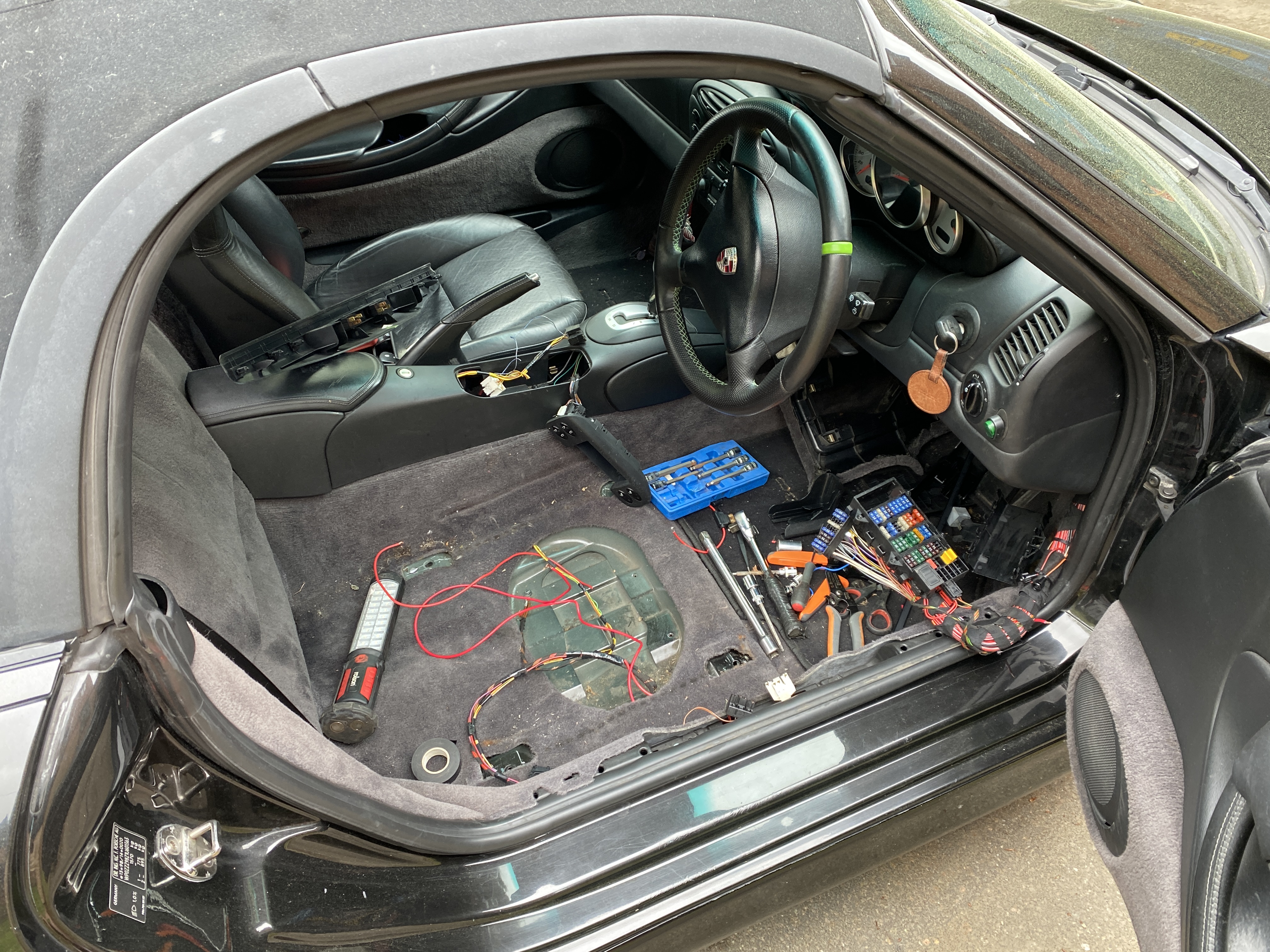

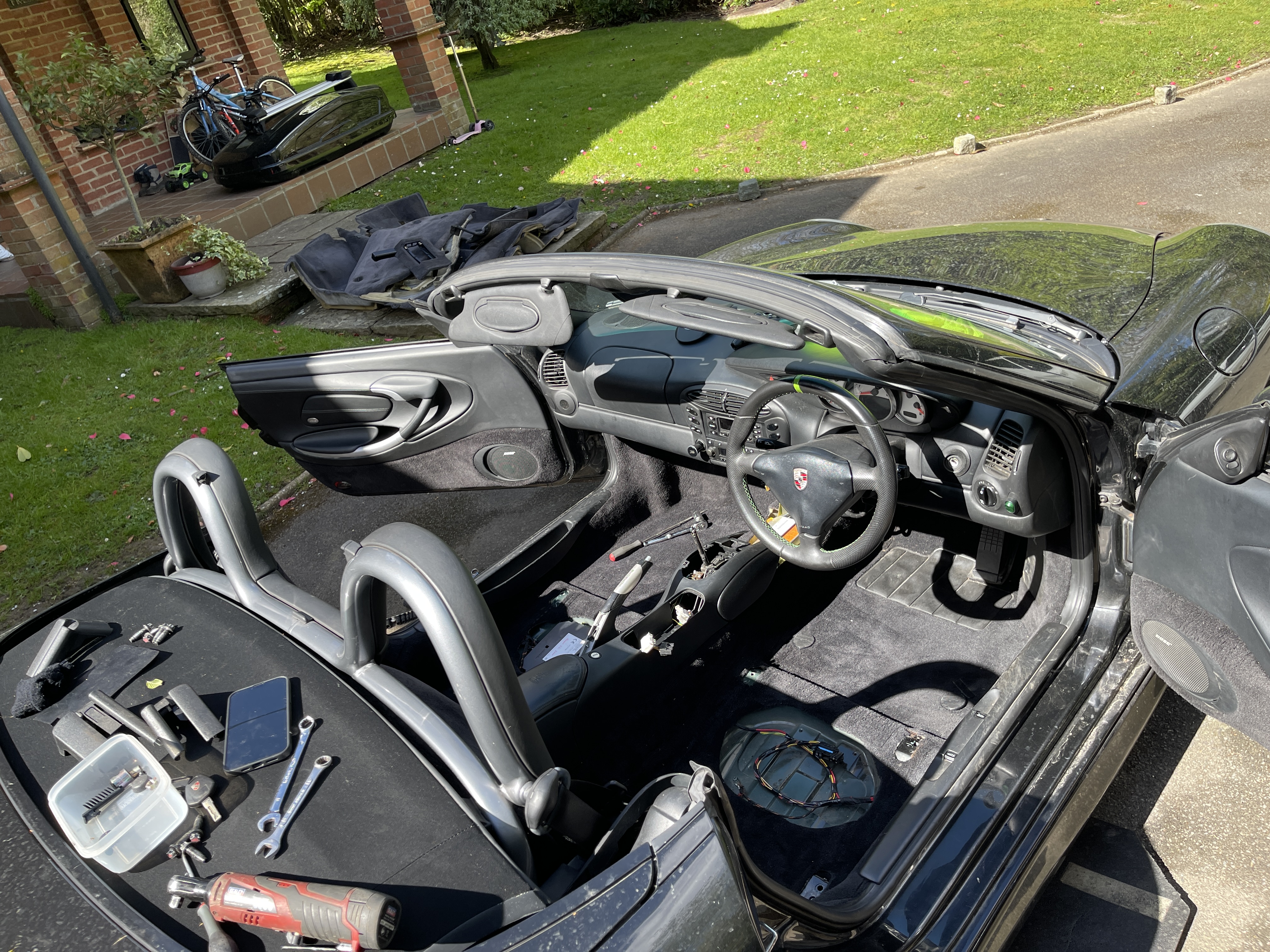

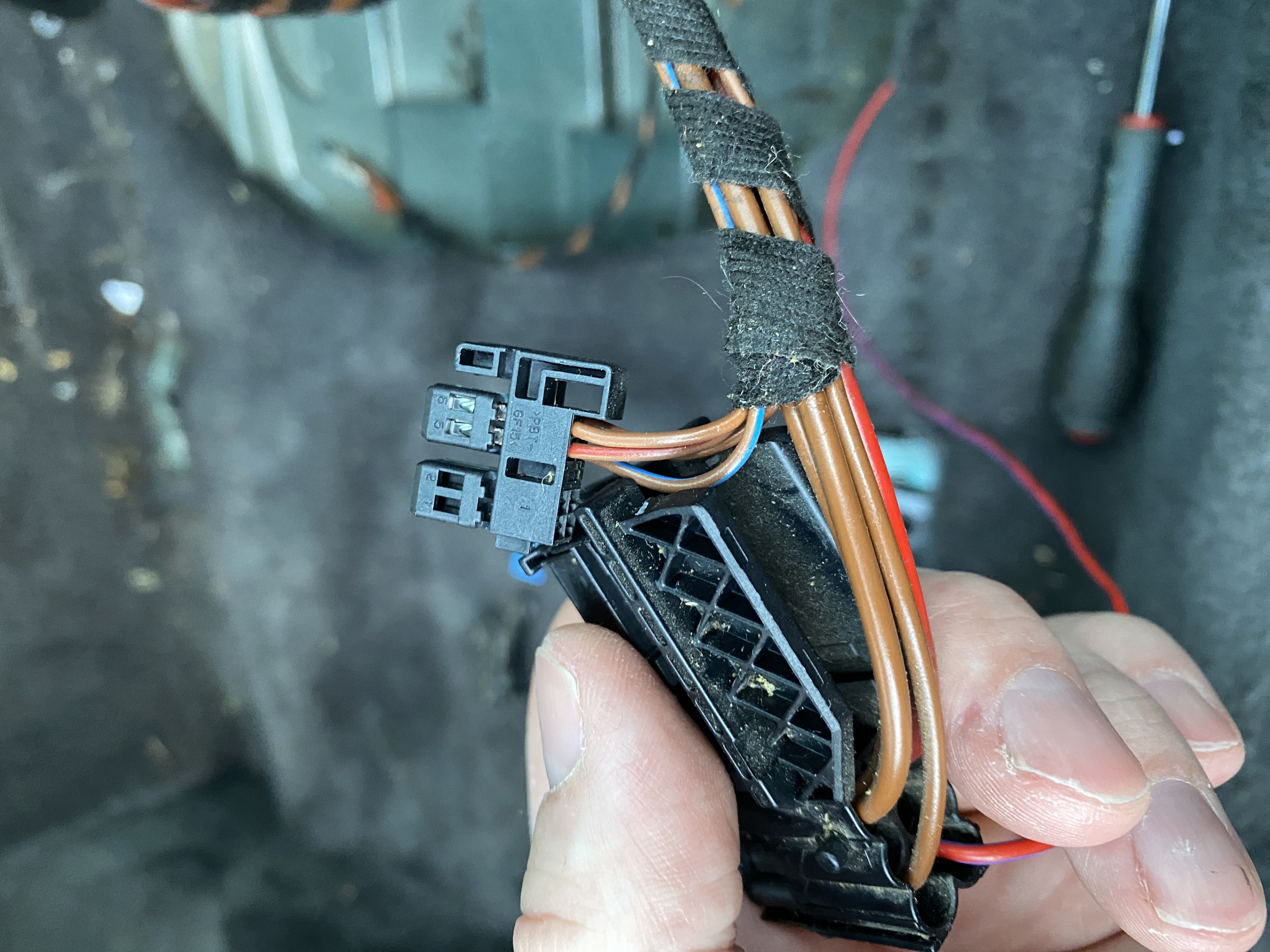

Heated seats

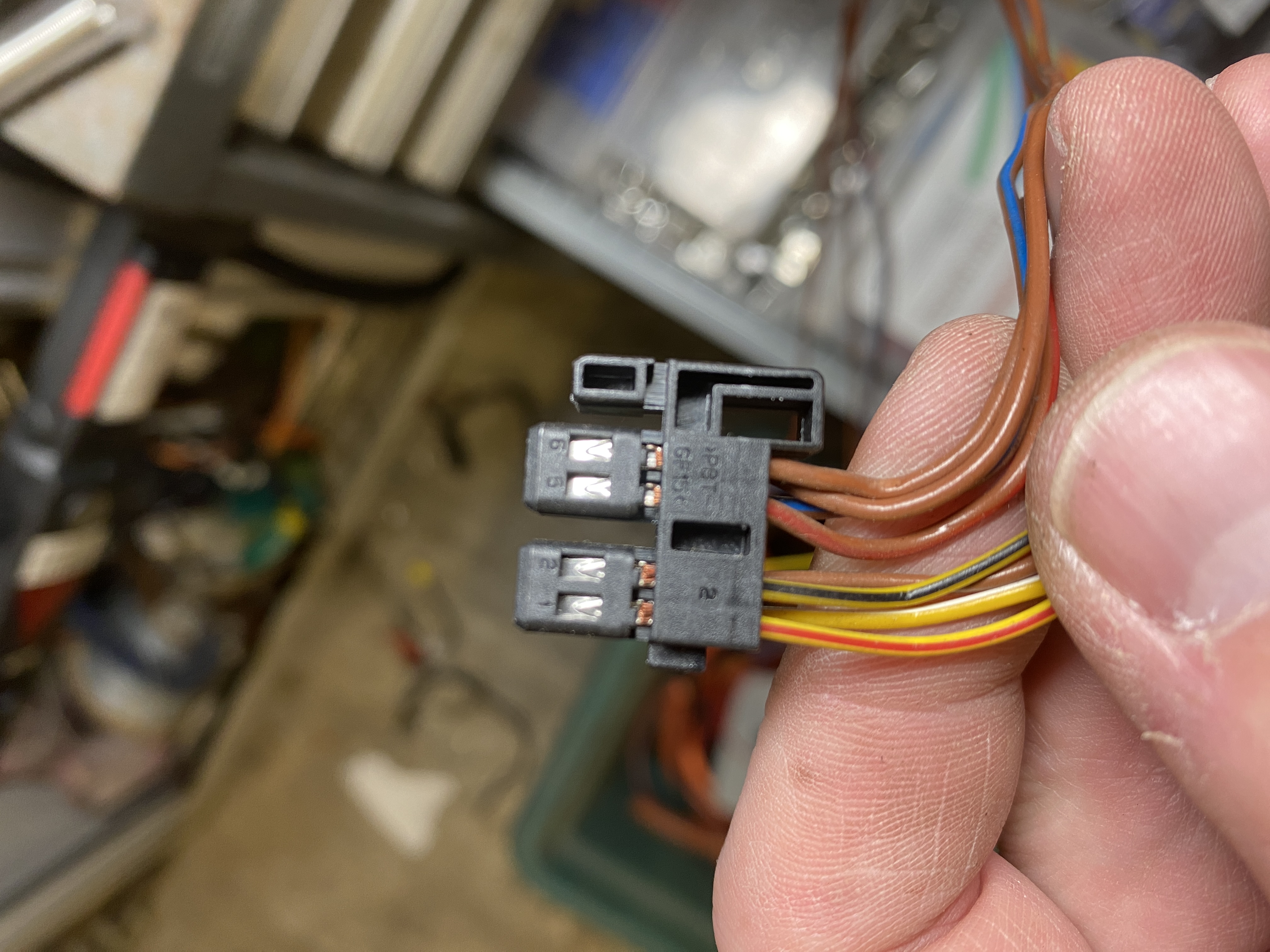

The sport seats in my car were salvaged from a parts car two years ago and have heating elements and relays pre-installed. Wiring them up has been one of those jobs that I never got around to until recently. I followed this superb guide https://www.dennisvogel.com/heatedseats/ and really, it was just a case of buying the connectors, pinning them up and running wires. Very straightforward and satisfying job. OE Switches bought on eBay.
Homemade loom made up and integrated within existing harness, with 25amp fused feed taken from the main fuse panel (Porsche fuse A6)
Seat connector pinned up.
Before:
Rinse and repeat for passenger side.
Having heated seats is a must have in a conversion. Just wish I’d installed them sooner!

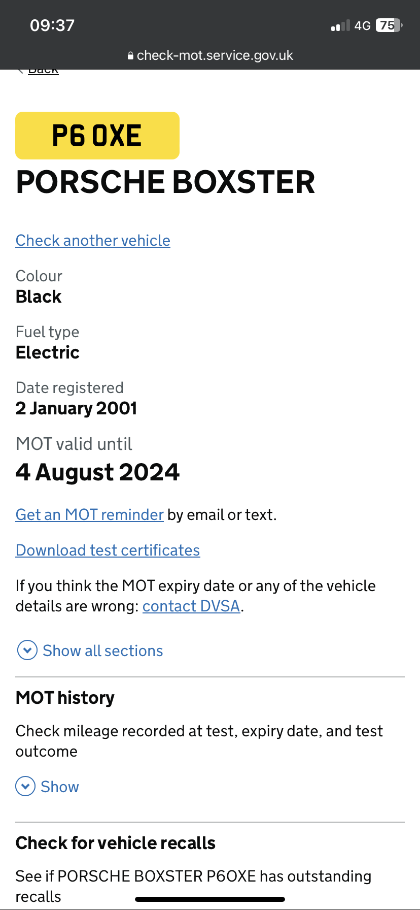

Thanks to the mods for updating my thread title. The car has now completed nearly 25,000 electrical miles running Openinverter savoir faire.
It’s also just passed it’s annual MOT.
The only real update is that I installed a DIY solar array at home to charge it. 🌞

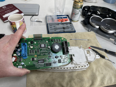

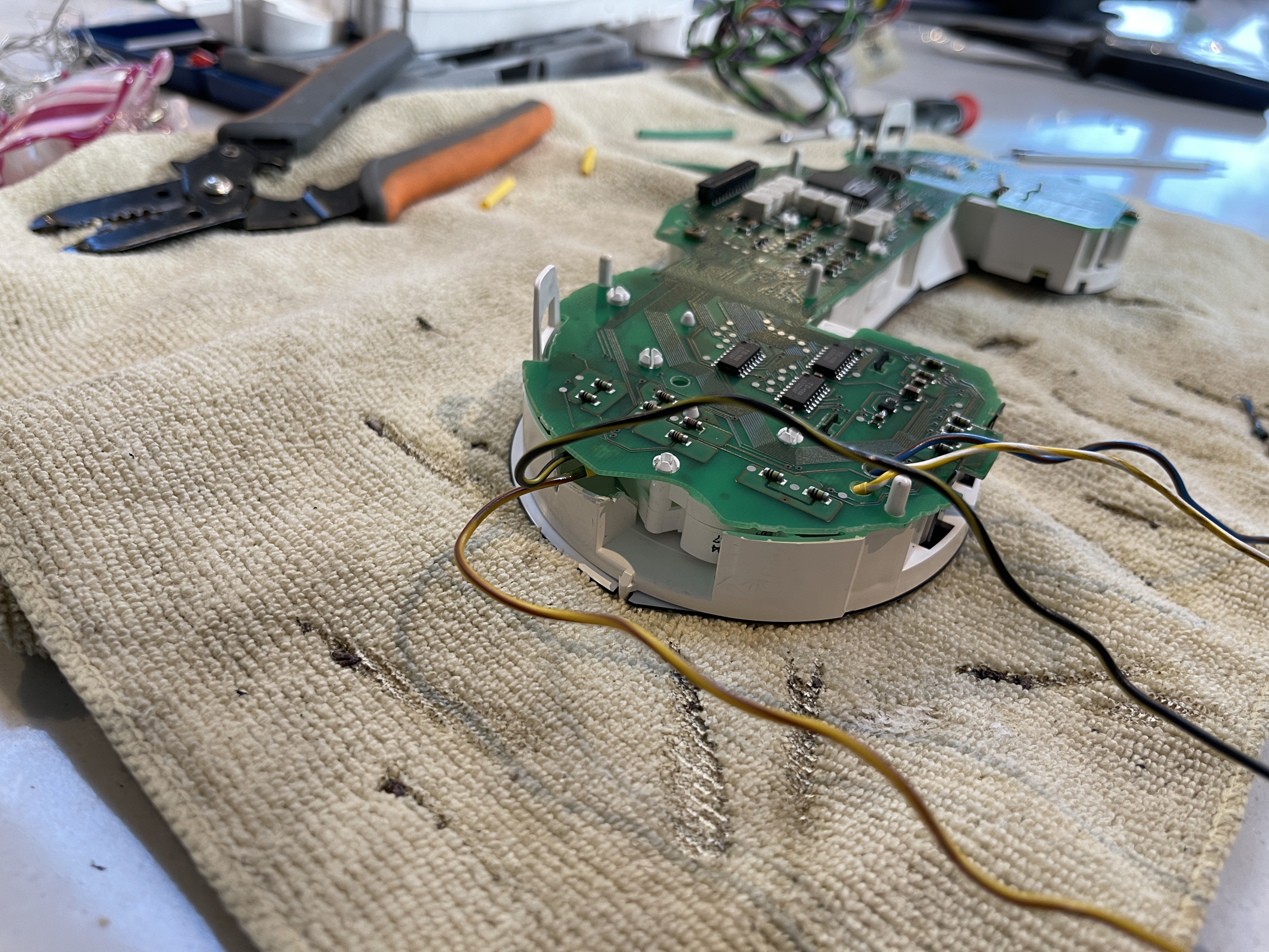

I’ve been having trouble with my dash fuel gauge and have been putting off digging into the issue for some time. Bottom line is that I needed to open the cluster and repair a dry solder joint to the stepper motor and rewire. The next issue was that I was using a twisted pair of .5mm2 cable to run from my Teensy VCU (near the motor) to the easydriver board, however I am getting interference. Thanks to suggestions by Janosch and KnoxEV, it was identified that EMI was indeed disturbing the signals. I’ve now moved my VCU to the front of the car as far from the motor as possible. This has significantly improved things, but I still see small oscillations with the needle. Any suggestions out there on how to shield the Teensy VCU further would be most welcome.

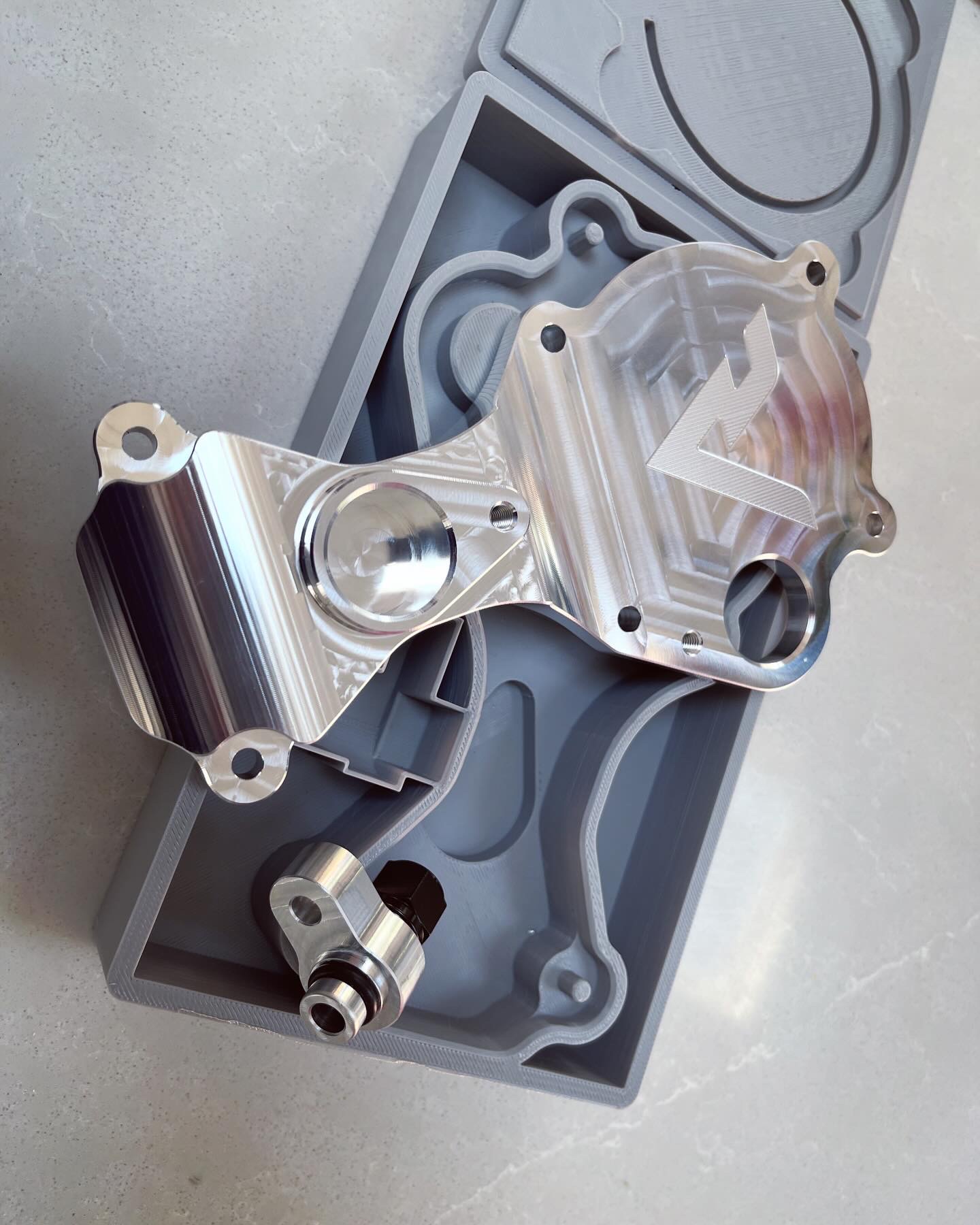

Tesla Large Drive Unit coolant manifold delete:
This is a big deal. Ever since converting the car I’ve had concerns about coolant leaking past the infamous rotor seal. The length of this thread:
viewtopic.php?t=2242
demonstrates just how concerned others have been too. My OE Tesla seal leaked badly two years ago, with coolant making its way along the AC busbars to the inverter. It made a mess of my logic board, but luckily the inverter wasn’t damaged. I had several unsuccessful attempts at fitting Chinese replica Tesla seals and since then, I fitted a generic high quality SKF seal and Speedi sleeve which has been fine, however having covered more that 15k miles on this solution, I felt like I was living on borrowed time and don’t really want to ruin my drive unit. Therefore, I decided to delete the coolant manifold altogether.
To achieve this, I had two choices: modify my existing manifold which would take about a week at a machine shop or, buy a coolant blanking plate from one of the various US specialists that have developed this aftermarket solution (Tesla also do one but it’s not available to buy). I chose the second option. It was painfully expensive at nearly £650 once the importation fees were paid but it beats the cost of replacing the whole drive unit due to a catastrophic coolant leak. I can recoup some of that cost by selling my old manifold. It took about an hour to fit.
So far so good having covered about 1000 miles. Hoping that having a rotor that isn’t cooled doesn’t have any long-term issues. It’s worth the risk in my opinion (versus the alternative of a leaking seal). Noteworthy that forum user asavage is taking a more considered approach by placing a temperature sensor inside the rotor to monitor things.

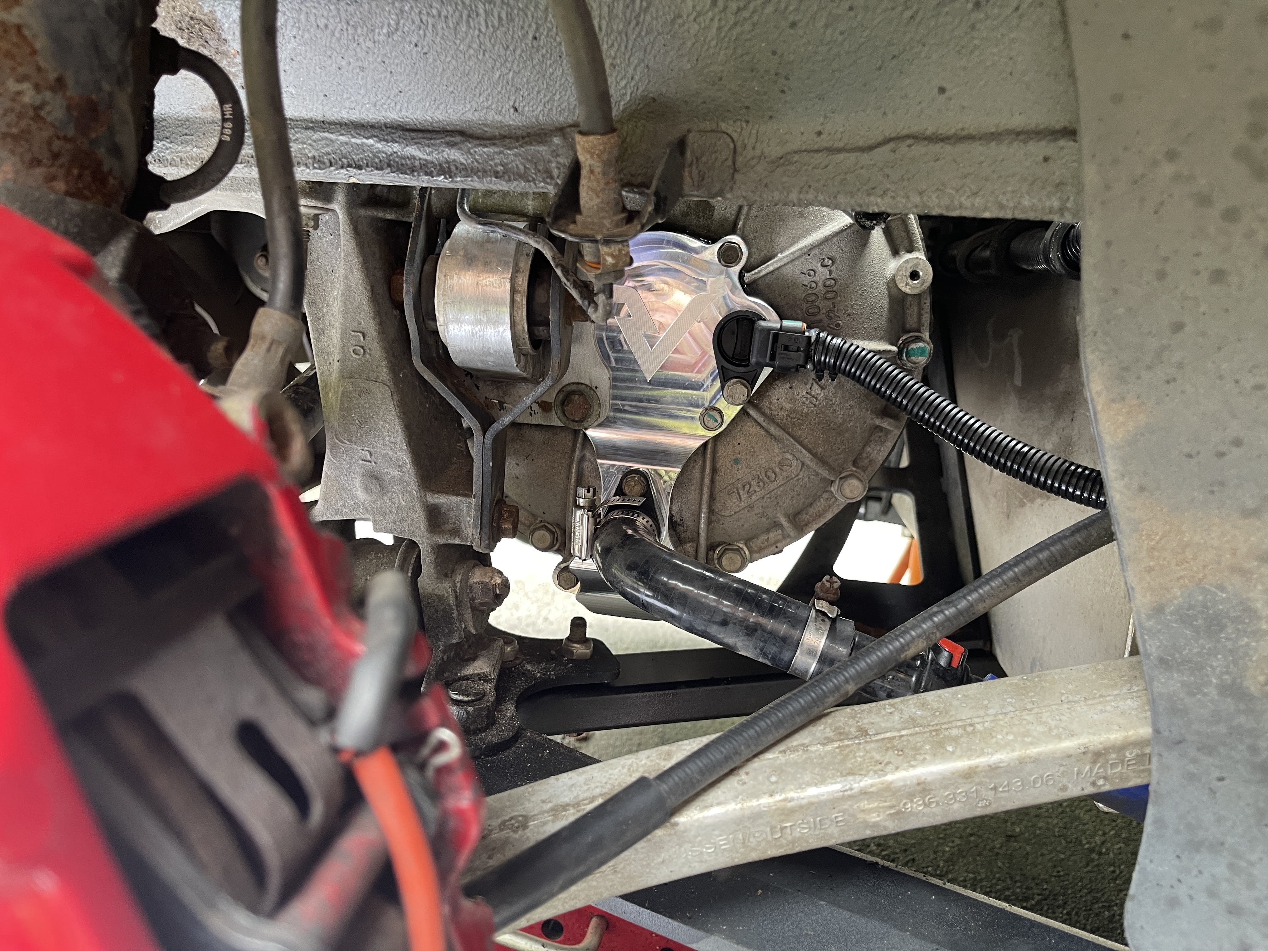

Relocate Power Steering pump
Next on the list is to relocate the power steering pump from the rear of the car and mount it behind the brake reservoir cowling from a left-hand drive car inside the frunk. A few positive for going this route: weight saving by removing all pipework that runs front to rear, weight distribution by having the pump in the front, but most importantly; mounting inside the sealed frunk to reduce the noise. I was going to have an electric power steering rack or column mounted / fabricated, but it would require too much cutting and modification to the factory set-up.

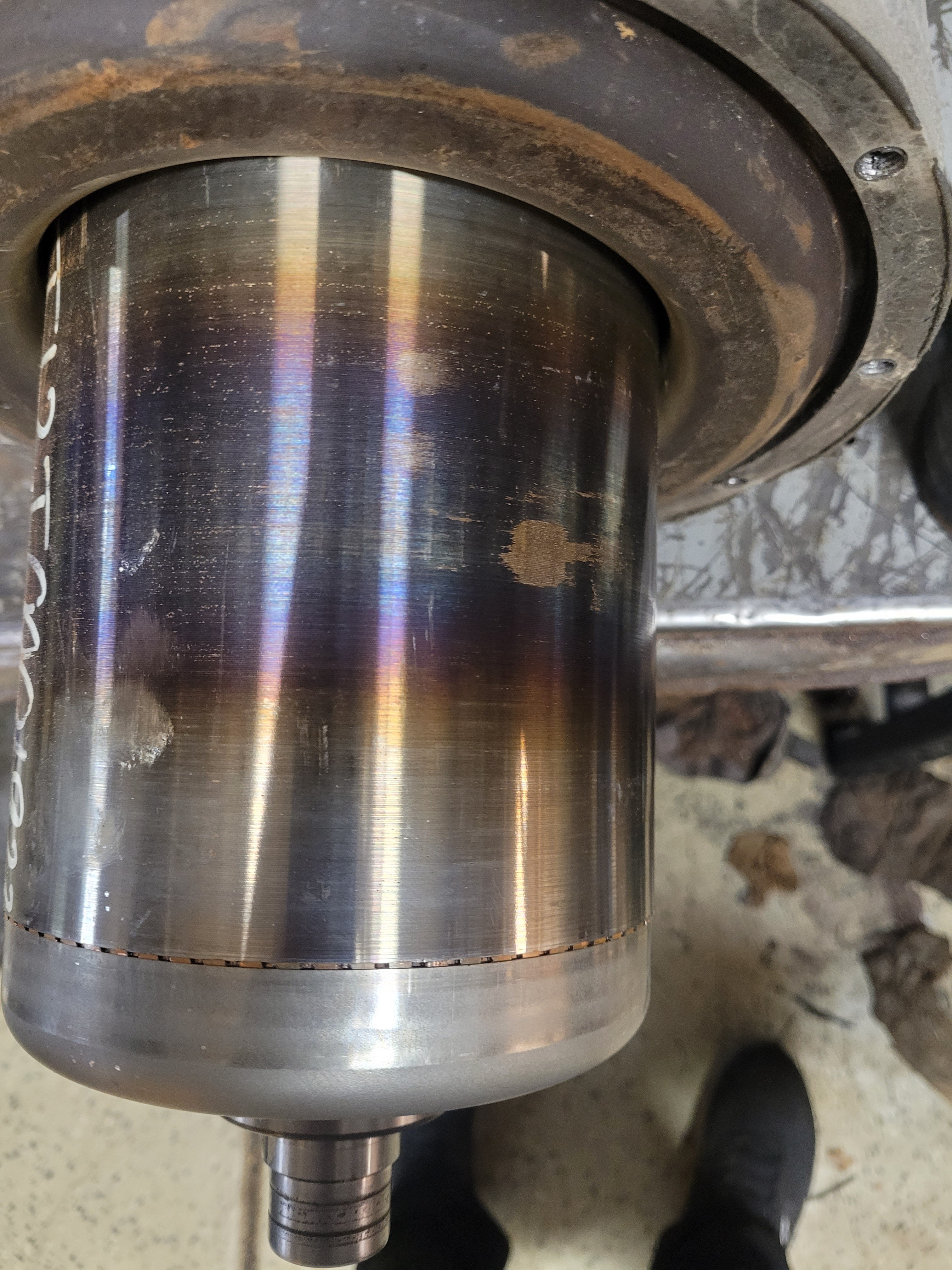

Boxster EV wrote: Fri May 24, 2024 12:58 pm . . . forum user asavage is taking a more considered approach by placing a temperature sensor inside the rotor to monitor things
Last night was first trial run with "working -- with caveats" LDU Rotor Temp Monitor:
(sorry for the large view; can't resize a linked image here)
Rotor after a coolant delete modification (source):
LDU Rotor Blued
LDU Rotor Blued
Google says plain-ish steel blues in the high 500s°F (~300°C). The MLX90614 IR sensor I've installed can read up to 380°C (720°F).
Al Savage

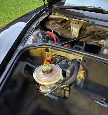

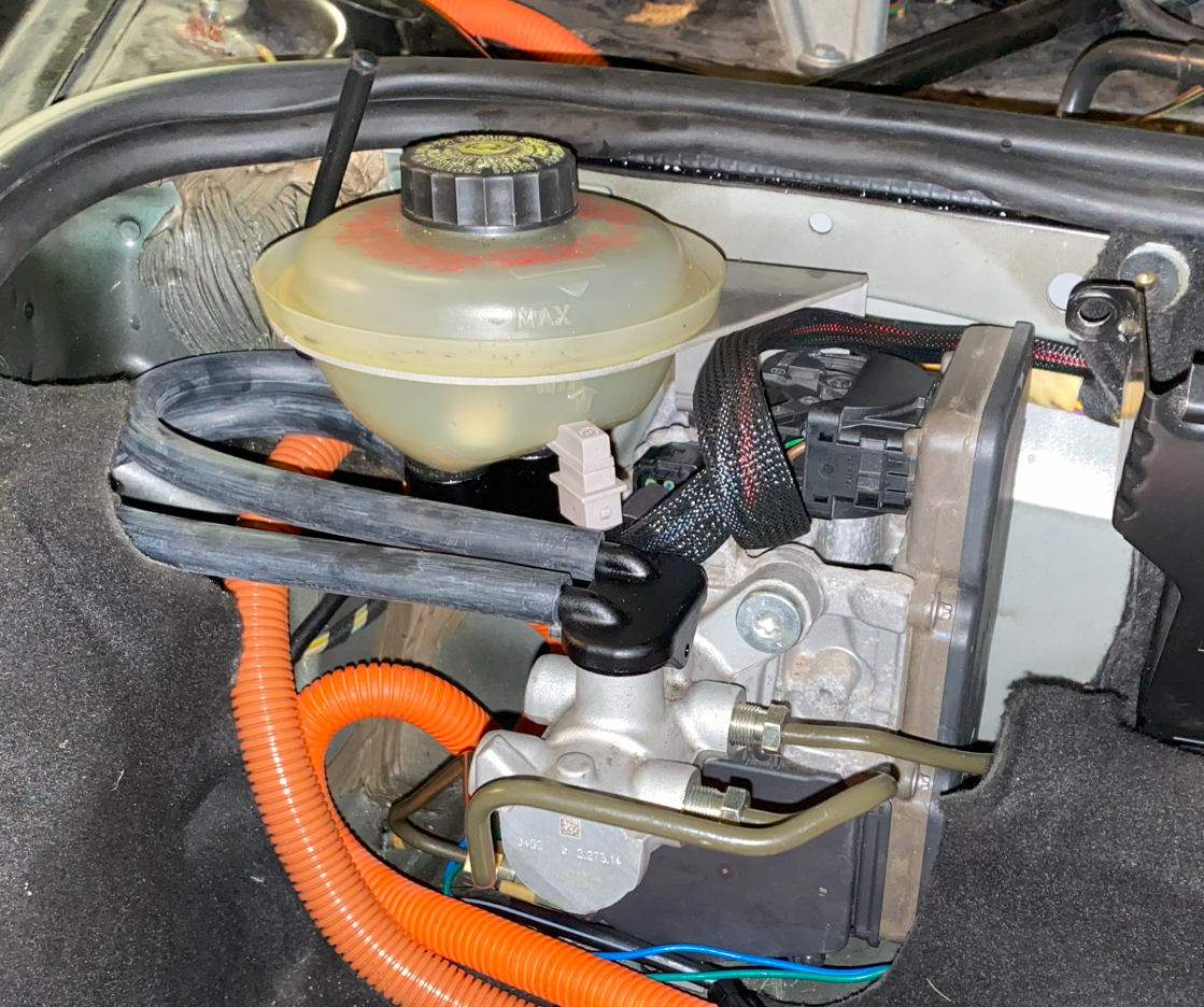

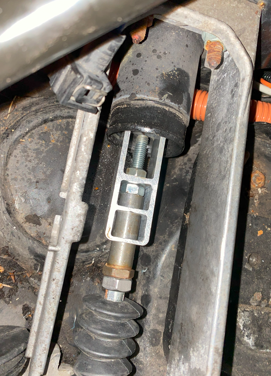

Tesla Gen 1 ibooster installation:
Whilst I installed an ibooster a few years ago upgrading from a UP28 vacuum pump, I wanted to update this thread as I’ve improved the installation solution.
Here’s the first iteration whereby I offset the fluid reservoir position.
I was never happy with this solution, running hoses from reservoir to cylinder, however it was necessary as neither the Tesla or Porsche reservoir fitted when mounted directly – they were too high fouling the bonnet. Moreover, because the OE brake lines ran in front of the Ibooster the frunk cowling didn’t fit over it and made the whole thing look very ugly:
I haven’t changed how the ibooster is mounted (its straightforward as the bolt patterns make it almost plug n play for the Porsche).
Here’s a picture of the connection between ibooster and the Porsche OE rod to brake pedal. It is adjustable as the ibooster rest point must be within its calibrated parameters. I used blue Loctite to secure the adjustment bolts once tested and working.
Revised set-up
With this revised set-up I fitted the OE brake lines from the ABS pump to the cylinder from a later car that runs directly to the side of the brake cylinder. To overcome the reservoir fouling the bonnet when closed, I found some lower profile rubber seals that attached the reservoir directly to the cylinder. Look how clean the installation is compared with my first iteration.
For obvious reasons, power and ground cables must be properly installed and robust!
Final picture with the cowling refitted.

I did some research as I am also converting a 986. How deep did you dig into the fuel gauge? It seems like the fuel gauge is calculated by the resistance of the tank sensor and the "fuel consumed" CAN bus message sent by the motor controller. If they are out of order they can be recalibrated by PIWIS / DURAMATIC. Would mean you have to emulate the resistance and the can messages in paralell. Did you ever try this before resoldering?
For calibration:
The factory calibration procedure is to use 28 liters (7.3 US gallons), not 13 liters. It is also important that the fuel tank is completely empty before starting this procedure.
"Calibrating fuel level sensor system
1. Disconnect the battery and cover terminal or battery.
2. Remove cap over the fuel level sensor system.
3. Remove fuel level sensor. Removing and installing fuel pump.
4. Using a fuel extractor, completely drain the fuel tank through the fuel level sensor opening.
5. Make sure that the two recesses on the left and right hand sides of the tank are emptied completely.
6. Reinstall the fuel level sensor and, with "ignition off", fill the tank with exactly 28 liters of fuel.
7. Perform tank calibration with the Porsche System Tester 2 (PIWIS or Durametric):
- Select vehicle type (911 Carrera)
- Select control modules
- Select instrument cluster
- Select menu item "Tank calibration"
- Confirm calibration
8. The fuel level sensor system has now been calibrated."
