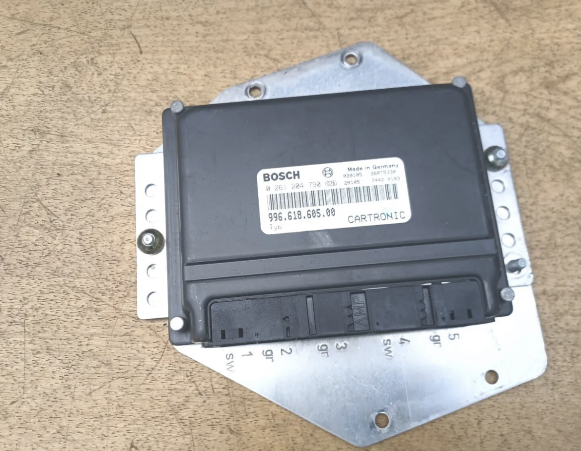

Good news that you’ve got the car moving.canadasconvert wrote: ↑Mon Jan 10, 2022 9:35 pm I'm working my way through my Porsche/Tesla conversion. The car is running on the road but I have two issues (for now)
First, when I turn the ignition on, all the dash lights flash and wont stop. All the functions work (lights, horn, wipers, windows, etc.) Is this a matter of clearing faults? I did remove the computer and then put it back in again. Any suggestions would be helpful.
The second item is to get the display working. I noticed in the April 27th road test post, it looks like you have the speedometer working. In a later post I think you said you were using the fuel gauge as a hi level battery monitor. Is this something do did with CANBUS? How?
You need to be more specific about the lights flashing. It sounds like you either have an alarm issue or the battery is flat or both. Please rule out these things first - can you lock and unlock the car with the key remote?
You do not need the Porsche cartronic module (the one that’s in the boot). However you will still require the body control module which is located under one of the seats.
The Speedo will work out of the box via the ABS system so no further input there.

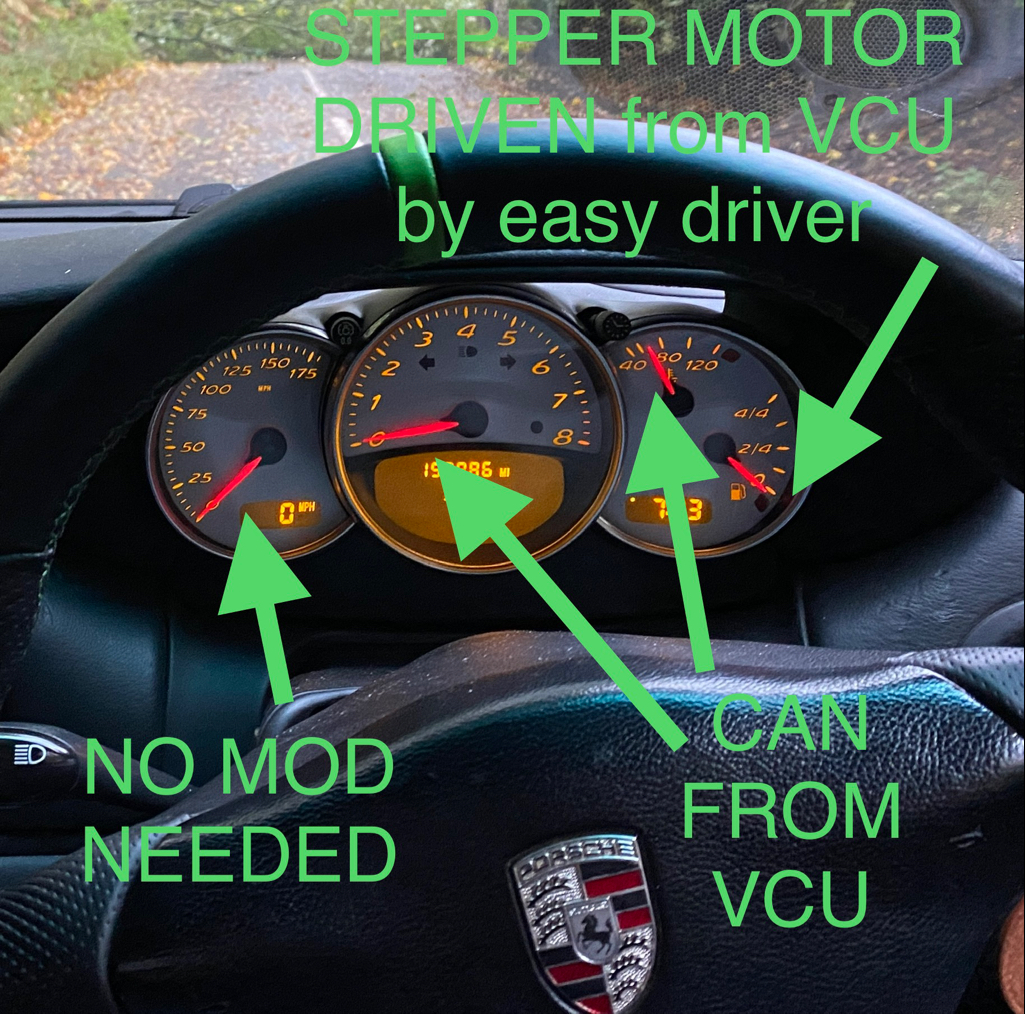

Gauge cluster and what the VCU controls:
I have the tach (amps) and temp gauge (inverter temp) working over CAN. They are CAN mapped from my drive unit.
The engine management light, oil light etc is also turned off over CAN from the same sketch. Likewise, the fuel gauge is powered by a retrofitted stepper motor and associated driver board.
Your best bet would be to see if Jon Volk has any mini VCUs left, buy one from him, then I’ll send you the sketch to do all of this.

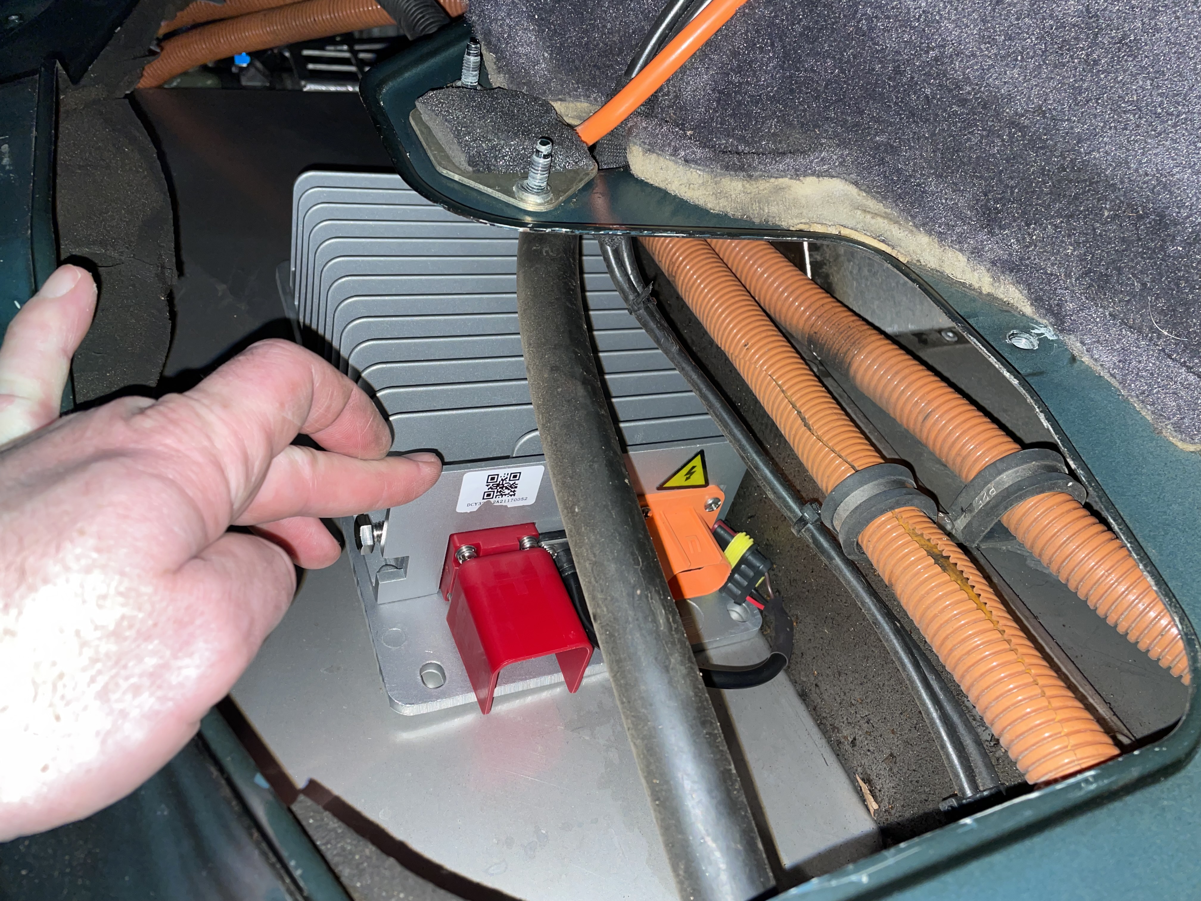

The biggest catastrophe was that my Chevy volt DCDC decided to let out the black smoke. I think it got a little damp during the winter months. I’ve since replaced it with an off-the-shelf IP67 rated unit (picture below) and relocated it nearer the HVJB for safety reasons. More seriously, when it ‘let go’, it sent a surge through the CAN BUS network taking out comms (CAN transceivers) to my VCU, ABS unit and gauge cluster. What joy!

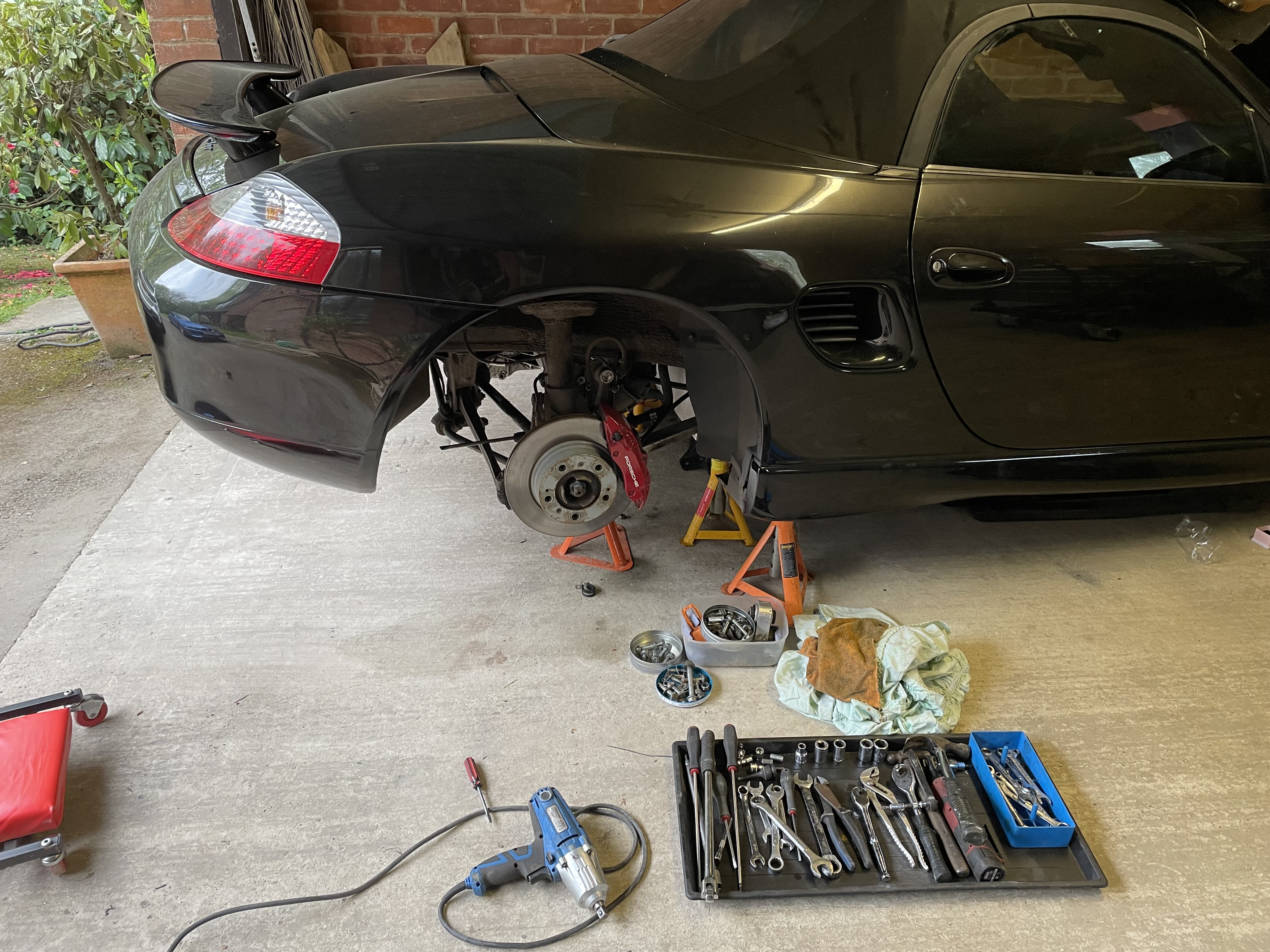

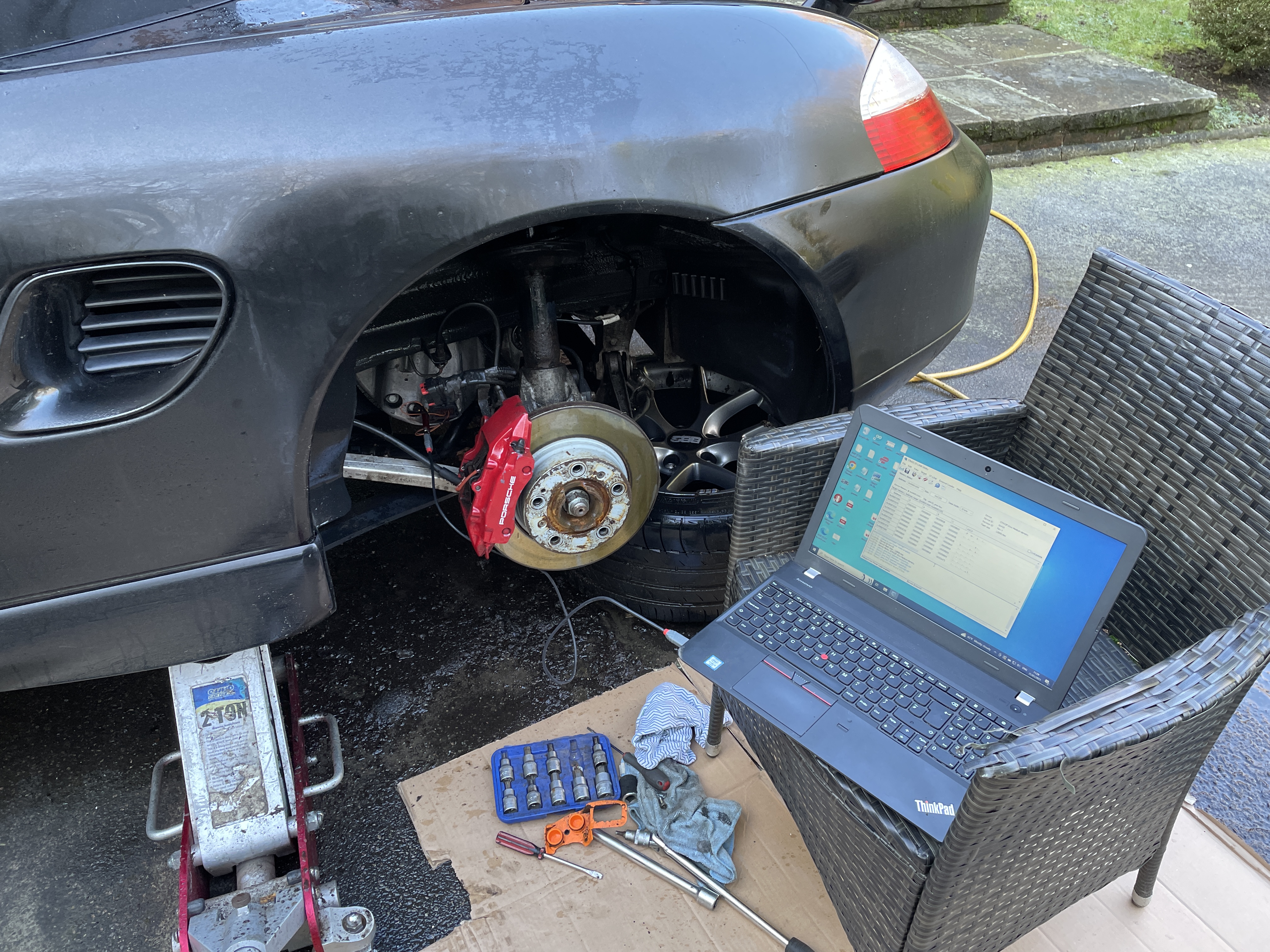

The next little project was to fit the spare drive unit that I’d recently refurbished. Thread here. All seemed good initially but as documented, the rotor coolant seal continued to leak and since then I’ve sleaved the seal contact surface as a preventative measure. I’ve also drilled a small hole in the encoder chamber to monitor / dump any future leakages overboard rather than allowing them into the motor.
The key to removing the LDU quickly is having all of the tools ready
So pleased that I used green loctite for the drive shaft bolts last time

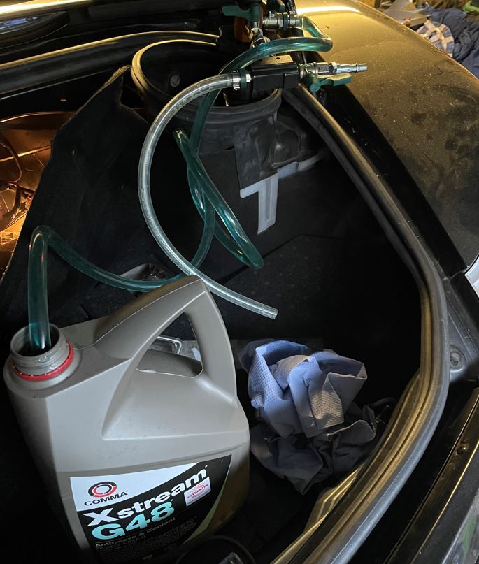

Vacuum bleeding the system

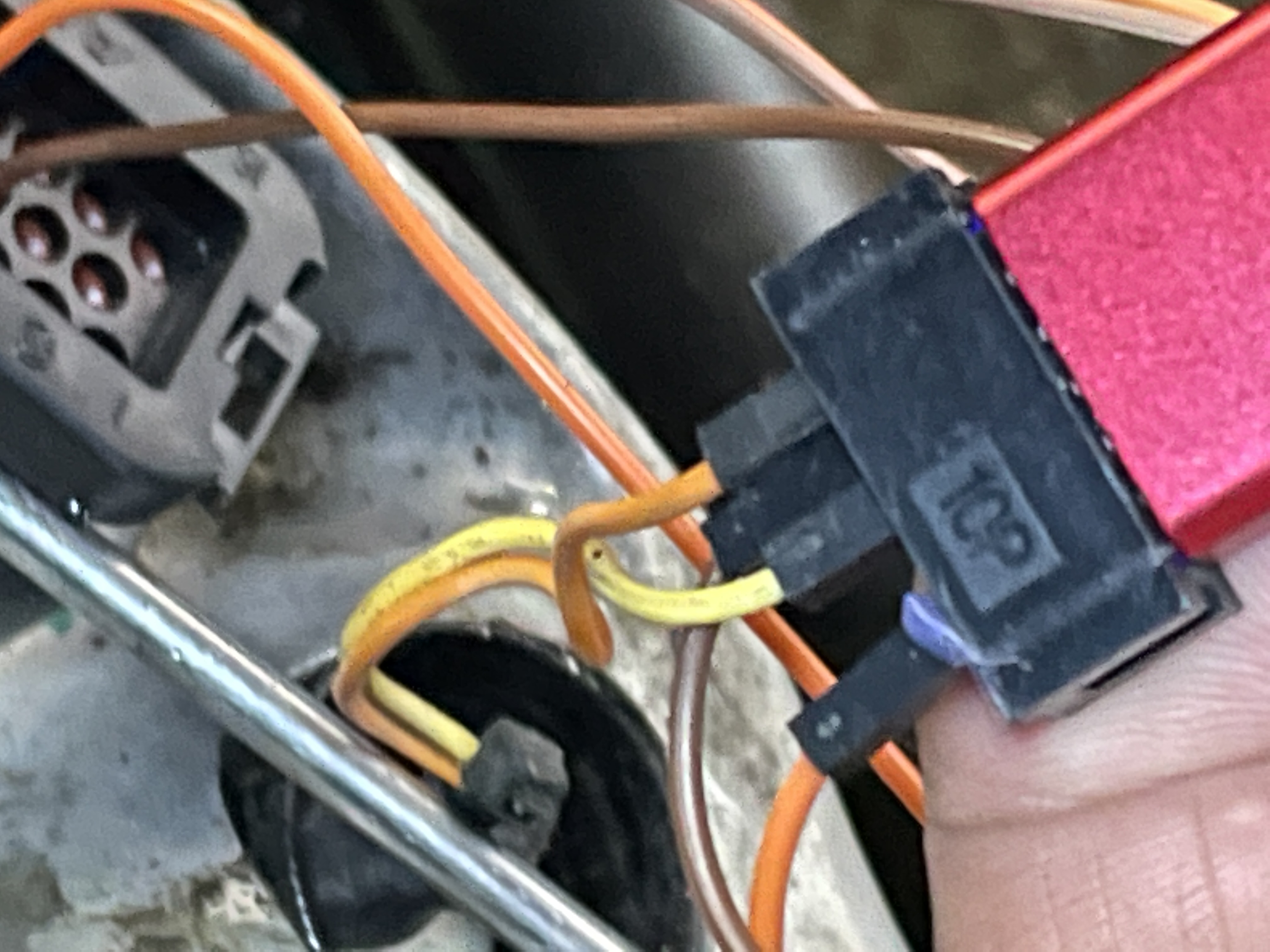

The next episode was that my e-pedal sensor which is original to the car, started to fail. It would exhibit pot readings high or lower than the according pedal travel. At little disconcerting to say the least. A replacement Porsche sensor and throttle recalibration fixed this issue.
So the car was back on the road, but because a quiet life would be far too simple, I thought; I know I’ll update the inverter firmware for fun…. Nope… Car off the road for another few weeks whilst I sorted this issue. It’s also meant the drive unit had to be pulled for the third time in a year to get access to the programming pins on the logic board to manually re-load the firmware with an St-Link. At the same time I took the opportunity to start with a fresh ESP8266 wifi module to mitigate futures issues.

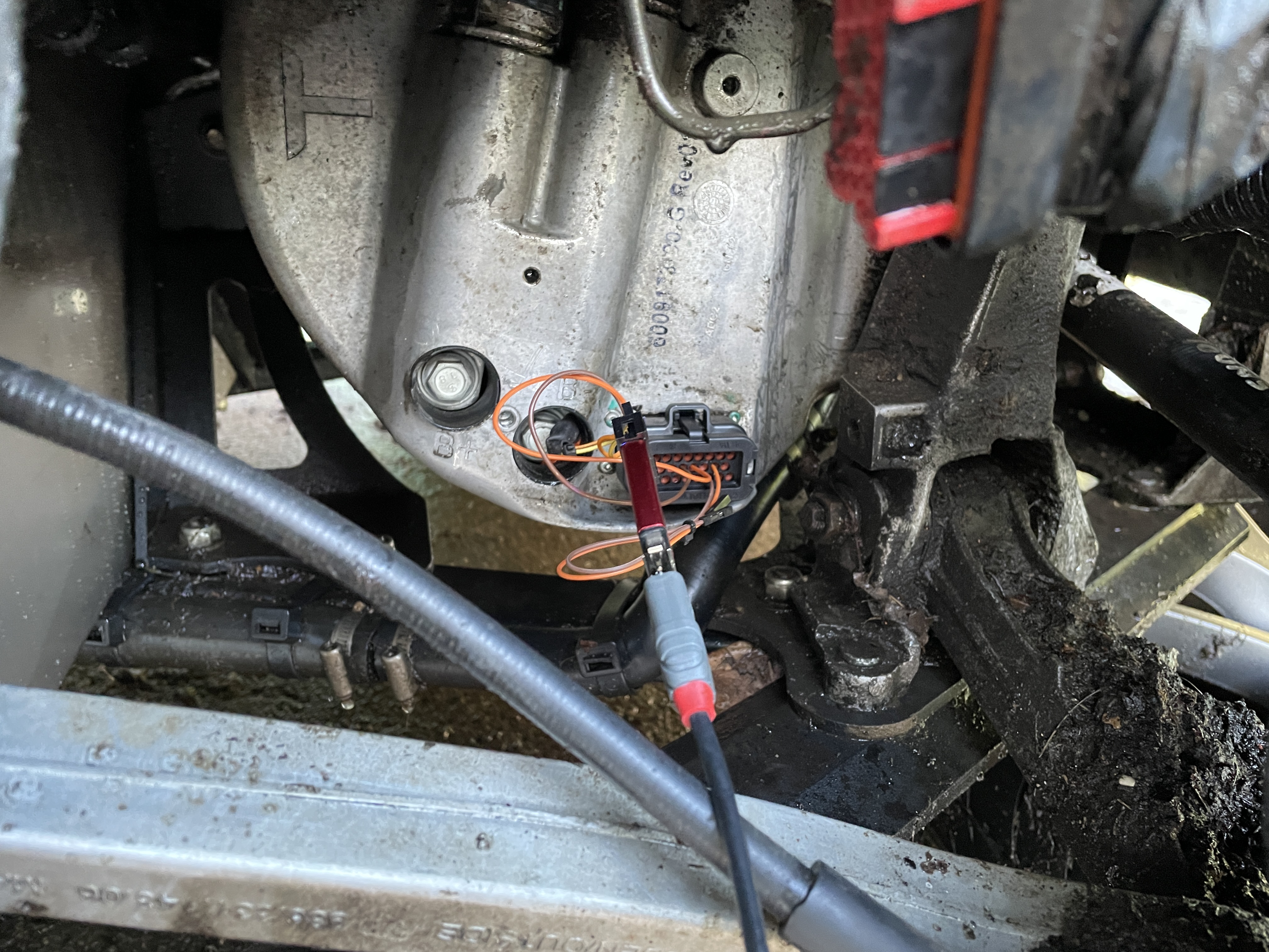

They say the first sign of madness is doing the same thing over and over and expecting different results…. Well, in the sprit of improving this situation for my future self, I’ve modified my logic board to bring physical programming connections to the outside world, therefore if the thing freezes mid-update again, I’ll be able to re-flash it via a hardwired ST-link connection with no drama – that’s the theory anyway.

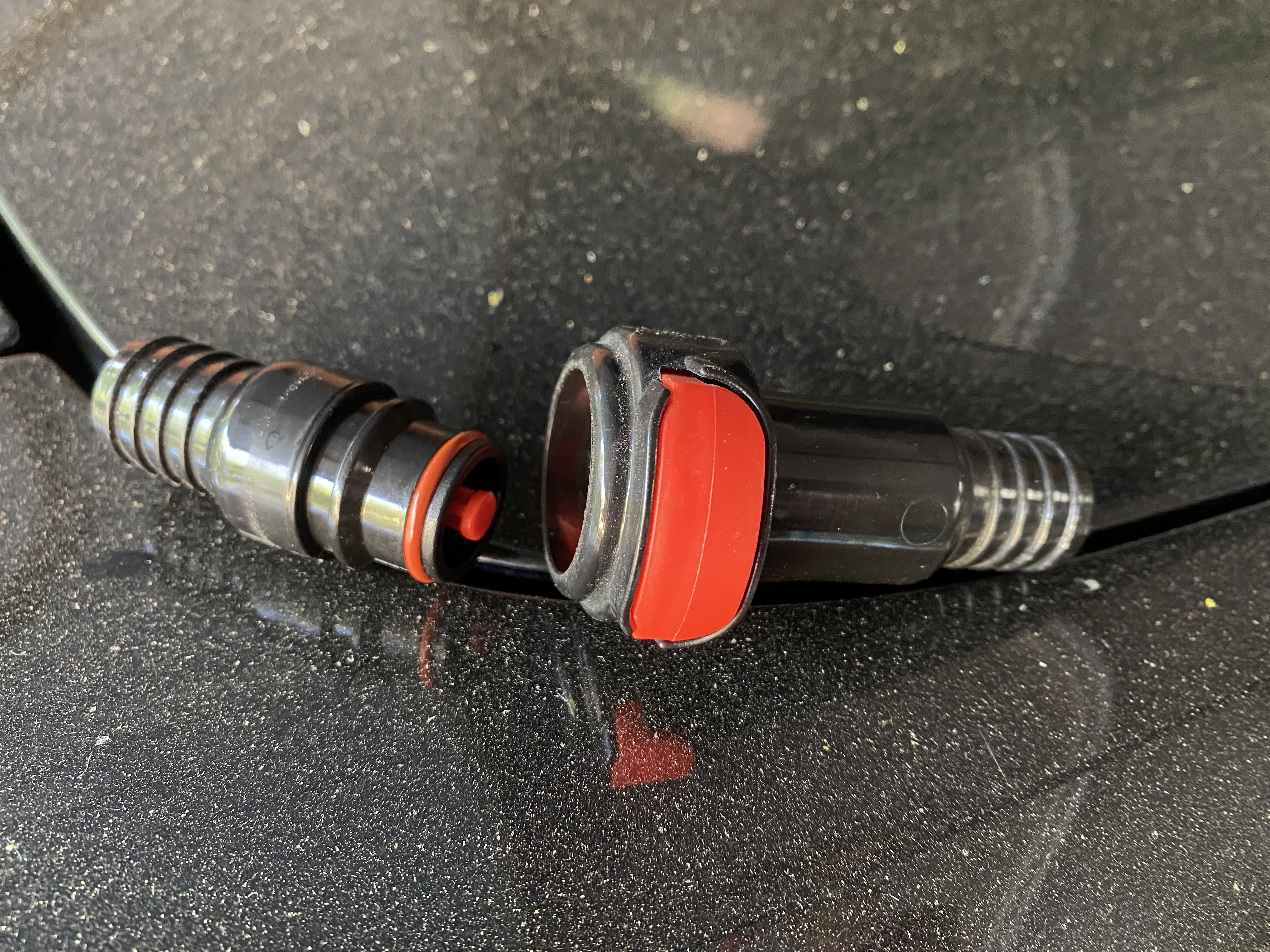

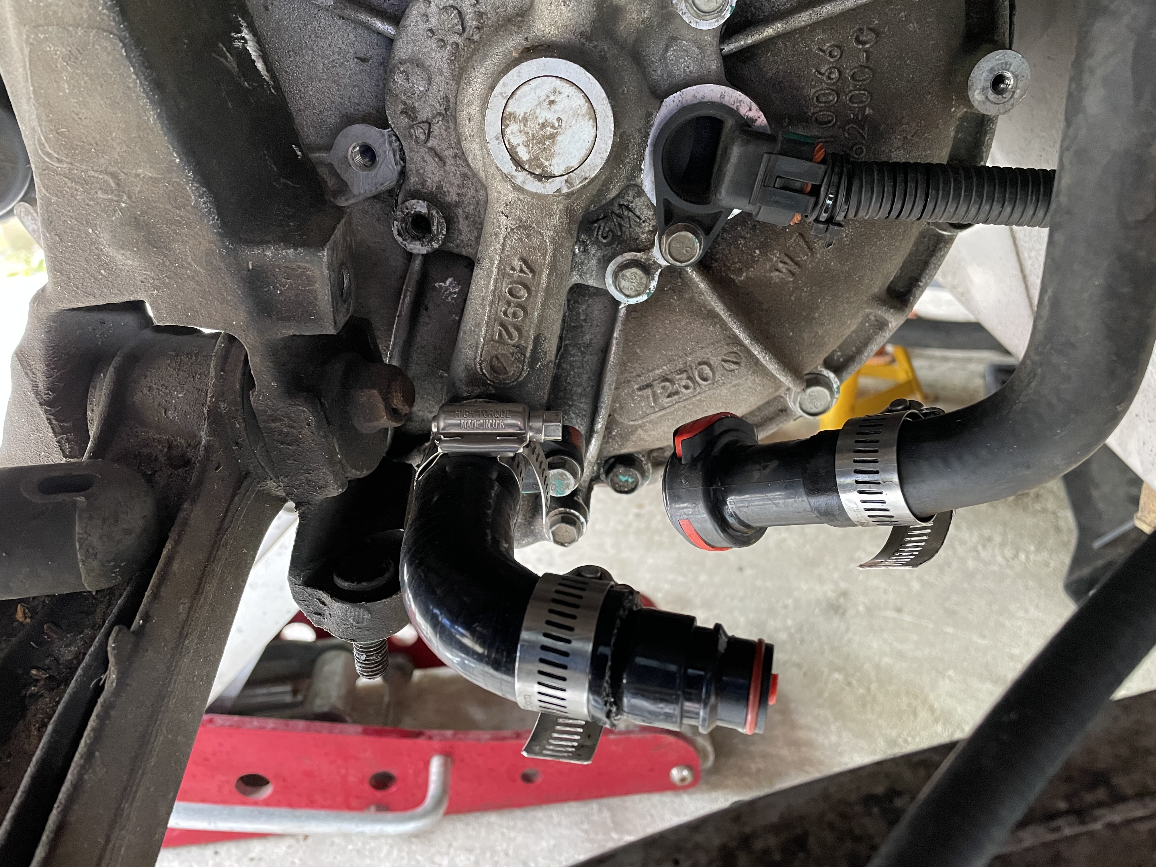

I’ve also fitted these rather nifty coolant quick release valves which mean the DU can be disconnected without letting air into the coolant system.

I NEED to know the part name/numbers for that coolant disconnect setup. I poorly designed my cooling system and bleeding it takes forever. This would solve some headaches!
- EV_Builder
- Posts: 1205
- Location: The Netherlands
- Been thanked: 37 times
Re: Porsche Boxster 986 Tesla conversion
oehh yeah that would be great to know indeed.

Not specific to this setup, be we'd been using vacuum coolant bleeders for years to obviate the need for "high point air bleeding". I think it was working on one of the low-hood Thunderbirds that pushed me into buying this tool.
Mine uses shop air (compressed air) to draw a vacuum on the cooling system via a venturi device. Any air pockets will have their pressure reduced to "almost" nothing in a few seconds. Then you stop creating/drawing a vacuum, switch a valve, and the bleeder allows coolant to be drawn from a reservoir (your coolant jug) into the low-pressure cooling system.
Works well. The hardest part of using it is flushing the tool of coolant and drying it before stowing it for next time. Since there's a YouTube vid on everything you can think of, let me see if I can find one . . .
I have an Airlift, like in that vid.
It looks like Boxster is using one as well:

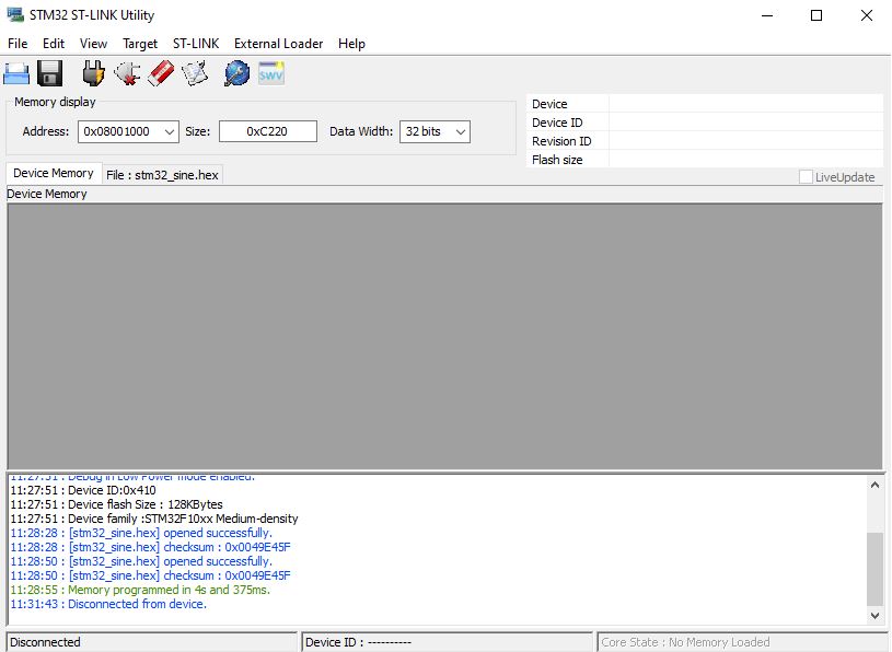

The LDU I currently have in the car is now running the SKF coolant manifold seal (on a SKF Speedi sleeve). At the time of writing I’ve put about 2500 miles on it and cannot detect a single drop of coolant inside the encoder chamber. Fingers crossed it lasts – I’d happily renew the seal every 15k or so miles if necessary.

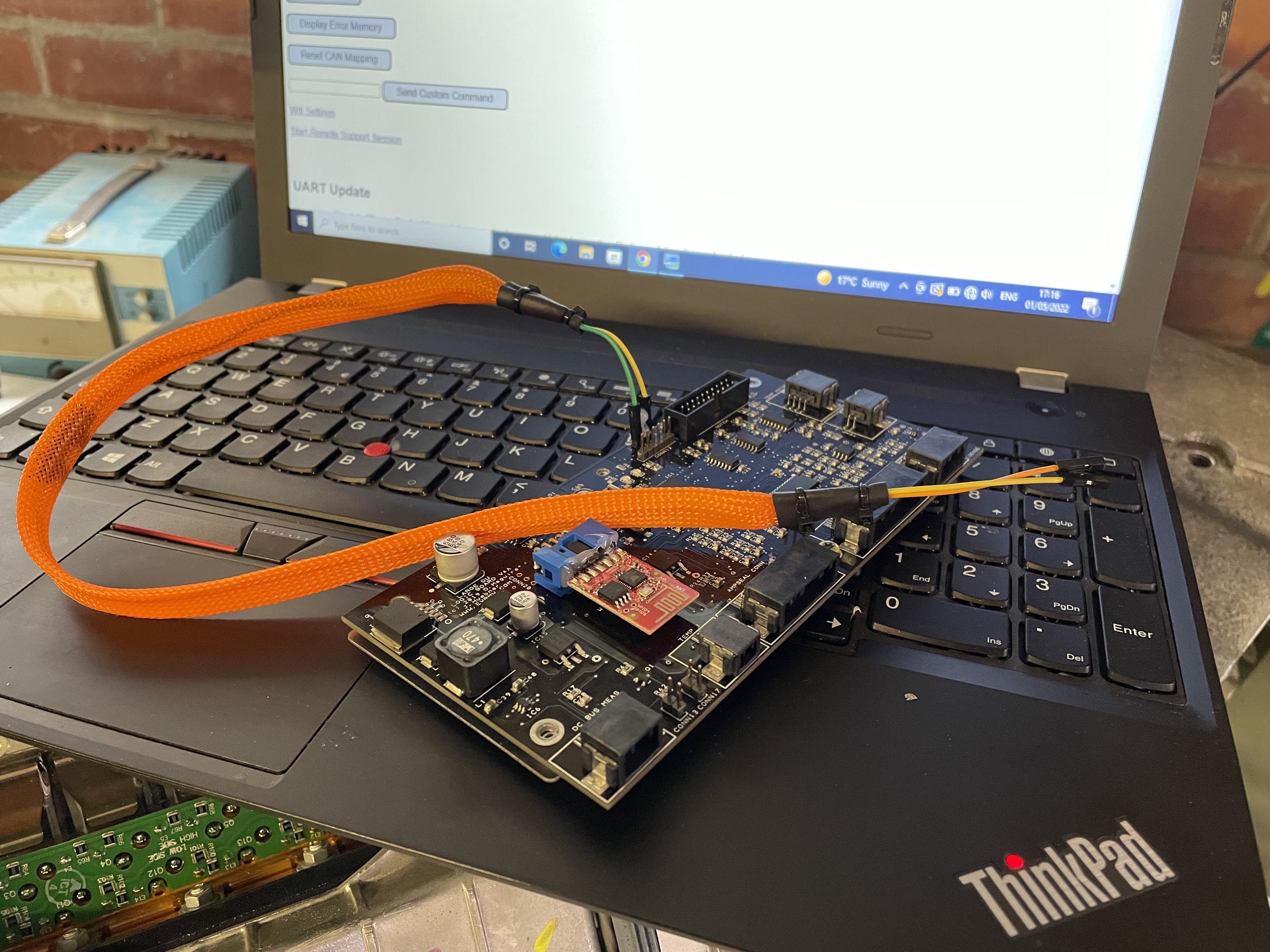

In other news, some months ago I managed to replace one the Inverter gate drive PCB IGBT driver chips in a spare drive unit. You can read about that here and see the drive unit running here

Sorry, one other question: Do you need the ECU/DME for the engine attached/connected?
- Boxster EV
- Posts: 489
- Location: UK
- Has thanked: 57 times
- Been thanked: 50 times
Not sure if I understand your question.
You do not need the original ECU for the conversion. This is no longer required:

I can only speak about this car (a Dec 2000 986). Post conversion, all functionality of the car is retained without the Bosch ICE motronic engine brain pictured above.EV_Builder wrote: ↑Fri Dec 09, 2022 9:57 am Well if the car is first in it's kind / class then the engine mcy might reveal allot of canbus signals. So I'm not too sure about not needing it.
It's needed for reverse engineering purposes and not for functional purposes.

Received a PM regarding code for the gauges. Here it is and I hope it helps others:
#include <FlexCAN.h>
#include "canmessage.h"
CAN_message_t outMsg;
CAN_message_t inMsg;
#define LSB 0
#define MSB 1
#define UNSIGNED 0
#define SIGNED 1
//Vital statistics
int16_t InverterTemp = 0;
int16_t MotorTemp = 0;
int16_t BatteryTemp = 0;
int16_t MotorSpeed = 0;
int packCurrent = 0;
int packVoltage = 0;
int tempguageval = 0;
//Fuel Guage
unsigned long gaugeresettime = 0;
int fuel_direction_pin = 15;
int fuel_fuel_step_pin = 13;
int full_sweep_steps = 385;
int desiredposition = 0;
int actualposition = 0;
int SOC = 0;
//Chevy DCDC converter
const int dcdcTargetVoltage = 14;
//Cyclic Timing Variables
elapsedMillis ms500Timer;
elapsedMillis min3Timer;
elapsedMillis ms10Timer;
const int ms10 = 10;
const int ms500 = 500;
const int min3 = 180000;
void setup() {
Can0.begin(500000);
CAN_filter_t allPassFilter;
allPassFilter.id = 0;
allPassFilter.ext = 1;
allPassFilter.rtr = 0;
for (int filterNum = 4; filterNum < 16; filterNum++) {Can0.setFilter(allPassFilter, filterNum);}
Serial.begin(115200);
Serial.println("Starting up!");
pinMode(fuel_direction_pin, OUTPUT);
pinMode(fuel_fuel_step_pin, OUTPUT);
//Ram needle against endstop to calibrate
digitalWrite(fuel_direction_pin, HIGH);
for (int i = 0; i <= full_sweep_steps*3; i++) {
digitalWrite(fuel_fuel_step_pin, HIGH);
delay(1);
digitalWrite(fuel_fuel_step_pin, LOW);
void loop() {
while (Can0.available()){canread();}
if(ms10Timer >= ms10){ //Every 10ms
ms10Timer = ms10Timer - ms10;
sendRPMgauge();
sendTempgauge();
sendMILlight();
if(ms500Timer >= ms500){ //Every 500ms
ms500Timer = ms500Timer - ms500;
movefuelguageneedle();
sendDCDCcommand();
printStats();
if(min3Timer >= min3){ //Every 3 minutes
//Ram gauge against endstop every
//3 minutes as holding force is low
min3Timer = min3Timer - min3;
gaugeReset();
void sendRPMgauge(){
outMsg.id = 0x280;
outMsg.len = 8;
outMsg.ext = 0;
for (int i = 0; i < outMsg.len; i++) {outMsg.buf[i] = 0x00;}
outMsg.buf[2] = lowByte(MotorSpeed *4);
outMsg.buf[3] = highByte(MotorSpeed *4);
Can0.write(outMsg);
void sendTempgauge(){
outMsg.id = 0x289;
outMsg.len = 8;
outMsg.ext = 0;
outMsg.buf[1] = (2 * 1.655 * tempguageval) + 48;
Can0.write(outMsg);
void sendMILlight(){
//Stop sending this frame to show engine light
outMsg.id = 0x4E0;
outMsg.len = 8;
outMsg.ext = 0;
Can0.write(outMsg);
void sendDCDCcommand(){
outMsg.id = 0x1D4;
outMsg.len = 2;
outMsg.ext = 0;
outMsg.buf[0] = 0xA0;
outMsg.buf[1] = dcdcTargetVoltage * 1.27;
Can0.write(outMsg);
void canread(){
Can0.read(inMsg);
switch (inMsg.id){
case 0x126:
InverterTemp = CAN_decode(&inMsg, 32, 16, LSB, SIGNED, 1, 0);
tempguageval = map(InverterTemp, -5, 50, 0, 55); //Map temperature gauge
MotorTemp = CAN_decode(&inMsg, 48, 16, LSB, SIGNED, 1, 0); //Motor temp current not used as inverter hotter
break;
case 0x125:
packVoltage = CAN_decode(&inMsg, 16, 16, LSB, SIGNED, 0.1, 0);
packCurrent = CAN_decode(&inMsg, 0, 16, LSB, SIGNED, 0.1, 0);
packCurrent = abs(packCurrent); //Make current always positive
packCurrent = packCurrent * 1.6; //Correction for tesla du DC current
SOC = map(packVoltage, 300, 395, 0, 100); //Rudimentary map of SOC to voltage
SOC = constrain(SOC, 0, 100); //Prevent out of bounds
desiredposition = map(SOC, 0, 100, full_sweep_steps, 0); //Update needles desired stepper position
MotorSpeed = map(packCurrent, 0, 400, 0, 4000); //Map current to motorspeed aka gauge revs
break;
default:
break;
void printStats(){
Serial.println();
Serial.print("Inverter Temp : ");
Serial.print(InverterTemp);
Serial.println("˚C");
Serial.print("Motor Temp : ");
Serial.print(MotorTemp);
Serial.print("Battery Temp : ");
Serial.print(BatteryTemp);
Serial.print("Motor Speed : ");
Serial.print(MotorSpeed);
Serial.println("rpm");
Serial.print("Pack Current: ");
Serial.print(packCurrent);
Serial.println("A");
Serial.print("Pack Voltage: ");
Serial.print(packVoltage);
Serial.println("V");
Serial.print("Battery SOC : ");
Serial.print(SOC);
Serial.println("%");
void gaugeReset(){
int amountofstepstorewind = map(SOC, 0, 100, full_sweep_steps, 0);
amountofstepstorewind = amountofstepstorewind + 50;
for (int i = 0; i <= amountofstepstorewind; i++) {
delay(1);
//let movefuelguageneedle know it has been reset
actualposition = 0;
Serial.println(amountofstepstorewind);
void movefuelguageneedle(){
//Need to move clockwise
if(desiredposition > actualposition){
digitalWrite(fuel_direction_pin, LOW);
int num_steps_calculated = desiredposition - actualposition;
//Serial.print(num_steps_calculated);
//Serial.println(" steps moved clockwise");
for (int i = 0; i <= num_steps_calculated; i++) {
delay(1);
actualposition = desiredposition; //Move has been completed!
//Need to move anti-clockwise
if(desiredposition < actualposition){
int num_steps_calculated = actualposition - desiredposition;
//Serial.println(" steps moved anti-clockwise");
delay(1);
}- Boxster EV

I have been running firmware version 5.14.R for nearly a year. This version had a couple issues in my application. I would get an occasional current spike (causing an overcurrent event) when gently coming off throttle to regen (OC never happened when the motor was under full load). To make the car usable I adjusted brknom, regenramp and regenrampstr to very mild settings to prevent this happening however it made the car feel lethargic under some conditions.
Today I upgraded the firmware to sine 5.20.R using the hex file and STM programming application connected directly to the board (I don't like doing OTA firmware updates). The update went smoothly and I've just put about 30 miles on the car. Initial impressions are that things are much smoother when on and off throttle, in fact, anecdotally everything seems smoother. I've reverted the above regen settings back to normal so I'll monitor whether my spurious OC event returns - so far so good and very pleased.
Few pictures of the filthy car and process:
