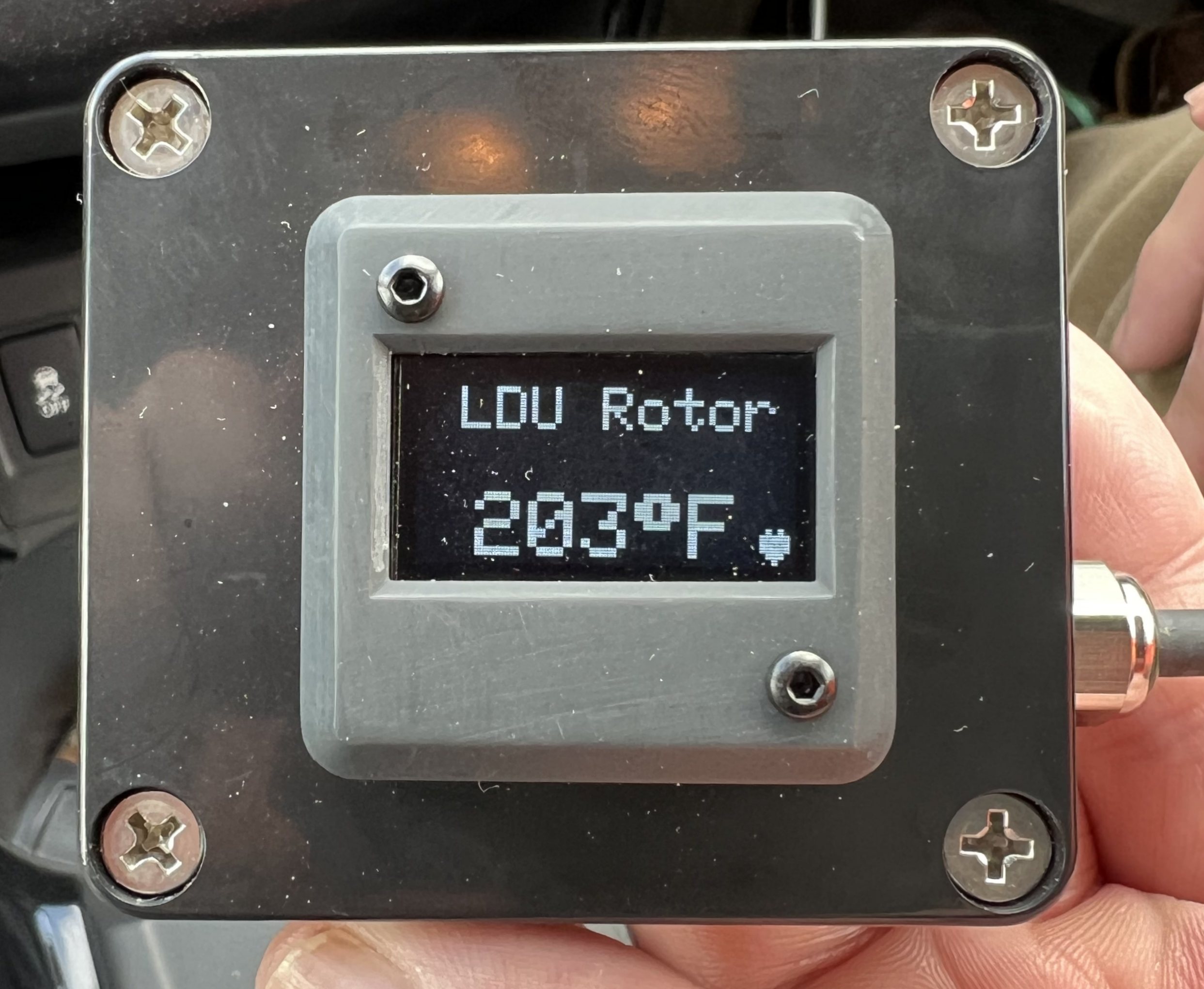

Bit of crossposting: coolant manifold plug of 6061:
https://www.myrav4ev.com/threads/anothe ... post-30941
Teaser:
Rotor temperature sensor/display:
https://teslamotorsclub.com/tmc/posts/8230849/
Teaser:
Teaser:
Teaser:

LDU Rotor Temp Monitor update
Last night, I got a first run in with the temp monitor working. It's still a lash-up, things taped down to the console, running off a power tool battery, etc., but real readings. Summary: the highest reading I saw on a 30 mi. drive was 182°F (83°C).
At rest after sitting all night:
Back home in my driveway after 30 mi.:

Have you noticed any adverse effects of not having coolant running through the rotor? I have purchase all the parts to replace my failed seal and add a drain hole, but I am leaning towards buying the REVOLT Coolant Delete product and eliminating the problem altogether. Any comments?
- asavage
- Posts: 352
- Has thanked: 307 times
- Been thanked: 111 times
I have around 400 miles on my RAV4 EV (which is not a Model S, but close) since I went dry rotor; I have seen 203°F on a 45 mile highway drive in 60°F ambient. It drives the same. So far, so good.
