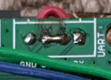

I should probably mention, because it's not obvious. The way the pins happened to line up, the serial RX and TX on the CAN board become the +3v3 and GND supplies to the display. These pins are shorted to the supply as shown, and just left floating by the MCU.

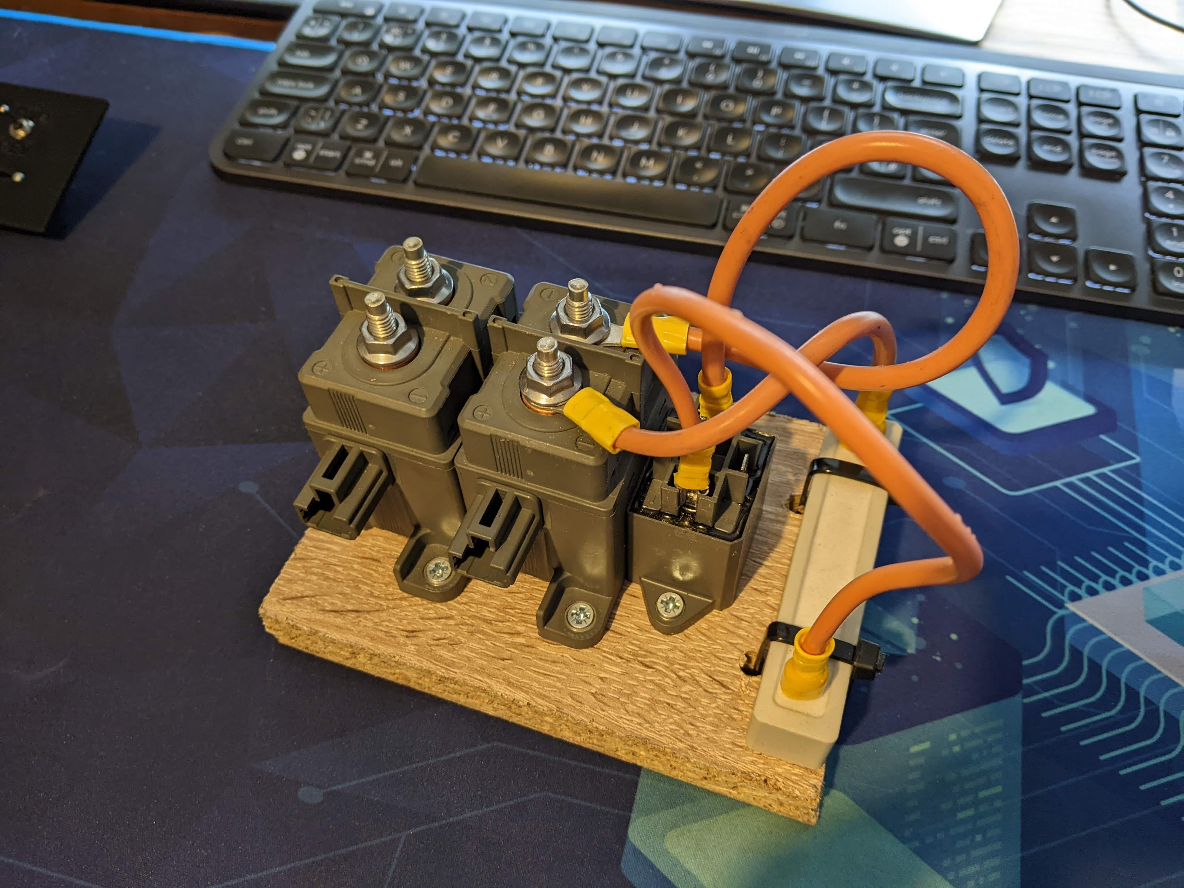

- 7yatna
- Posts: 85
- Joined: Wed Jul 06, 2022 2:49 am
- Location: Irvine, CA
- Has thanked: 6 times
- Been thanked: 17 times
Re: VX220 with Tesla SDU
Hi Catphish,
Yes i`m aware of the trip mode and flashing with HV voltage on.
i have designed my system that it requires about 3 different stages of contactors to close after the manual switch to energize the motor.
i will use your parameters and will adjust to my system.
still need about a week or two before test driving. finalizing other things but we do have a spinning system

I always use a full set of contactors for bench testing, and I control them automatically, exactly the same way as in the vehicle. Is there a reason you don't want to do that?espriev wrote: ↑Fri Feb 03, 2023 4:08 pm Also, is there anything you can suggest for the initial test bed set-up?
As I understand it, under normal operating conditions the O/I controls the pre-charge and main contactors, but for low motor voltage testing the precharge contactor must be manually operated, so run the coil GND to a switch to engage it (2nd after connecting +12 VDC to pin 13)?
