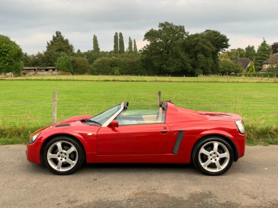

I'd like to begin a thread here to document my project, a 2001 Vahxuall VX220, which I hope to modify with a Tesla Model S Rear Small Drive Unit. I've been rambling about this project on the DiyElectricCar forum, but I wanted to record a more concise version here.

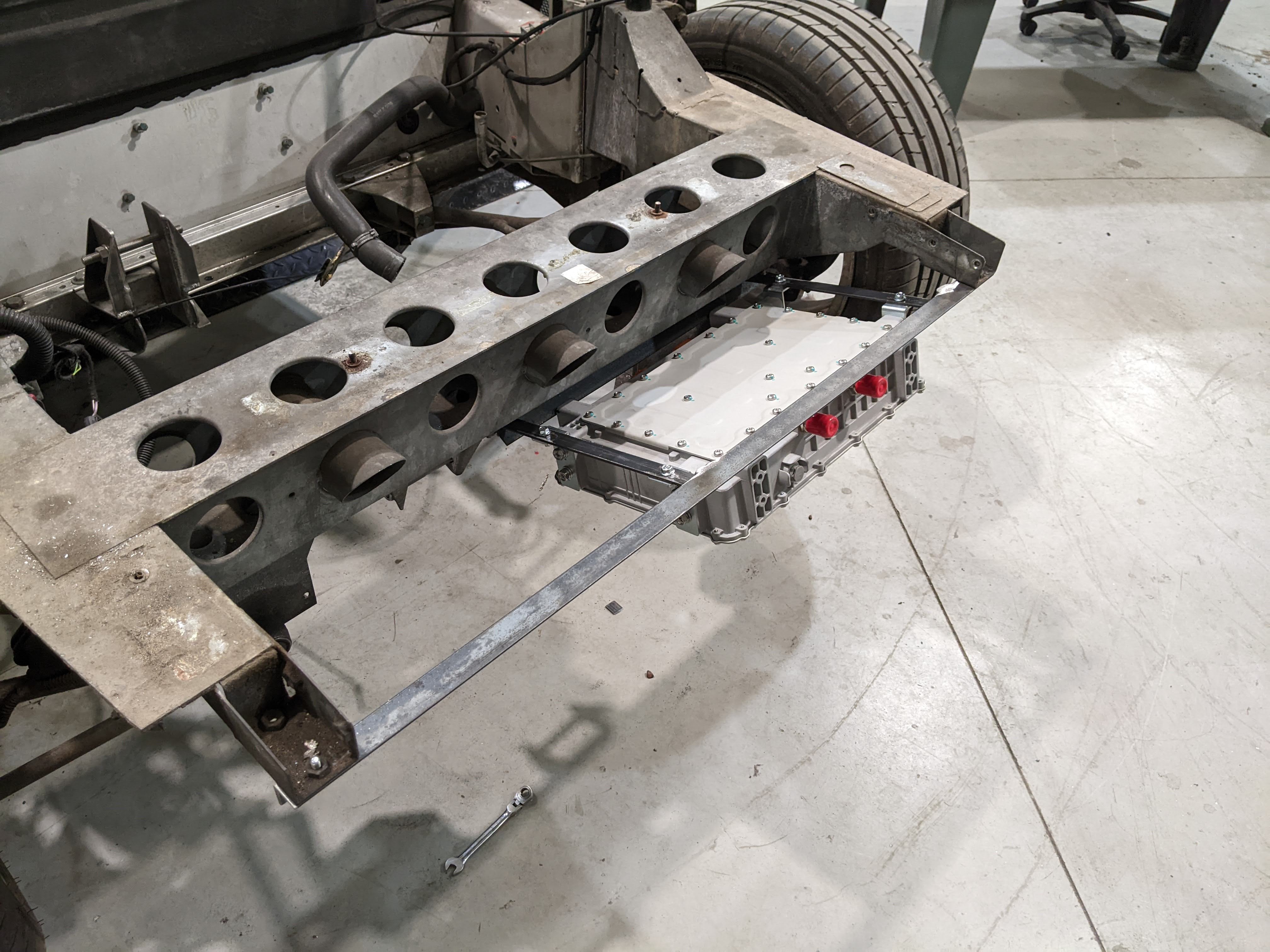

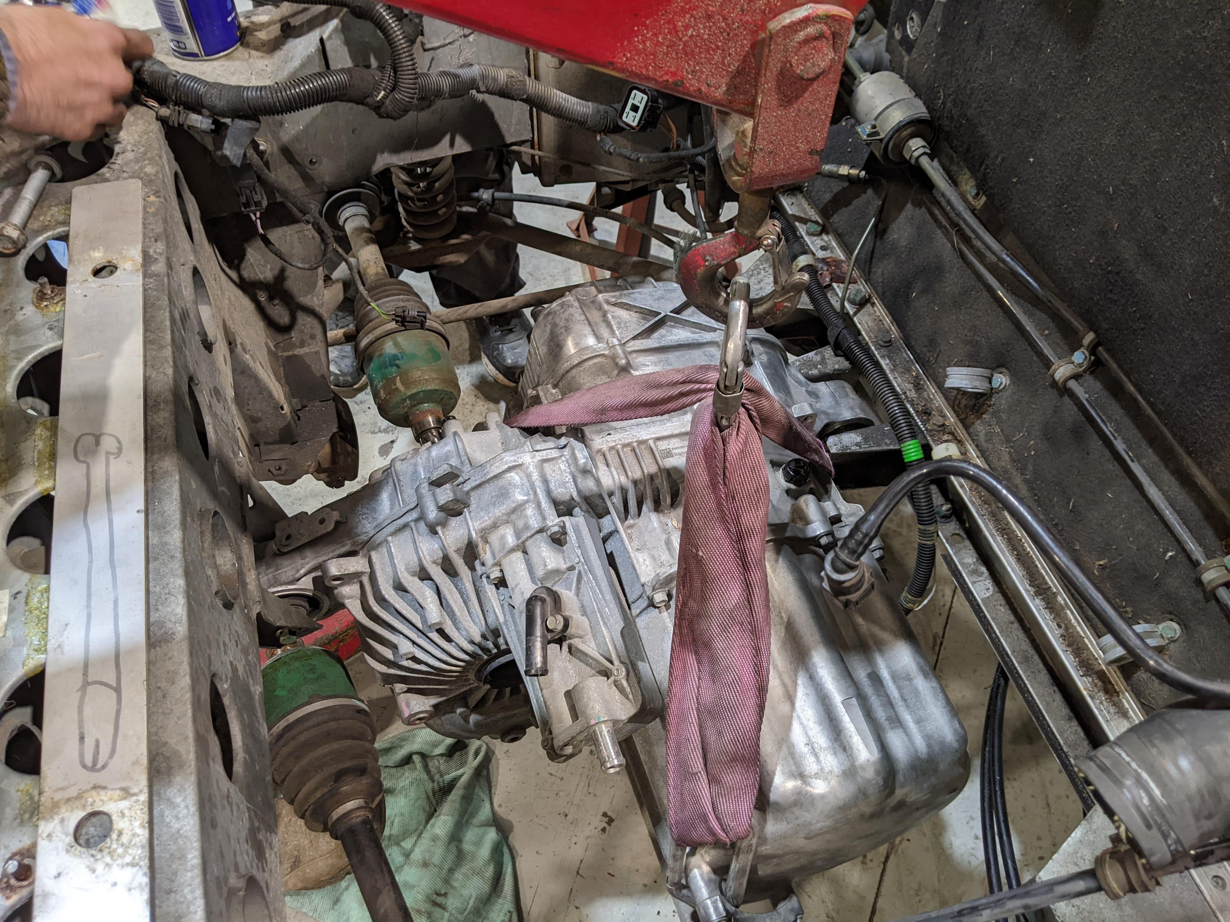

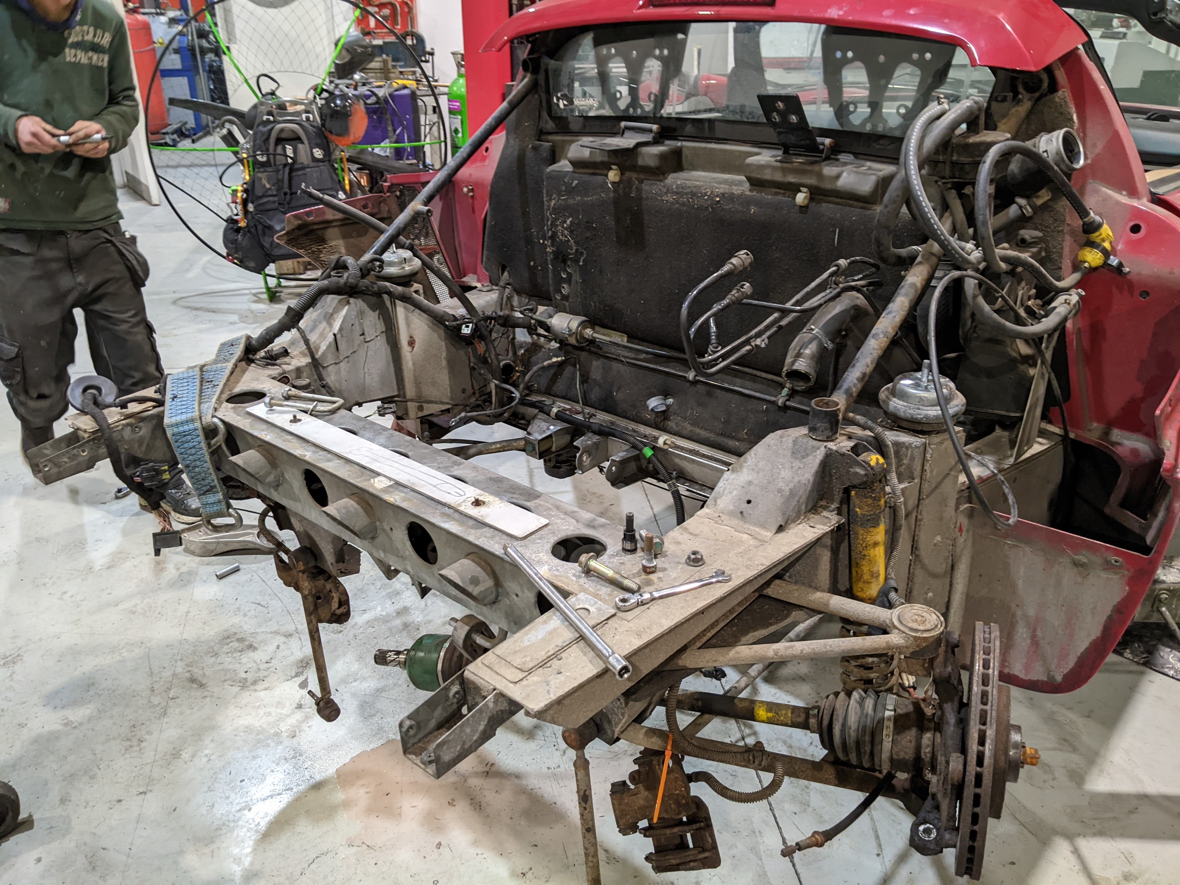

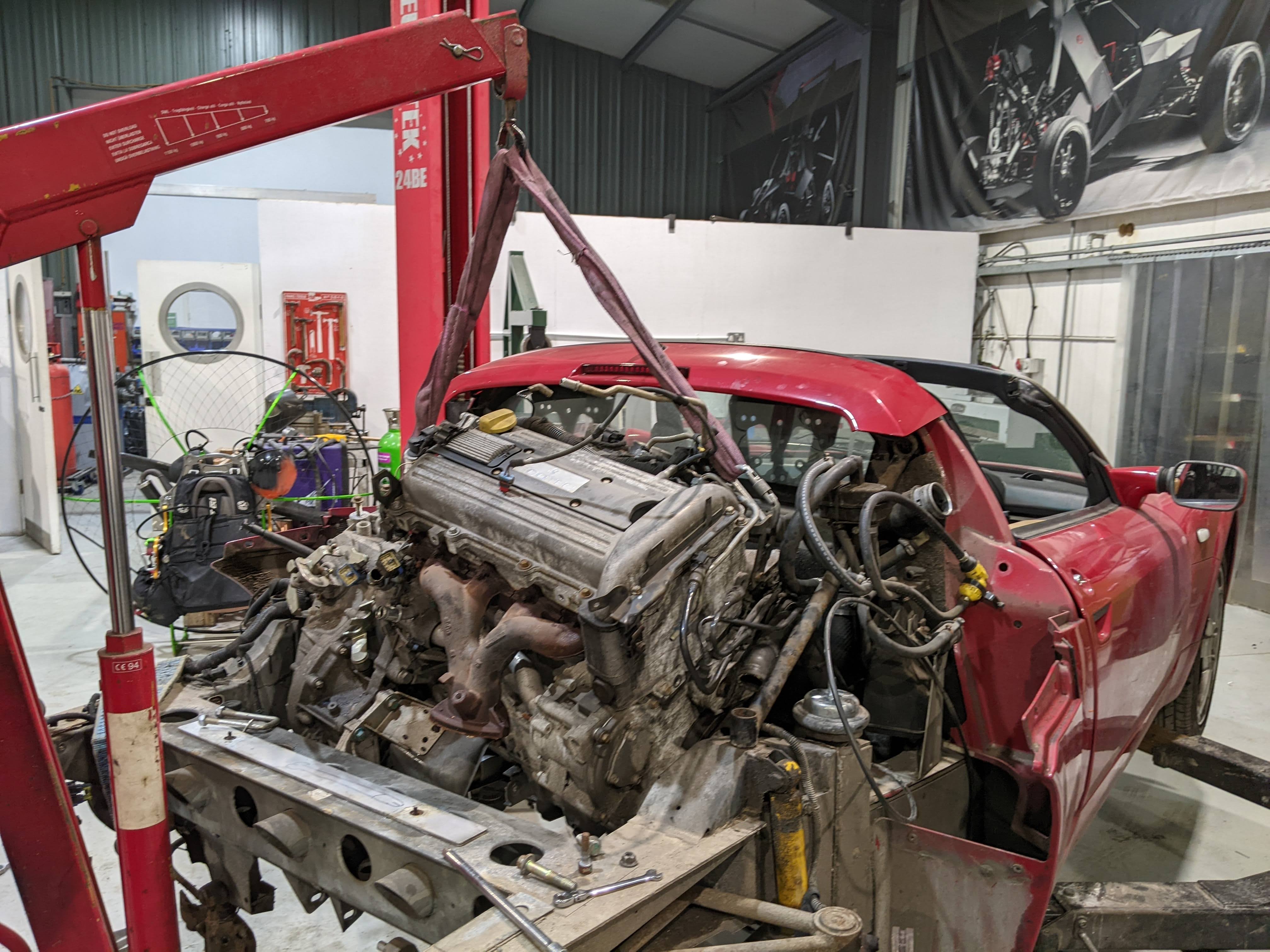

Today I was able to remove the engine from the VX220 and offer up the Tesla SDU! Looks very promising so far. Still lots of disassembly and measuring to do before I can commit to a battery pack layout though. One key point is that is is almost essential that the SDU run in reverse, so I will need a solution for oil pumping.

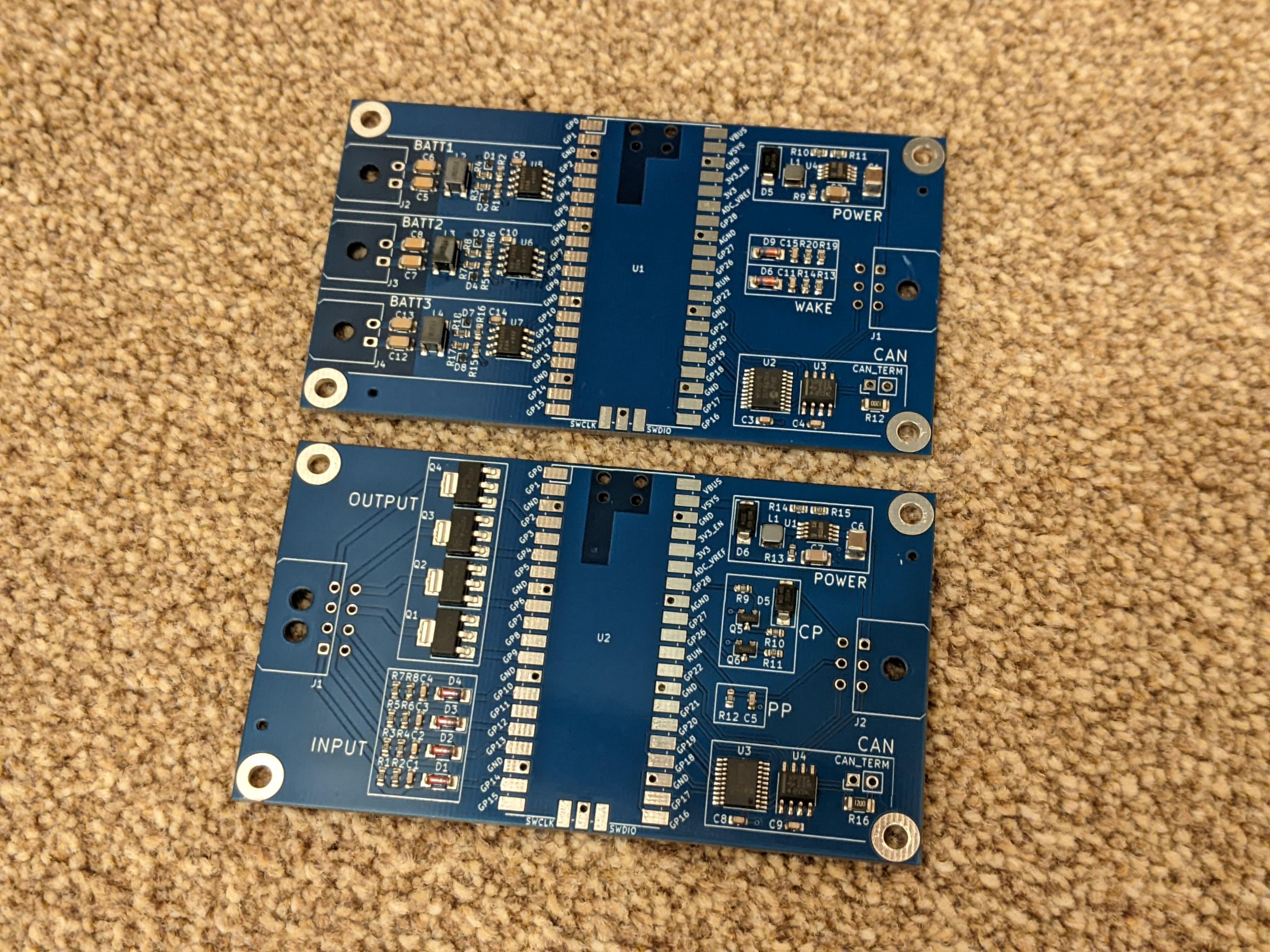

Version 3 my BMS master and my charge controller boards also arrived today, so I will be testing these and hopefully finishing the software in the next few days :idea:

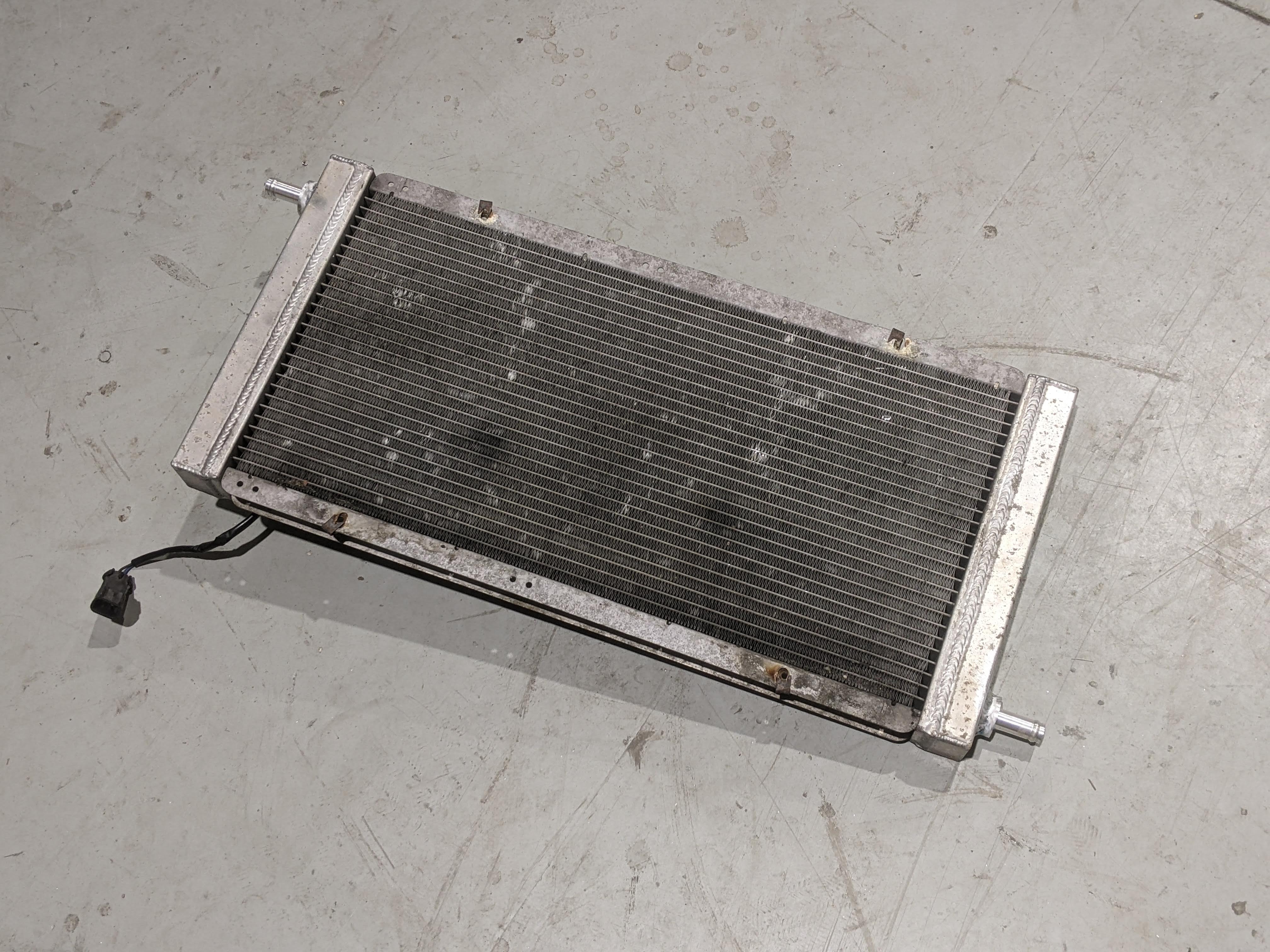

Things are going well (if a little slowly) thanks! The following is complete:
* Modified SDU to run in reverse
* Mounted SDU in car
* Designed and fabricated battery box - final assembly in progress...
* Bought all necessary electronics and connectors

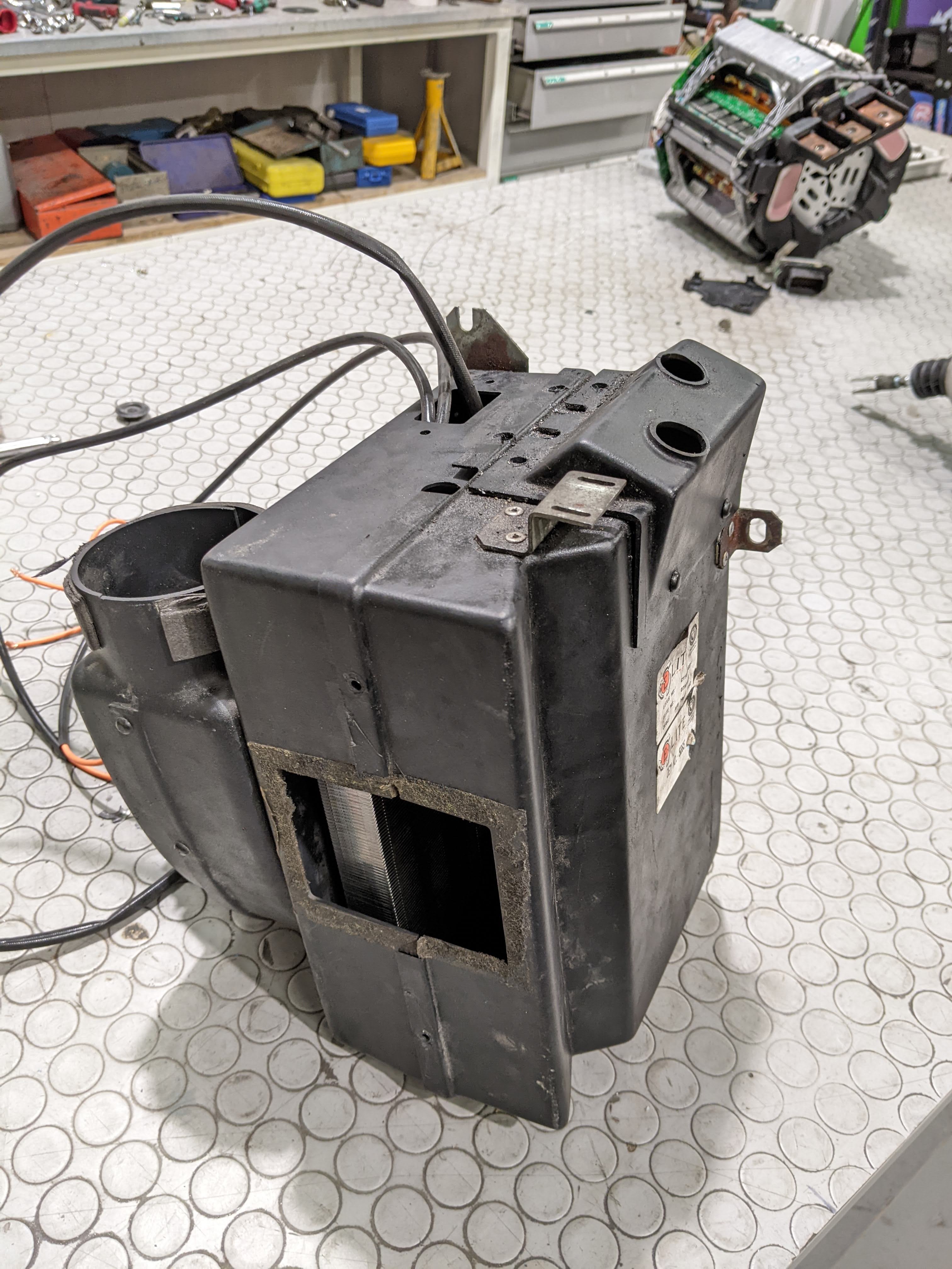

* Modified cabin heater with high voltage PTC element
* Modified OEM radiator with 16mm pipe connectors
* Removed unnecessary components - clutch, gearstick

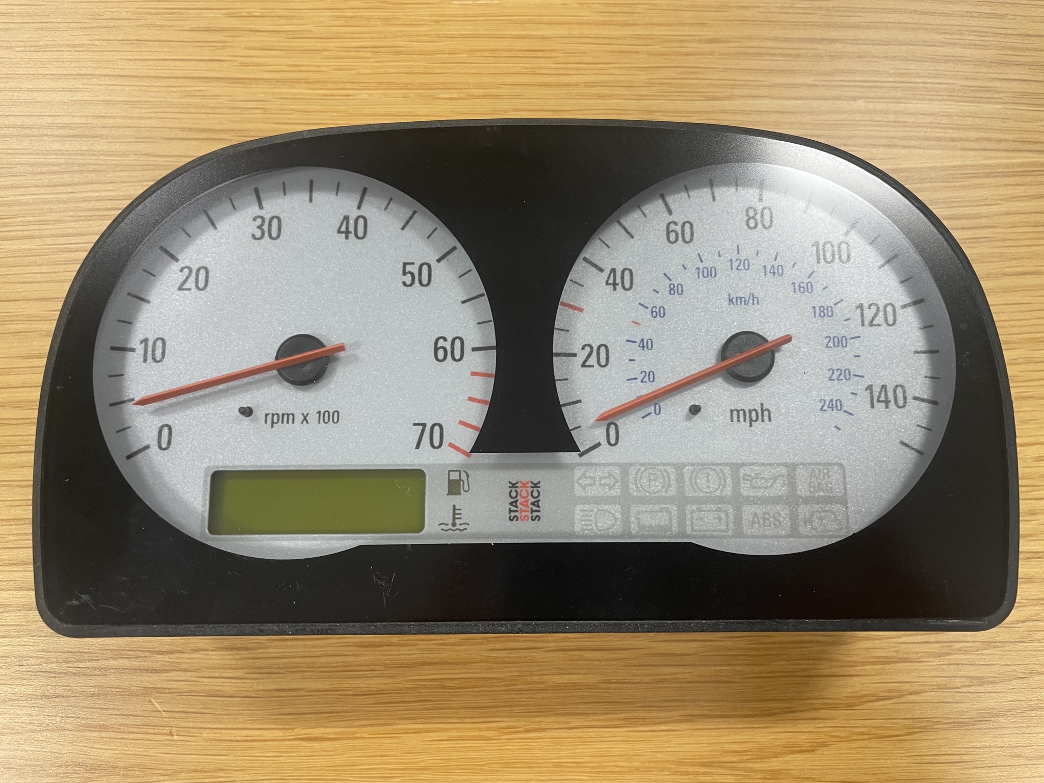

* Integrate gauge cluster

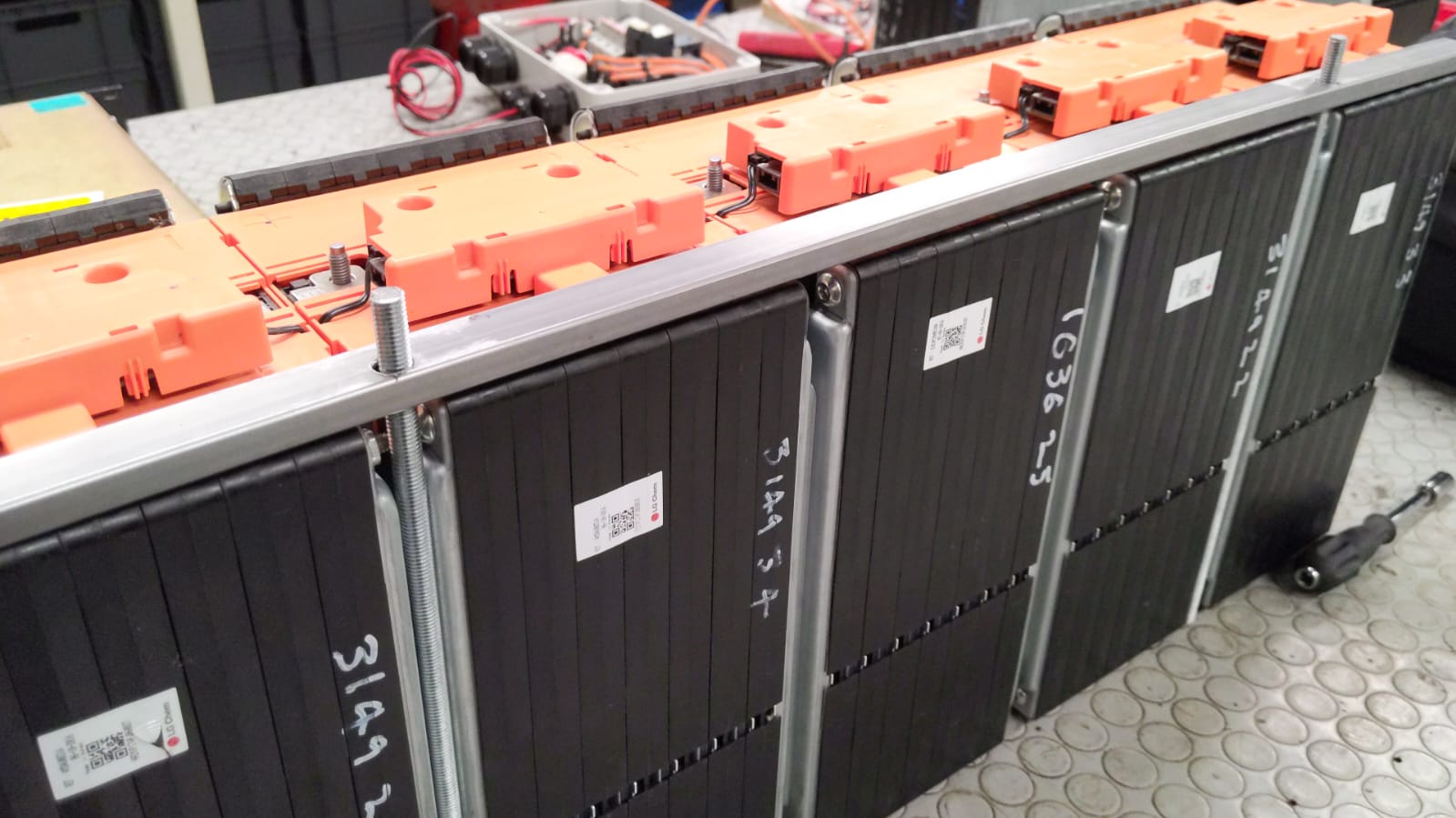

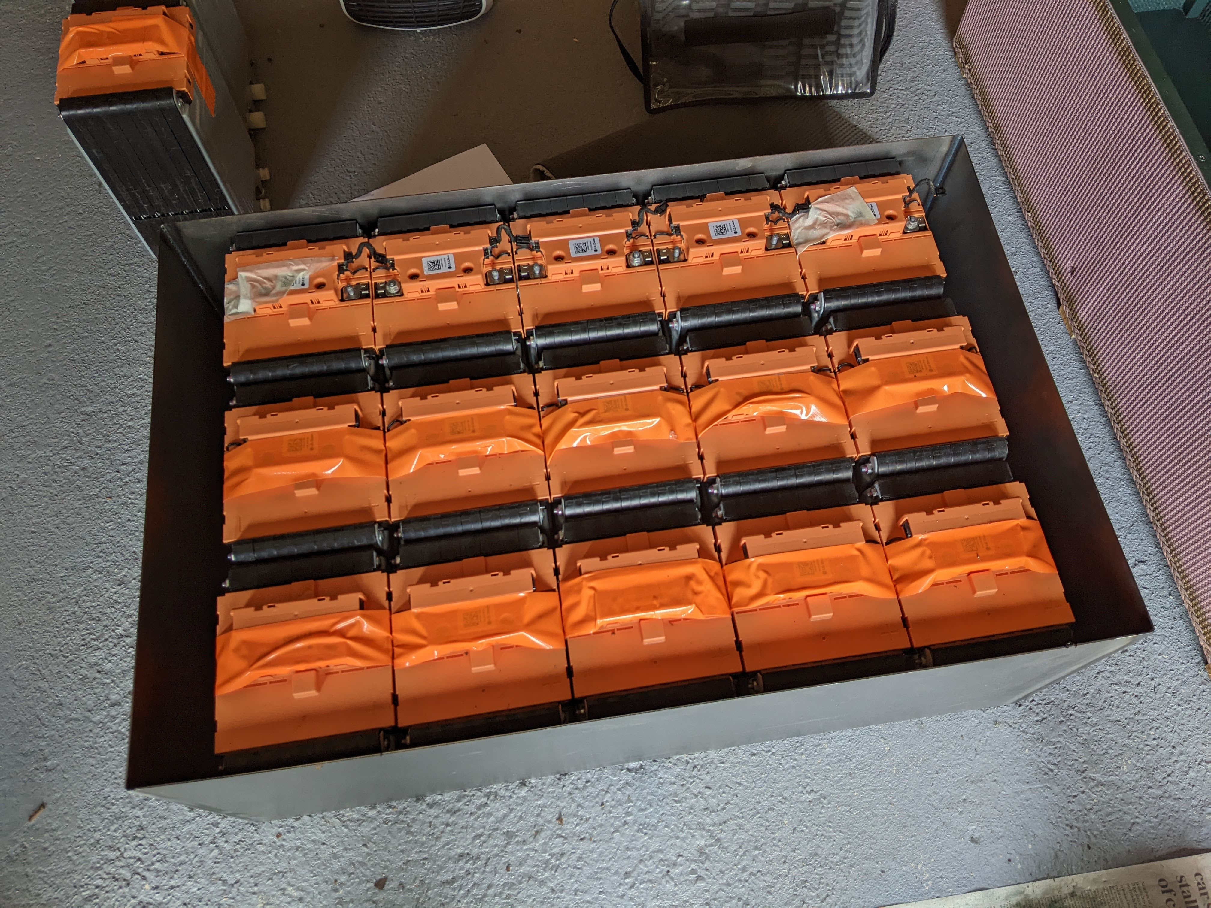

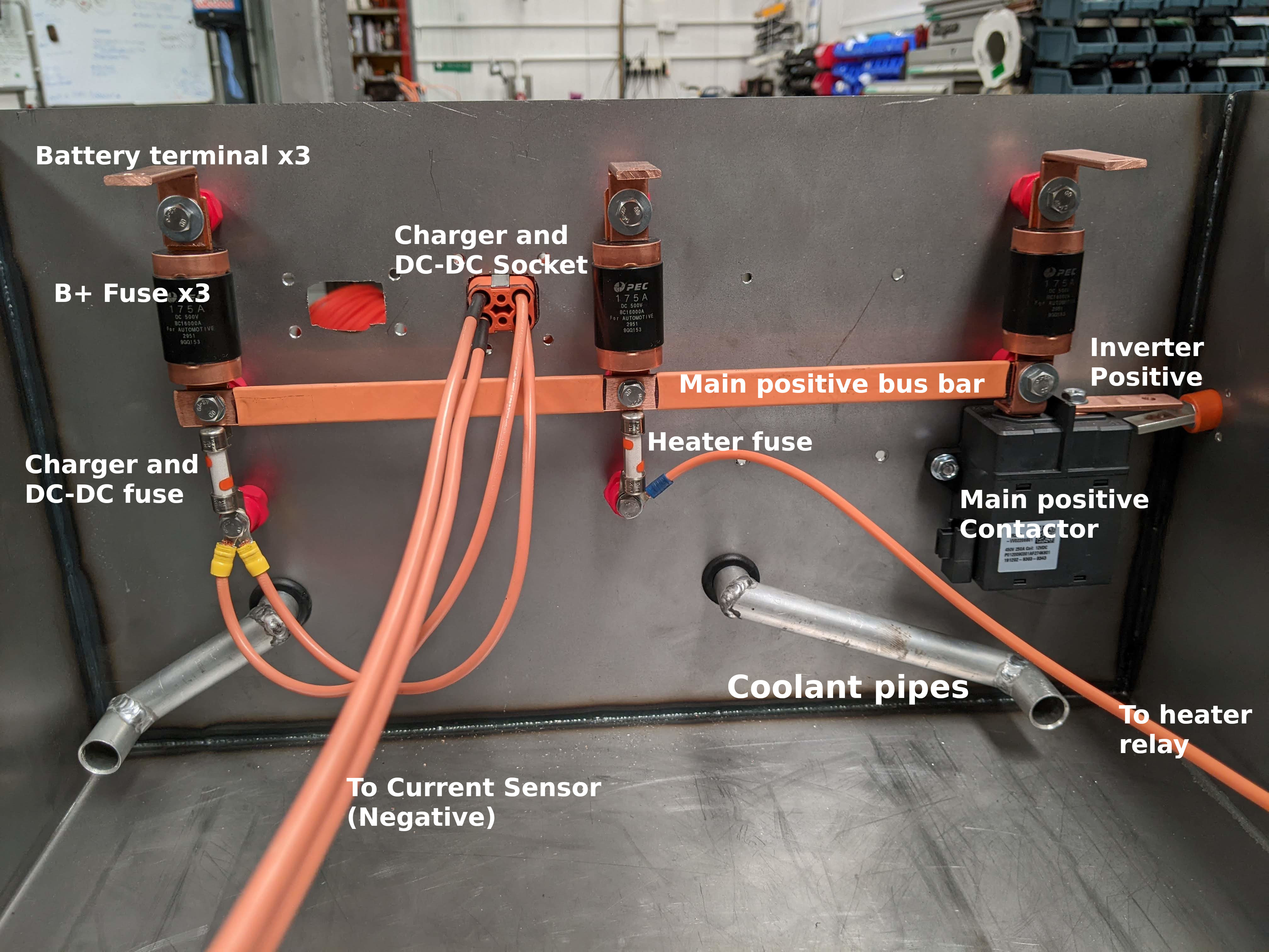

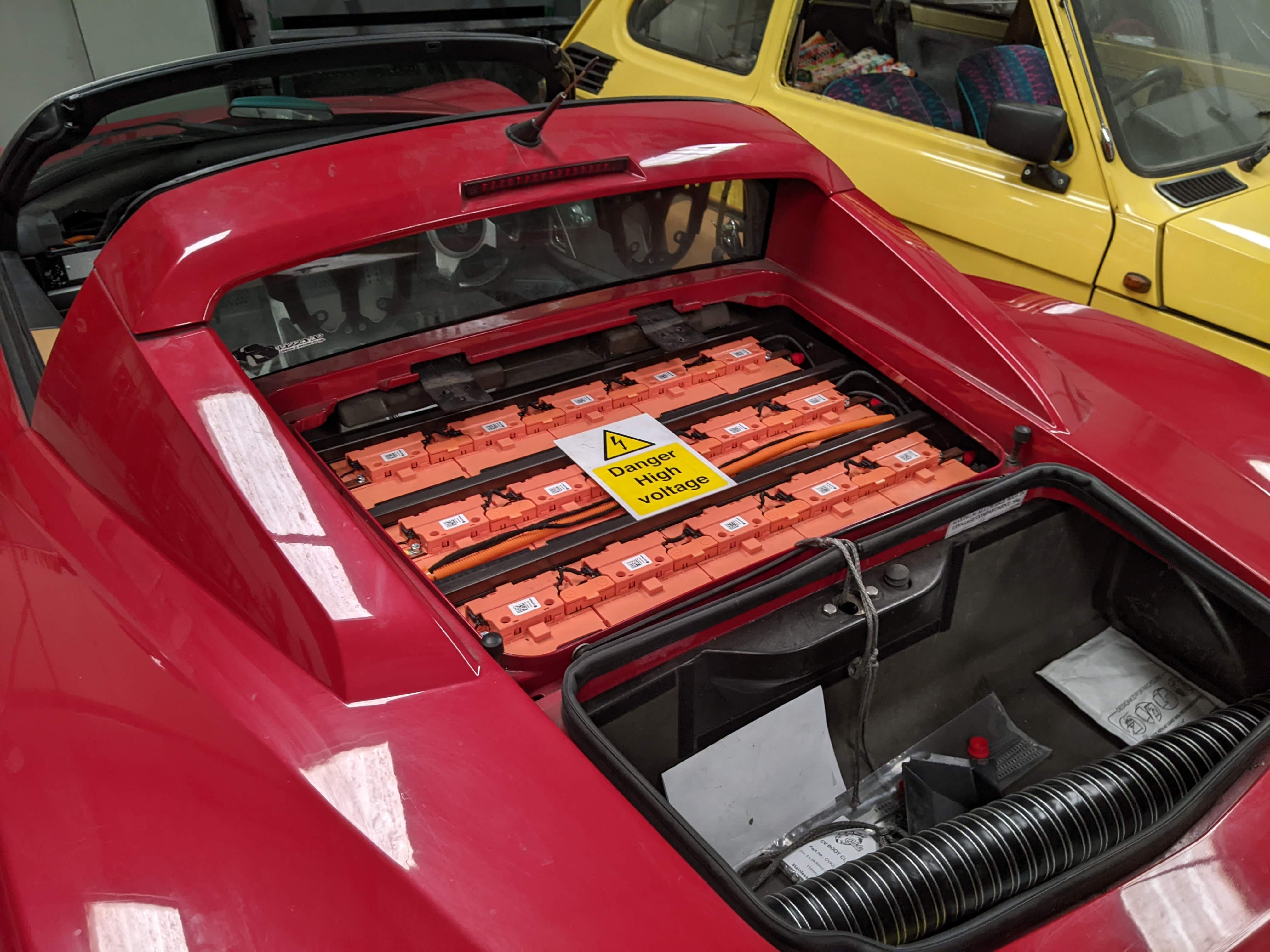

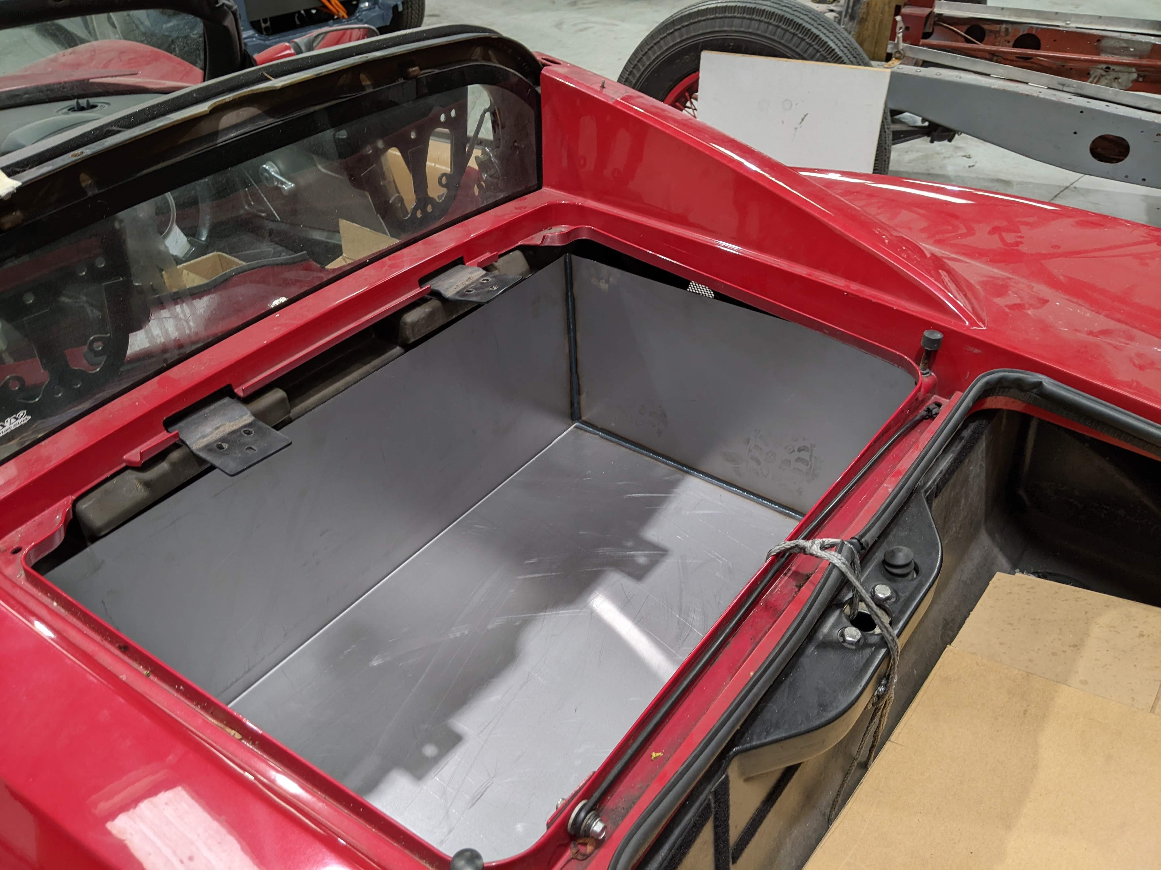

The battery box has really dragged on! Almost done now though. Just got to install the batteries themselves, and add some lifting points so it can be hoisted into the car.

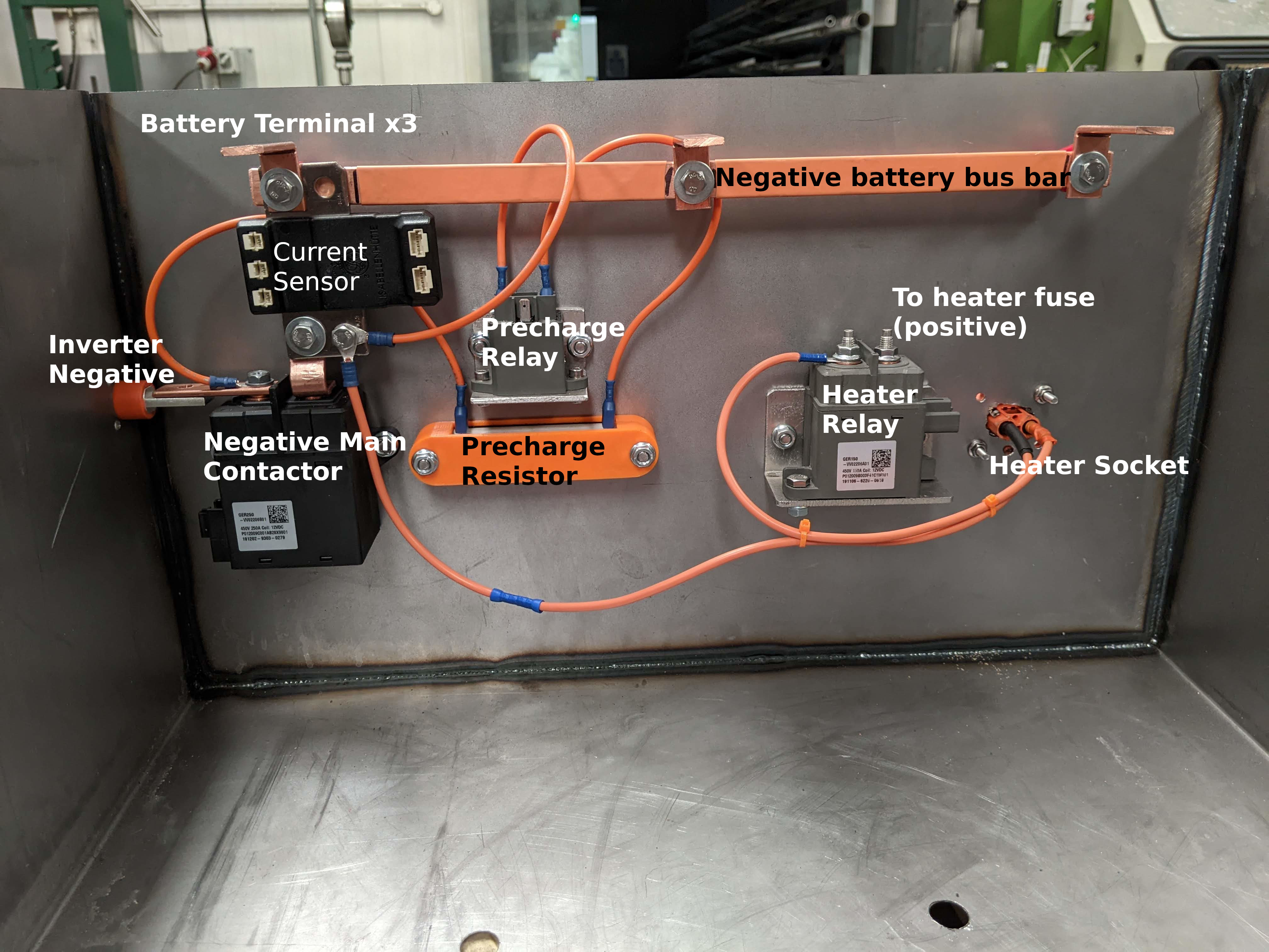

Very nice work, I notice your running the pre charge on the negative side is there a reason for this. I’ve always done pre charge across the positive contactor, I suppose It doesn’t matter really
catphish
Posts: 966
Location: Dorset, UK
Has thanked: 99 times
Been thanked: 197 times
Re: VX220 with Tesla SDU
Post by catphish »
Ev8 wrote: Sun May 01, 2022 7:19 am Very nice work, I notice your running the pre charge on the negative side is there a reason for this. I’ve always done pre charge across the positive contactor, I suppose It doesn’t matter really
The only reason it's on the negative side was to balance the space. I put the fuses on the positive side which took up a lot of room, so I put the current sensor and precharge on the negative side. All of these things will work equally well on either side.

qmedia2651 wrote: Sun May 01, 2022 3:51 am Nice how much watts are your battery pack
My pack is 20kWh usable, not particularly impressive, but hopefully the light weight of the car will allow something approaching 100 miles of range from that.

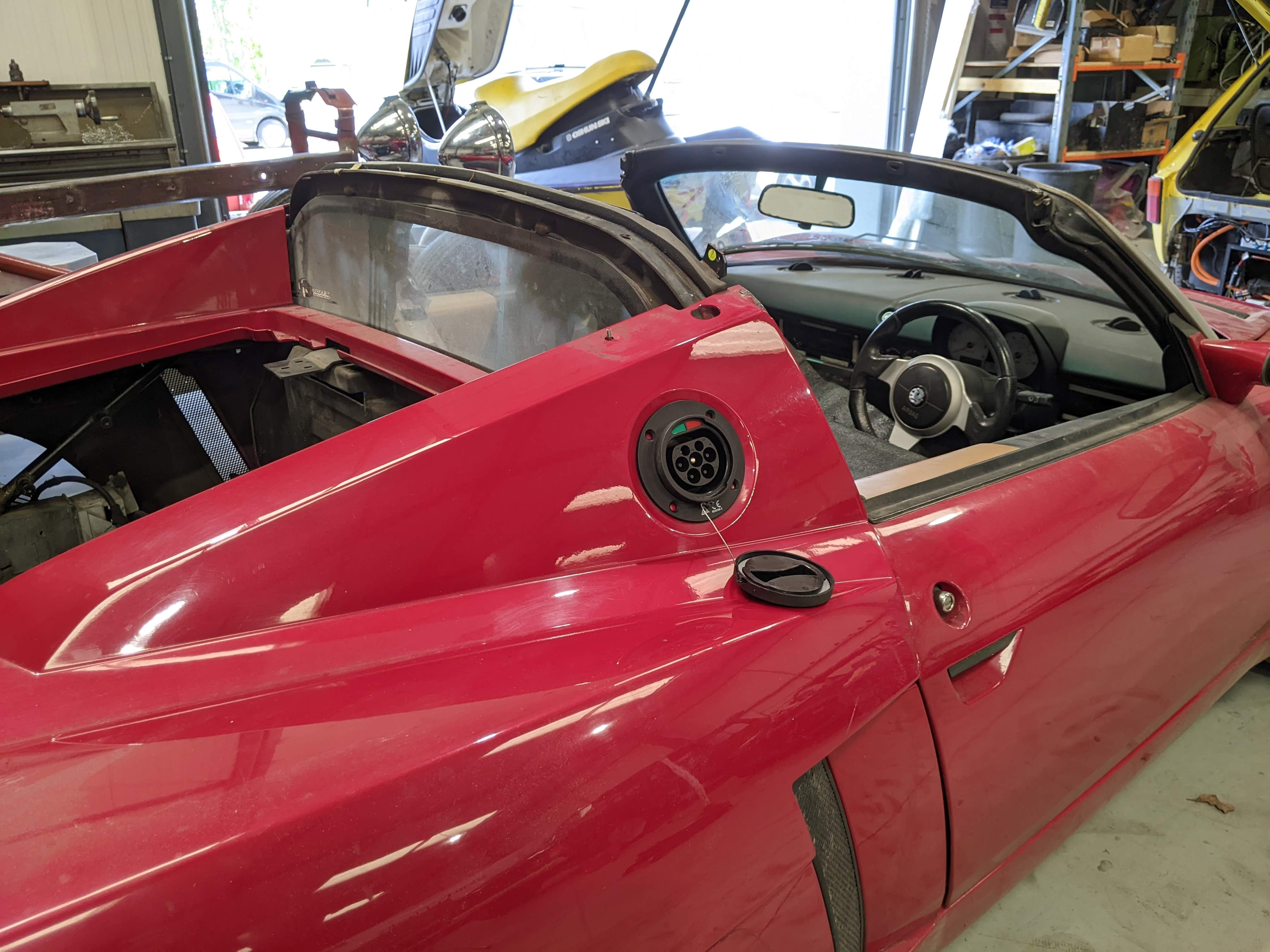

Now that I've finished the design of the battery box and sent it off for powder coating, I've been able to get started on some of the more fun parts of the build. So far this week I've installed the charger and charge port.

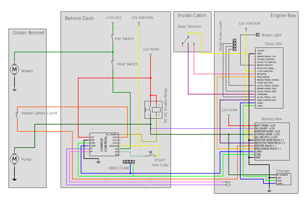

Just wanted to do a small post about my plans for low voltage cabling. Luckily I am able to use the huge majority of the OEM wiring, just got to add new wiring for CAN, HV relays, gear selector, and EVSE.
One cool feature here is I believe I can use the start button on the dash as both a start button *and* a cruise control button over CAN.
car.pdf
(31.7 KiB) Downloaded 485 times

Openinverter appears to stay in pre-charge mode indefinitely in the period before start is engaged. Are you planning an interlock to prevent pulling current over the pre-charge resistor from the DC-DC/Charger before start is pressed?
catphish
Posts: 966
Post by catphish »
cloudy wrote: Sun May 29, 2022 8:55 pm Openinverter appears to stay in pre-charge mode indefinitely in the period before start is engaged. Are you planning an interlock to prevent pulling current over the pre-charge resistor from the DC-DC/Charger before start is pressed?
My DC/DC converter is not behind my inverter contactors, so this isn't a problem.
