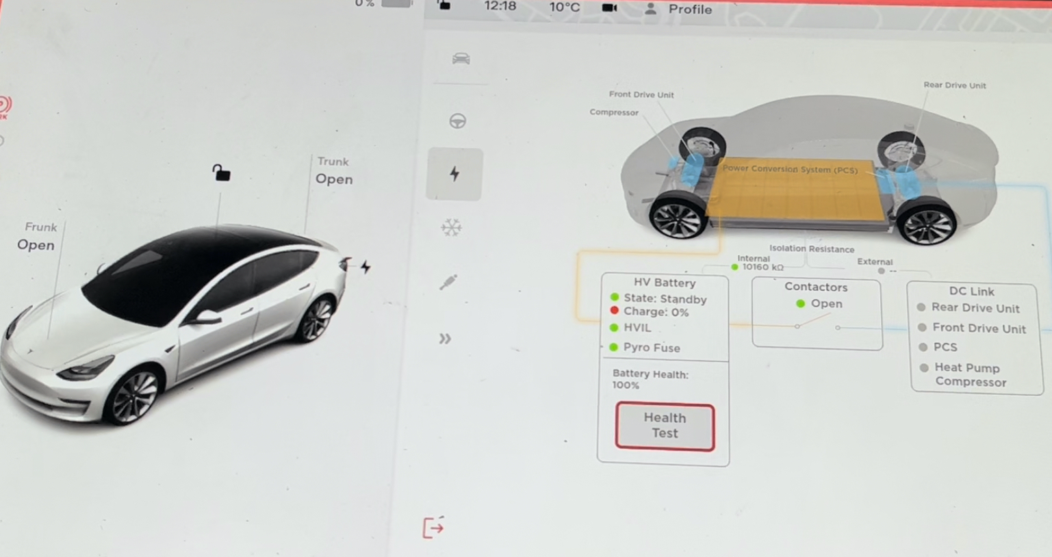

This is really interesting. I enjoy reading your message over several pages.
I have different application where I try to connect the complete car including all ECU and PCB. Trying to manipulate the CAN message. For frame transmittion rate, I used Savvycann with 0x221 30ms update rate and notice the update rate of Tesla every 10ms. I tune the Savvycann to 10ms and manage to clear the charge stage fault to green.
But Savvycan shutdown after a while due to over flow. Do you know if Arduino MCP2515 can bus survive the message with 10ms?
I have issue with SOC 0% even if I measured the voltage 340VDC. That is probably due to the brick voltage per cell is below the low level because I use SR battery for the LR car.
BR; Nam
