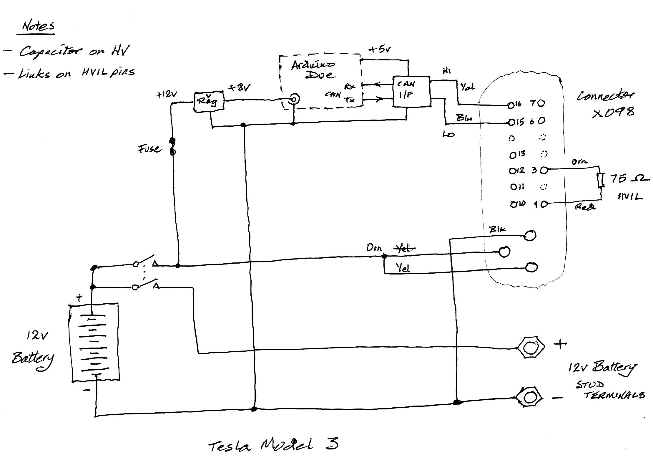

Tesla Model 3/Y and Plaid Battery Solar Storage project.
- Posts: 38
- Joined: Tue Apr 19, 2022 12:17 pm
- Location: Aberdeenshire
- Been thanked: 14 times
Re: Model 3 High Voltage Controller
Use vehicle Can bus on pins 15,16
Fit a capacitor across the H.V.
I used an Arduino Due but it may work with an ESP32, I don't know. It does have a CAN interface.

- Posts: 38
I have been asked to provide a diagram of my system which achieves contact closure and display of data on an Arduino Due. Here it is. And of course the can lines should be terminated with 120 ohms

Thanks for providing the picture. Could you please explain about "Links on HVIL pins"?

I was referring to the HVIL pins. High Voltage Interlock Loop. This is an electrical loop which must be intact to allow the battery to energise. The electrical circuit loops through each high voltage connector , the data connector and even one of the lid screws of the "penthouse" cover. On each HV connector there are two small extra contacts . These must be shorted out to complete the safety loop. This is usually done by fitting the relevant connector which contains a shorting link but us hobbyists don't always have all the connectors to fit. A resistor must also be fitted to the correct pins of the data connector as shown in the diagram.

There is only one high-voltage connector for the single-engine tesla model's battery. There is also another connection under the penthouse, which is for the heater and/or compressor, that has small extra contacts; do we need to short them also? Also, there are small extra contacts for the charger port on top of the penthouse; do we need to short-circuit them?bielec wrote: ↑Wed Jan 04, 2023 11:49 pm I was referring to the HVIL pins. High Voltage Interlock Loop. This is an electrical loop which must be intact to allow the battery to energise. The electrical circuit loops through each high voltage connector , the data connector and even one of the lid screws of the "penthouse" cover. On each HV connector there are two small extra contacts . These must be shorted out to complete the safety loop. This is usually done by fitting the relevant connector which contains a shorting link but us hobbyists don't always have all the connectors to fit. A resistor must also be fitted to the correct pins of the data connector as shown in the diagram.

I have a dual motor version and I have linked the HVIL on both front and rear motor connectors and the small pins on the "Anciliary"/heater connector.PE22 wrote: ↑Thu Jan 05, 2023 3:26 pm There is only one high-voltage connector for the single-engine tesla model's battery. There is also another connection under the penthouse, which is for the heater and/or compressor, that has small extra contacts; do we need to short them also? Also, there are small extra contacts for the charger port on top of the penthouse; do we need to short-circuit them?
I have nothing connected to the charger socket.
I have been asked about using an ESP32 instead of a Due so today I quickly modified and stripped the code to work on an ESP32.
This requires Collin Kidders esp32_can library and his can_common library to compile. It is sufficient to copy these two libraries into your arduino library folder. The program is operated from the Arduino serial monitor screen where you will see a continuous stream of battery SOC, cell Voltages, Temperatures etc. Sending a "C" toggles message 221 which turns the contactors on/off. The messages are sent at default 30mS but the rate may be varied by command eg. "i 60" for 60mS. Sending "?" displays a menu of these commands.
I used a Node ESP32 with a 3.3v compatible CAN driver shield Rx on GPIO16 Tx on GPIO17
This is quick and dirty but should allow novice users to get the contactors to close on a newer Wireless capable device.
(edit) there is an error which prevents this program from transmitting proper data and closing the contactors... to correct the error, remove the line "outframe.rtr = 1;"
