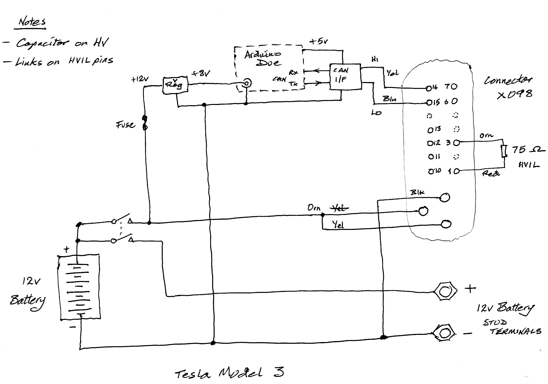

If I figure it out correctly, I need:
2 resistors on the drive unit connectors on the battery
1 connector for the high volt connectors (goes to the inverter)
1 esp32 with can Interface - (what’s the correct can interface?) and flashed with the Programm from here
1 serial connection to a computer for close the switches in the battery with the c key via serial console
1 12v Powersource for power the battery bms electronic.
1 model 3 SR or LR battery (complete)
Did I miss something?
What’s the best CAN bus pins? (Inverter front/real, charge Port or vehicle can)
Best regards.

Re: Model 3 High Voltage Controller
Use vehicle Can bus on pins 15,16
Fit a capacitor across the H.V.
I used an Arduino Due but it may work with an ESP32, I don't know. It does have a CAN interface.

Do you know what is the reason for "having 2 resistors on the drive unit connectors on the battery"? What value? and how do we connect them?OOP wrote: ↑Sun Dec 25, 2022 2:39 pm If I figure it out correctly, I need:
Best regards.
It is to connect in the small parts in the connector, otherwise the bms thinks, that no engine is connected and don’t come up. I hope that’s the correct description.
I hope this is correct. I think I have read this anywhere. In my opinion it will be better to have his only on the connector that will be used and connected. But anyone write this is a issue if the battery is configured for a dual engine.

I have been asked to provide a diagram of my system which achieves contact closure and display of data on an Arduino Due. Here it is. And of course the can lines should be terminated with 120 ohms
Thanks for providing the picture. Could you please explain about "Links on HVIL pins"?
I was referring to the HVIL pins. High Voltage Interlock Loop. This is an electrical loop which must be intact to allow the battery to energise. The electrical circuit loops through each high voltage connector , the data connector and even one of the lid screws of the "penthouse" cover. On each HV connector there are two small extra contacts . These must be shorted out to complete the safety loop. This is usually done by fitting the relevant connector which contains a shorting link but us hobbyists don't always have all the connectors to fit. A resistor must also be fitted to the correct pins of the data connector as shown in the diagram.
There is only one high-voltage connector for the single-engine tesla model's battery. There is also another connection under the penthouse, which is for the heater and/or compressor, that has small extra contacts; do we need to short them also? Also, there are small extra contacts for the charger port on top of the penthouse; do we need to short-circuit them?bielec wrote: ↑Wed Jan 04, 2023 11:49 pm I was referring to the HVIL pins. High Voltage Interlock Loop. This is an electrical loop which must be intact to allow the battery to energise. The electrical circuit loops through each high voltage connector , the data connector and even one of the lid screws of the "penthouse" cover. On each HV connector there are two small extra contacts . These must be shorted out to complete the safety loop. This is usually done by fitting the relevant connector which contains a shorting link but us hobbyists don't always have all the connectors to fit. A resistor must also be fitted to the correct pins of the data connector as shown in the diagram.
I have a dual motor version and I have linked the HVIL on both front and rear motor connectors and the small pins on the "Anciliary"/heater connector.PE22 wrote: ↑Thu Jan 05, 2023 3:26 pm There is only one high-voltage connector for the single-engine tesla model's battery. There is also another connection under the penthouse, which is for the heater and/or compressor, that has small extra contacts; do we need to short them also? Also, there are small extra contacts for the charger port on top of the penthouse; do we need to short-circuit them?
I have nothing connected to the charger socket.
