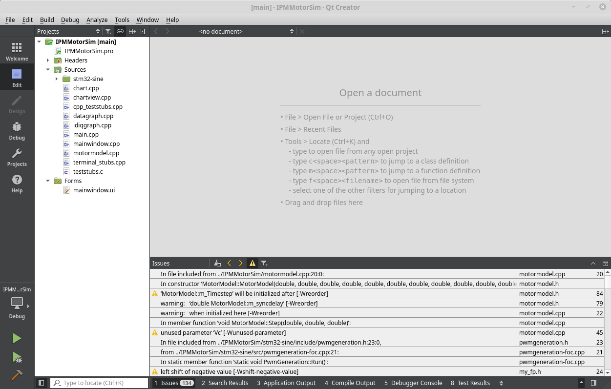

still having issues building a working version of the sim, again, God only kno how it worked once but not since! obviously if you git clone the stm32-sine repo itll clone the latest commit, but the sim readme asks for 5.24 so what is the best SHA to build from?
also when building in qt creator i get a whole host of issues, most seem to be referring to unused variables, but there are a couple of wreorder issues flagged up, is this a problem?

This one's got stm32-sine linked as a submodule: https://github.com/jsphuebner/IPMMotorSim/
Plus a Makefile in the build/ directory so you don't need to launch QTCreator
git clone --recurse-submodules https://github.com/jsphuebner/IPMMotorSim.gitSupport R/D and forum on Patreon: https://patreon.com/openinverter - Subscribe on odysee: https://odysee.com/@openinverter:9

Just done a clean checkout to test and it all seems to work fine, I did:
opened qt, opened the project, accepted the default config, rebuilt and ran and it works fine.
I do change a line at the top of pwmgeneration-foc.cpp from to to clean up the plots at low speed but that's it (and it will run fine without the change).
I get 126 warnings pretty much as you describe. Really should look at tidying them up sometime!
Would be worth letting us know what OS you are on and what version of Qt?

Thanks will try a clean build of everything again, running windows 10, version 22h2 and qt 6.4.1
I use wsl and Ubuntu for compiling stm ect and have managed to build the sim using Johannes makefile bit unsure of what to do with the output it creates…

I've only tried it on Linux (Mint/Ubuntu), will give it a try on Windows tomorrow.
Thanks guys I think i'm back up and running, no idea what was going on there but a fresh start seems to have things giving more repeatable results

Open Qt, go to 'Open Project' (either in the File menu or on the Home screen), browse to the directory where you installed the simulator and then go down into the 'IPMMotorSim' subfolder twice. In there there should be an 'IPMMotorSim.pro' file. Open this and you will get a 'Configure Project' dialog, just accept the default for this. You should see something like this: To build the software go to 'Build' at the top and select 'Rebuild Project: IPMMotorSim'. This should do a full build of the simulator software and the OI firmware. On my Qt install (which is a little out of date) this results in 53 warnings. They are non-critical (mostly to do with type conversion in the OI fixed point math). With that done you can run the software either by clicking the 'Run' button (green triangle at the bottom left), the 'Start Debugging' button (other green triangle with a bug icon) or by selecting the same from the top menu. With that done you should see something like this: Now on the first run the window positions are not set so the first thing to do is to set the windows up how you like them, this is how I set it up: On subsequent runs these positions are remembered. It's worth noting that the more windows you have active the slower the results are to draw so there is no point having windows up that you don't use.
The last thing to do is run the simulator to see if everything works, first change the values for Lq to 4 and Lq to 2 (so that it matches the Lq-Ld setting of 2 that has been pulled from the param file) and hit 'Run (1s)', you should see something like this: Edit - Jan23 Updated to reflect code changes

OK - above bug now fixed and the new code is on github (https://github.com/Pete9008/IPMMotorSim).
Changes are:
Changes are:
- Should be able to change any parameters in the param_prj.h file now without breaking the simulator (let me know if not)
- The resolver pole pairs is now not used and the motor pole pairs is used for everything.
- Bug on motor pole pairs fixed, van now change at any time.
- Operating point plot can now be selected to show either Volts or Amps
- Can now choose whether to display the phase currents and voltages on the plots (turning them off makes rendering the plots around 30% faster)
- Edit - And cleared around 2/3 of the build warnings (rest are due to OI firmware fixed point macros so have been left)

Just a note to mention that you may need to delete saved preferences if updating/unbreaking/starting fresh - ~/.config/OpenInverter/IPMMotorSim.conf on Linux
