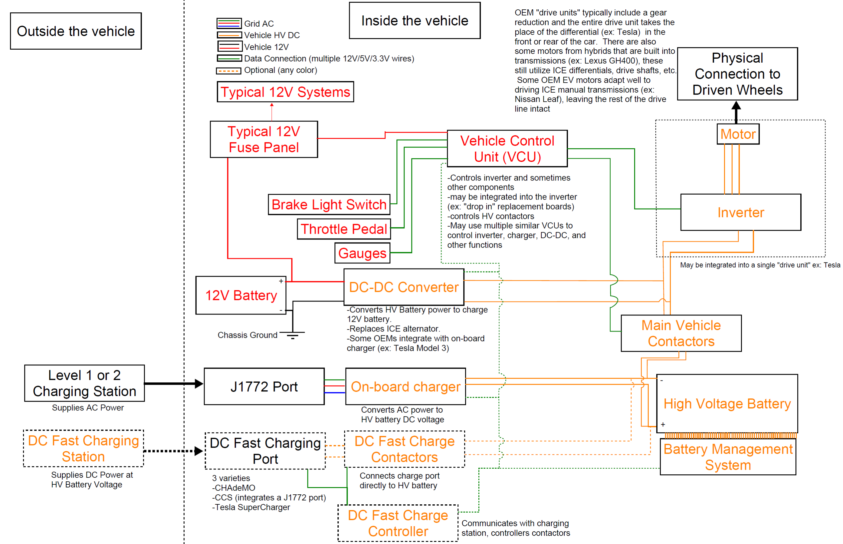

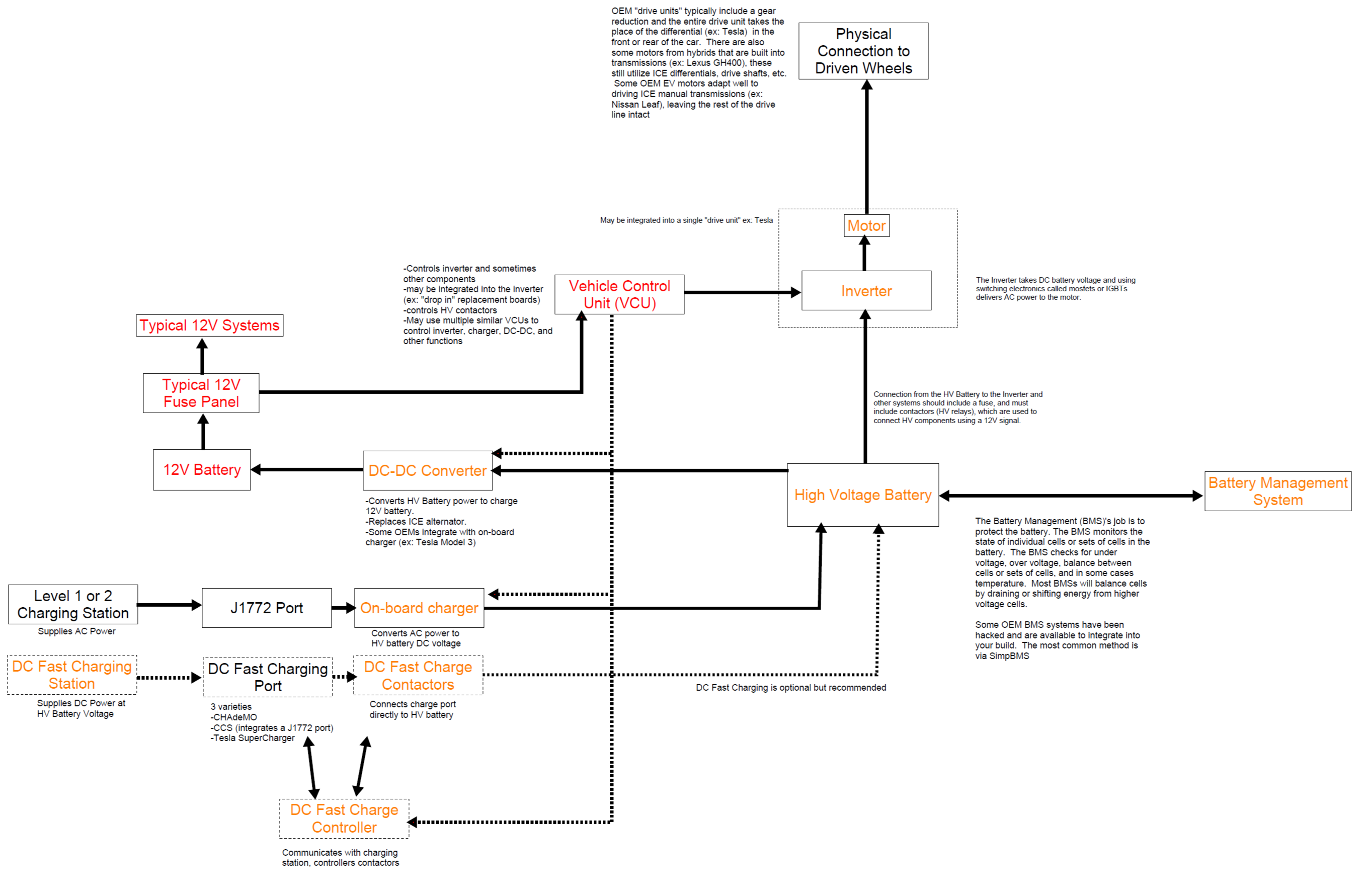

I'm a visual guy, so I'm going to try to find time to draw up a high level diagram of all components needed for an EV conversion, I think it'd be useful for newbies to wrap their head around what is required. I make no promises - work has been insane - but I'll try.

luv the idea, it would be cool to complicate your plans with making it animated, in the sense that if you replace say the Lexus GS450h transmotor with a Nissan Leaf motor the diagram adjusts and pops in a transmission adapter plate for rear drive cars, but I will wait till the Mangeldorf version 1.1.2 for thatP.S.Mangelsdorf wrote: ↑Thu Dec 15, 2022 12:56 pm I'm a visual guy, so I'm going to try to find time to draw up a high level diagram of all components needed for an EV conversion, I think it'd be useful for newbies to wrap their head around what is required. I make no promises - work has been insane - but I'll try.

Ok so I have a first pass at two different options and I'd like folks' opinions. These are just quick screen grabs, the final version for the wiki will be a bit cleaner and use bigger fonts.P.S.Mangelsdorf wrote: ↑Thu Dec 15, 2022 12:56 pm I'm a visual guy, so I'm going to try to find time to draw up a high level diagram of all components needed for an EV conversion, I think it'd be useful for newbies to wrap their head around what is required. I make no promises - work has been insane - but I'll try.
Option 1 is purely conceptual. Option 2 is closer to a wiring diagram

It would be neat to be able to click on the items in the diagram and to navigate to the corresponding wiki page with a list of parts. Clicking on "High Voltage Battery" would take you to https://openinverter.org/wiki/Batteries wiki page.
There are wiki extensions that allow for diagraming.

Like it!
Prefer the second one, the first one seems a little light on information and not too keen on the way it hides the contactors inside the battery. Could do with adding the BMS words from the first one to the second diagram too.
The second one does assume that brake and throttle go though the VCU which isn't always the case.
Being able to click/hover to get more information would be good.
