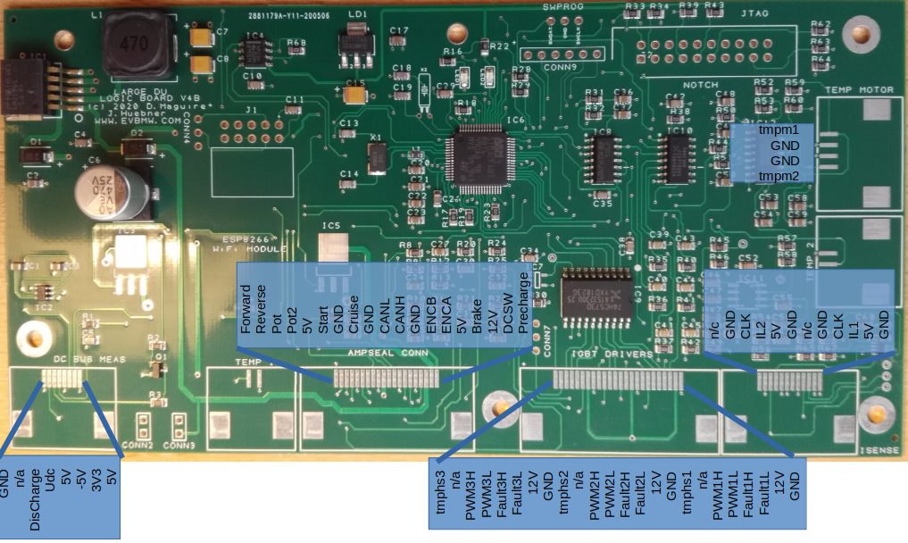

Greetings this trying to start my Tesla LDU with the load and precarious Nissan Leaf relay system this has a resistance of 30ohm and 40 watt, but the unit does not start me I do not know if it is by the Nissan system, but pin 6 is not activated to activate the main relay, also pin 12 of accelerator only takes me 3.4V and not 5V. No I don't know what happens I am thinking of changing the resistance for one of 100W as the diagram says to see what happens. What opinion do you have and how can you help me?
Been thanked: 1918 times
Looks like the PCB picture hasn't made it into the wiki yet:
Are you getting 5V between pin 1 and 3 of LD1?
Can you please answer the question I asked you instead of just repeating what you said before...

johu wrote: Sun Nov 06, 2022 6:37 pm Looks like the PCB picture hasn't made it into the wiki yet:
Greetings, I measured the voltage is 3.4V
bmwx5projet wrote: Tue Nov 08, 2022 9:45 pm Greetings, I measured the voltage is 3.4V
Ok, so the 5V regulator does not produce 5V.
Now what is the voltage on C6? What is the feedback voltage, i.e. across R33? What is the total current draw of the board? Can you post a high res picture of your board? Where did you obtain the board?
