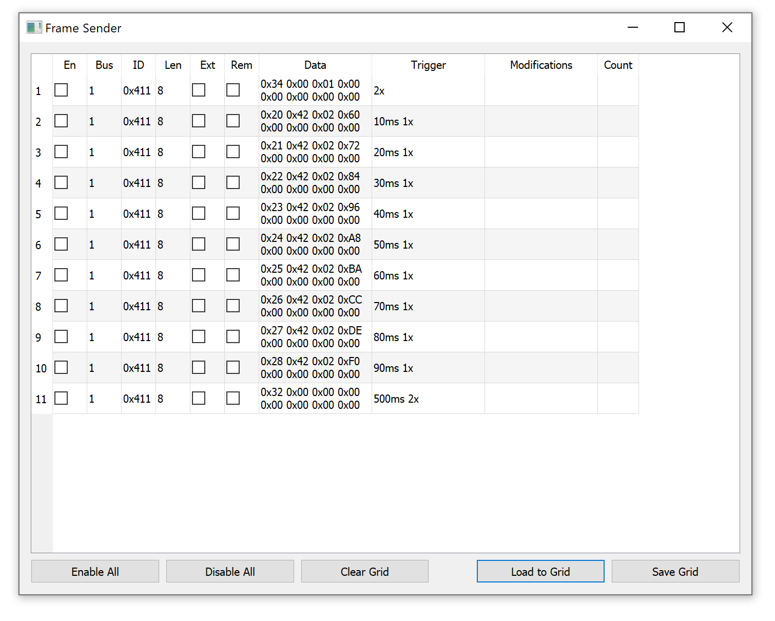

Hi all. I am having trouble with a couple of CAN streams please will someone shed some light
I have had temp and motor temp perfect
The first is motor RPM
I am getting 0-250ish then it starts again
I have it on big endian, it is signed 16 bits gain 1
The other is the ISA shunt. I am desperate to see the current draw. At the moment I am not seeing anything useable.
Many thanks

Did you initialize the ISA shunt?
Yes shunt is initialised, do you happen to have the CAN details as i am not 100% I’ve got it right.

When setting up the shunt for CHAdeMO, the snip below is my most recent initialization CAN messages. NOTE: I have not yet been able to confirm that the signs are all set correctly for CHAdeMO, but I know it is putting out CAN data correctly.
