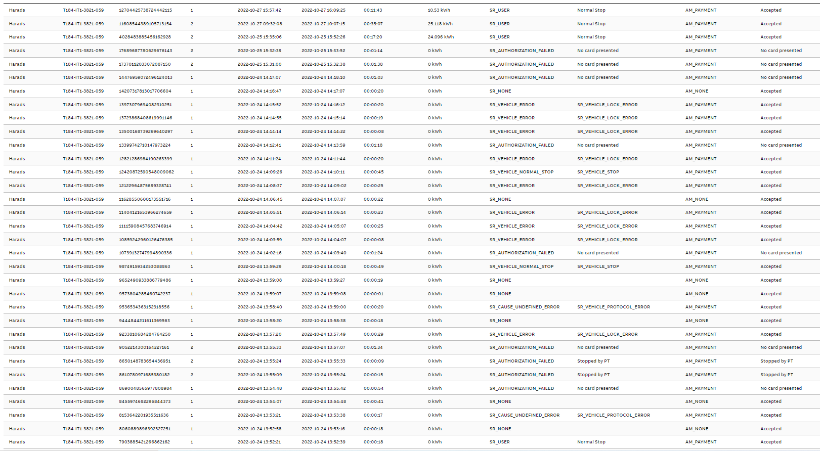

But there's another thingy: I contacted the company operating the ABB charger. And they sent me the log of the charger. See attachment.
You can ignore the SR_VEHICLE_LOCK_ERROR, that day I had to put in the lock manually (hardware error, that's fixed in the meantime). And I wasn't always quick enough. You can even ignore the cases where I fought with the stupid payment system.
That means there's SR_CAUSE_UNDEFINED_ERROR / SR_VEHICLE_PROTOCOL_ERROR and SR_VEHICLE_NORMAL_STOP / SR_VEHICLE_STOP
This documents explains these strings (of course it doesn't help me a lot...). But there's a separate error for isolation error: SR_ISOLATION_TEST_FAILED

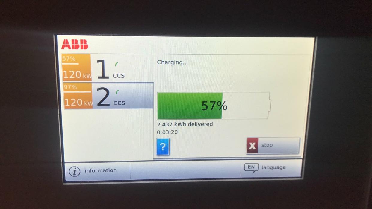

It works! On ABB chargers at least. Tested on two different ones.
On Efacec it stops after some seconds of actual charging. But investigating... I made a log...
Thanks everyone involved!
