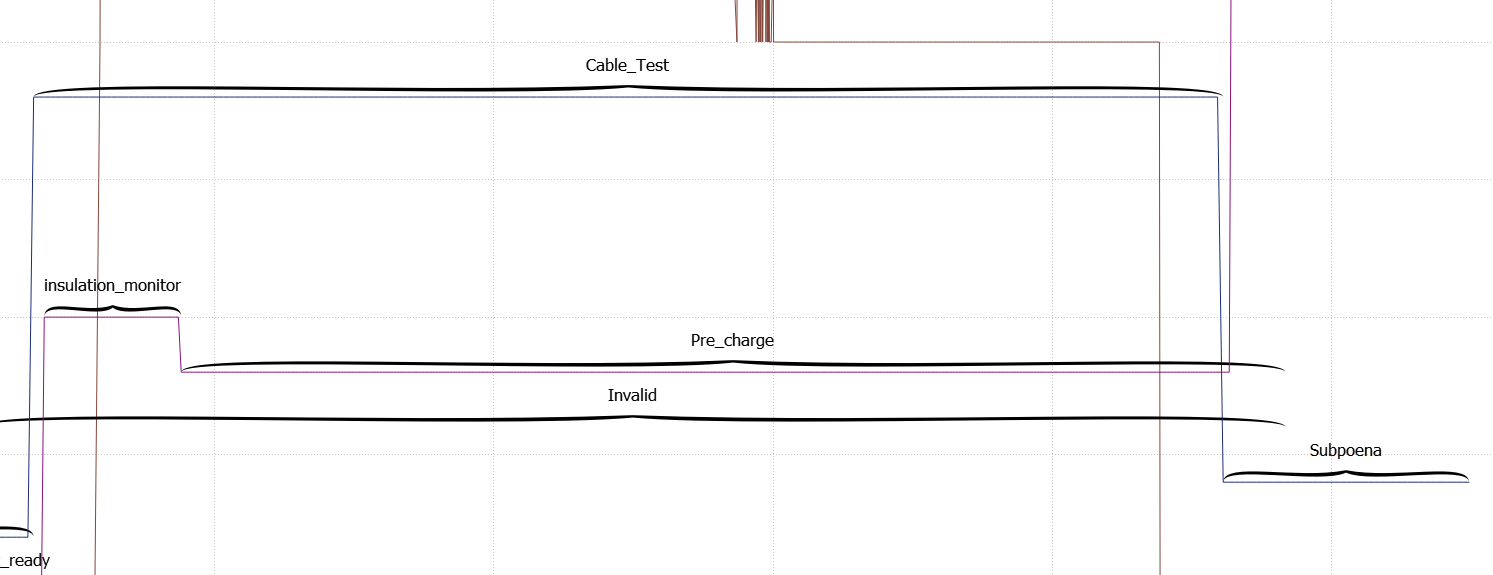

You wrote your own code i believe looking at how long you stay in "cable test". The external charger even decides to move on before you request it. would it be due to waiting for the reported FC HV voltage to drop slowly, I would raise it to move on sooner, the charger does not mind.
ABB I see that as soon as the contactors shut the charger shuts it all down. So I would indeed look at Isolation. Possibly you got internal fault somewhere or the BMS is causing issues.
christoph
Posts: 40
Joined: Fri Sep 09, 2022 9:40 pm
Post by christoph »
tom91 wrote: Wed Oct 26, 2022 10:42 pm You wrote your own code i believe looking at how long you stay in "cable test". The external charger even decides to move on before you request it. would it be due to waiting for the reported FC HV voltage to drop slowly, I would raise it to move on sooner, the charger does not mind.
I use this code:
https://github.com/damienmaguire/Stm32- ... /i3LIM.cpp
Even in that given revision. So this is where the delay comes from. I call Send10msMessages every 10ms, Send100msMessages and Control_Charge(true) every 100ms and Send200msMessages every... you guess it... 200ms. And looking at the CAN timestamps, this seems to work.
And I set these params: Param::udc (to the voltage reported by the Leaf battery), Param::idc (to the current reported by the Leaf battery, might be negative when not in charge mode, might this be a problem I wonder now writing that?), Param::opmode to 0 when charging, Param::SOC to state of charge in percent, Param::BattCap to the battery's capacity in Wh. And finally CCS_ILim to the maximum amperage wanted.
Is there anything obviously wrong? Is there another version with different timing as you noticed that this might be wrong?
This is my complete code: https://github.com/cschleifenbaum/qleaf - stuff is happening in lim.cpp
The car is turned on at the give time with the heating drawing a bit energy from the battery. I'm not faking a Chademo charge yet but going there directly.
tom91 wrote: Wed Oct 26, 2022 10:42 pm ABB I see that as soon as the contactors shut the charger shuts it all down. So I would indeed look at Isolation. Possibly you got internal fault somewhere or the BMS is causing issues.
Is the shutdown from the charger side somehow related to the 272 error? Does it happen before or after?

christoph wrote: Thu Oct 27, 2022 8:02 am Is the shutdown from the charger side somehow related to the 272 error? Does it happen before or after?
Now I had a look ath where it changes from 0x01 to 0x05 (to closed state). I had a look at the 0x2b2 message at the same time. Voltage in the first two bytes stays the same: 357,0V. And so does current: 0xffff. Both before the contactors close and after. And that does - I'm quite sure - not translate to 6553,5A.
At the same time I had a look at the 0x3b4 messages. The voltage measured by the voltage sensing board is in the range of 344-348V. Both before and after contactors closed. 348V when closed.
The battery voltage was 354V at that time.
Now I don't know how much of a voltage drop is normal. But honestly I think the voltage at the sensing board is a bit low. OTOH the cables from the contactor to the board are thin (but short).

christoph wrote: Thu Oct 27, 2022 8:02 am Is there anything obviously wrong? Is there another version with different timing as you noticed that this might be wrong?
You have 2 issues one is timing based and the other is isolation based. I have resolved both in my version of coding.
Timing:
 if(Cont_Volts==0)lim_stateCnt++; //we wait for the contactor voltage to return to 0 to indicate end of cable test
            if(lim_stateCnt>20)
               if(CCS_Iso==0x1) lim_state++; //next state after 2 secs if we have valid iso test
               lim_stateCnt=0;
I changed this to wait for the voltage to drop below 50V before proceeding, the decay of the voltage on the charge port depends on how the charger stages work and if they hard disconnect or not. The Can Log shows a very slow delay for the Efacec.
The ABB one closes contactors and then the charger gets upset right away, I have seen this issue before as you can see in the thread and it was isolation related. It did not communicate the fault all the way onto the canbus properly though so it was a hunt to find the issue.
