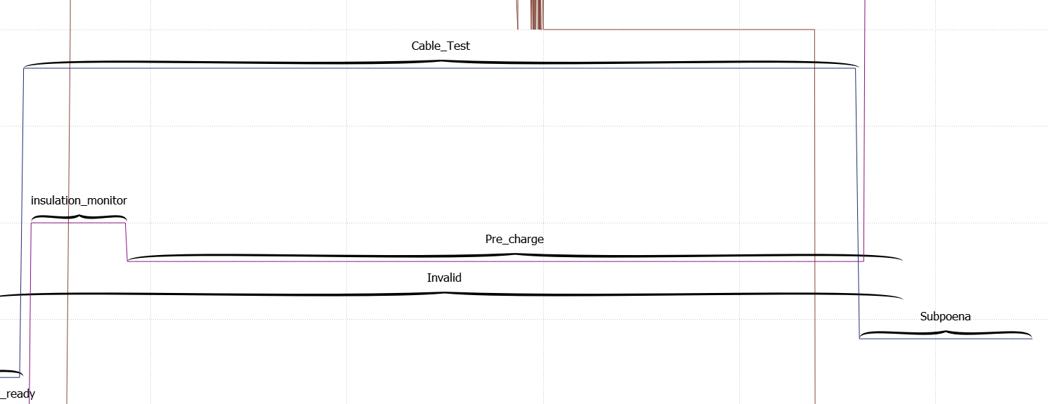

So... there are the logs.
ABB is the one where the contactors close and then end up in the error state. Efacec didn't made it through isolation test.

You wrote your own code i believe looking at how long you stay in "cable test". The external charger even decides to move on before you request it. would it be due to waiting for the reported FC HV voltage to drop slowly, I would raise it to move on sooner, the charger does not mind.
ABB I see that as soon as the contactors shut the charger shuts it all down. So I would indeed look at Isolation. Possibly you got internal fault somewhere or the BMS is causing issues.

Now I had a look ath where it changes from 0x01 to 0x05 (to closed state). I had a look at the 0x2b2 message at the same time. Voltage in the first two bytes stays the same: 357,0V. And so does current: 0xffff. Both before the contactors close and after. And that does - I'm quite sure - not translate to 6553,5A.
At the same time I had a look at the 0x3b4 messages. The voltage measured by the voltage sensing board is in the range of 344-348V. Both before and after contactors closed. 348V when closed.
The battery voltage was 354V at that time.
Now I don't know how much of a voltage drop is normal. But honestly I think the voltage at the sensing board is a bit low. OTOH the cables from the contactor to the board are thin (but short).

Is the shutdown from the charger side somehow related to the 272 error? Does it happen before or after?
You have 2 issues one is timing based and the other is isolation based. I have resolved both in my version of coding.
Timing:
 if(Cont_Volts==0)lim_stateCnt++; //we wait for the contactor voltage to return to 0 to indicate end of cable test
            if(lim_stateCnt>20)
               if(CCS_Iso==0x1) lim_state++; //next state after 2 secs if we have valid iso test
               lim_stateCnt=0;
I changed this to wait for the voltage to drop below 50V before proceeding, the decay of the voltage on the charge port depends on how the charger stages work and if they hard disconnect or not. The Can Log shows a very slow delay for the Efacec.
The ABB one closes contactors and then the charger gets upset right away, I have seen this issue before as you can see in the thread and it was isolation related. It did not communicate the fault all the way onto the canbus properly though so it was a hunt to find the issue.

Post by christoph »
tom91 wrote: Thu Oct 27, 2022 9:08 am I have seen this issue before as you can see in the thread and it was isolation related. It did not communicate the fault all the way onto the canbus properly though so it was a hunt to find the issue.
I looked at your log and yes, the behaviour is pretty much the same. The Nissan Leaf has a ground monitor error code, but nothing is set. Chademo charging is working as well. It shouldn't otherwise.
So to check this I have to measure if there's voltage between + <-> GND and - <-> GND. And that if the wire is live, obviously. It should be 0V. Is that correct? I don't want to kill myself, nor the multimeter, nor any car part :-o
