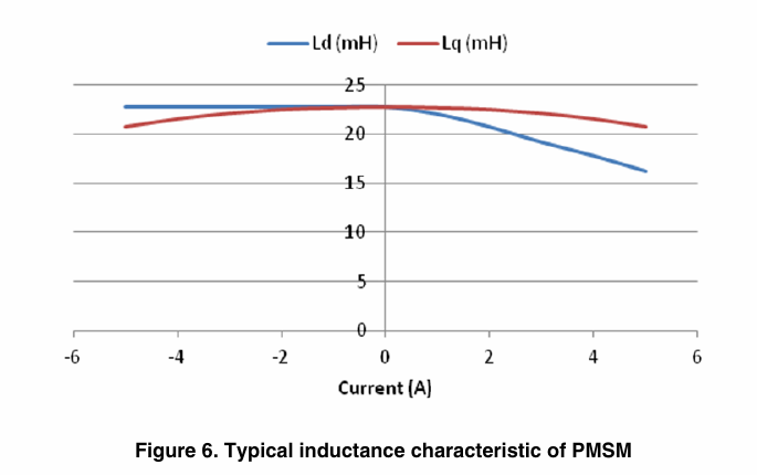

Is it possible to measure Ld and Lq from a motor?
Edit: Should've googled first, of course. I'll see what I can do with a Hyundai HSG (SPM), if that's useful?
Do you account for changing Ld and Lq with current?
https://www.physicsforums.com/attachmen ... pdf.79167/

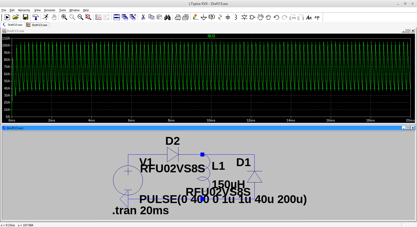

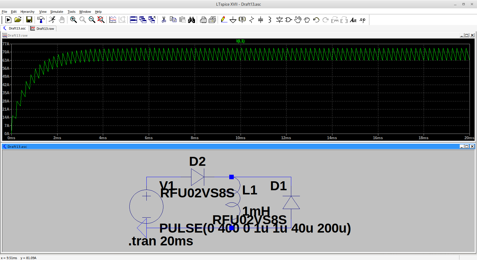

Gotta say 150uH sounds implausible as the Leaf inverter runs at 5 kHz PWM frequency. 150 uH would not be able to smooth that out at all and you'd have enormous ripple currents:
And here's what 1mH looks like

Agree, although trying to keep an open mind on it at the moment. The ripple on the 150u plot is just about on the limit of what I'd consider acceptable, and that is with 400V? It might explain some of the nuisance trips at low speeds though?
Edit - maybe a little bit over acceptable!

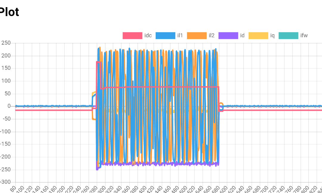

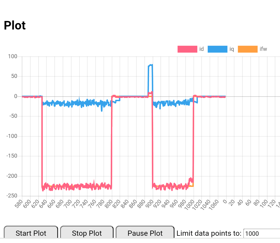

Really need more data (csv log or plot capture) to comment but I'd guess that it might be this viewtopic.php?p=45686#p45686?
If it is then a momentary small throttle opening following deceleration would reset Iq and Id and remove the current.
