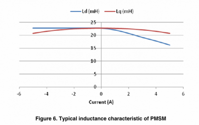

Is it possible to measure Ld and Lq from a motor?
Edit: Should've googled first, of course. I'll see what I can do with a Hyundai HSG (SPM), if that's useful?
Do you account for changing Ld and Lq with current?
https://www.physicsforums.com/attachmen ... pdf.79167/

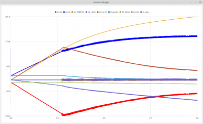

When I have time I'm also going to try tuning the simulator for different motor inductances to try and get a feel for how much difference it might make to the inverter settings.
The numbers do make me wonder about the Leaf data, it does seem to be the odd one out. Will see what the Outlander motor looks like, hopefully later today. Could also do with working out a way to do the inductance measurement at high current levels as that would be more representative. Should be relatively straight forward once it is connected to a battery and inverter but it will be a while before I have that setup here.

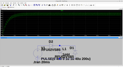

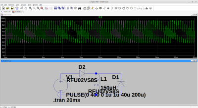

Gotta say 150uH sounds implausible as the Leaf inverter runs at 5 kHz PWM frequency. 150 uH would not be able to smooth that out at all and you'd have enormous ripple currents:
And here's what 1mH looks like

Agree, although trying to keep an open mind on it at the moment. The ripple on the 150u plot is just about on the limit of what I'd consider acceptable, and that is with 400V? It might explain some of the nuisance trips at low speeds though?
Edit - maybe a little bit over acceptable!

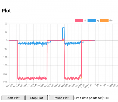

Really need more data (csv log or plot capture) to comment but I'd guess that it might be this viewtopic.php?p=45686#p45686?
If it is then a momentary small throttle opening following deceleration would reset Iq and Id and remove the current.
- Posts: 1801
- Has thanked: 102 times
- Been thanked: 347 times

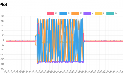

Starting to make sense again, just for reference here is a plot showing what the individual contributions to the motor voltages are:
Vq_BEMF is the back EMF generated by the turning motor, if it gets above battery voltage (~175V) the motor is above base freq.
Vq_Ld and Vd_Lq are the voltages generated across Ld and Lq by Id and Iq when the motor is turning (actual term is wLI so are proportional to speed). They are mostly a pain (these are what limit the performance of high inductance motors) but Vq_Ld is useful to produce field weakening. You can see its effect starting to come in as FW increases -Id at around 1.4sec.
Vd_Rd and Vq_Rq are the voltages dropped across the DC resistance of teh windings.
VLd and VLq are the residual voltages left after the above are subtracted from Vd and Vq that appear across the inductance and produce current change in the windings.
At the moment all the control loops are barely stable so they are the next thing to work on.
Vd and Vq are the same as on previous plots and are what are seen on the motor terminals (after the Park, Clarke translation). The rest are the voltages generated by the individual terms of the model equations:Vq_BEMF is the back EMF generated by the turning motor, if it gets above battery voltage (~175V) the motor is above base freq.
