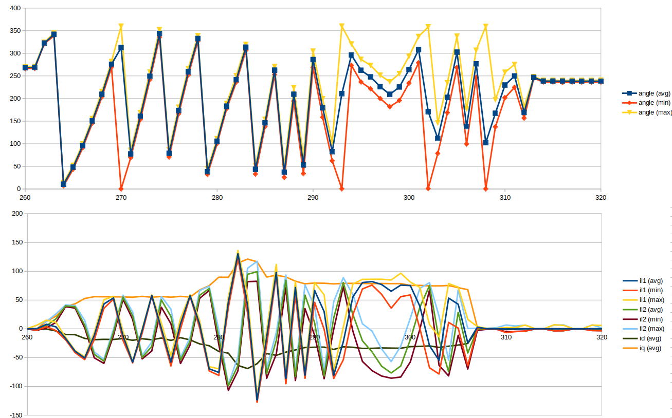

I think you can get il1 and il2 which would be enough and only need the controller angle (the others are just there as standard on my plots and not easy to remove).Bigpie wrote: ↑Wed Sep 21, 2022 10:39 am Not sure, not sure it's possible to plot the currents of each phase, with the current software, nor differentiate between controller position and motor position?

The time resolution on that has improved to 0.3sec so the 100 points does help. It's still only the first few seconds that have good enough resolution though:
Edit - calculating the 3rd phase and plotting gives this - again all good. Edit2 - do the cut-outs tend to be low speed, high speed, low load, high load or fairly random?
That looks pretty good, the angle plot is a nice sawtooth with very little noise. The min, max and ave currents track each other and are a nice sinusoid. No obvious problems there at all which is great - but I'm now at a loss as to why you get the cut-outs and are only running at around half power!Edit - calculating the 3rd phase and plotting gives this - again all good. Edit2 - do the cut-outs tend to be low speed, high speed, low load, high load or fairly random?

This is the current plot for the complete run:
Edit, looking at the time axis guessing the former.
It's very intermittent, was this you coming on and off the throttle or was this the juddering?Edit, looking at the time axis guessing the former.

The cutouts can occur in 2 situations from what I can tell, is accelerating from standstill at high throttle, i.e. trying to setoff more quickly than usual. It starts moving very briefly then cuts. The other situation is when for example merging to motorway and trying to gain speed quickly and so at pretty high RPM, very much over 10k.
I can only think it's overshooting causing the problem?
On and off the throttle, going forward a little, putting it in reverse going backwards and repeat.

Another plot showing a section in the middle, nothing wrong with that at all!
On the high speed one it might be worth trying the build of code that I did for Ev8 which has a bit of sync compensation which will help at high speeds, let me know if so.
From standstill will give some pretty fast motor movement/rates of change as all the slack in the drivetrain is taken up. Does it still do it if you use a little bit of throttle to take up the slack and then accelerate hard?On the high speed one it might be worth trying the build of code that I did for Ev8 which has a bit of sync compensation which will help at high speeds, let me know if so.

Taking up the slack first still has the issue even rolling at a couple of mph the same. Not a big issue day to day, but would be nice to understand why and irradicate. I've not played with curkifrqgain as the higher speed cutouts are even less of an issue daily as I don't tend to need to accelerate to higher speed quickly often.
I'll try plot with even fewer points see if that highlights anything
