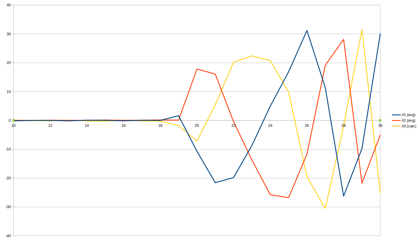

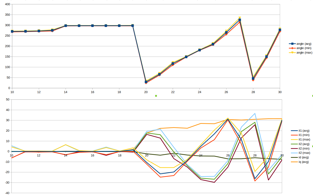

The time resolution on that has improved to 0.3sec so the 100 points does help. It's still only the first few seconds that have good enough resolution though:
That looks pretty good, the angle plot is a nice sawtooth with very little noise. The min, max and ave currents track each other and are a nice sinusoid. No obvious problems there at all which is great - but I'm now at a loss as to why you get the cut-outs and are only running at around half power!
Edit - calculating the 3rd phase and plotting gives this - again all good.
Edit2 - do the cut-outs tend to be low speed, high speed, low load, high load or fairly random?
