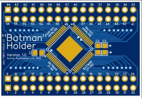

Re: Tesla Model 3 Battery Hacking
Getting this board made up at moment,
And batman chip placed on it, so can swap between porotype boards
Then hopping to look at reading data once I get some hardware

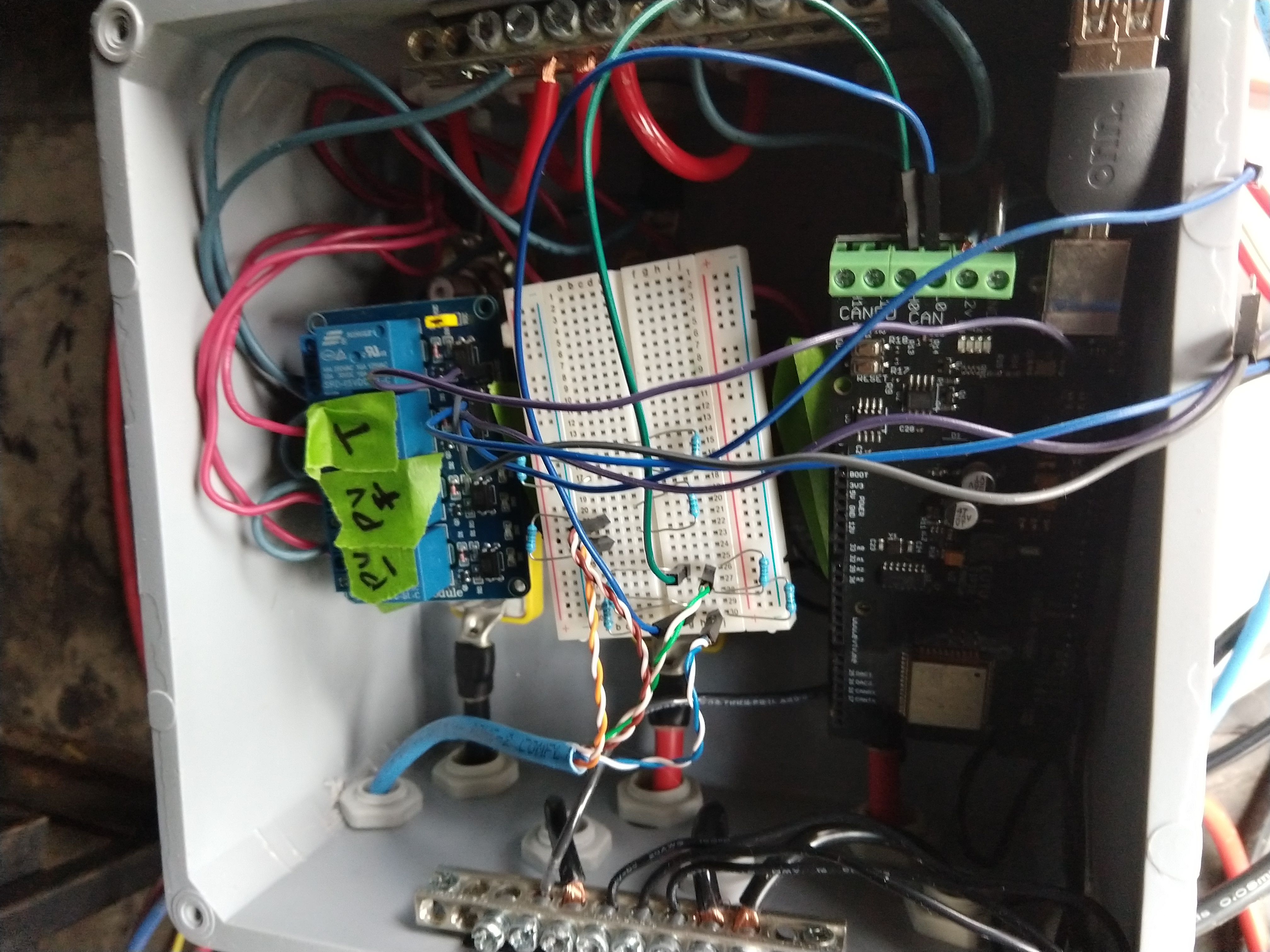

Hi all, this is my first post in this forum. I am converting a VW T3/Vanagon camper to Tesla Model S small drive unit and using Tesla Model 3 75 kW batteries.
My background is that I am a mechanic, not an electronis guy. I have been servicing and maintaining this van for a customer for about the last 20 years. Now we are taking the plunge into EV. The customers daily car is a Model 3
A bit more info on this project. The original plan was to use a dilithium BMS and Elcon 3.3kW charger and DCDC convertor. And we are using a T2C controller. All scourced from EVWest.
Then we decided that the 3.3kW charger would take forever to recharge the battery and so we scourced a Tesla Model 3 10kw PCS charger.
Bratitude assisted us with obtaining a EVBMW V3 PCS controller which I am in the process of installing and hope to turn it on and test it in the coming weeks. Again advice from Angus was to use the Tesla BMS and not the Dilithium BMS. And thus started the search for info on how to accomplish this and I came upon this forum and have spent a few days reading stuff here.
There seems to have been very little chat in this forum for a long time. Does this indicate that the EVBMW batman boards are now working successfully? They seem to be available in the EVBMW webshop.

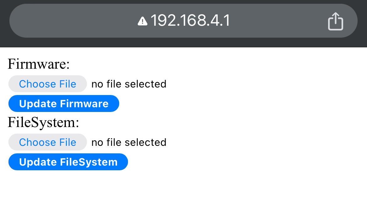

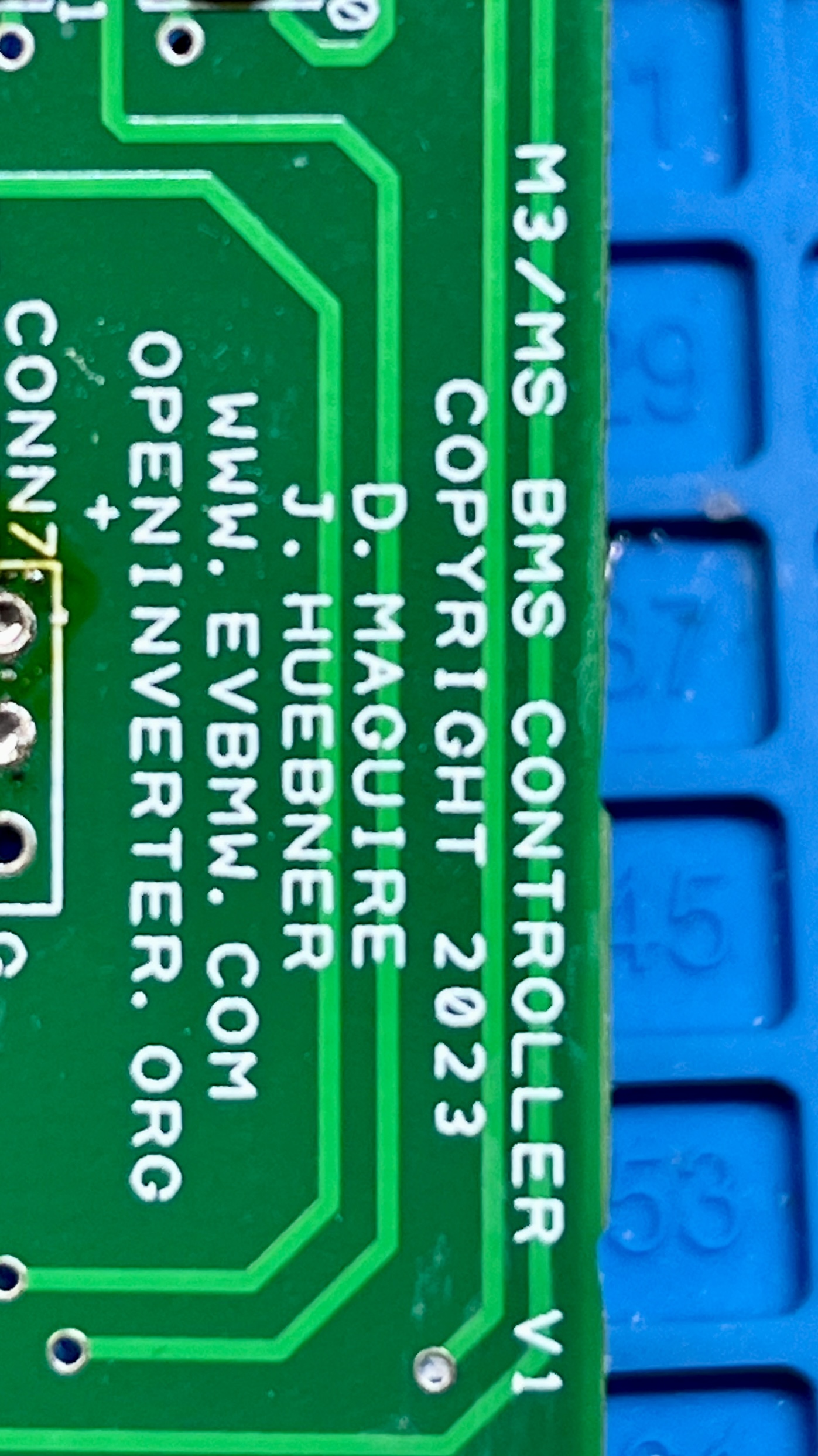

Hi, I have the Batmanboard (aka M3/MS BMS Controller V1) and transplanted the Batman chip from one of the harvested slave boards on it. Build up my test scenario, so have a other Slave Board connected to 23 batterie cells to siulate a block, connected SPI (p/n). But I did not get readings (Web-Interface). I can see that the Slave Board sends data to the batman STM32 board, but the register are not filled, also after SPI p/n swap. Then I did a mistake, thought I just have to use the latest version from Github, uploaded the bin file and now the Batmanboard is not working anymore. asking for a new Firmware or filestructure file (Wifi only). On Github I could not find the default file to fash again the STM32 chip. Where could I find that file to get my batman STM32 board working again?
Thanks for any hint.
- Posts: 6969
- Has thanked: 455 times
- Been thanked: 1771 times
I don't quite understand which part you flashed. The ESP Wifi board? Because "asking for a new Firmware or filestructure file " means the file system of the ESP8266 was lost. In this case look here: https://openinverter.org/wiki/Olimex_MO ... bInterface
Wifi Module WEMOS D1 still connected to my infrastructure and when opening the 192.168.4.1 it asks for update Firmware or update Filesystem. Will try your lead, thanks a lot.
Update: Finally I spared some time to get my board up and running again. Now I have connected that with a full pack (4 Slave BMS). Has had anyone else the problem that only 88 cells are present instead of 96? I have made reference measurments, taken the total voltage divided with average V from Cells and came up with 96. But the Board reports only 88 cells. Any idea where I could find an path to get the value from all 96 cells?

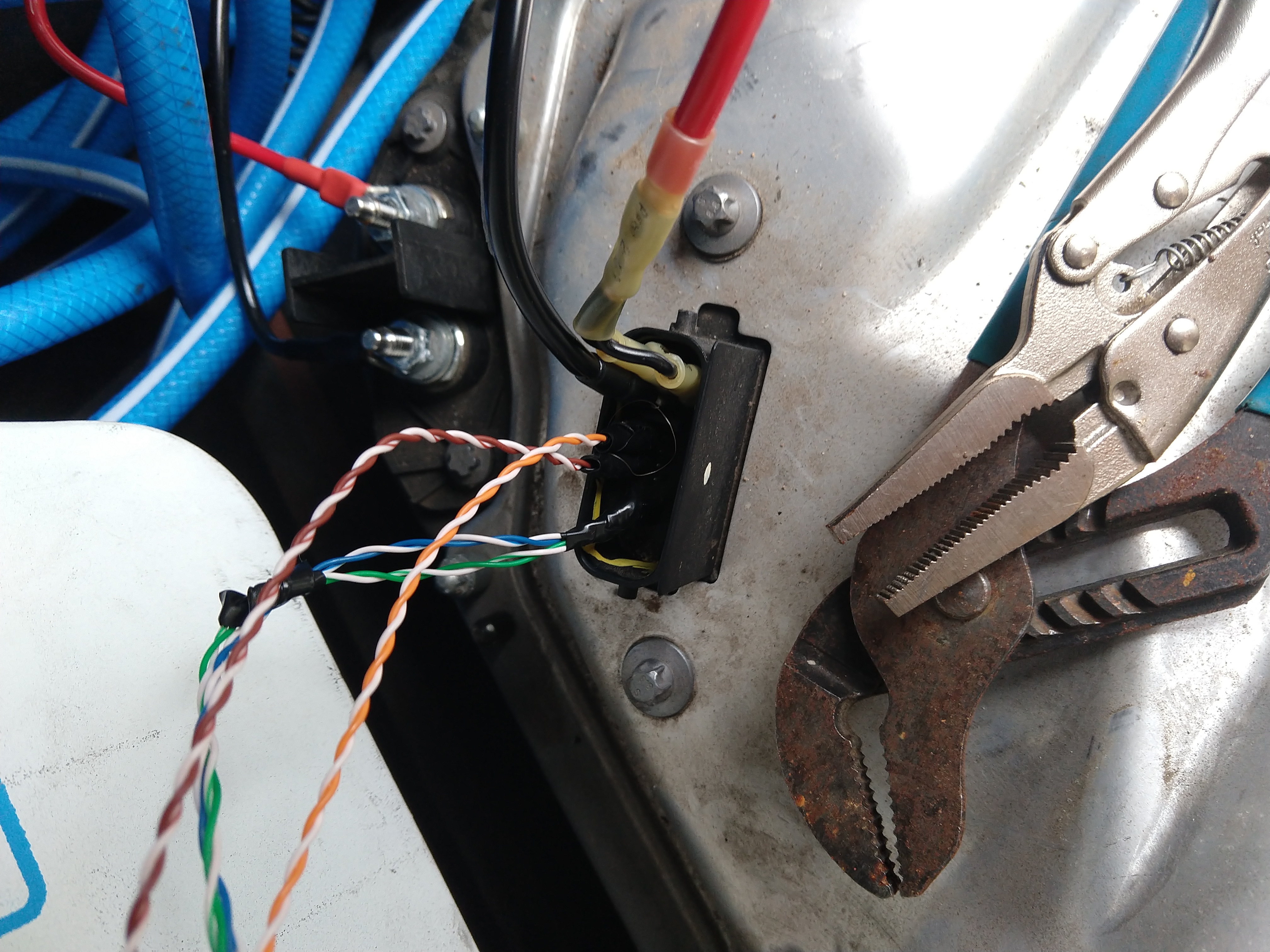

I also have lengthened cables due to use of custom battery boxes. I just extended the cables with twisted shielded aerospace wire, so far it seems to work ok with the ISOSPI bus. On my Tesla ISOSPI wires with the purple connectors, green is ISOSPI + and white is ISOSPI -TastyGuac wrote: ↑Tue May 21, 2024 1:21 pm Does anyone know what kind of connector is used between the BMB slave cards? Its the purple connector between the modules. I have the T2C controller with the BMS option. The modules are in a custom box, so I need lengthened cables.
Looks like there are vias on those circuits that I could tap into if needed, but I'd like to use the actual connectors if possible.

Hi Tom, I have not yet bussed the modules together and so far have connected the BMS controller individually to both of the short modules (23s) and one of the longer (25s) ones. There didn't seem to be any issues with the longer module; all 25 cells were recognized and showing voltages. I will be able to put some more time in this weekend, let me know how i can help troubleshoot.
