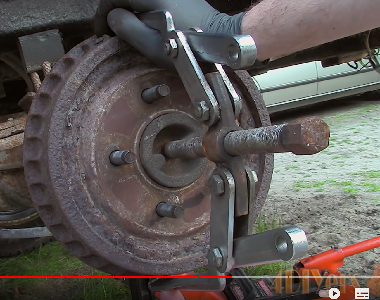

johu wrote: Thu Aug 11, 2022 3:53 pm ... Had to cut the one drum apart because it wouldn't come off...
Oh god, our very early prototype had a drum that was badly seized:
pulling technique on YouTube <-- this is what I did back then. The twisting big bolt in the middle there didn't work for me, I used a car jack to rip it the drum off with an improvised grabber similar to what he has in the video there.
I am sure "real" mechanics have endless stories about this stuff.
