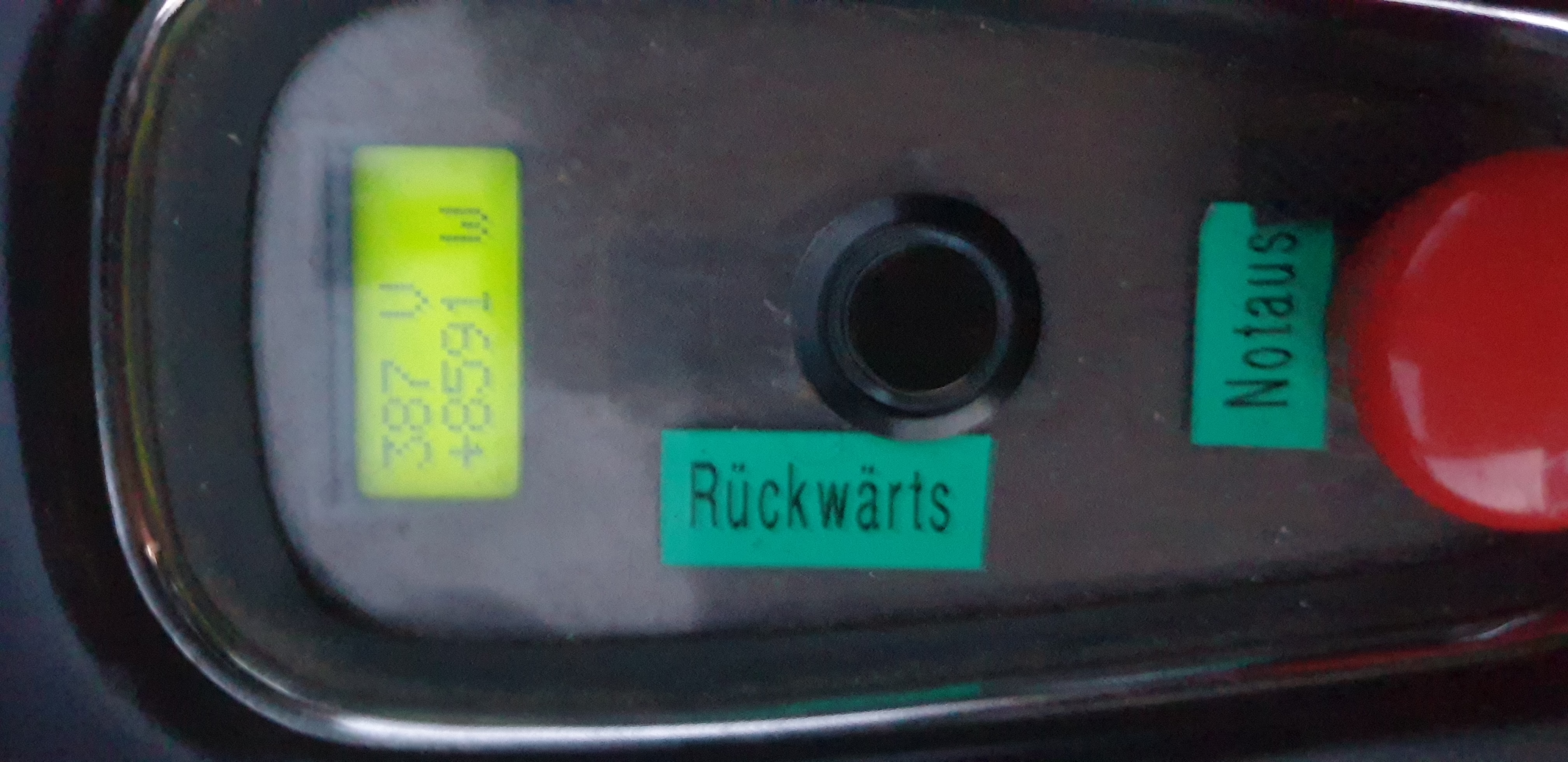

Ok i have an issue.
Not with the charger... it runs just fine.
Not with the board... it also does its job.
Maybe the formware? Or my settings?
I replaced 3x of my 3kW eltek chargers which were charging ar 9kW but would not abide by EVSE Cp signal.
I put in Tesla gen2 charger and used open source firmware with serial setup.
I did setup in evse mode with 20A phase limit.
Charger only goes up to 8.5kW! Why would that be? And i tested at various voltages as to eliminate constant power tapering. Also i tested on various L2 EVSE in Slovenia. See the photos.
Did anyone come across similar behaviour?

Hi, are you using the arduino code with SAM3X version of the board? In that case you can plug in USB cable and open serial terminal in arduino. It reports very clearly what each charger is doing and what amperage it is charging at. Can you take a look if each charger is charging at 16A AC? It also shows there what cable limit it is receiving from EVSE. Or can you take a screenshot?

I am using Tomdbs arduino code compiled evidently for stm32 chip on my v5b3 board. Did you notice similar behaviour with your version?m.art.y wrote: ↑Wed Aug 10, 2022 4:30 pm Hi, are you using the arduino code with SAM3X version of the board? In that case you can plug in USB cable and open serial terminal in arduino. It reports very clearly what each charger is doing and what amperage it is charging at. Can you take a look if each charger is charging at 16A AC? It also shows there what cable limit it is receiving from EVSE. Or can you take a screenshot?

Didn't know this version of firmware existed where did you find it? I'm using Tom's firmware on SAM3X board. So can you access serial debug info at all? Mine works and AC current ramps up to 16A max but then it drops to ~2A and ramps up again, does this every 10 seconds or so..

In the binary folder of Damiens repo. He seems to have it ported to STM32m.art.y wrote: ↑Wed Aug 10, 2022 7:56 pmDidn't know this version of firmware existed where did you find it? I'm using Tom's firmware on SAM3X board. So can you access serial debug info at all? Mine works and AC current ramps up to 16A max but then it drops to ~2A and ramps up again, does this every 10 seconds or so..
https://github.com/damienmaguire/Tesla- ... are/Binary
That is exactly what i am seeing. Goes up to 8.5kW and dances about 500W. Could that mean each of the modules sees something faulty in its CAN command and starts to reduce but is then overcome by correct telegram? Or is it that Cp sensing is not very precise. I count some 2m of unshielded wire from socket to charger.
Yeah... about debug... the way i installed the charger i have to gat it down and take the lid off. My plan is to put a small cable through the lid and use it to connect to FTDI to have serial connection. Then i will be able to see debug...any day now.

Post a canbus log of it and I will take a look at it. From turning charger on couple of those cycles and turning off.

I wasnt able to connect to CAN even with the alternative firmware.EV_Builder wrote: ↑Wed Aug 10, 2022 8:45 pm Post a canbus log of it and I will take a look at it. From turning charger on couple of those cycles and turning off.
I will setup a twisted pair as well then...
