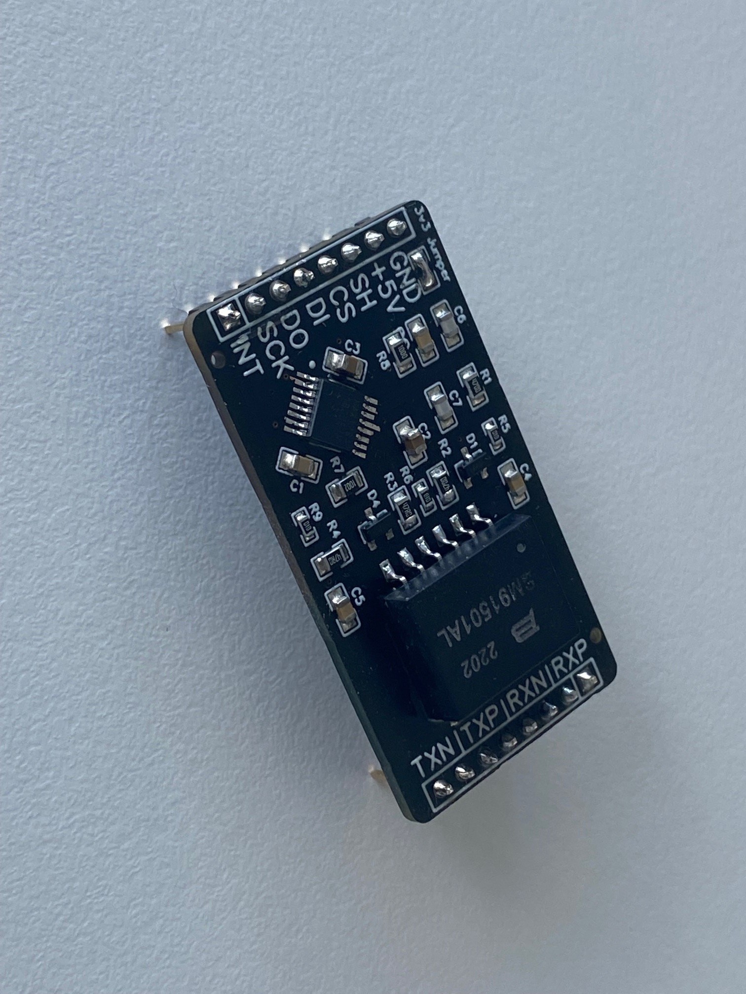

I have a couple of MAX17841 interface boards left if someone is interested. 40eu.
Pm me for schematic.

Re: Peugeot e-208 CATL modules BMS interface
My clanarn MAX17841 board arrived today - thanks!.
Time for some wiring and coding. Wish me luck...
Some progress, but now a bit stuck - help appreciated.
Status:
- microcontroller talking to MAX178741B master board. Using code published on here, many thanks to authors (Anton and Chris mentioned in header, apologies if I should also thank others)
- about 0.8v ac can be seen between TxP and TxN, as sent from the master to the first slave in the daisy chain
- connected to (2) slaves via the original BMS loom from the pack
- Pinouts master -> slave found on here (thanks!). All consistent with the physical world (wire colours and continuity test) so I am pretty sure I have the two tx pins from the master connected to the rx of the first slave (and tx from slave to master rx, obviously). Not sure they are the right way round (neg pos), but have tried swapping.
- Have terminated daisy chain after the second module by connecting pins per posts on here
Not working:
I'm getting nothing back from the slaves when the code reaches the DaisyChainInit() stage. We seem to be sending 0x01 to read the rx status register and hoping for a 0x21 return, to indicate that the daisy chain has woken up. This times out and I can't get any further.
I wondered whether the slaves need a separate reset or power supply, but reading the slave data sheet, it looks like you can just send signal via the UART and a charge pump will set the reset pin (so only need UART comm signal to wake up a slave, after which it draws its supply from the main battery)
I'm sure I am missing something obvious.... apologies for dumb question, but suggestions welcomed if you have any. Thanks!
Status:
Not working:

I thought I would put together a list of things I have found out about the Peugeot e-208 CATL modules.
Firstly a big thank you to Clanarn for designing the master board, bexander for the software and chris01290 for software and general advice.
The e-208 modules use the MAX178xx family of devices. e208 modules using Max17823B and the master to control these is MAX17841B as the master controller.
Clanarn has made a niffy little board using the MAX17841B, please bear in mind that this board only uses the 4 middle pins on the TX/RX end.
ie
TXN pin 1 Not Used
TXN pin 2 Not Used
TXP pin 3 is TXN and goes to pin 1 on Module 1 (RXNL)
TXP pin 4 is TXP and goes to pin 7 on Module 1 (RXPL)
RXN pin 5 is RXN and goes to pin 8 on Module 1 (TXNL)
RXN pin 6 is RXP and goes to pin 3 on module 1 (TXPL)
RXP pin 7 Not Used
RXP pin 8 Not Used
Wiring on the Modules, look at the rear of the connector plugged in the module the right way up. Pin 1 Top Left, Pin 6 Top Right, Pin 7 Bottom Left, Pin 12 Bottom Right
Pin 1 RXNL
Pin 2 blank
Pin 3 TXPL
Pin 4 blank
Pin 5 goes to pin 8 on Module 2
Pin 6 goes to pin 7 on Module 2
Pin 7 RXPL
Pin 8 TXNL
Pin 9 blank
Pin 10 goes to pin 3 on Module 2
Pin 11 blank
Pin 12 goes to pin 1 on Module 2
and so on until the end when Pin 5 loops back to Pin 12 and Pin 6 to Pin 10, the end of the daisy chain.
I believe the original wiring harness twists the wrong pairs!
The Cells are connected to the first six Channels, so voltages are read from the address 0x20 to 0x25.
Now onto the cell temperature sensors. each module has three NTC and are not contacted as the MAX chip manufacturer recommends.
Being three the board uses a combination of two logic gates, which use GPIO 0 and GPIO 1 to switch outputs/inputs
Address 0x11 drives the GPIO,
so 0x7001 selects NTC1 and NTC2 with NTC1 connected to AUXIN1 and NTC2 connected to AUXIN2
and 0x7002 select NTC3 connected to AUXIN2, AUXIN1 is left unconnected and should not be stored.
I have also found that the THRM voltage needs to be switched on to let the circuit settle. I leave it on by using address 0x19 0x0310, the 3 is the THRM on and the 10 is a small delay, may not need it.
The address 0x2D is for NTC1 and leads with the LSB then MSB. Shift the LSB 4 to the right and MSB 4 to the left and add the two together
measTemperature = ((readRegisterData[3 + (i * 2)] << 4) + (readRegisterData[2 + (i * 2)]>>4));
i being the module number.
Address 0x2E for NTC2 and 3
The good news is the read-out is linear.
So for NTC1
temperature = (measTemperature - 1680)/32;
and for NTC2 and NTC 3
temperature = (2450 - measTemperature)/31;
Both in C
I was not allowed to take over control of the freezer for a couple of days, I was told that was a step too far. So freezer packs and hair dryier were used, and the readings were linear I just may be a deg or two out.
By the way, NTC1 is in the middle, NTC 2 and NTC 3 are next to the module terminals.
I have not added the documents for the MAX178xx family as these are already been added to this post along with examples of software.
Hope this helps.
Joe

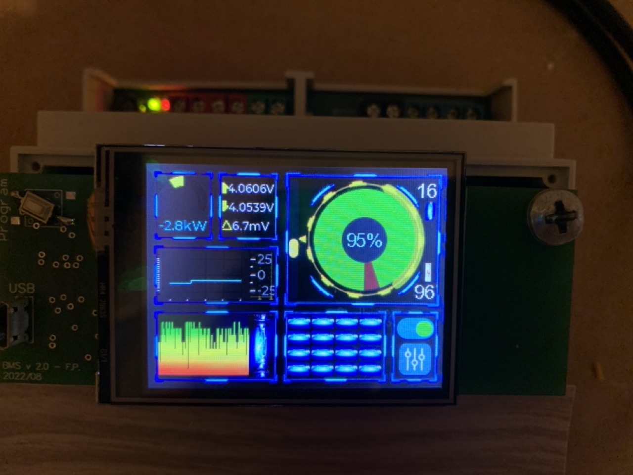

Anyway having quadruple-checked my wiring, I am now up and running. Thanks to all for the help.
Little test with 2 modules:
@inaglasshouse
Can you do a part list? Maybe some picture and diagram with connection?
Yellow box and display look nice.
BR.
BR.
Congrats, to success, now the funny part can begininaglasshouse wrote: ↑Mon Aug 29, 2022 3:01 pm
btw, nice visualization of data on display.
I can share some photos of my BMS here for inspiration. its designed onto DINrail mount:
Its from test desk without covers and it include HV contractor.
Nice!ecertik wrote: ↑Tue Aug 30, 2022 9:23 pm Congrats, to success, now the funny part can begin
