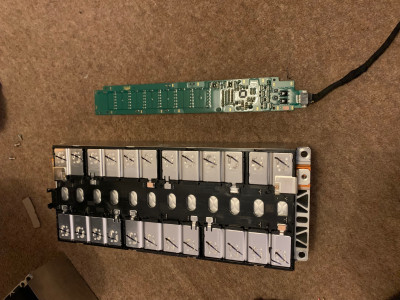

Has any work been done to interface to the BMS on these?
CATL Battery Module 2P6S 2.74kWh 21.9v 2737Wh
taken from Peugeot e-208

These modules do not have any BMS system in the modules. Or are you talking about the BMS ecus?

I assumed all manufacturers where putting the bms on the modules now and saw some advertised on eBay, which stated bms on board

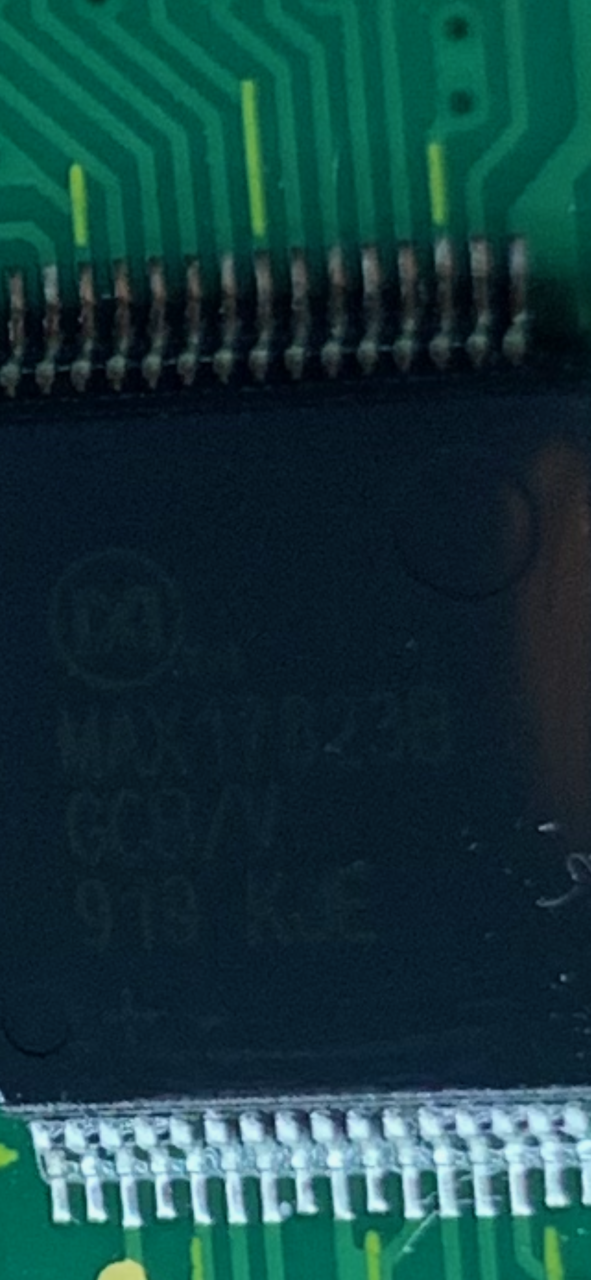

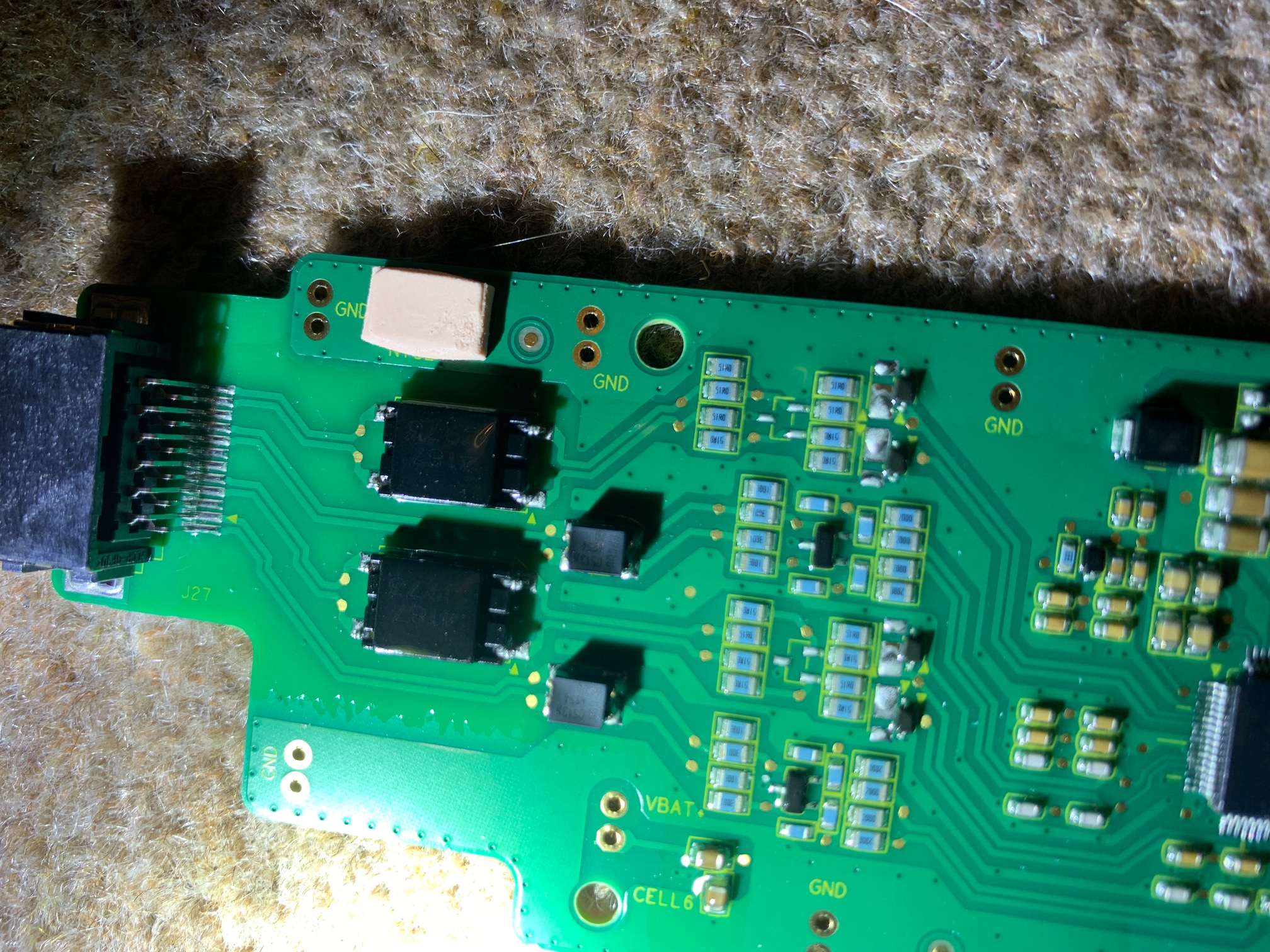

These CATL modules are using a MAX17823B chip.
Data sheet is available for it seems to be a dedicated BMS chip.
Looking at the loom its wired in a daisy chain.
Has anyone interfaced to these before ?
Might just save me some work
See images attached
See images attached

Yes they use a max17823 chips which other manufacture's have used, There is a max17841 interface chip which make interfacing allot easier. data sheets arfe easy avala ble if you google the chip numbers.
Also have a read through this
https://openinverter.org/forum/viewtopi ... 335#p20335
I got one of the interface boards using the max17841 developed by 'bexander' and 'Clanarn'. The base code used was from 'bexander'
I have comm's to all 13 of the packs i have in the pack i have built for my proiject. i am in the process of intergrating the code into SIMBMS.

I am just away on holiday but can supply the pin out when I get back. I asked the breaker to supply the comms cable from the donor car, small things like that can really help

looking at the connecter starting pin 1 top left, 6 top right ,7 bottom left, 12 bottom right
pin 10 TX1, pin5 TX1
pin 6 RX1, pin12 RX10
Pin1 TX2 (next module), pin7 TX2 (next module)
Pin3 RX2 (next module), pin8 RX2(next module).
to daisy chain modules:
pin 1 connect to pin 12 of the next board
pin 7 connect to pin6 of the next board
pin3 connect to pin10 of the next board
pin8 connect to pin 5 of the next board
repeat for the number of modules you have then terminate last module by connecting pin1 to pin 8 and pin3 to pin7.
to give you a quick check measure with a multi meter if you have the correct tx pins they will show up as low resistance as they use a isolating transformer to tx the output signal this shows up as low résistance on a multi meter.
