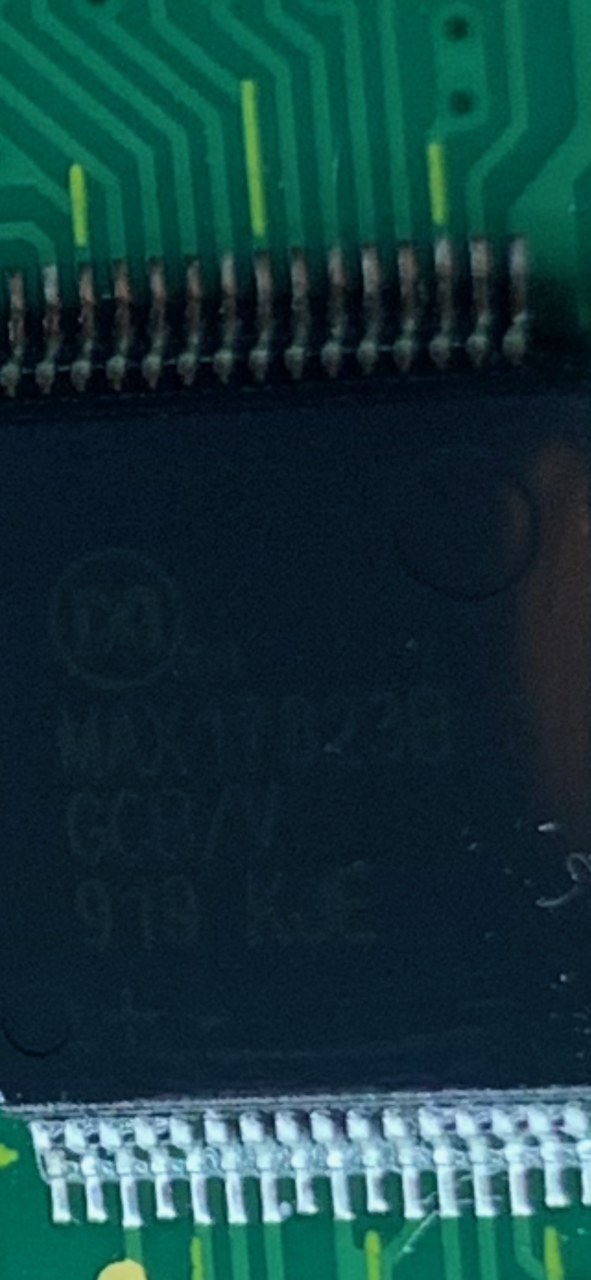

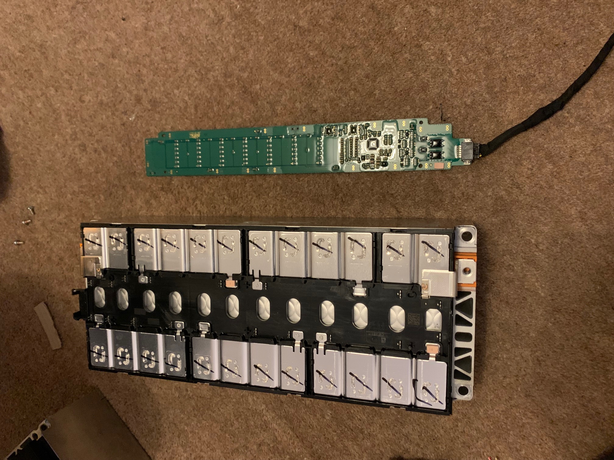

Re: Peugeot e-208 CATL modules BMS interface
These CATL modules are using a MAX17823B chip.
Data sheet is available for it seems to be a dedicated BMS chip.
Looking at the loom its wired in a daisy chain.
Has anyone interfaced to these before ?
Might just save me some work
See images attached
See images attached

Chris - I notices that you have had one of the boards off one of the batteries, did you work out what cells contact to what pins. Is it a straight C0 to C6 or are they gaps? Also, do the batteries have one or two thermistors. Thanks

Yes these modules use the first 6, although the code I have written auto detects and can handle any config, I have the die temp working and a reading the thermistors the first thermistor I get a value but does not seem like a correct value I need to check the calculations. The second I am just getting 0.
