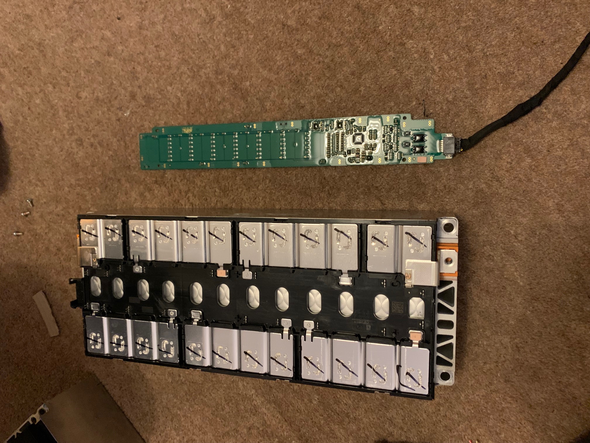

chris01290
Posts: 15
Joined: Mon Jan 03, 2022 10:28 am
Location: Ayrshire
Re: Peugeot e-208 CATL modules BMS interface
Post by chris01290 »
These CATL modules are using a MAX17823B chip.
Data sheet is available for it seems to be a dedicated BMS chip.
Looking at the loom its wired in a daisy chain.
Has anyone interfaced to these before ?
Might just save me some work
See images attached

Yes they use a max17823 chips which other manufacture's have used, There is a max17841 interface chip which make interfacing allot easier. data sheets arfe easy avala ble if you google the chip numbers.
Also have a read through this
https://openinverter.org/forum/viewtopi ... 335#p20335
I got one of the interface boards using the max17841 developed by 'bexander' and 'Clanarn'. The base code used was from 'bexander'
I have comm's to all 13 of the packs i have in the pack i have built for my proiject. i am in the process of intergrating the code into SIMBMS.
It appears the different manufacturer's are using the same chip even different battery configurations as this chip can monitor upto 12 cells.

looking at the connecter starting pin 1 top left, 6 top right ,7 bottom left, 12 bottom right
pin 10 TX1, pin5 TX1
pin 6 RX1, pin12 RX10
Pin1 TX2 (next module), pin7 TX2 (next module)
Pin3 RX2 (next module), pin8 RX2(next module).
to daisy chain modules:
pin 1 connect to pin 12 of the next board
pin 7 connect to pin6 of the next board
pin3 connect to pin10 of the next board
pin8 connect to pin 5 of the next board
repeat for the number of modules you have then terminate last module by connecting pin1 to pin 8 and pin3 to pin7.
to give you a quick check measure with a multi meter if you have the correct tx pins they will show up as low resistance as they use a isolating transformer to tx the output signal this shows up as low résistance on a multi meter.

Chris - I notices that you have had one of the boards off one of the batteries, did you work out what cells contact to what pins. Is it a straight C0 to C6 or are they gaps? Also, do the batteries have one or two thermistors. Thanks

VWJoe wrote: Fri Jun 24, 2022 6:29 pm Chris - I notices that you have had one of the boards off one of the batteries, did you work out what cells contact to what pins. Is it a straight C0 to C6 or are they gaps? Also, do the batteries have one or two thermistors. Thanks
Yes these modules use the first 6, although the code I have written auto detects and can handle any config, I have the die temp working and a reading the thermistors the first thermistor I get a value but does not seem like a correct value I need to check the calculations. The second I am just getting 0.
