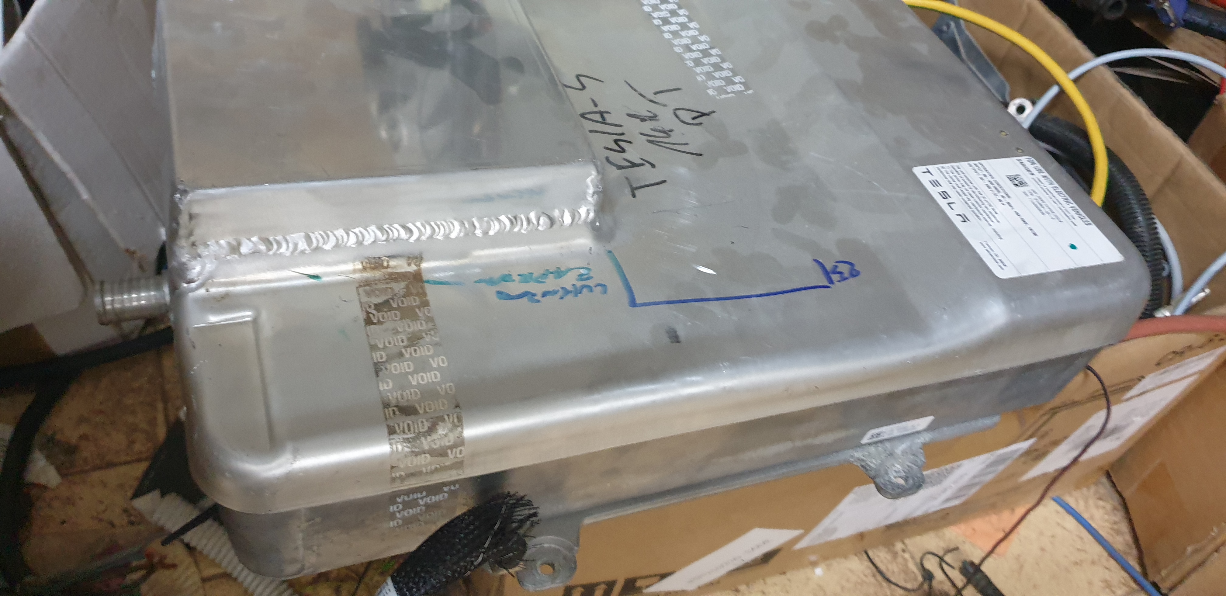

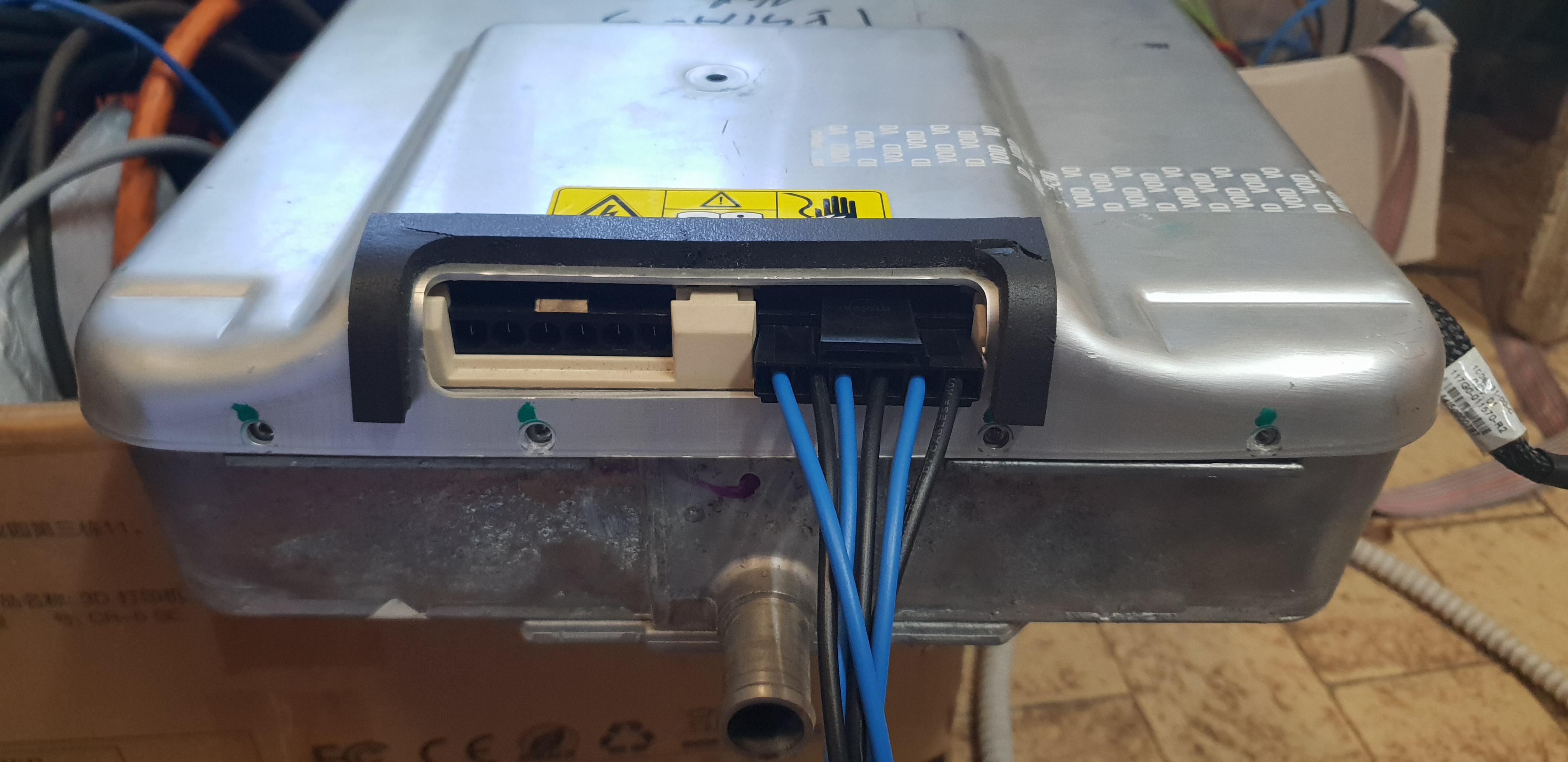

Hi All

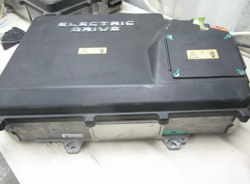

I am working on my Tesla charger 2nd gen. I am trying to fit it under the seats. Not a problem for now. But i see a specific problem in future, weatherproofing! Did any of you implemented his charger in a car on the otside? How did you deat with weatherpoofing? It is not exactly IP67 class.
Also there is not much room for grommets or cable fittings.
I have in mind a simple formed alu sheet glued to Tesla case with wires coming out of two holes. I want to glue those wires with automotive gasket sealant which when hardens is still flexible enough to dampen vibrations somewhat.
Does anyone have another idea? A fresh view would be most welcome.

arber333 wrote: Sat Jun 11, 2022 9:05 am Hi All
tnx
Would a 3d printed cover that goes over the connectors work in conjunction with a tpu seal that goes on the side of the top side of lid?

Yes or just weld up a hollow tube like a 60*30mm cut out the corner of the lid and cap the ends and weld or seal it to the lid.
Then you have some distance for two IP67 glands.
Other possibility might be to undo the connector inside the charger and move it / start from there with other type of connection and just finish the lid with piece of sheet and try to add the glands there.
The Panamera has huge void where the battery is in the back I'm gonna swap the battery for a small one and add the charger and DC/DC there..wish me 🤞

EV_Builder wrote: Sat Jun 11, 2022 5:52 pm Other possibility might be to undo the connector inside the charger and move it / start from there with other type of connection and just finish the lid with piece of sheet and try to add the glands there.
Hm... I could remove plastic floor with connectors fittings and replace it with just plastic sheet. Then i could get one additional box welded up on the plateau, cut out part of it and also weld up the front. Since i would then got another box maybe 25mm higher there would be enough room for two glands on the front where there would be additional glacis. I will make a mockup and some photos tomorrow...

You could 3D print a cover similar to what they did for the MB B class Tesla powered stuff to weatherproof. This was under hood I believe. Probably needs to be a two piece print unless you have a CR10 MAX or larger.

FFF 3D prints are not watertight and are total garbage for EMI.
Are you sure the MB cover is not backed or cored with metal? That plastic piece may simply be double insulation to get around a safety compliance rule.

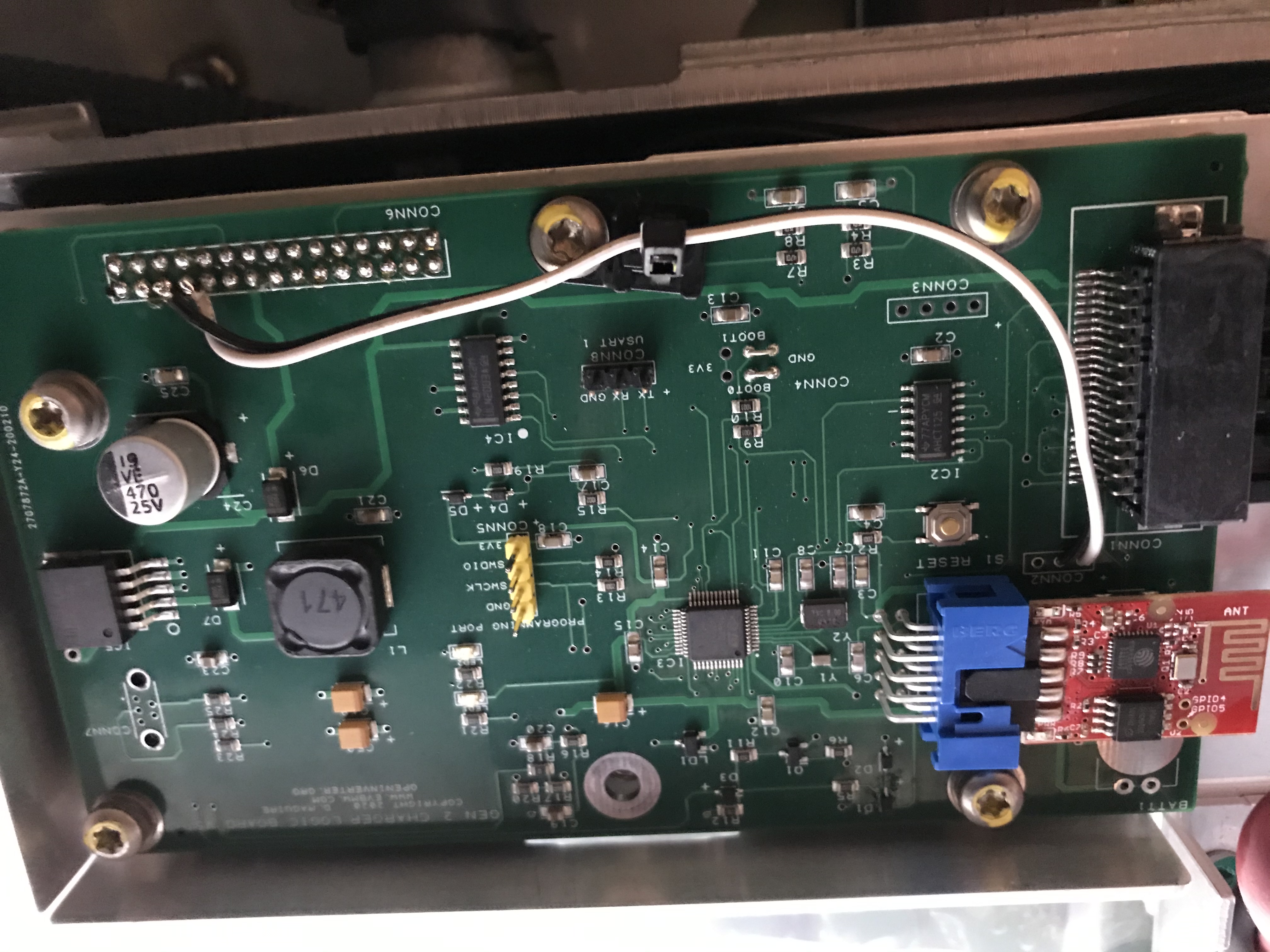

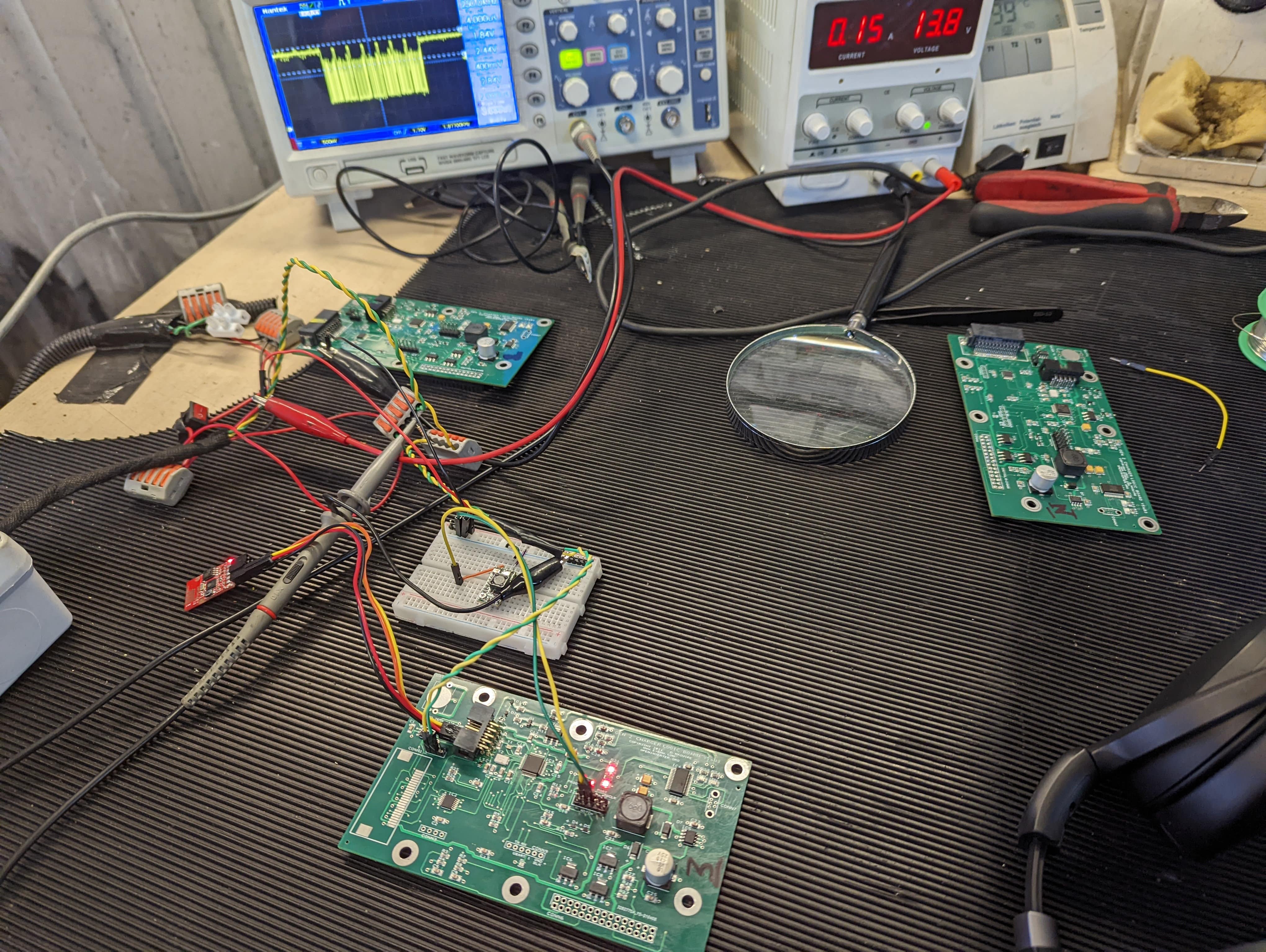

I cant seem to connect to my tesla rev2 charger via serial.
I got the V5aB3 board from Damien and i soldered USB type B connector and FT232 chip to the left side. When i prepared to connect to the board i connected AC and DC and powered the board via 12V. Then i connected USB cable. Immediately both leds went out and i couldnt get response from PC USB. Did i turn my FT chip the wrong way?
Is it possible to connect via connector9? I can connect with FTDI and power the main chip up. But i cant get any response. What am i doing wrong?
EDIT: both FT232 leds just lit up and stay lit no matter what i connect to... also FT is really hot to touch. I guess it is broken.
tnx

arber333 wrote: Sat Jun 11, 2022 9:05 am Does anyone have another idea? A fresh view would be most welcome.
You could build an enclosure for it or cover it with some sealant.
Another option is to use gen3 Tesla charger that one is better in that regard, would still reguire some rubber or sealant in the wire holes but much less. I have a few of the gen3 ones for sale.

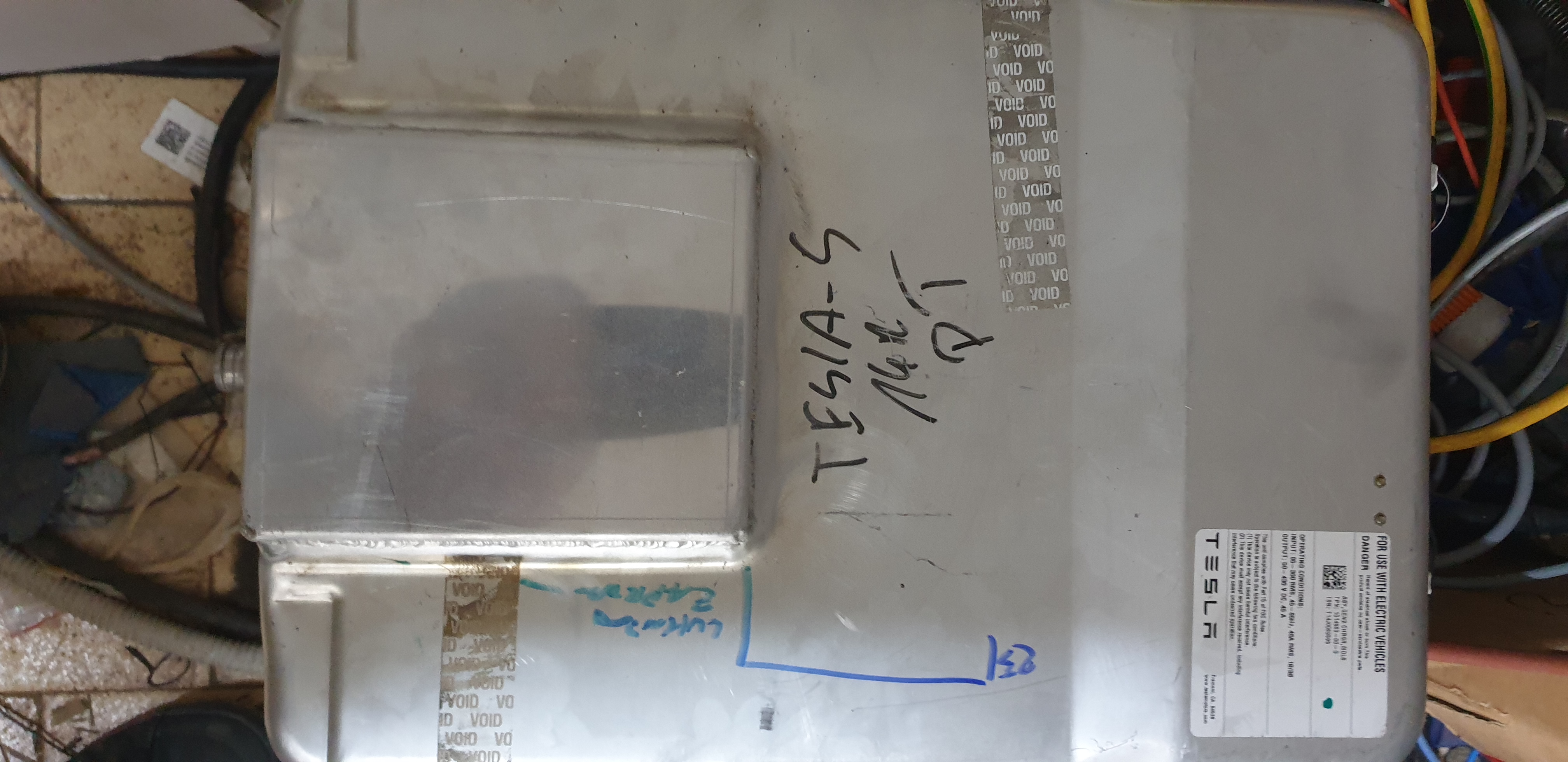

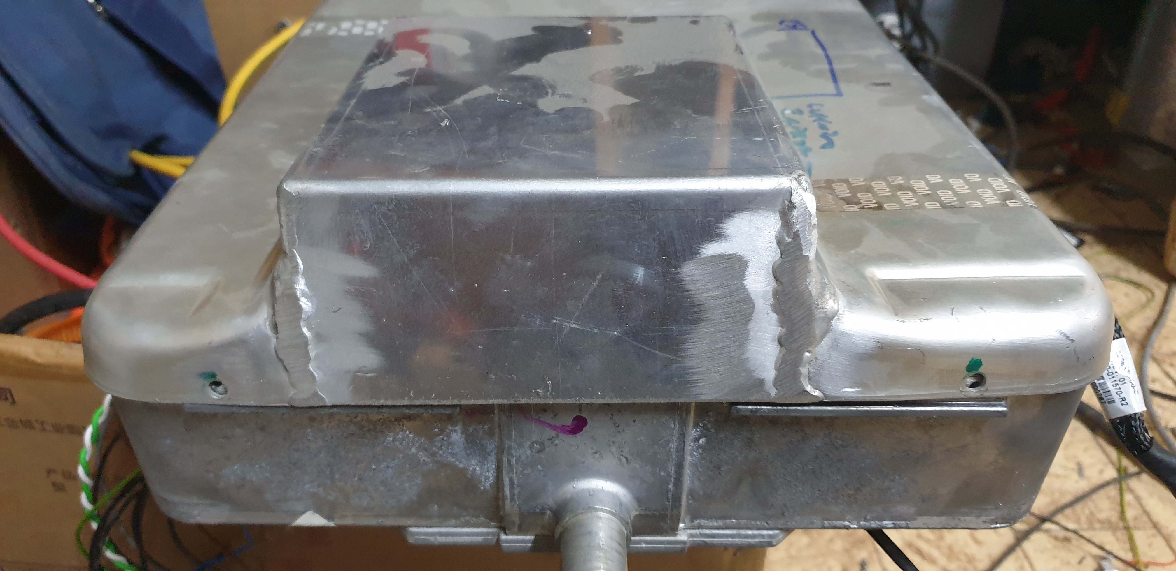

ImageOK, i got the charger to work.
But i just couldnt access serial or CAN bus for original firmware. I had to reinstall open firmware.
I went around the FT chip and soldered some wires directly to FT chip input pins. Then i used FTDI module for Arduino and i got serial connection.
I went to setup menu and setup 15A charging up to 420Vdc. Charger will heatup fast without coolant and then it will derate.
On the other note i enlisted help from a welder friend who welded a small box over OEM chaarger cover for a straight surface. He warned me about the chance of alu material having too much magnesium. This could prevent welding and cause material to burn. Luckily that was not the case.
New cover will allow me to fit several glands there and make the charger IP67 :).

I really dont know what to say to all this. There is an extensive wiki article here describing how to use the board and firmware :
https://openinverter.org/wiki/Tesla_Mod ... age_manual
All boards are supplied pre programmed with commercial firmware with the pin entered which you access via the wifi interface as per the instructions in the wiki article linked above. The ftdi and usb are not populated because they are not needed.

Jack Bauer wrote: Thu Jul 07, 2022 9:17 am ....
True and i could tell it was commercial as the led was blinking. I just couldnt get anything from can bus. I tried with soldered and free termination pads. Also i tried multiple devices.
I could clearly see can traffic with my scope but my transcievers could not read it.
But i had to test if i had the working charger...
Any chance you could pm me the pin again 😁?

When you say couldn't access CAN, I assume you're referring external connection from the Molex connectors? If so, at least on the board version I have, they are not connected to the external pins by default. I needed to run jumper wires in order have external CAN comms.

jon volk wrote: Mon Jul 11, 2022 1:06 pm When you say couldn't access CAN, I assume you're referring external connection from the Molex connectors? If so, at least on the board version I have, they are not connected to the external pins by default. I needed to run jumper wires in order have external CAN comms.
No, i mean directly on internal CAN connector i could see CAN traffic with scope, but i couldnt negotiate connection with my CAN tools or arduino. Strange... I have V5b3 board.

arber333 wrote: Mon Jul 11, 2022 3:18 pm
Wheren't there fake can drivers shipped?
Check those drivers out first.

Plus make sure you're either using the older release firmware or this one: https://openinverter.org/forum/viewtopi ... 240#p42240
