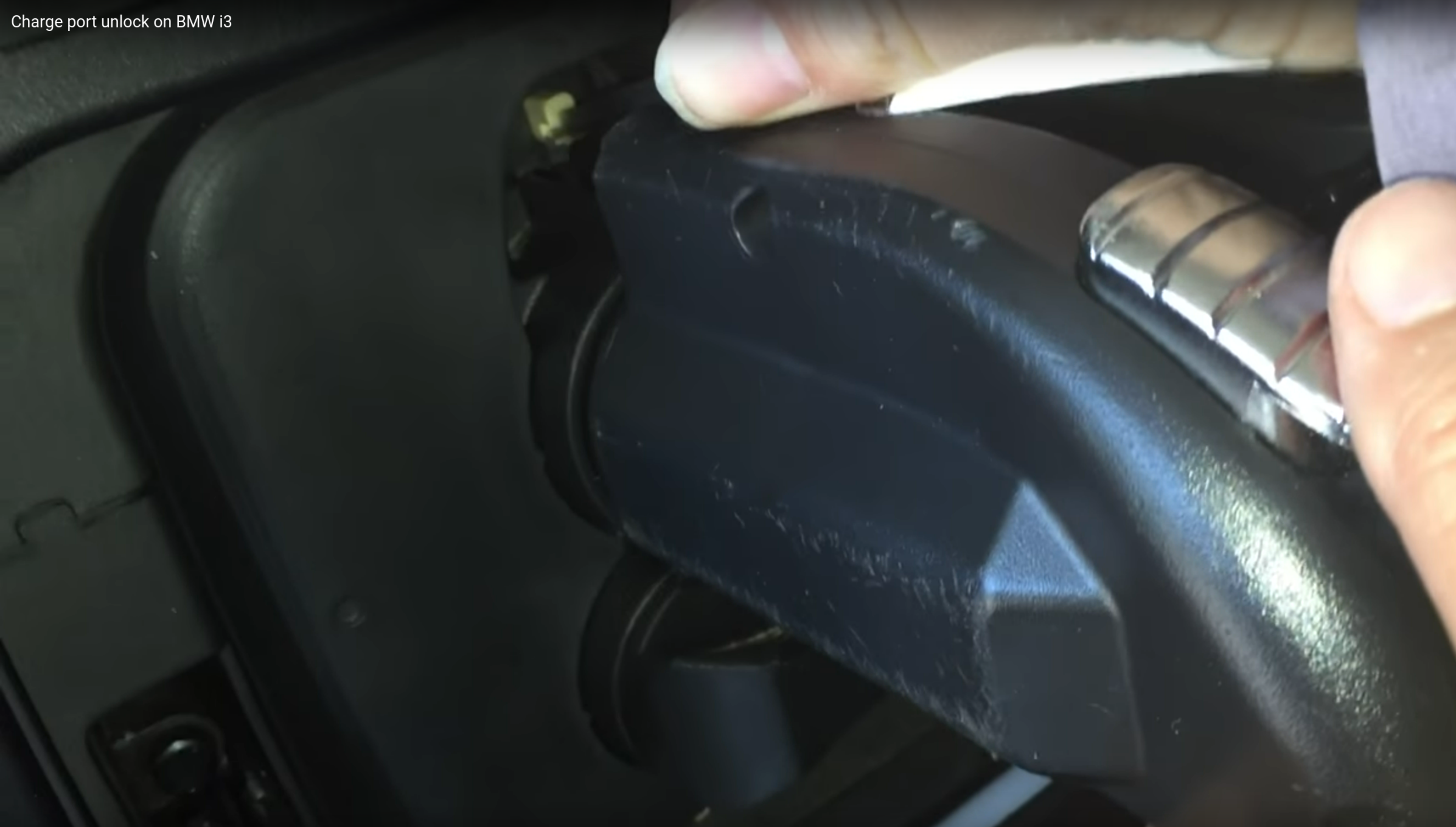

I have a question about charge port locking of CCS1 vs CCS2. The Wiki states: "Only important for Type 2 (3-phase) charge ports.", which to me implies that the charge port locking feature is not applicable to Type 1 (J1772) and/or CCS (1-phase) ports.
Via eBay, I recently purchased a BMW 6828092 charge port/cable assembly -- shipped from Lithuania, and supposedly from a 2016 model i3 -- which to my eyes looks like it's CCS1 with a Kuster cable lock actuator mechanism.
BMW i3 Charge Port (CCS2, 2016)
Here's a YT video of it in action:
Screenshot from that vid, where she's pushing on the end of the extended lock actuator to manually unlock the nozzle:
Manually unlocking CCS1 charge port
Another vid, showing a different angle on the same locking and how it prevents depressing the latch release button:
Apparently, sometime in late 2015 BMW redesigned the inlet to make it more difficult to just insert a tool to press back the actuator, but the actuator itself remains.
My questions:
1) Do I understand this accurately (CCS1 in North America does lock the charge cable/nozzle)? If so, should I update (remove) that line in the Wiki?
2) Does the North American CCS nozzle sense that the charge port's actuator has extended (locked) the nozzle to the port? Thereby refusing to DCFC if the actuator has not been extended? Some discussion I've read implies this. Put another way: does CCS1 in the US require a functioning cable lock for DCFC to operate?

Probably stating the obvious but all DC charging requires locking of the connector to the vehicle.
In CCS 1, a pin or lever in the receptacle holds down the latch of the CCS1 connector/plug/“gun” to prevent actuation of the button/latch and thus removal of the connector from the vehicle. Users typically can press hard enough to trigger the switch to stop charging but not to actually remove the connector. While not the way the standard was intended, a lot of locks on vehicles have some slack (along with latch flexy-ness) to make this possible. Notably, the i3 mechanism is a bit stiffer and therefore doesn’t quite allow this.
In CCS2, there are notches on the CCS2 connector that the receptacle lock grabs on to. Commanding this lock to unlock is done externally, typically with a button adjacent to the charge port.
Note proximity pilot handled is different between the two CCS styles:
CCS1 has a voltage divider with 5v (from the vehicle) and the button on top which actuates the latch changes the resistance and thus voltage drop (150 ohms normal, 480 ohms button pressed). While this arrangement is primarily for the EV to monitor, DC EVSE should also monitor proximity pilot for CCS1. Some but not all stations use the voltage pull up on the vehicle to detect a CCS1 vehicle. So, if you’re in a CCS 1 market, you need to get the car side right. The LIM provides the 5v supply on one of the pins for this purpose.
For CCS2, proximity pilot is a bit less defined for the car side, but overall there is a fixed resistance in the cable and the EV monitors it to know what is connected and immobilize the car. This is mostly to convey AC cable ampacity, but DC cables have a fixed 1.5k ohm resistance between proximity pilot and ground.
Pilot wire communications including the low level states and PLC are exactly the same between CCS1 and CCS2.
Oh and locking for CHAdeMO is handled within the cable and is controlled by the charger.
Tesla proprietary connector in NA is similar to CCS2 except the notch is on the bottom of the connector. The button on top has CCS1 arrangement but only electrically, with the button being a signal to the car to stop charging for both AC and DC, but the latch is completely handled car side. The pilot wire switches to single wire CAN for supercharger DC and some AC (for some Tesla AC EVSE).

Thanks for that, I appreciate the time it took to write, and "stating the obvious" is always a good idea as a preface, because here one cannot assume the technical level of your audience. For example, though I've driven an EV for five years, and we also own a 3-year-old Tesla in addition to that EV (the Tesla now for sale, as I don't like it, go figure), I have never used CCS, anywhere, and therefore while I'm by default my neighborhood's EV guru, I know more about Tesla and only sketchy theory around actually using CCS.
You have answered my Q1 "Do I understand this accurately (CCS1 in North America does lock the charge cable/nozzle)? ": yes. I have updated the Wiki and removed the reference to "Only important for Type 2 (3-phase) charge ports."
Q2 was: "Does the North American CCS nozzle sense that the charge port's actuator has extended (locked) the nozzle to the port? " Anecdotally (ref. is above) an i3 owner replaced a malfunctioning Kuster cable lock and zip-tied the replacement behind the charge inlet, so it was electrically connected but mechanically not engaging with the CCS nozzle. AC charging worked, DCFC did not. Then he mechanically installed the Kuster correctly, and DCFC resumed working.
How did the EVSE know that the nozzle was not mechanically locked?
It doesn’t. The vehicle tells the station that the vehicle is unable to lock. In all honesty a lot of vehicles handle the conveyance of failure to lock very badly, which results in weird charger error codes… but all should essentially stop the charge during the setup process, ideally at or before cable check, where the vehicle must lock the cable on or before that point.
The LIM is capable of monitoring the lock state and checks during initialization and continuously during the charge. I don’t know how the LIM handles telling the station of said lock failure but it clearly does stop the charge from happening. Could get me a pcap and I can tell you how well it does so.
As I sad about 10ish pages before, when incorporating CCS into your EV, having functional locking is absolutely 100% necessary. The station is trusting the vehicle to handle locking. There’s likely ways to trick the LIM into thinking the lock is ok, but actually isn’t. Do not do this.
The LIM is likely tolerating a broken lock for AC because the on board charger can ramp current down pretty fast and AC won’t arc much anyway.
As an aside, a lot of European centric vehicles lock upon plug in, even for AC. This is sometimes a carryover from CCS2 as users bring their own cables for L2 AC charging. The EVSE contains a locking mechanism as well so people can’t walk off with your cable. In CCS1 land L2 the cables are always supplied with the stations so locking is considered more optional/settable there for AC charging.

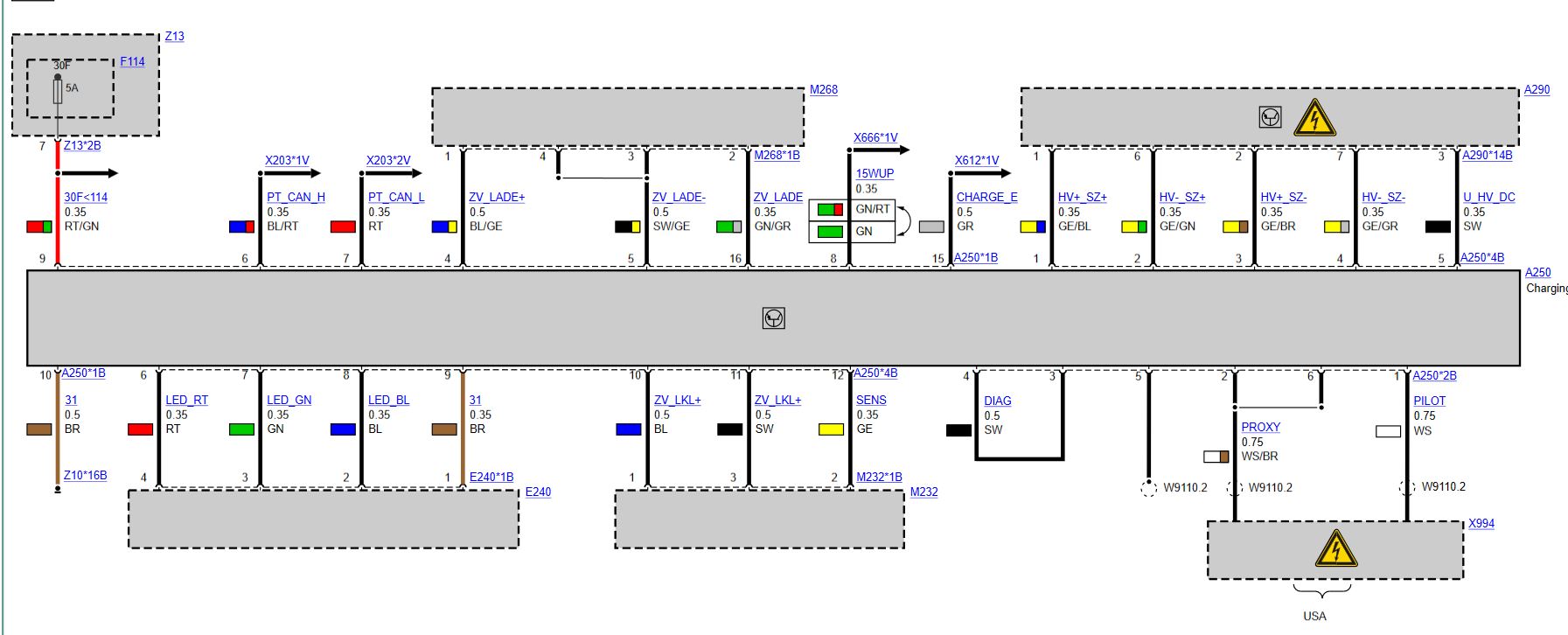

I am due to receive my own I3 LIM soon and have been doing work with others to try and first of all reproduce the findings in this thread. So far so good and gotten the AC charging functioning.
One "basic" function I would want to look at sorting is the ability of the I3 LIM to wake up the rest of the vehicle. Reading the documentation on the wiki there is reference to a wake up line that the LIM controls, however in the wiring info on the wiki I cannot find it.
Has anyone looked into this wake up functionality if it is a canbus based wake up of vehicle or a true hardwired line?

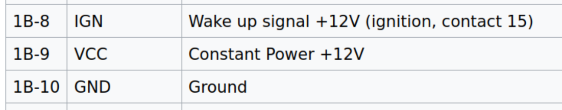

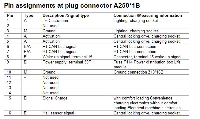

tom91 wrote: Thu Jun 16, 2022 10:38 am I would want to look at sorting is the ability of the I3 LIM to wake up the rest of the vehicle. Reading the documentation on the wiki there is reference to a wake up line that the LIM controls, however in the wiring info on the wiki I cannot find it.
IDK, to me it looks as if terminal 30F is connector 1B-8.
" LIM . . . is supplied . . . " = "module wake-up"? Could be me mis-interpreting translated German).

If we're discussing the charge port's lock (the BMW has a separate switch on the actual door) . . . the LIM monitors pin 1B-16 (referenced to ground) and is expecting 11k when locked, 1k when unlocked. Because the LIM thinks it's driving a motor that drives the lock actuator pin, it outputs 12vdc in one polarity for ~1 second pulse to lock, and another ~1 sec. pulse of the opposite polarity to unlock.
Member raine recently updated the charge port lock wiring diagram and made a really good contribution in the process, added to the Wiki:
In May2021, Damien spoofed the LIM's expected charge port lock behaviour via a pair of resistors and a bistable relay:
We are not discussing the plug lock. :| Besides that I like your very through and complete posts it helps pull the information into one location.
We are talking about the Fuel door/charge door position switch. This door can be locked by the central locking system.

I recieved my LIM and built a bench setup
4B-12 COV FBK when not grounded it indicates being open over canbus based on the DBC file on github.
I do not see any change when grounding 1B-13 or having it high.
One thing to note when powering on the LIM and having both 1B-13 and 4B-12 floating on startup the flap status report error.
At this moment I am simulating the charge socket and actuator with resistors, I do not know is this will cause issues. I have not been able to get the LIM to be happy with a simple portable EVSE, probally due to not having an locking actuator.
1B-13 is not on on the wiring info on ISTA, this only is referenced when you look at the Chademo version.
Made changes on wiki to match this info.
