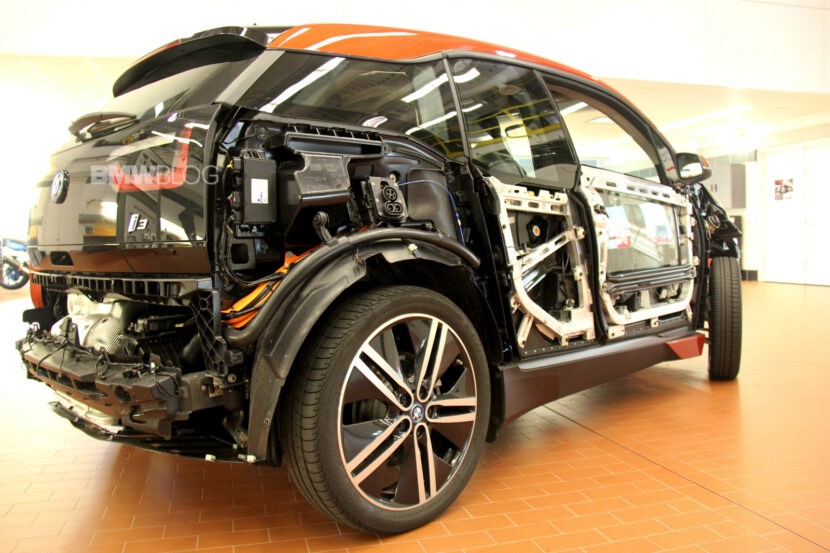

The module is located behind the rear quarter panel and seems to require body panel removal. I had a look through the munro teardown document too and they have a block diagram for the module. My current idea is to look through wiring to find easy point to unclip trim and get access to loom (ideally around or in front of doors).

The LIM is attached to the FA CAN, which can be reached on the BDC in the footwell on the right (LHD). A red cable (CAN L) and a red / blue cable (CAN H) A258 * 8B 47 + 48 or A258 * 7B 35 + 36

Look up my channel Mini Life Crisis, I have a video of removing the n/s rear quarter panelpaaa wrote: ↑Wed Mar 17, 2021 1:30 pm The module is located behind the rear quarter panel and seems to require body panel removal. I had a look through the munro teardown document too and they have a block diagram for the module. My current idea is to look through wiring to find easy point to unclip trim and get access to loom (ideally around or in front of doors).

Check out this video. If you take off the wheel and the plastic wheel well it looks like you can reach up to the LIM. It may be a bit awkward, but it looks fairly straightforward apart from that.

The rear quarter panel is really easy to take off, remove the rear bumper (about 10 bolts and a sharp pull)
Remove 4 volts from the rear of the panel, 4 from the front and 4 or 5 from the arch lining and voila.
