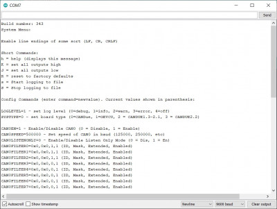

OH my lord after a little due_can-master (good library) swap for due_can (bad library) duplicate libraries it COMPILED on the PC !!!!
and just like that we are GVRETing...

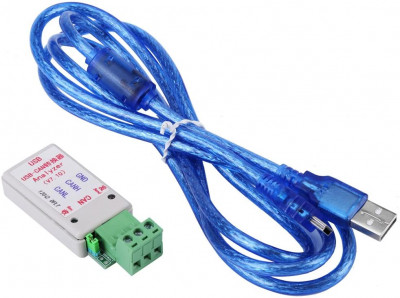

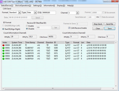

not yet, I opened a Tech Support case for that black box aka the Microchip as I really want one of them darn things to work, you can follow it's status here: Sending commands using APGDT002 CAN BUS ANALYZER TOOL is not working and I am planning on testing the pink one with the Chevy Volt first gen DC-DC Converter as I believe it only requires a single CAN command instead of two, and I am pretty sure reading that Arber Kramar used that very CANalyst-II gizmo to control his, more as the news develops
I also returned this white one cause it had a horrible UI and all the documentation was in Chinese

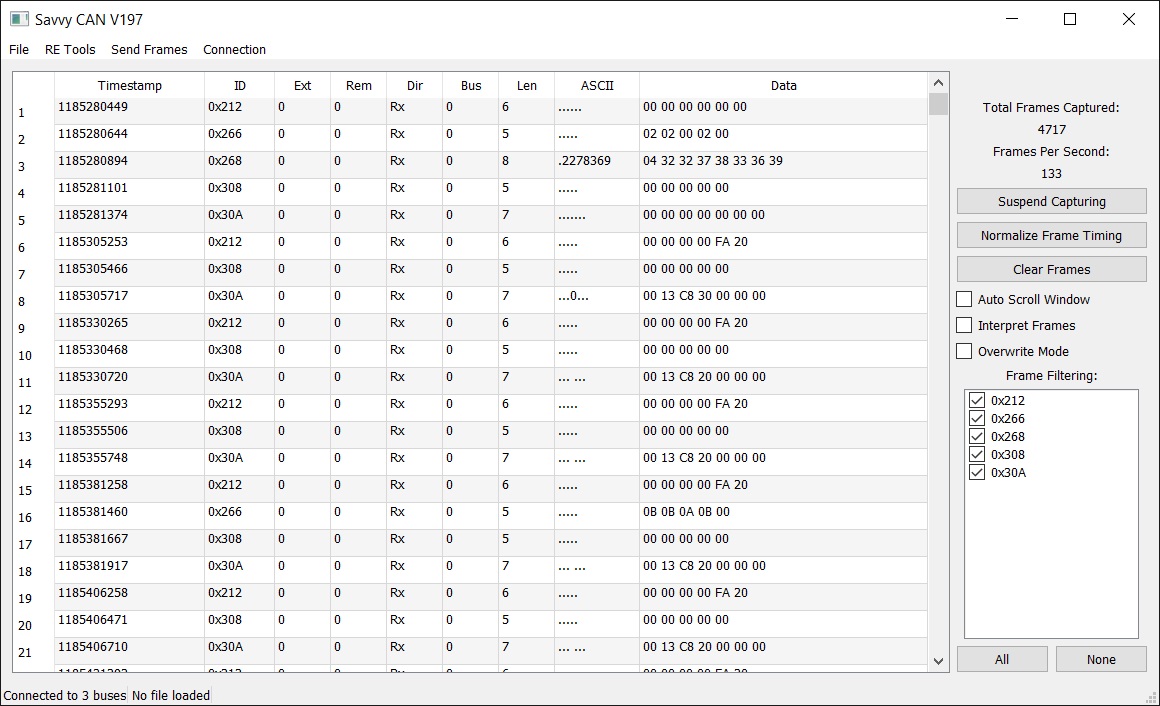

Re: I think I CAN, I think I CAN...

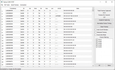

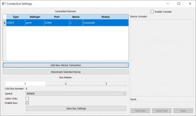

and now we can make a connection in SaavyCAN, so progress
and we can read the CAN messages from the Chevy Volt first gen onboard charger

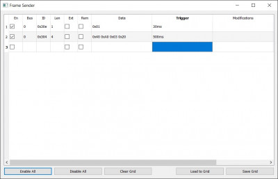

and we can send frames successfully using the Frame Sender in SaavyCAN

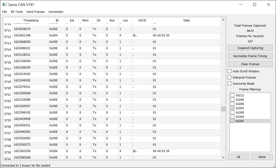

and we can confirm with a frame Capture that the first message is being sent every 30 milliseconds and the second one every 500 milliseconds

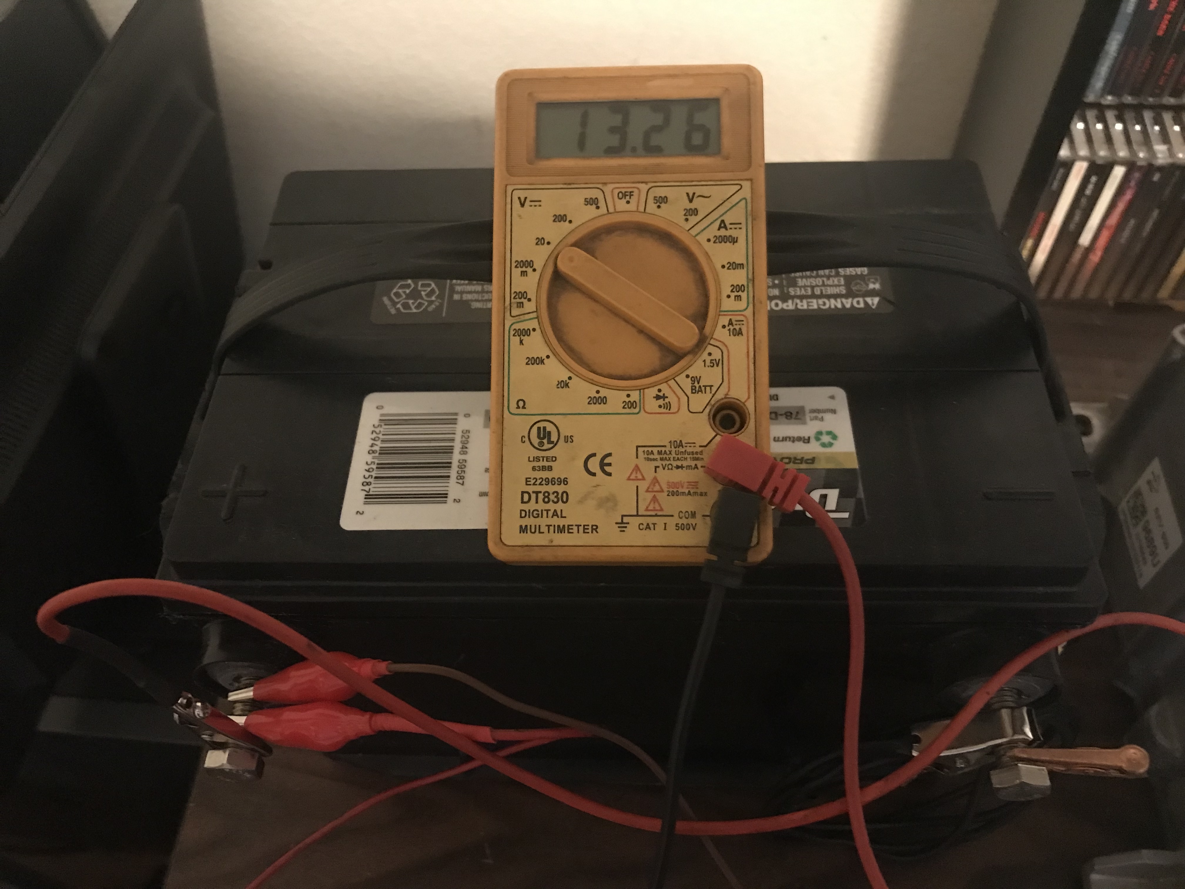

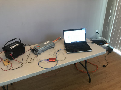

and here I confirm with a multimeter that indeed my trusty ol' lead acid battery is charging at 13.3 volts cause it drops to 12.5 when not charging
man I really like this Chevy Volt first gen charger, you can test with just the 12 volt battery and not get dead

So I just heard back from Microchip Tech Support, the black box thingie regarding their device not working and us not being able to successfully send two back to back CAN messages using it to our Chevy Volt first gen onboard charger, and here's their response:
"Thanks for contacting Microchip Technical Support Team.
We checked the back-to-back transmit scenario and it is working perfectly."
in all fairness they did ask for a bit info...

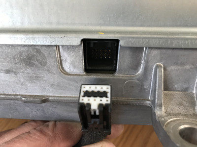

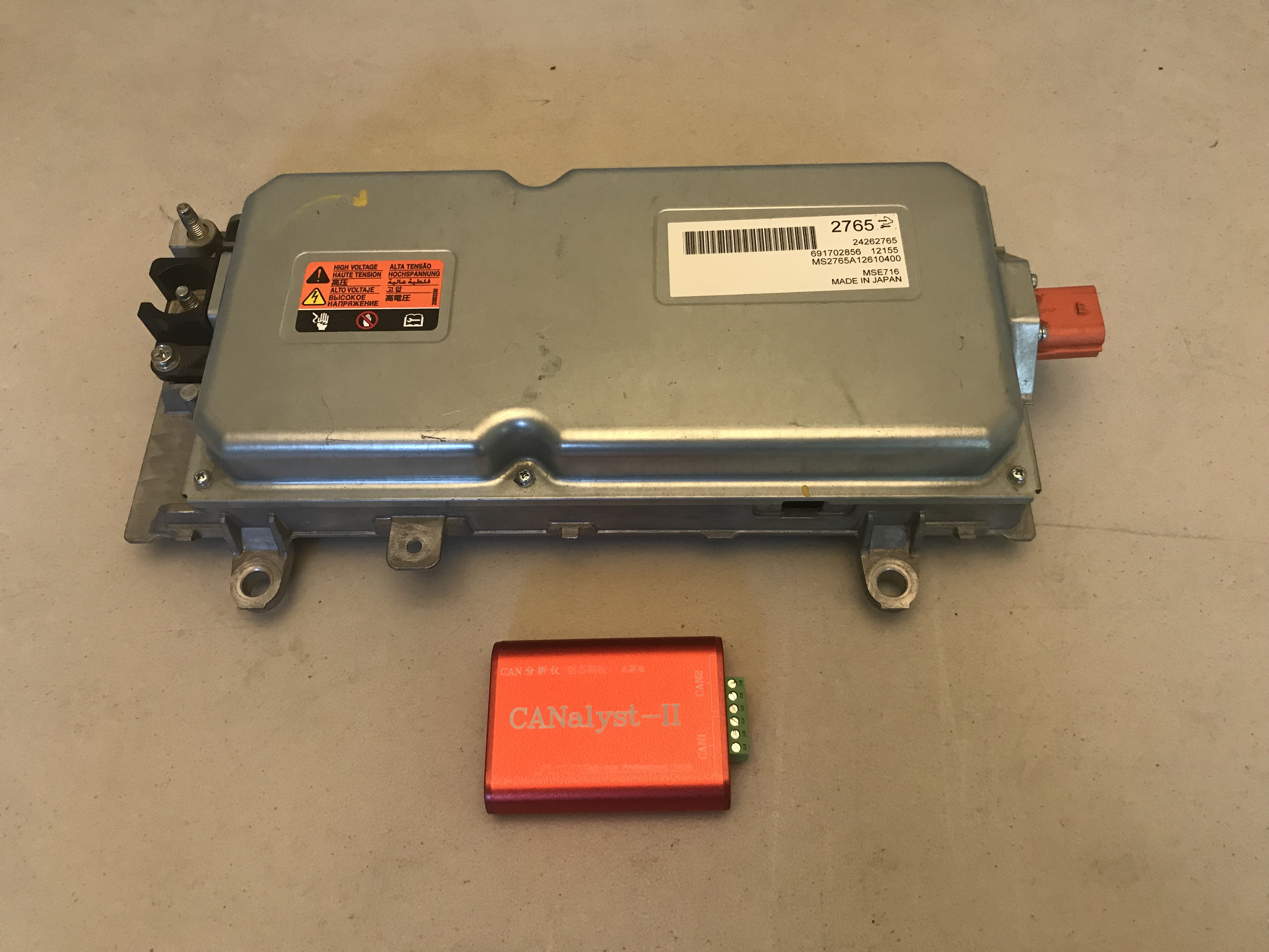

Just so you don't think I'm Mr. One n Done here I am having a go at the first gen Chevy Volt DC-DC Converter once again with the CANalyst-II
if you enjoy a fun read: I bought a Chevy Volt Gen1 DC-DC Converter - Now What?
the DC-DC Converter only requires one command to dance, so I thought this one ought to do it and that's how Mr. Kramar beat it into submission on LEAFDRIVEBLOG Ampera/Volt DCDC or APU , but no dice for The Greg
CAN ID is 01 D4
Length is 2
Msg is A0 B2 send every 100ms (B2= 14 volt output)
OR
Msg is A0 AF send every 100ms (AF= 13.8 volt output)
A0 means Start
send 00 to Stop
Pinout Info
Pin 2 (second top left) CAN Low
Pin 3 (third top left) CAN High
Pin 5 (last one top right) Ignition (so to battery positive)
Pin 10 (last one bottom right) Accessory (so to battery positive)

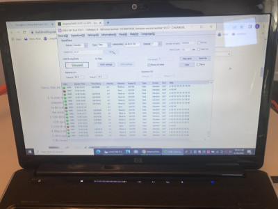

In all fairness you need to play with canalyst some to get communication going. Also termination resistor configuration is important.
I got best results when i opened a bridge between can1 and can2...

Sorry i missed this...
Pin 5 is ignition and also signal for dcdc to wake up
Pin 10 is actually an output. That one becomes live when you provide ignition. I think it is used to turn the cooling fan on.

so are you saying we don't need to worry about ie connect Pin 10 to get the converter to convert?
- Posts: 3565
- Has thanked: 134 times
- Been thanked: 335 times
No that one will work by itself. You only need CANH, CANL and Enable signal. You can use aux contact to run some indication LED so you are aware it is working...Gregski wrote: ↑Wed May 11, 2022 7:43 amso are you saying we don't need to worry about ie connect Pin 10 to get the converter to convert?
Also i belive CAN is not terminated here. You have CAN input and CAN output lines. So if DCDC does not work reliably you might put 120R across second pair of CAN wires.

Yes in general you should be fine if Canalyst is blinking its leds. That means it is receiving CAN traffic. Can you post a screenshot of your send/receive screen? I dont have that DCDC with me anymore, but i can still help...
EDIT: that got me thinking... when you post ID into Canalyst you have to make it in 4 byte length for "standard" length (not extended).
So for ID 0x1D4 you would put it like 00 00 01 D4. Try it...
Msg repeats in 100ms intervals. Example from my AC compressor...
