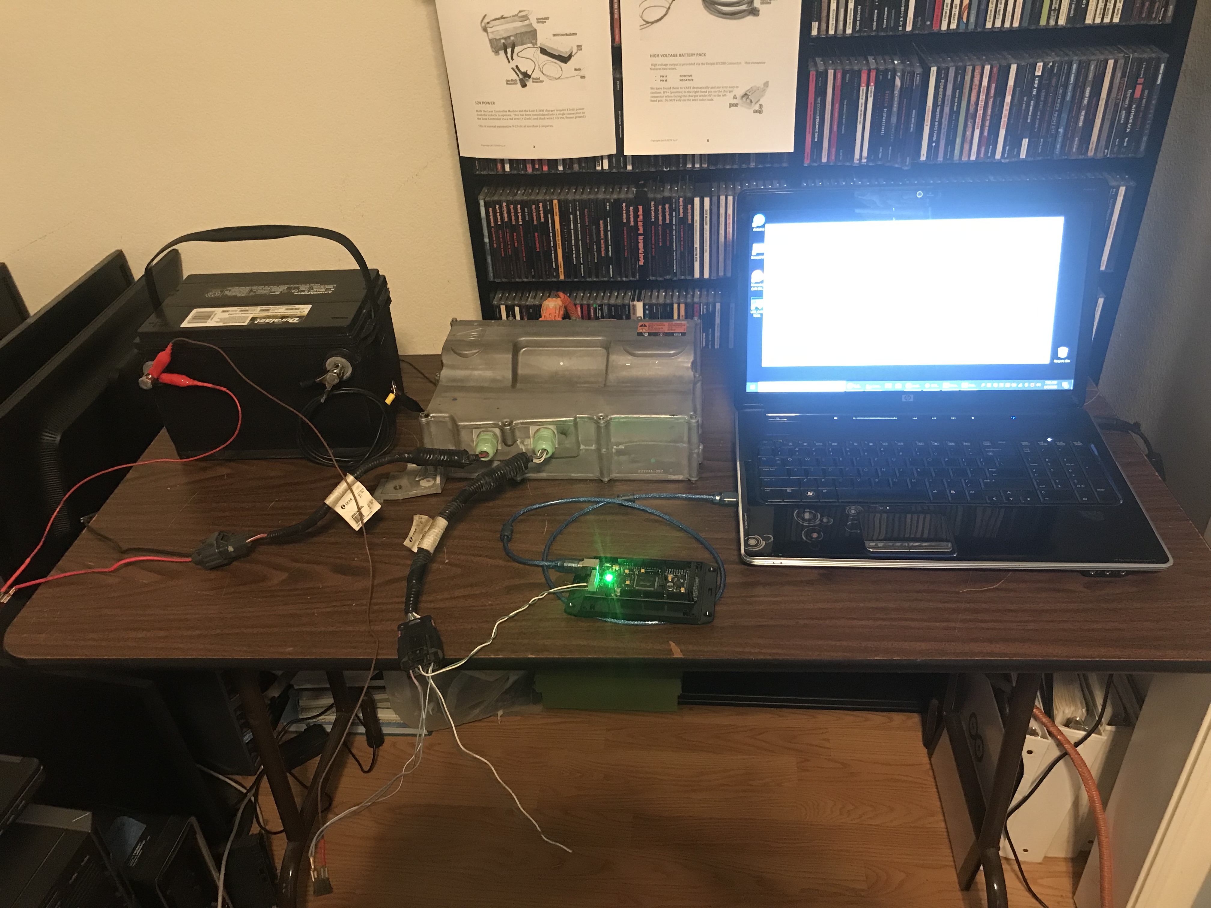

provided the following legend by Mr. Kramar I decided to geek out a little bit and create this cheat shit
Address 0x304 Data0 is an unknown at present, but seem to be 40 or 48 in the Volt.
Address 0x304 Data1 is the current commanded, convert to decimal and divide by 20.
Address 0x304 Data2 first 2 bits are MSB of the voltage command.
Address 0x304 Data3 byte is the LSB of the voltage command. Then MSB LSB is divided by 2.

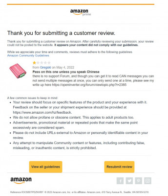

just when I thought I couldn't luv big corporations even more, comes this Amazon review submission rejection (my first one by the way)
Posts: 3565
Has thanked: 134 times
Been thanked: 335 times
Re: I think I CAN, I think I CAN...
Gregski wrote: Fri May 06, 2022 12:59 pm just when I thought I couldn't luv big corporations even more, comes this Amazon review submission rejection (my first one by the way)
Did you use any profanity when describing how it did not work for you? 8-)
Gregski
Posts: 2723
Has thanked: 499 times
Been thanked: 945 times
Post by Gregski »
arber333 wrote: Fri May 06, 2022 1:18 pm
you can read the review I wrote in the screen shot verbatim, what I think offended them was a link to this forum, ha ha, can't have that, everyone knows the only website you will ever need is theirs

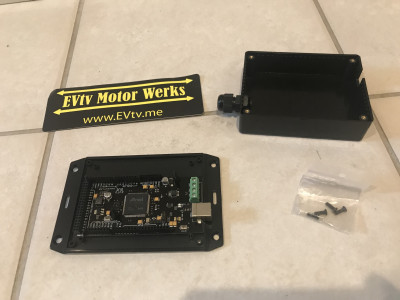

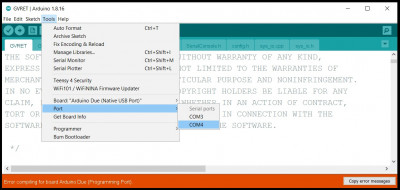

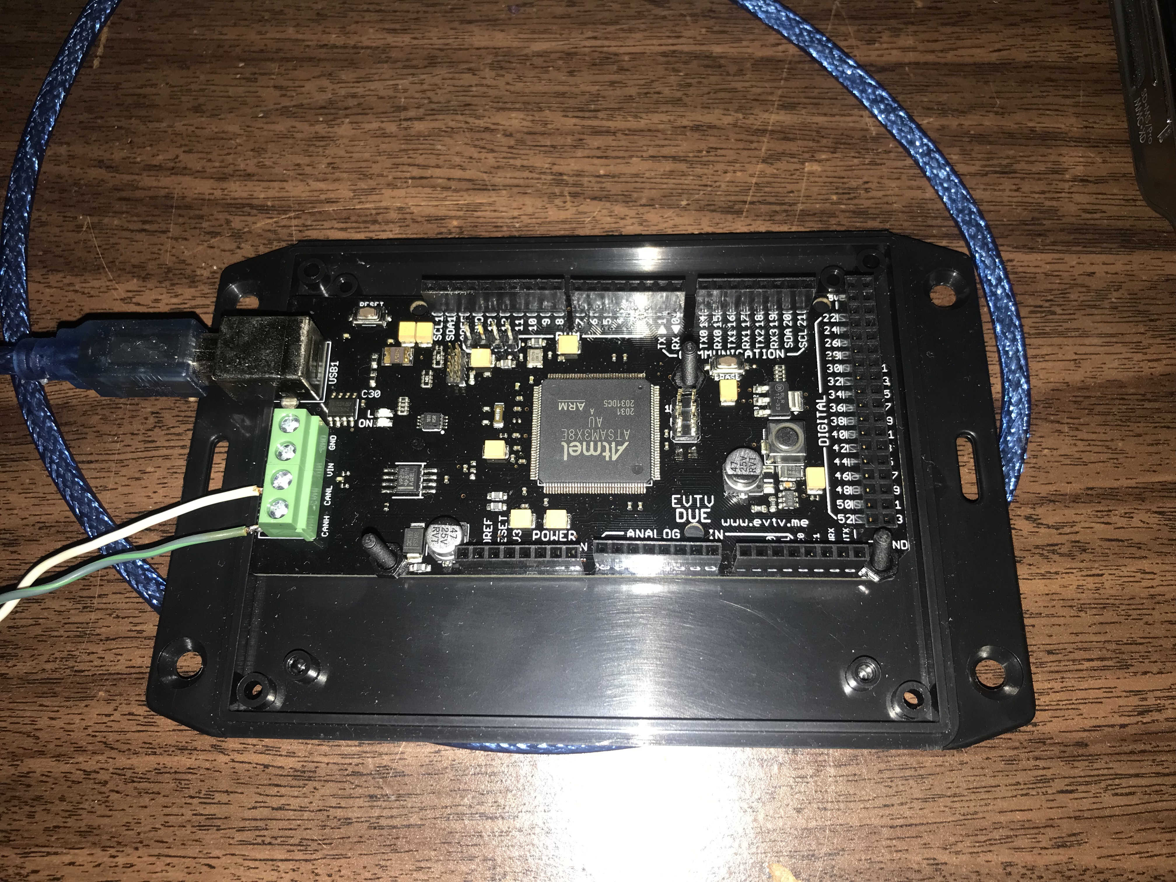

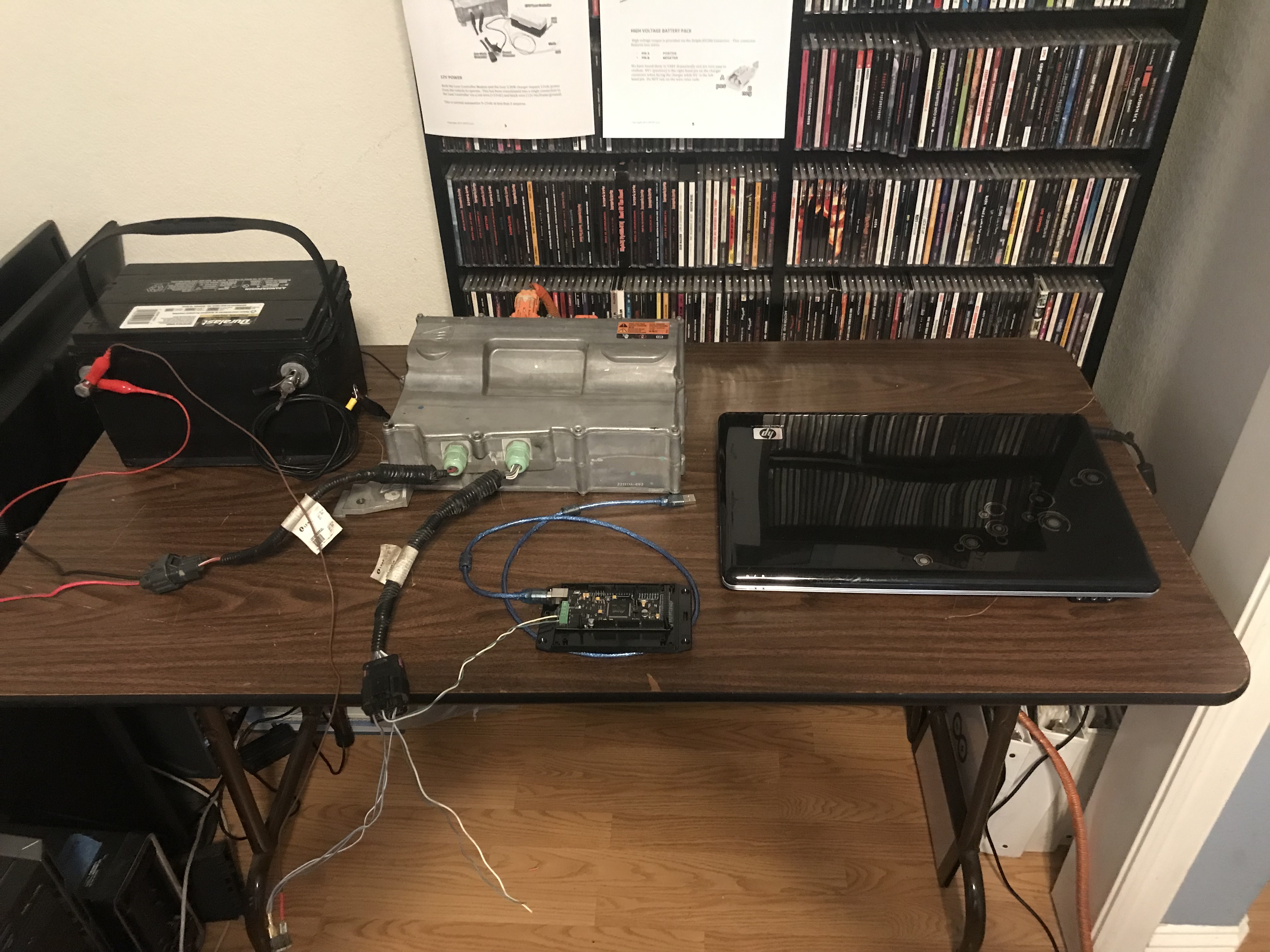

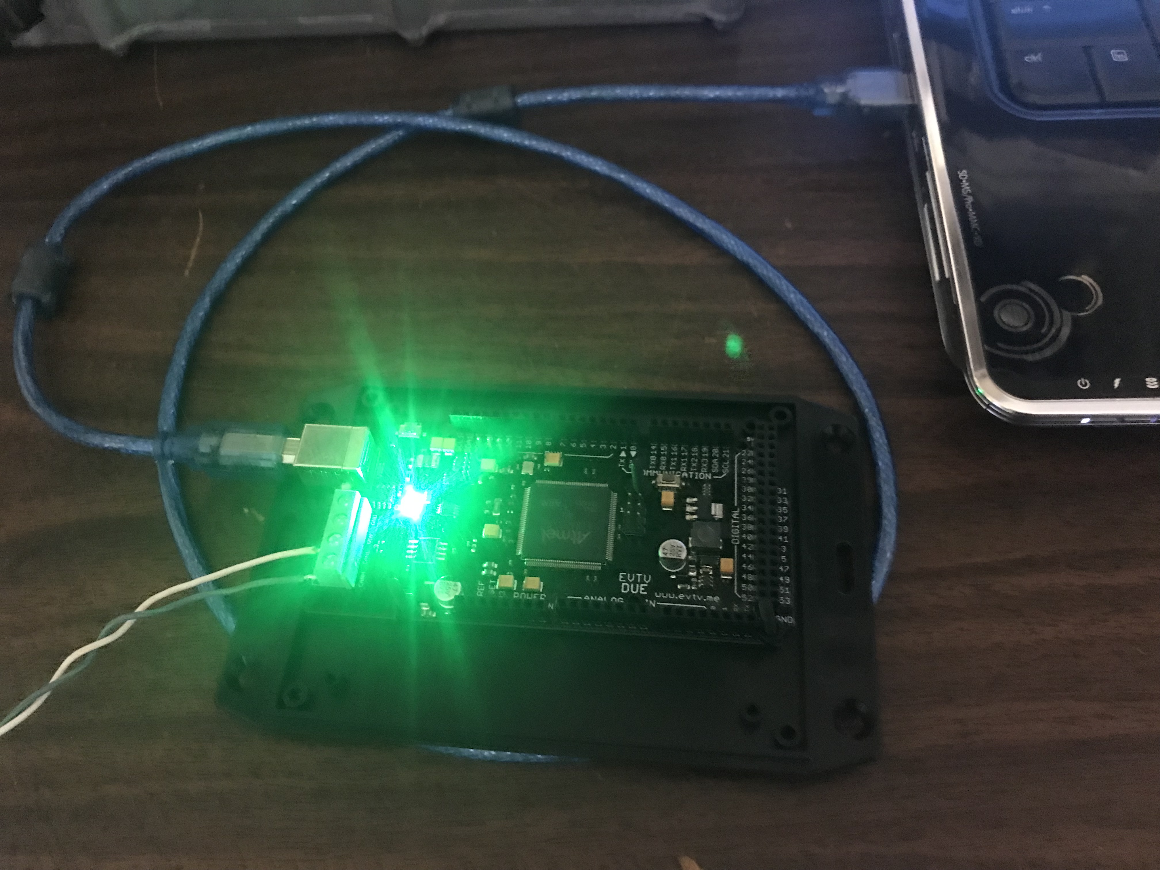

so I must say I am a little bit bumbed, I connected the EVTVDue board with an older style USB cable to my laptop, launched Saavy CAN which by they way is just an executable (pronounced: you don't have to install it you just double click a .exe file to open it up) quite brilliant really, as it means it's very portable, and nothing happened
So I launched Arduino IDE (the software program where you write code and run code) I made sure the right COM port was selected, I crossed my fingers and launched the serial monitor, then I typed "?" took a deep breath and hit enter, and as I suspected, nothing happened which confirms to me GVRET must not come pre installed on this card
that's the only way I know how to check what is on an Arduino board, if you have any suggestions I'm all ears
my opinion is that it would be a real value added feature if the board came with GVRET pre installed, now I don't know if that means they would need a couple flavors of the board like one for Linus, one for Apple, and one for Windows, but I think they could reach and satisfy an larger segment of the not so DIY EV conversion community, as I find Arduinoing a steady P.I.A.
let me know your thoughts
Gregski
Posts: 2723
Post by Gregski »

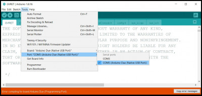

as I was saying Arduinoing is no fun there's errors every time, and here it is no different, so I am not trying to compile the GVRET code (pronounced: firmware) onto the EVTV Due board, and I am getting an error:
unknown CPU
Arduino: 1.8.16 (Windows 10), TD: 1.55, Board: "Arduino Due (Native USB Port)"
In file included from C:\Program Files (x86)\Arduino\libraries\Robot_Control\src\Fat16.h:29:0,
from C:\Program Files (x86)\Arduino\libraries\Robot_Control\src\SquawkSD.h:4,
from C:\Program Files (x86)\Arduino\libraries\Robot_Control\src\ArduinoRobot.h:24,
from C:\Program Files (x86)\Arduino\libraries\Robot_Control\src\ArduinoRobot.cpp:19:
C:\Program Files (x86)\Arduino\libraries\Robot_Control\src/SdCard.h:76:2: error: #error unknown CPU
#error unknown CPU
In file included from C:\Program Files (x86)\Arduino\libraries\Robot_Control\src\ArduinoRobot.h:26:0,
C:\Program Files (x86)\Arduino\libraries\Robot_Control\src\EasyTransfer2.h:42:20: fatal error: avr/io.h: No such file or directory
#include <avr/io.h>
compilation terminated.
exit status 1
Error compiling for board Arduino Due (Native USB Port).
This report would have more information with
"Show verbose output during compilation"
option enabled in File -> Preferences.

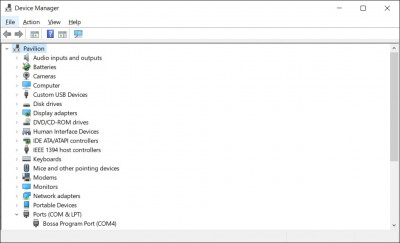

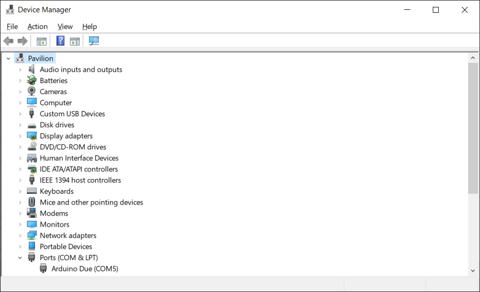

so after a bit of an investigation (starting with the basics) here's what my laptop aka Device Manager sees the genuine Arduino Due as, as compared to what it sees the clone EVTVDue as: Bossa ???

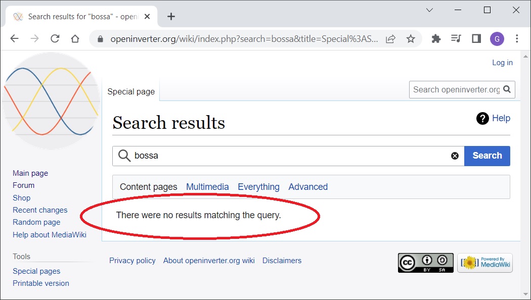

so I tried searching our Wiki for "bossa" next and that yielded "no results matching the query."
Pete9008
Posts: 1801
Has thanked: 102 times
Been thanked: 350 times
Post by Pete9008 »
Bossa is this https://www.shumatech.com/web/products/bossa, it means that the board is totally blank and just contains the Atmel (chip manufacturers) bootloader. The Arduino IDE should still work with this though.
I'll set mine up and see if I can reproduce (although I'm on Linux so it may behave differently)
BTW - I agree completely, the Arduino environment is a pet hate of mine, capable enough to try to do complex stuff with it but with none of the debug tools to figure out why it doesn't work!

Pete9008
Posts: 1801
Post by Pete9008 »
Bad news, mine works fine. Erased it to blank and reprogrammed over the native port no problem.
Guessing it might be a Windows driver issue. Long shot but it might be worth trying it on a different PC USB port (it sometimes re-installs the USB driver)??
Post by Gregski »

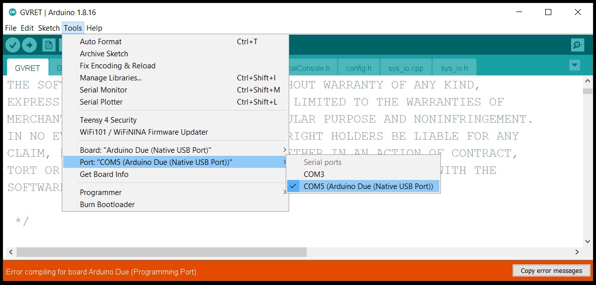

first of all thank you all for your feedback and offering to help, the troubleshooting continues, here's what Arduino sees on the COM ports for the Due vs the EVTVDue aka Bossa (ie nothing)
Gregski
Posts: 2723
Post by Gregski »
Pete9008 wrote: Sat May 07, 2022 4:22 pm Bad news, mine works fine. Erased it to blank and reprogrammed over the native port no problem.
great suggestion, so here is the error it gives me on my PC (the other one was my laptop)
