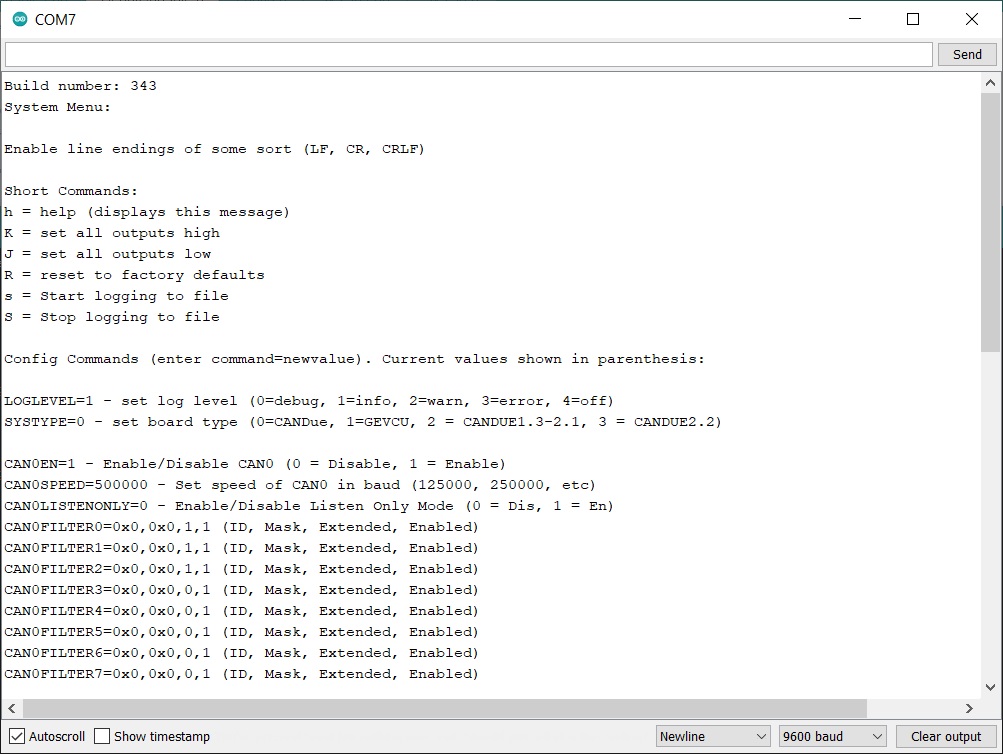

No problem. Hoping to modify the GVRET code to save settings to Flash rather than EEPROM (as my board doesn't have one) this evening so working on it anyway.
Not sure the nothing for bossa is an issue, I am slightly concerned by the compile warning you also seem to have though - what is that complaining about?
Edit - just seen your latest post, looks like you're missing a library, let me have a look on mine.

I have a directory called can_common in my Arduino libraries, downloaded from here https://github.com/collin80/can_common. Are you missing it?

OH my lord after a little due_can-master (good library) swap for due_can (bad library) duplicate libraries it COMPILED on the PC !!!!
and just like that we are GVRETing...

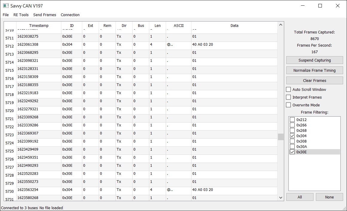

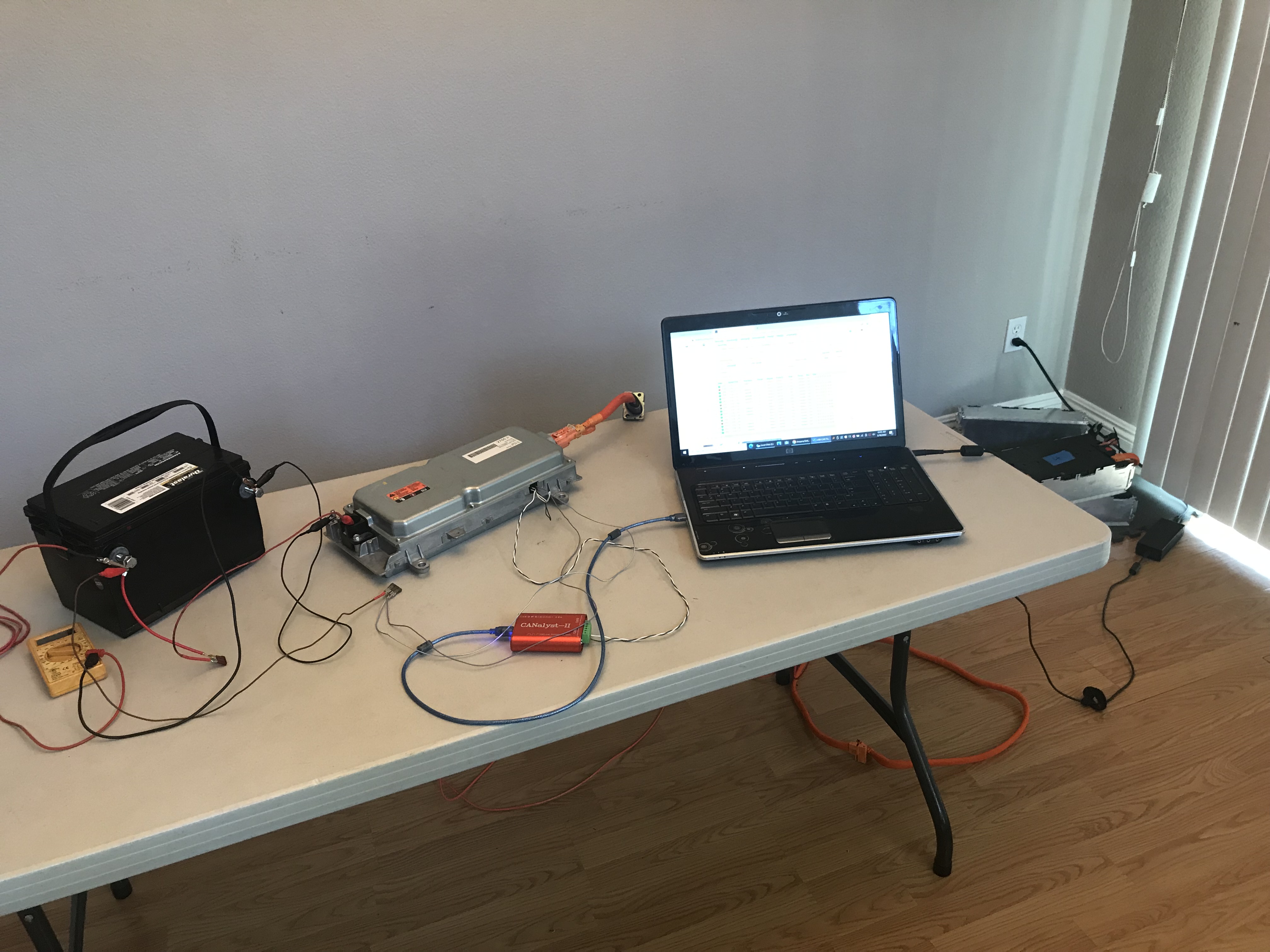

and now we can make a connection in SaavyCAN, so progress
and we can read the CAN messages from the Chevy Volt first gen onboard charger
and we can send frames successfully using the Frame Sender in SaavyCAN
and we can confirm with a frame Capture that the first message is being sent every 30 milliseconds and the second one every 500 milliseconds

and here I confirm with a multimeter that indeed my trusty ol' lead acid battery is charging at 13.3 volts cause it drops to 12.5 when not charging
man I really like this Chevy Volt first gen charger, you can test with just the 12 volt battery and not get dead

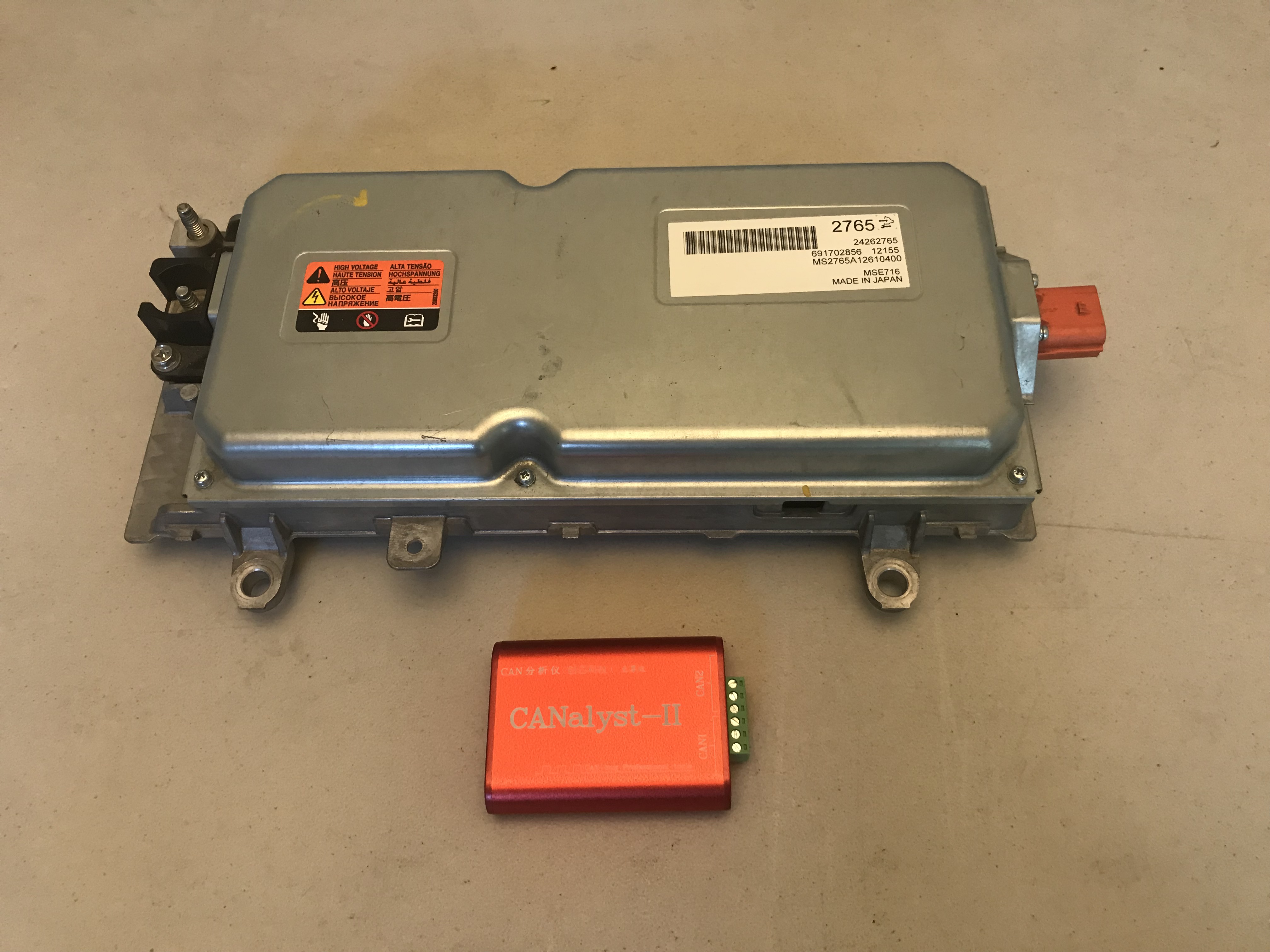

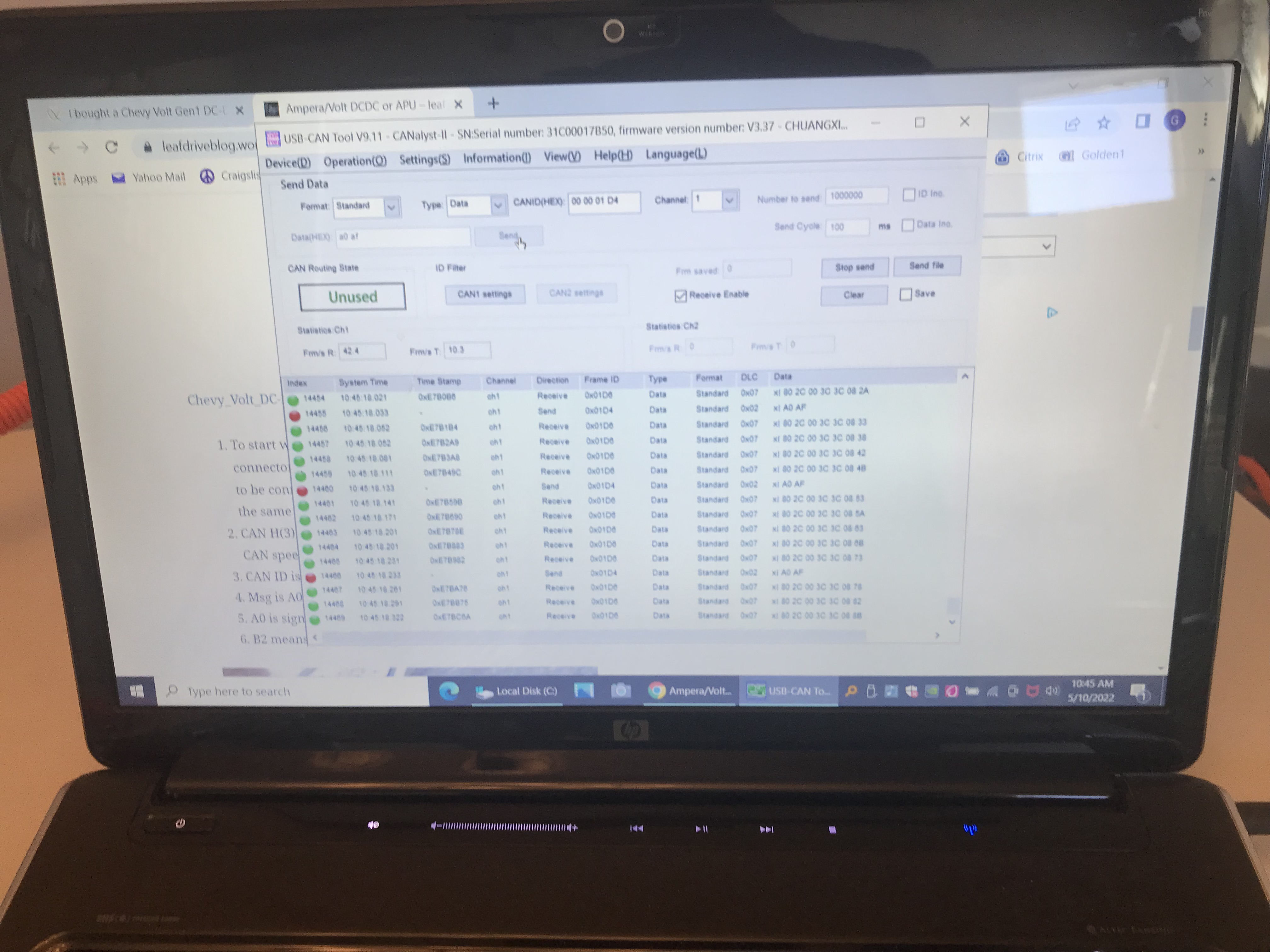

Just so you don't think I'm Mr. One n Done here I am having a go at the first gen Chevy Volt DC-DC Converter once again with the CANalyst-II
if you enjoy a fun read: I bought a Chevy Volt Gen1 DC-DC Converter - Now What?
the DC-DC Converter only requires one command to dance, so I thought this one ought to do it and that's how Mr. Kramar beat it into submission on LEAFDRIVEBLOG Ampera/Volt DCDC or APU , but no dice for The Greg
CAN ID is 01 D4
Length is 2
Msg is A0 B2 send every 100ms (B2= 14 volt output)
OR
Msg is A0 AF send every 100ms (AF= 13.8 volt output)
A0 means Start
send 00 to Stop

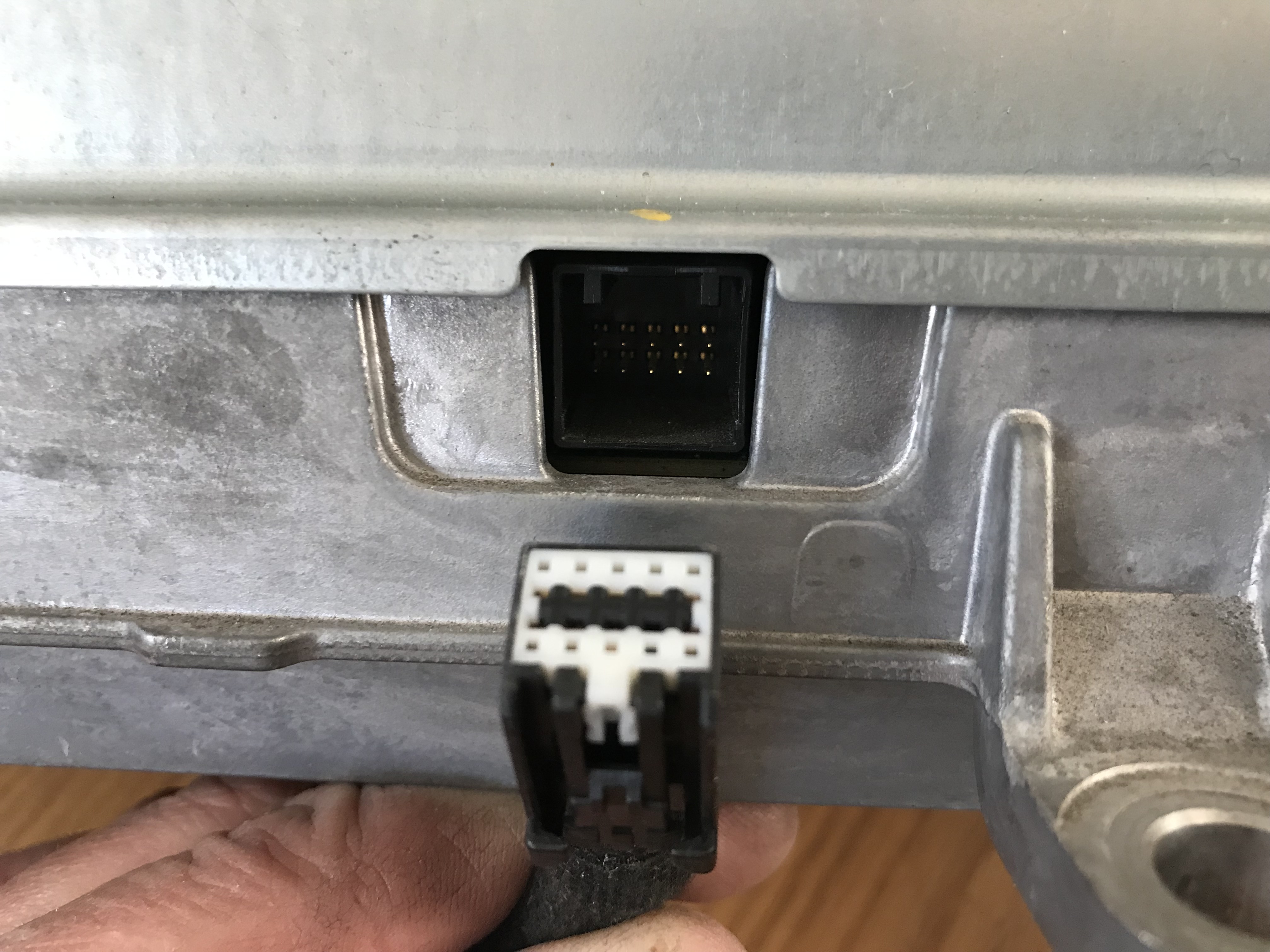

Pinout Info
Pin 2 (second top left) CAN Low
Pin 3 (third top left) CAN High
Pin 5 (last one top right) Ignition (so to battery positive)
Pin 10 (last one bottom right) Accessory (so to battery positive)

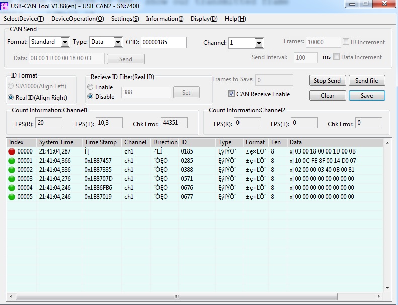

In all fairness you need to play with canalyst some to get communication going. Also termination resistor configuration is important.
I got best results when i opened a bridge between can1 and can2...

Pin 5 is ignition and also signal for dcdc to wake up
Pin 10 is actually an output. That one becomes live when you provide ignition. I think it is used to turn the cooling fan on.

so are you saying we don't need to worry about ie connect Pin 10 to get the converter to convert?
- Posts: 3795
- Has thanked: 166 times
- Been thanked: 411 times
Re: I think I CAN, I think I CAN...
No that one will work by itself. You only need CANH, CANL and Enable signal. You can use aux contact to run some indication LED so you are aware it is working...Gregski wrote: ↑Wed May 11, 2022 7:43 amso are you saying we don't need to worry about ie connect Pin 10 to get the converter to convert?
Also i belive CAN is not terminated here. You have CAN input and CAN output lines. So if DCDC does not work reliably you might put 120R across second pair of CAN wires.

The ideal is to have a termination at each end but as long as there is a termination somewhere you should be fine on a small network (few m of cable). Too many terminations reduce the signal level, possibly to the point where messages aren't received (but that would need quite a few extra terminations).
If you find a network is really sensitive to terminations there are probably other problems (such as high electrical noise) too.
In general if you are connecting to an existing network (e.g. to debug it) don't add a terminator on the dongle and keep the cables as short as possible. If you are creating a new network with the dongle at one end then add a termination on the dongle.

Yes in general you should be fine if Canalyst is blinking its leds. That means it is receiving CAN traffic. Can you post a screenshot of your send/receive screen? I dont have that DCDC with me anymore, but i can still help...
EDIT: that got me thinking... when you post ID into Canalyst you have to make it in 4 byte length for "standard" length (not extended).
So for ID 0x1D4 you would put it like 00 00 01 D4. Try it...
Msg repeats in 100ms intervals. Example from my AC compressor...
