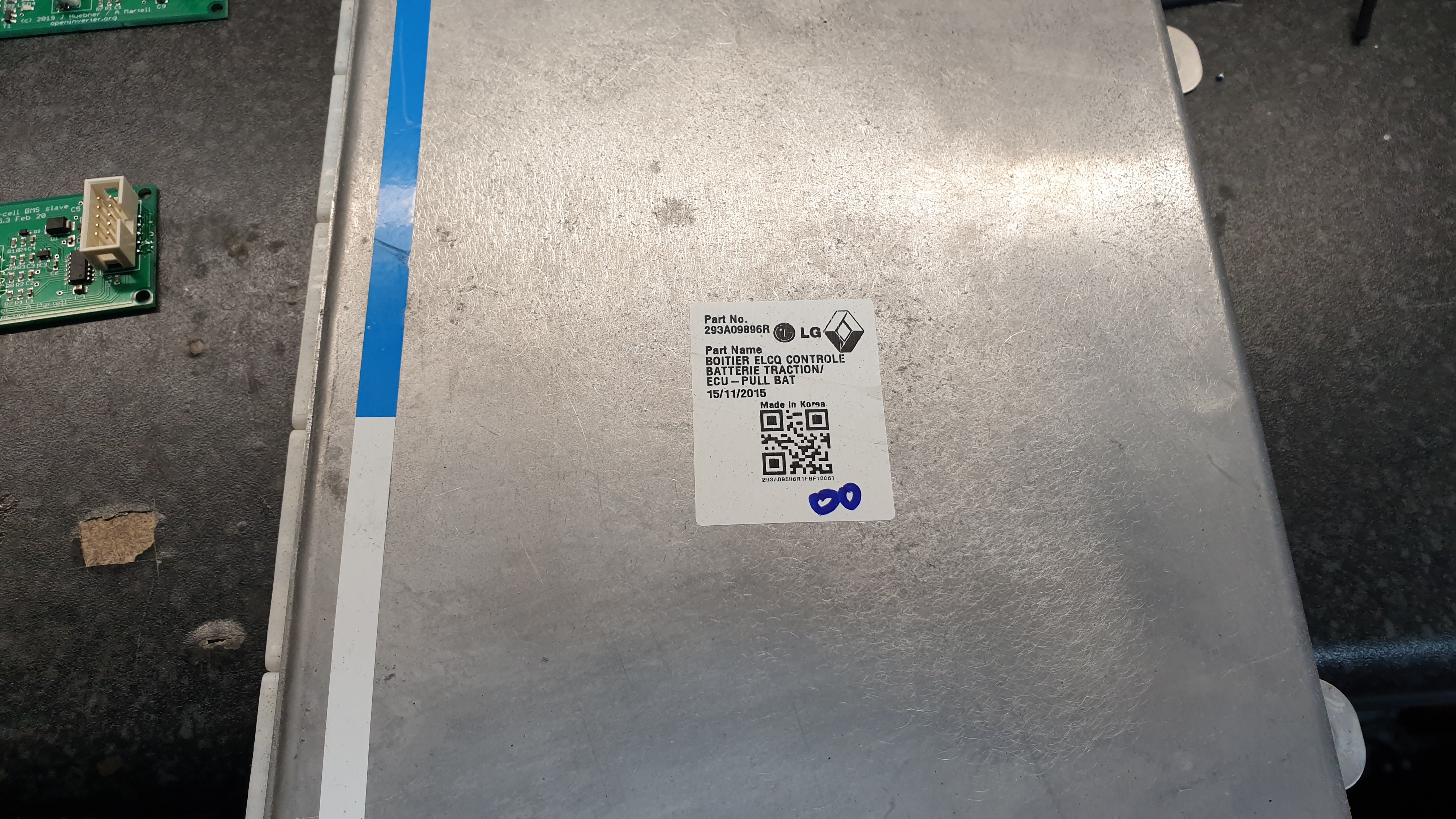

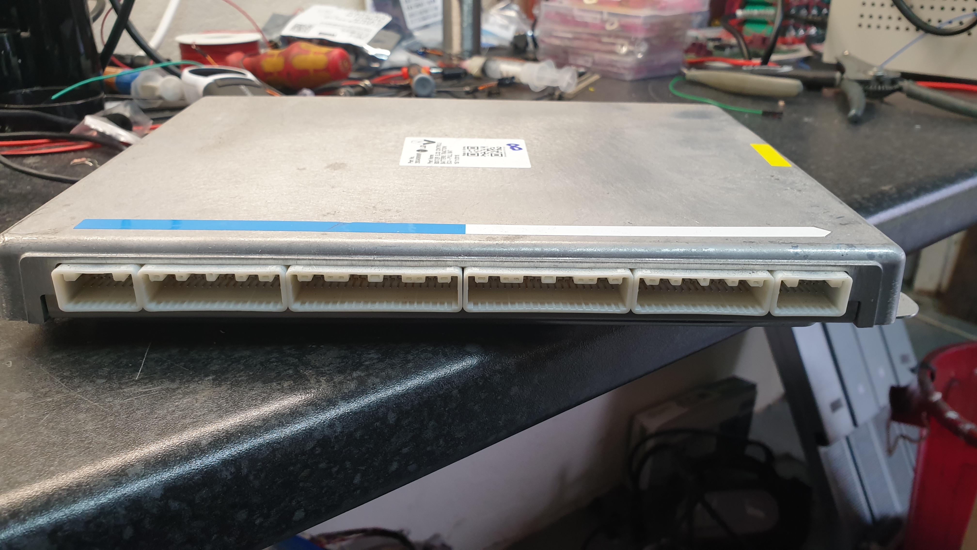

Anyone looked at the Zoe BMS? Circling back around to this as I have a Zoe pack in the E46 touring that is going to need a bms soon. Cracked it open to have a look. Seems to be 12 groups and a chip called a L9763 in each group. Also seems to have been designed by LG.

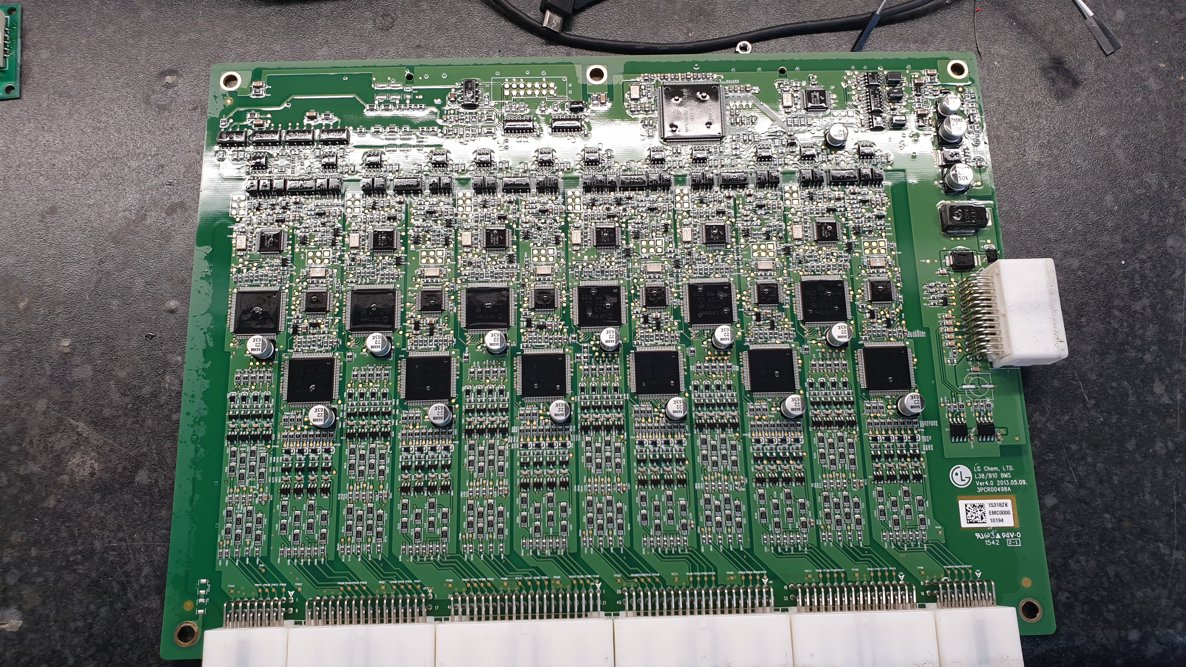

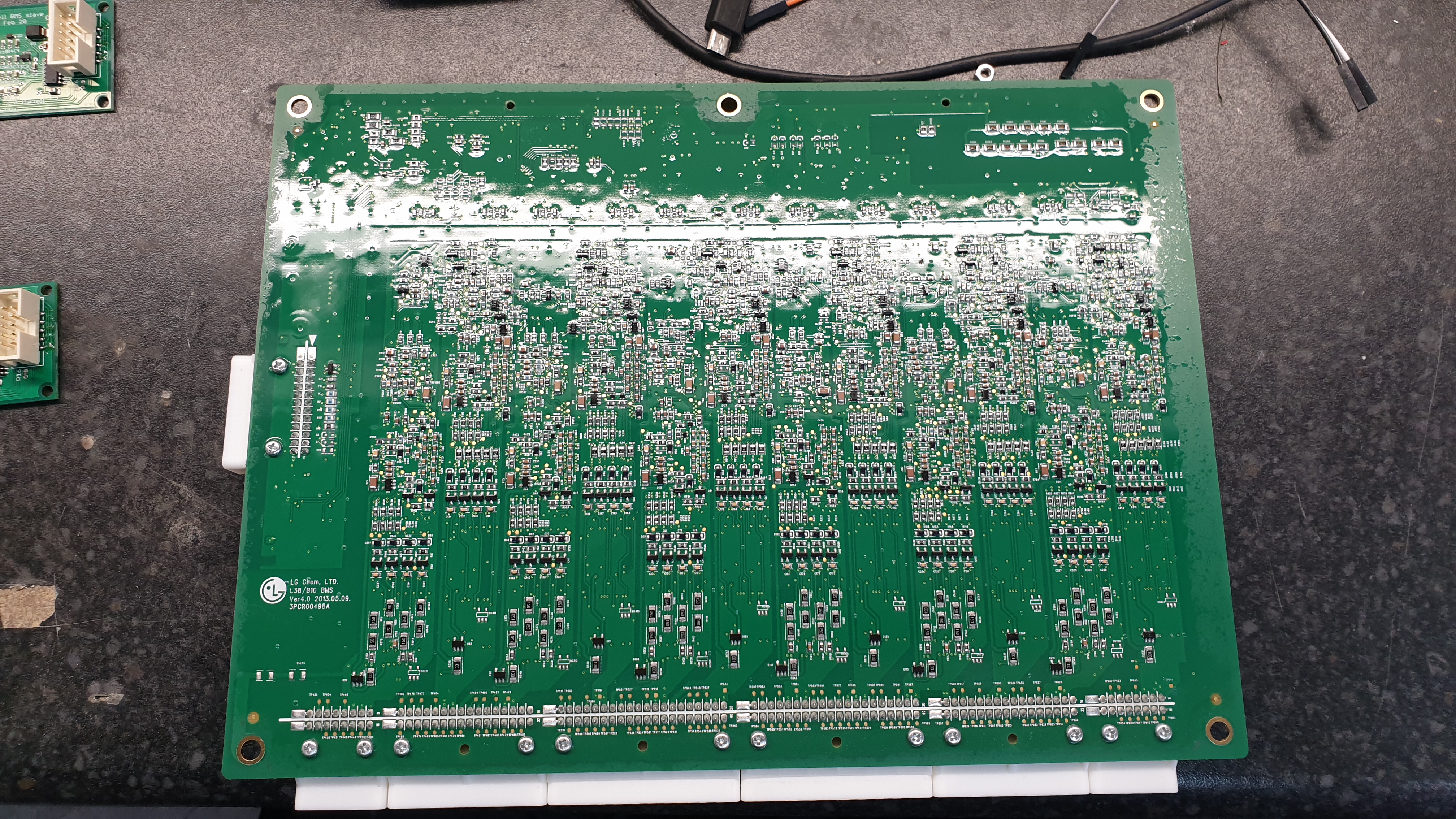

Apparently, the L9763 chip is also used in the Chevy Volt/Opel Ampera BMS:
- https://www.edn.com/teardown-high-volta ... afe-power/
I can't quite see what the other chip is, but it appears to be a fairly common automotive processor:
- https://www.nxp.com/products/processors ... ns:MPC5510

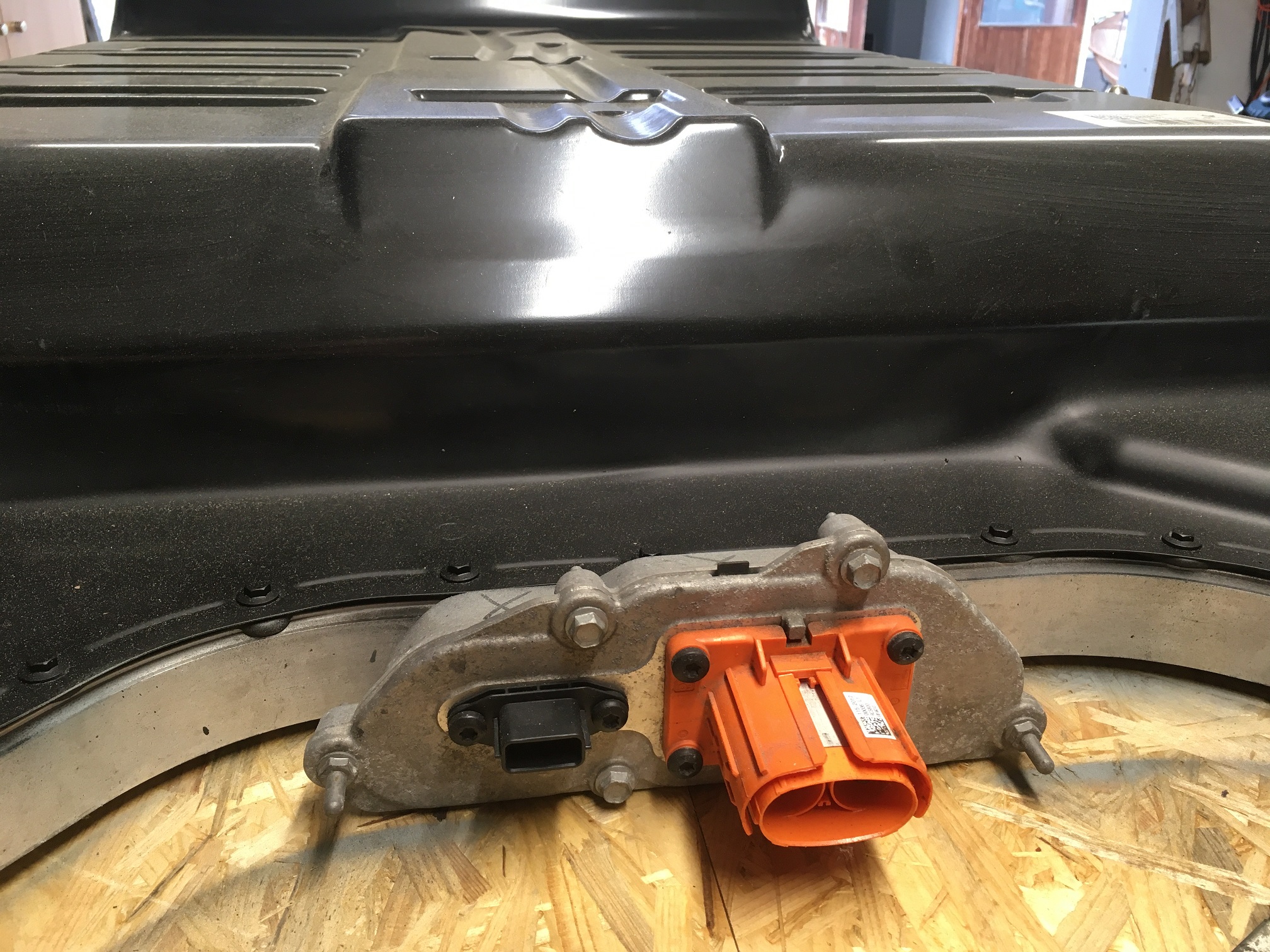

Re: Renault Zoe BMS
Well, paaa. Have you had a chance to get any further with the Zoe kit?
I've a 22kwh pack complete with BMS and HVJB. Ideally I'd use them all if I could.
Just getting to the part of the build where I'm looking to pull together the HVJB now.

Re: Renault Zoe BMS
I got it from a breaker in Tipp about 2 years ago. It wasn't a usual for them though, they just happened to have it.
Would consider a swap for a leaf pack or something if you wanted?
I disassembled the pack, but all electronic parts are there. Car had ~20k km on it when it was written off.

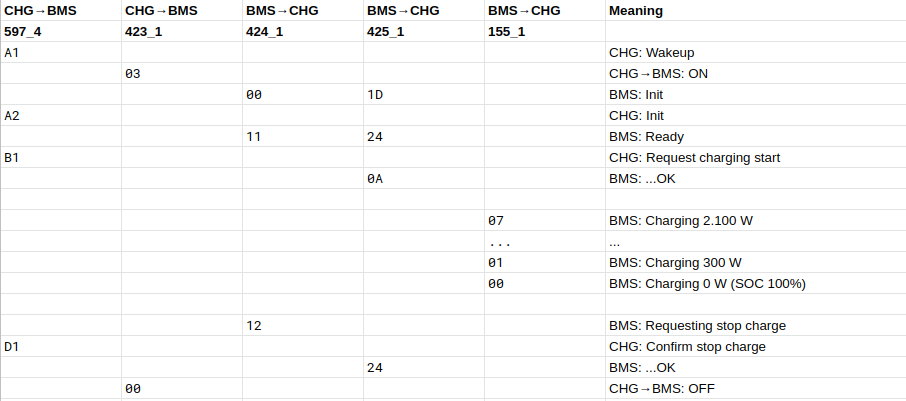

Re: Renault Zoe BMS
Thank you very much! I got quite some time on the weekend/next week and will upload my dumps, I've got quite a few.
Here is the document I've begun filling out with the meaning of the CAN frames:
https://docs.google.com/spreadsheets/d/ ... u441zBzlpM
There is definitely some handshaking going on between the BMS and the Charging Block, and also some status bits for balancing/interrupting power and so on. So in order to use a Zoe BMS with a different charger or a DIY BMS with the Zoe charger, this handshaking has to be understood and implemented.

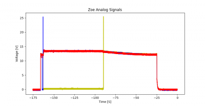

Of course that was too hopeful on my side, but it's the hope that counts.
I have uploaded my can dumps, they can be found here:
https://drive.google.com/file/d/19PINL3 ... 7qYPVdZgds
Some explanations:
Zoe_No_1 folder is the working Zoe that I don't have access to anymore.
Zoe_No_2 folder is the other Zoe without a battery, where I tried to emulate a battery with 96s1p 18650 cells attached. You can see me pressing the "Start" button one or two times in the sequences, but the Zoe shuts off after trying for 2-3 seconds. At least something happened with the relays though, and the display showed a range and 100% SOC.
I also added my oscilloscope measurements of the 3 relay lines going into the battery, (can be seen in the attachment). This is the typical start and shutdown sequence. Signals: Yellow is 2AD, Blue is 2AC and Red is 3FB1, referring to the designators in the Renault schematics.
Concerning the handshaking: There is definitely some handshaking going on. I've also attached the wakeup/handshake protocol of the Renault Twizy (!). The general structure of the car, both hardware- and can communication protocol-wise, is at least somewhat similar to the one of Zoe Ph 1. This has been reverse-engineered by dexterbg from https://github.com/dexterbg/Twizy-Virtual-BMS.

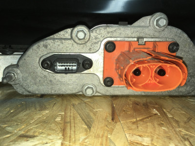

Hello, does anyone have the pin assignment of CAN BMS to match the ZOE (PH1 / 2013 - 2018)?
I would like to listen to the CAN bus from my ZOE battery (22 kWh). I'm looking for a way to operate the battery on a HV inverter without getting error messages about incorrect CAN BUS communication. I would be happy about a hint. Thx!
