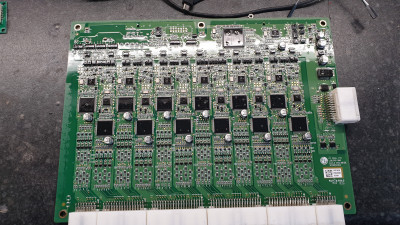

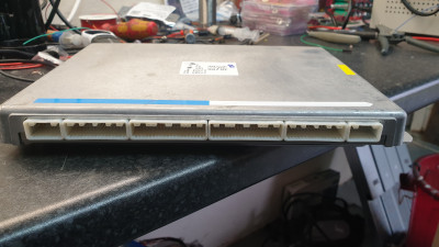

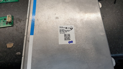

Re: Renault Zoe BMS

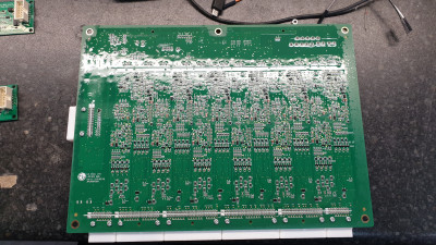

Apparently, the L9763 chip is also used in the Chevy Volt/Opel Ampera BMS:
- https://www.edn.com/teardown-high-volta ... afe-power/
I can't quite see what the other chip is, but it appears to be a fairly common automotive processor:
- https://www.nxp.com/products/processors ... ns:MPC5510

Re: Renault Zoe BMS
Thanks to Damien for the ZOE BMS. I have reviewed the Zoe wiring diagrams(utter muck) and have most of the pinout figured out. I have access to a damaged Zoe with no battery pack and a running Zoe(to record can traffic when working). Once I have wiring sorted I am going to make up single cell series pack and connect it with the BMS. Once I have damaged Zoe working with this trial battery I can then look into the CAN messages required to run the drive train.CAN ZE has a wealth of info that I have been trawling through. Hopefully we can make use of the Renault EVS as donor cars in the near future.

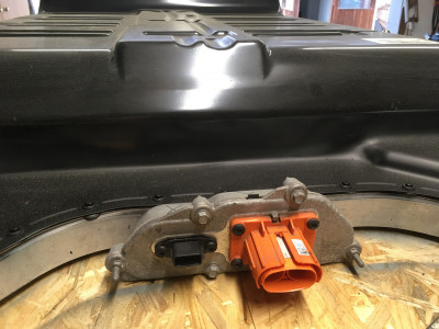

Re: Renault Zoe BMS
Well, paaa. Have you had a chance to get any further with the Zoe kit?
I've a 22kwh pack complete with BMS and HVJB. Ideally I'd use them all if I could.
Just getting to the part of the build where I'm looking to pull together the HVJB now.

I tried to get the minimum required can messages on the Renault Zoe Battery CAN Bus in order to get it rolling with a DIY-ed Battery and BMS. I logged traffic on the Bus using a Renault Zoe that was owned by a friend of mine and then tried to replicate them on my own Zoe, which I bought used and without a battery. There are only 6 different CAN frames on the Bus originating from the Battery, and I got quite a few of the messages figured out, such as momentarily allowed charge/discharge power, SOC, SOH, max and min cell temperatures, but also have some left to decode.
I then built a 96s1p 18650 pack (complete with contactors and pre-charge resistor) but unfortunately connecting it and replaying sensible (or common values where the meaning is unknown to me) was not enough to get my Zoe rolling. I didn't want to interfere with the Bus on my friends Zoe, which is why I only listened passively over there, and he has recently sold his Zoe, so I don't have access to it anymore.
I am not entirely sure what's the issue, but the PEB ECU throws some error codes that read "CAN Communication Error" so I might have gotten some illegal values or missed some handshaking going on. There is also some ISO-TP communication going on between the battery and the PEB containing some more info, e.g. all cell values. I didn't implement these ISO-TP Frames, since they aren't requested very often, but this could also be an issue.
I still think this is entirely doable since there are only 6 different CAN2.0A Frame-IDs containing some 40 bytes or so in total and nothing seems to be encrypted.

OK so I have the battery connected to a power supply, it pulls almost 300mA for a few seconds and then drops to 35uA. No data is transmitted on the canbus. Now I am hoping it wakes when it is sent some can data.

OK so solved that somewhat. Thanks to paaa I used one of the can logs and found that it wakes up and starts sending data when I send 0x423 and then stops again after the log is turned off. Now to work out what everything means..

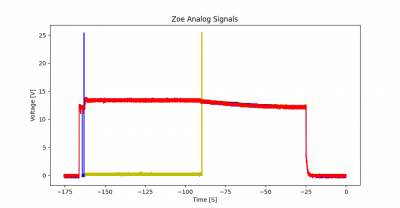

Re: Renault Zoe BMS
Of course that was too hopeful on my side, but it's the hope that counts.
I have uploaded my can dumps, they can be found here:
https://drive.google.com/file/d/19PINL3 ... 7qYPVdZgds
Some explanations:
Zoe_No_1 folder is the working Zoe that I don't have access to anymore.
Zoe_No_2 folder is the other Zoe without a battery, where I tried to emulate a battery with 96s1p 18650 cells attached. You can see me pressing the "Start" button one or two times in the sequences, but the Zoe shuts off after trying for 2-3 seconds. At least something happened with the relays though, and the display showed a range and 100% SOC.
I also added my oscilloscope measurements of the 3 relay lines going into the battery, (can be seen in the attachment). This is the typical start and shutdown sequence. Signals: Yellow is 2AD, Blue is 2AC and Red is 3FB1, referring to the designators in the Renault schematics.
Concerning the handshaking: There is definitely some handshaking going on. I've also attached the wakeup/handshake protocol of the Renault Twizy (!). The general structure of the car, both hardware- and can communication protocol-wise, is at least somewhat similar to the one of Zoe Ph 1. This has been reverse-engineered by dexterbg from https://github.com/dexterbg/Twizy-Virtual-BMS.

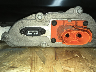

Re: Renault Zoe BMS
Hello, does anyone have the pin assignment of CAN BMS to match the ZOE (PH1 / 2013 - 2018)?
I would like to listen to the CAN bus from my ZOE battery (22 kWh). I'm looking for a way to operate the battery on a HV inverter without getting error messages about incorrect CAN BUS communication. I would be happy about a hint. Thx!
