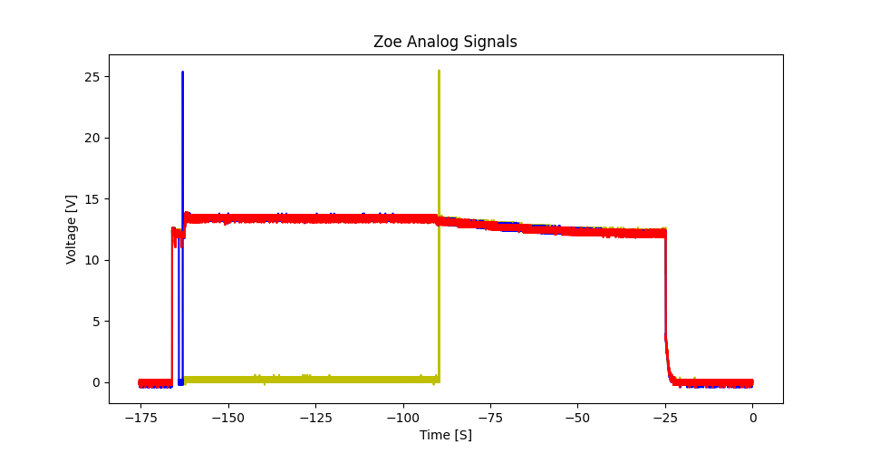

I also added my oscilloscope measurements of the 3 relay lines going into the battery, (can be seen in the attachment). This is the typical start and shutdown sequence. Signals: Yellow is 2AD, Blue is 2AC and Red is 3FB1, referring to the designators in the Renault schematics.
Concerning the handshaking: There is definitely some handshaking going on. I've also attached the wakeup/handshake protocol of the Renault Twizy (!). The general structure of the car, both hardware- and can communication protocol-wise, is at least somewhat similar to the one of Zoe Ph 1. This has been reverse-engineered by dexterbg from https://github.com/dexterbg/Twizy-Virtual-BMS.

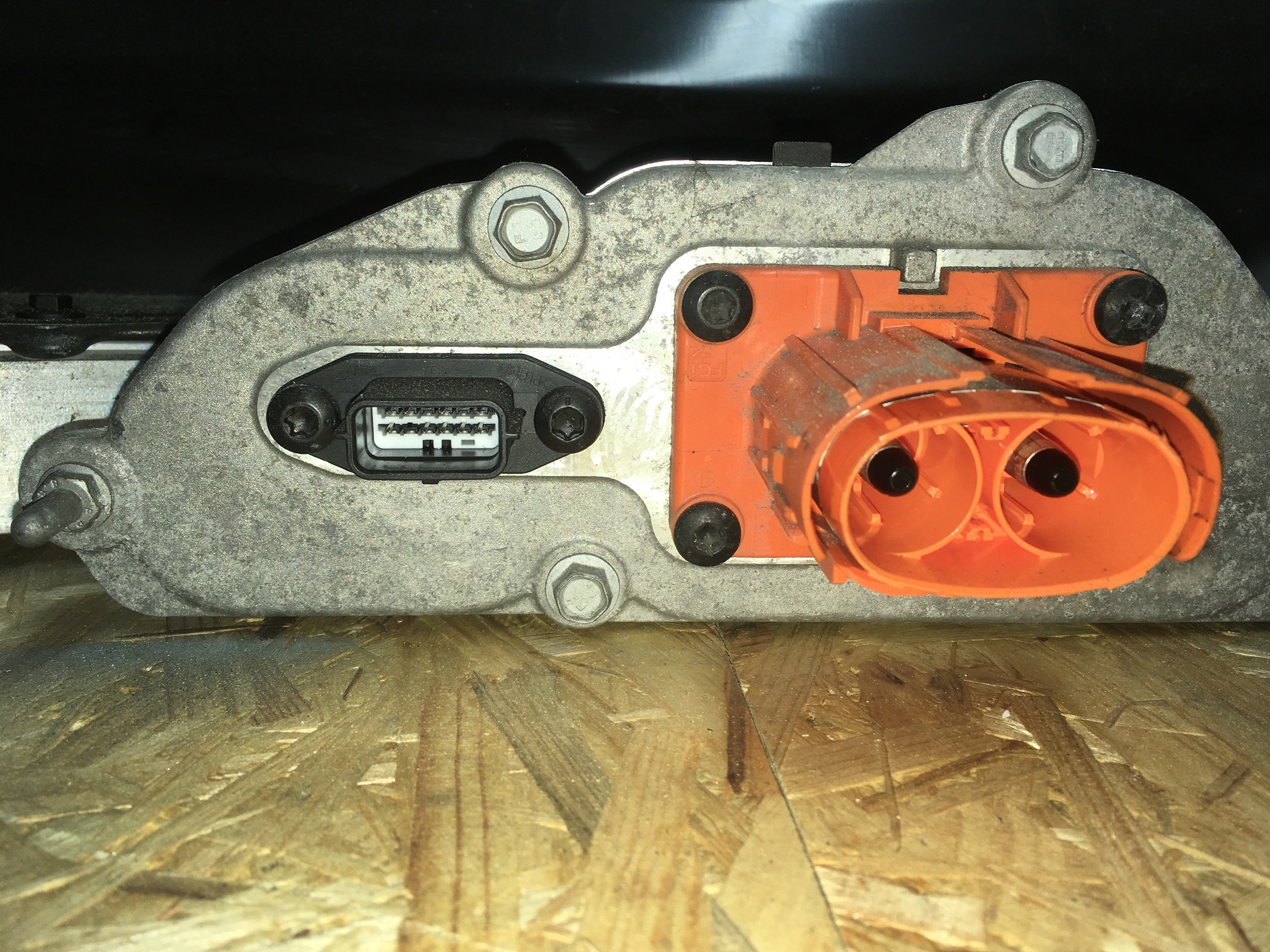

Hello, does anyone have the pin assignment of CAN BMS to match the ZOE (PH1 / 2013 - 2018)?
I would like to listen to the CAN bus from my ZOE battery (22 kWh). I'm looking for a way to operate the battery on a HV inverter without getting error messages about incorrect CAN BUS communication. I would be happy about a hint. Thx!
Renault ZOE Battery 22kWh
Renault ZOE Battery 22kWh, left side = CAN BUS, right side = battery poles
