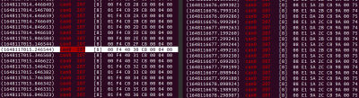

Re: Tesla Charger alternative firmware
Does increasing iaclim while charging break a GEN2 charger?
I was charging at ~16A DC @ 360V at a public charge point, ~29A AC.
Then I saw that iaclim was slightly lower than what the charge point could do and increased iaclim while charging from 29A to 32A.
The charge dropped off. Reconnected and I was able to charge for an hour after, but udc fluctuated*, then dropped out altogether, with only 1.5kW in 50mins delivered.
I think the DC wiring was fine, uaux is still showing at 12.62V, so DCDC was still on, and car drove home fine. Measured the cable from DC bus to charger today and had 0 Ohm resistance (under no load).

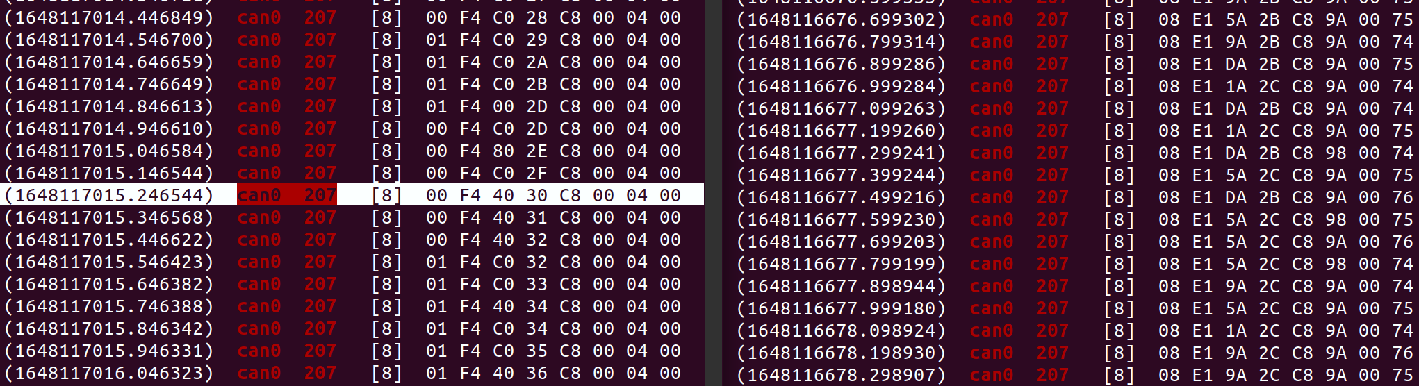

I just captured a CAN dump back to back with the now presumed broken charger and a working one on the bench.
hwaclim remains 0 for the presumed broken one.
according to this post:
0x207 32 to 40 (I hope I counted right):Jack Bauer wrote: ↑Tue Feb 02, 2021 6:25 pm 0x207 is the module 1 line status message. Available line current is in bits 32 to 40 as a 9 bit unsigned int with a scale of 0.06666. On the gen3 this will report as a little under 24A at power up and around 13 A on the gen 2 at power up.
working: C8 9C
broken: C8 00

- candump_broken.log
- (3.11 MiB) Downloaded 640 times
- candump_working.log
- (2.95 MiB) Downloaded 405 times

Haven't found the time to look at CAN dumps yet.
What I can say is there is just one value set affects charger power: modaclim. Whichever limit you set elsewhere it will show up on modaclim. So I doubt CHANGING iaclim really caused this. Were you charging single phase?

From the other side I wonder how the firmware could contribute to failure. We're not controlling power electronics directly, so that's ruled out. I could only guess that I need to put a ramp on modaclim so that current is ramped up slowly instead of one step.
When you activate just the presumably broken charger I guess it does not charge at all
Ok, one more idea: I have the wet charger here that still charges on one module and that can be sacrificed.
I can set CAN up to be dumped continuously and then we can stress it and see if we can get it to break while capturing?
