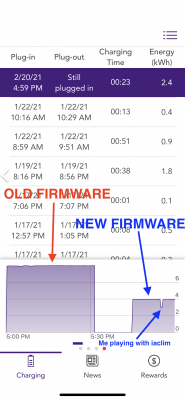

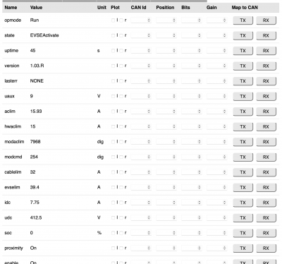

So I uploaded the latest firmware and gave it another shot. The AC current per phase (cXiac) is now scaled correctly, but it looks like hwaclim and/or aclim changes are preventing me from getting full juice. I'm only getting 5A per phase max.
I started a session with the old firmware, updated firmware, and now I'm stuck at a max charge of 15A AC.
Bryson
- Posts: 179
- Location: California
- Been thanked: 4 times
Re: Tesla Charger alternative firmware

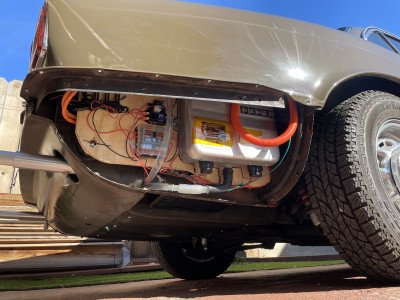

One more thing for Johannes - based on what I'm reading in the description of Type 1 and Type 2 settings, the charger will always enforce a maximum AC current of 32A, even if the EVSE is telling it that it can do more. Is that correct? My EVSE regularly puts out a full 40A with other EVs, Tesla and otherwise, so I'm not sure this interpretation of J1772 single phase is 100% correct. Am I reading it wrong? Should cablelim just be set to whatever the evselim is?
You'll notice that with the 'old firmware' in my image above, the EVSE is putting out just under 8kW. At 240V, that's about 32A total, curiously equal to cablelim.
Here is the same charger, cable, EVSE on the 'pre-Johannes' firmware running at 40A (@240V = 9.6kW): edit, last thing: I made a window in the charger case and covered it with a layer of kapton, this definitely improved my WiFi:

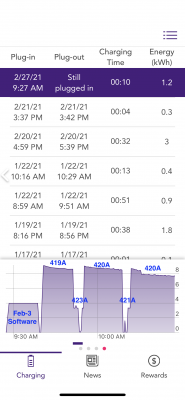

Well gents, I learned something this morning!
1. New firmware works great, thank you Johannes! I charged up to 37A, limited by constant voltage charge (EVSE does 39.4)
2. The Tesla charger doesn't like more than 420V set point. It looks like this may have been my issue. I played with different values and was able to quickly reproduce the cycling issue. I'd suggest limiting the max values at 420V instead of 430V based on this learning.

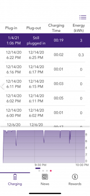

Note that this testing was done purposely in the constant voltage range of charging to attempt to trigger some of the high voltage cycling issues I've been seeing, nothing here is in the lower SOC constant current range.
Off to the office now...
* these should all be VOLTS not AMPS. Oops
