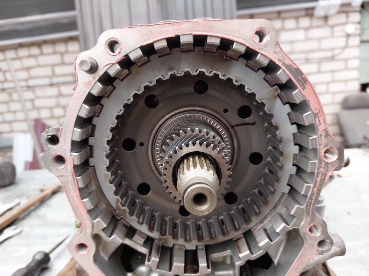

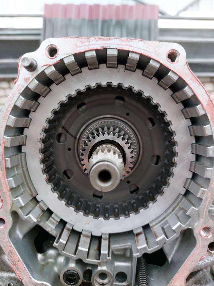

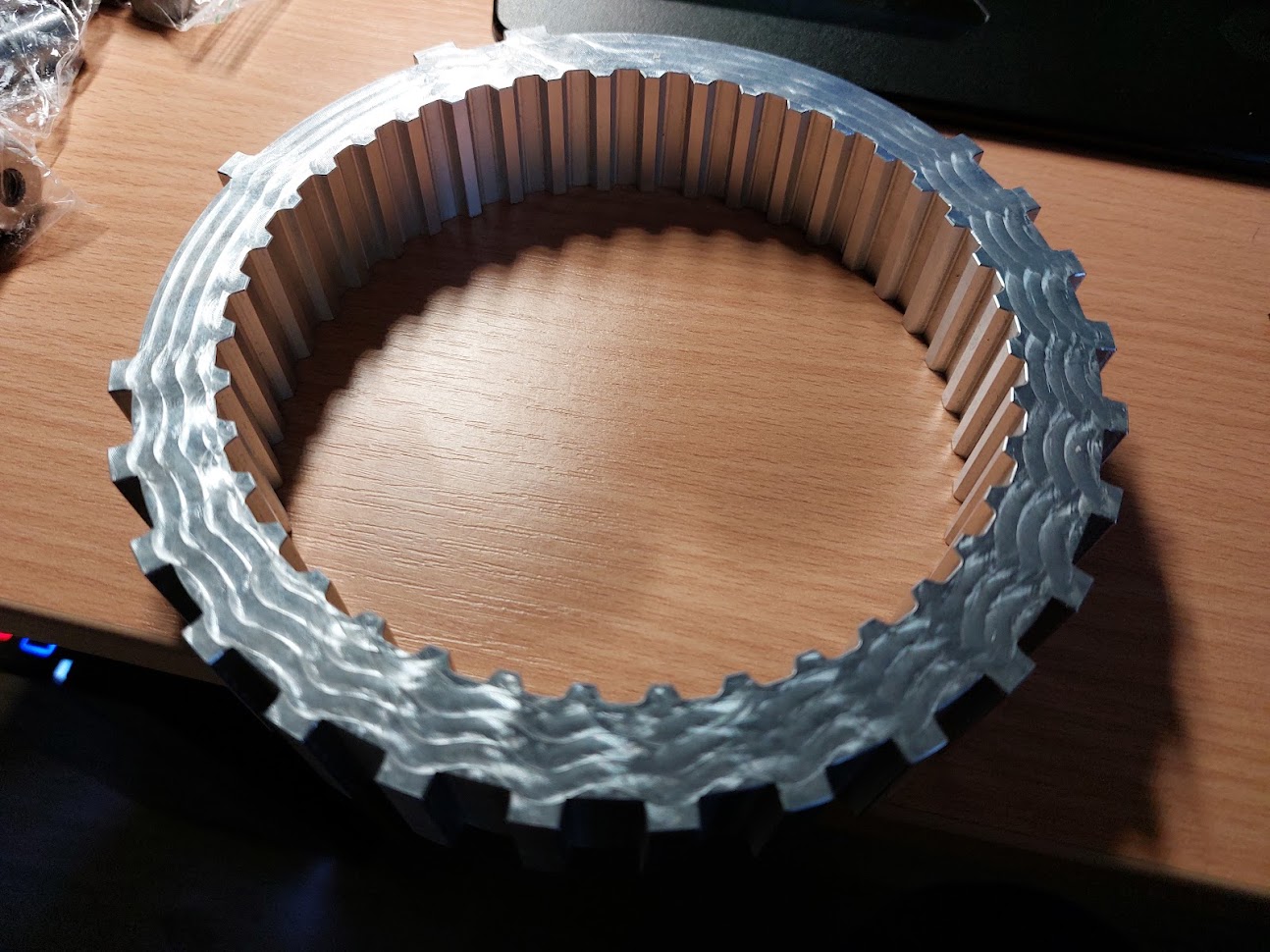

Test sample of the ring for permanently locking the high range was cut from PVC plastic. Laser wasn't really accurate(cheap model for advertisement production) and burned a little too much into the ring, but measurements seems to be taken correctly, so here dxf file for those who interested. You need to make a 32mm pack of this rings, preferably from some sort of 2-3mm thick stainless steel. Or make half of them and replace only rings with outer teeth.
HIGH_RANGE.dxf
(664.76 KiB) Downloaded 380 times

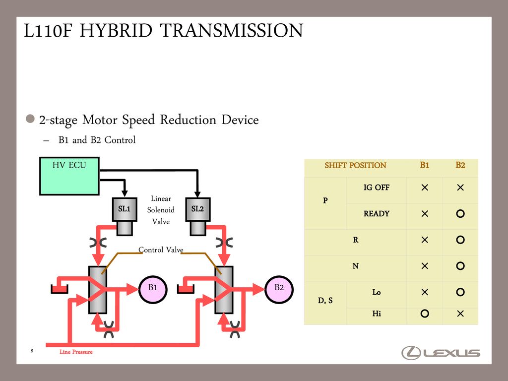

Re: GS450H Discussion
Post by catphish »
I am looking at programming ratio shifting on the GS450H and I'm trying to understand the relationship between the following:
* High and low ratio
* Brake 1 and Brake 2
* Solenoid 1 and Solenoid 2
Specifically, does anyone know which solenoid(s) should be energized for low ratio, and which for high ratio? Once I know this, I'm hoping I can get the correct timing for smooth shifts.
Edit: I just realised this is actually the original question of this thread, but I'm not sure that it was answered with any certainty.
This diagram leads me to believe that only one solenoid should be engaged, but several others seem to be operating them as a pair. It would be great if anyone could clear up my confusion here.
konstantin8818
Posts: 290
Location: Minsk, Belarus
Been thanked: 10 times
Post by konstantin8818 »
Markos wrote: Sat Oct 16, 2021 12:45 pm If I'm right, the mechanical pump is connected to the ring gear (green) of MG1. If the engine (blue) is locked and MG1 (yellow) turns, then the ring gear will turn and I would say the mechanical pump would also turn. But I think the pro's here can give the correct answer.
Watch my post at previous page. Mechanical pump connected to blue part, wich is ICE input. If you go same way as Damien, locking up input shaft, then you need external oil pump. I'm now at process of locking planetary carrier, to use original mechanical oil pump. Only one issue is it won't work while in reverse, so I need to lock mechanically one of the gear ranges.

It looks like if the ring gears are welded in place, MG1 would have a direct coupling to the wheels allowing MG1 to provide reverse.
konstantin8818
Posts: 290
NiHaoMike wrote: Mon Oct 18, 2021 4:49 am It looks like if the ring gears are welded in place, MG1 would have a direct coupling to the wheels allowing MG1 to provide reverse.
This somehow passed by my head at the first place :idea: Yup, seems like no need for locking ring, but you need to energize on of range solenoids. Clutch discs will only slightly wear out by MG2 while building up the speed from stand still.
However I don't want any additional electrinics to work inside my gearbox and high range seems to be enough for lightweight vehicle, so I'll stay with locking ring, atleast for testing purpose.

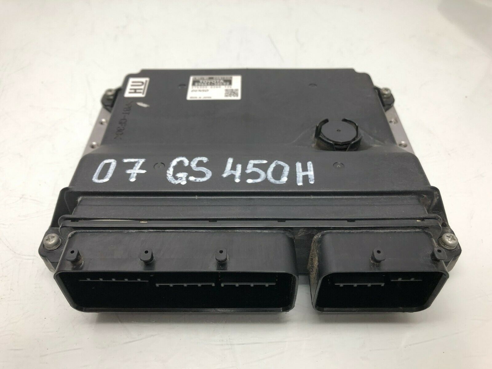

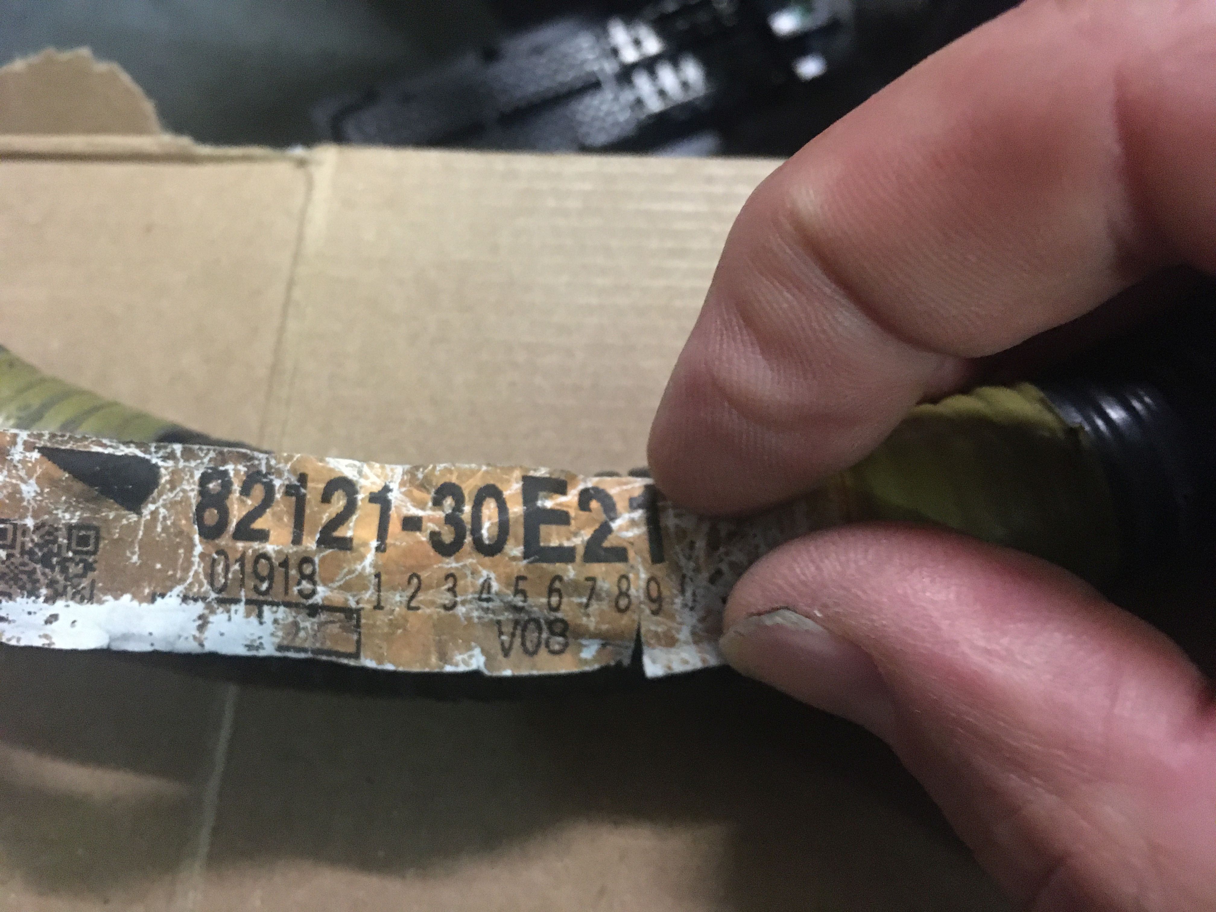

I skimmed this thread and did not catch the part numbers for the Engine/Transmission harness so I would like to share what I have recently learned when buying mine, I hope you don't mind, I also would like to share a link to me going through the detailed steps of "thinning" it out which I posted on the DIY Electric Car forum (I am still a little bit intimidated to post here on the accounts of lack of smarts and all, ha ha) 1971 GMCe Lexus GS450H BMW 530e Tesla Model S powered Electruck
ok so a little background, my transmission and inverted are both from the same 2010 Lexus GS450H, and this harness is from a 2008
now check this out and you tell me if this makes any sense to you guys:
Part Name: Engine Wire
Harness Part # 82121-30E21 is for 2007-2010 (this is the one I bought)​
$1,369 at the local Stealership​
Harness Part # 82121-30E22 is for 2009-2011​ (based on my VIN I actually need this one, but the other plugs in to the transmission just fine)
$1,366 at the local Stealership​
the large rectangular plugs on this harness plug into the Engine Control Module ECM / Hybrid Vehicle Control ECU which appears to be one and the same small metal box with two connectors on it
as mentioned before by some others, this harness does NOT include the INVERTER plug, that plug comes on a different harness, this harness actually directly plugs into the other harness, I have that information as well, but one thing at a time
and here it is all thinned out to just the sections we need

Gregski wrote: Sat Oct 30, 2021 4:53 pm I skimmed this thread and did not catch the part numbers for the Engine/Transmission harness so I would like to share what I have recently learned when buying mine, I hope you don't mind, I also would like to share a link to me going through the detailed steps of "thinning" it out which I posted on the DIY Electric Car forum (I am still a little bit intimidated to post here on the accounts of lack of smarts and all, ha ha) 1971 GMCe Lexus GS450H BMW 530e Tesla Model S powered Electruck
Nice! Looks like yours includes the VSS connector too. That could be helpful depending on how you plan to drive your speedo/odo. Yeah, I nearly sliced the end of my thumb off getting down to the simple, bare necessities on that harness! It's now numb on the very tip. I don't think anyone has found the harness with the inverter plug (I could be wrong), so great if you have that PN. My local Lexus dealership couldn't find it. Fortunately, my inverter came with it attached!

I've fabricated that locking ring for high range, I've shared here before, from solid piece of aluminum.
It fits like a glove. :)

konstantin8818 wrote: Wed Nov 03, 2021 1:08 pm I've fabricated that locking ring for high range, I've shared here before, from solid piece of aluminum.
SWEET! I am certain this is superior to my (alternate) plan of just filling that space with J-B Weld :D

ZooKeeper wrote: Thu Nov 04, 2021 12:17 am SWEET! I am certain this is superior to my (alternate) plan of just filling that space with J-B Weld :D
I just had an option of milling this part for free. It is less costly to cut those from 2mm stainless steel with laser and replace only metal clutch rings.
Atleast now I'm absolutely certain that this part will fit where it belongs.
