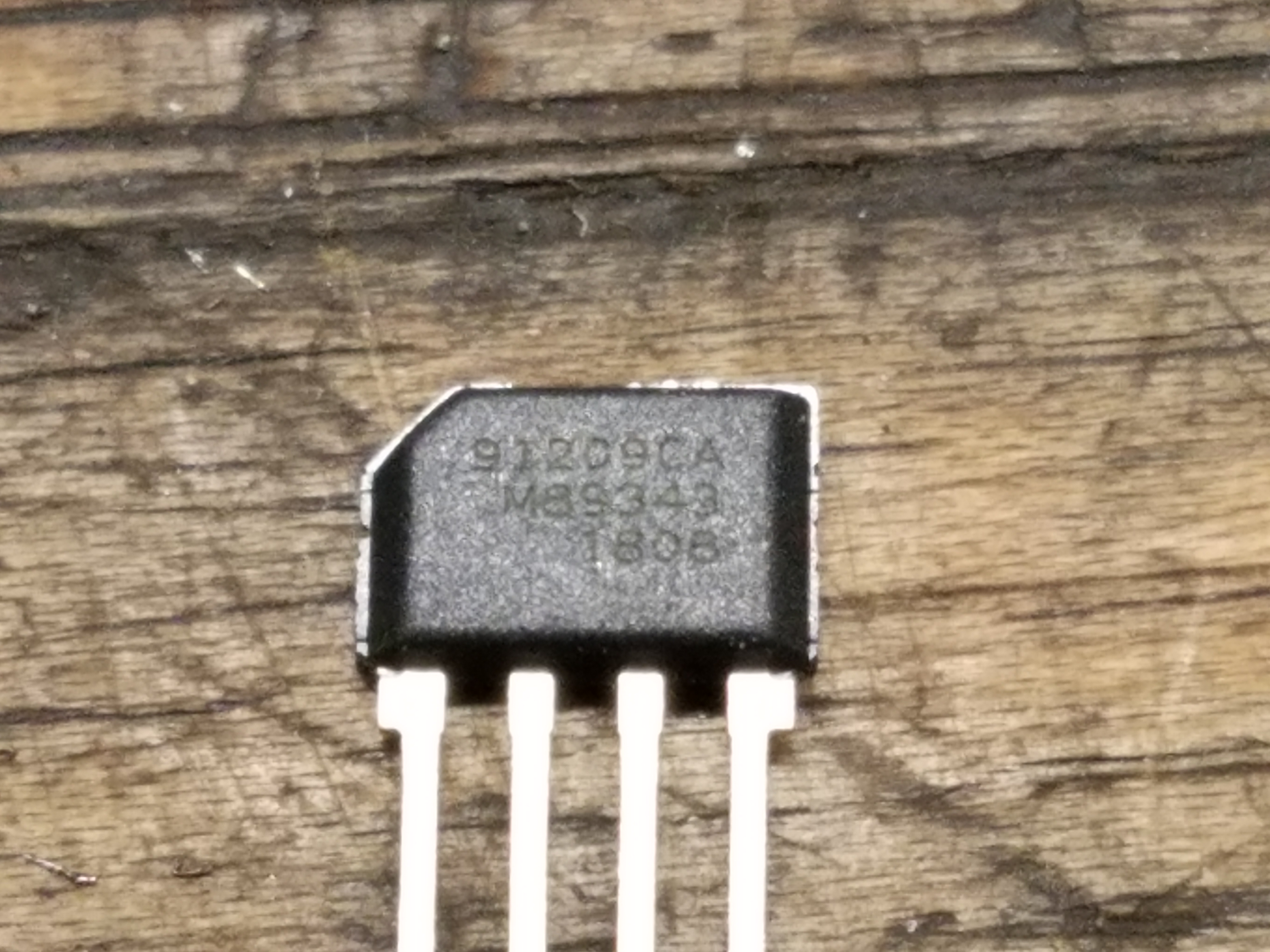

Re: Tesla Small Drive Unit Support Thread
The current sensor used on the small drive unit is the Melexis MLX91209.
https://www.mouser.ie/ProductDetail/Mel ... 4jl%2Fc%3D
The 7.3mV/mT version.

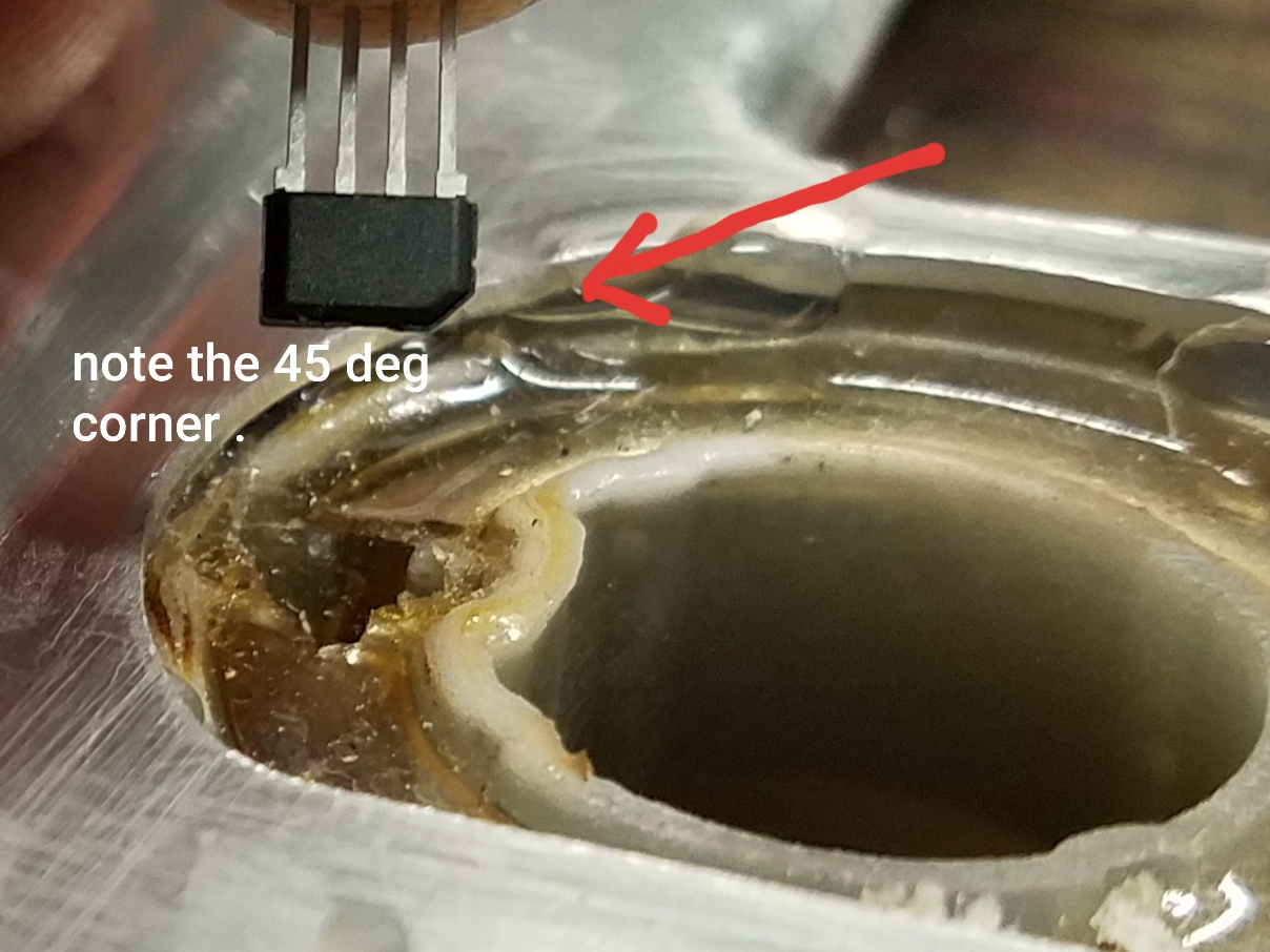

current sensors from the manufacturer
Post by Lee Malo »
When replacing a current sensor does it need to be programed ? The manufacturer states the sensor is programmable . Is the current sensor a drop in and solder or does it need to be programed ? Here is a link to Mouser stating it is programable - https://www.mouser.com/ProductDetail/Me ... DN4jl%2Fc=

PoloLbricolo
Posts: 106
Joined: Wed Apr 10, 2019 2:32 pm
Location: France
Been thanked: 12 times
Post by PoloLbricolo »
I'ts drop in, just make sure you have it in the correct orientation.
Lee Malo
Posts: 47
Joined: Thu Mar 21, 2019 6:09 pm
Location: Gloucester MA , USA
Post by Lee Malo »
Are both current sensors oriented the same way ?
Poor quality lingers long after the cheap price is forgotten.
Posts: 4007
Been thanked: 1138 times
They do not need programming and yes they both go in the same way.

iak78612
Posts: 7
Joined: Mon Sep 23, 2019 12:10 pm
Post by iak78612 »
Just busted my current sensor :( and if you can't tell from my question then I'll say it explicitly. I'm a noob.
My replacement current sensors will be getting here in a couple of days. Do I just pull out the old sensors from the "goo" and drop the new ones in? or is there something more involved?
Thanks!
Posts: 4007
Yes they go back into the goo. Just be aware of the orientation mark on the device.

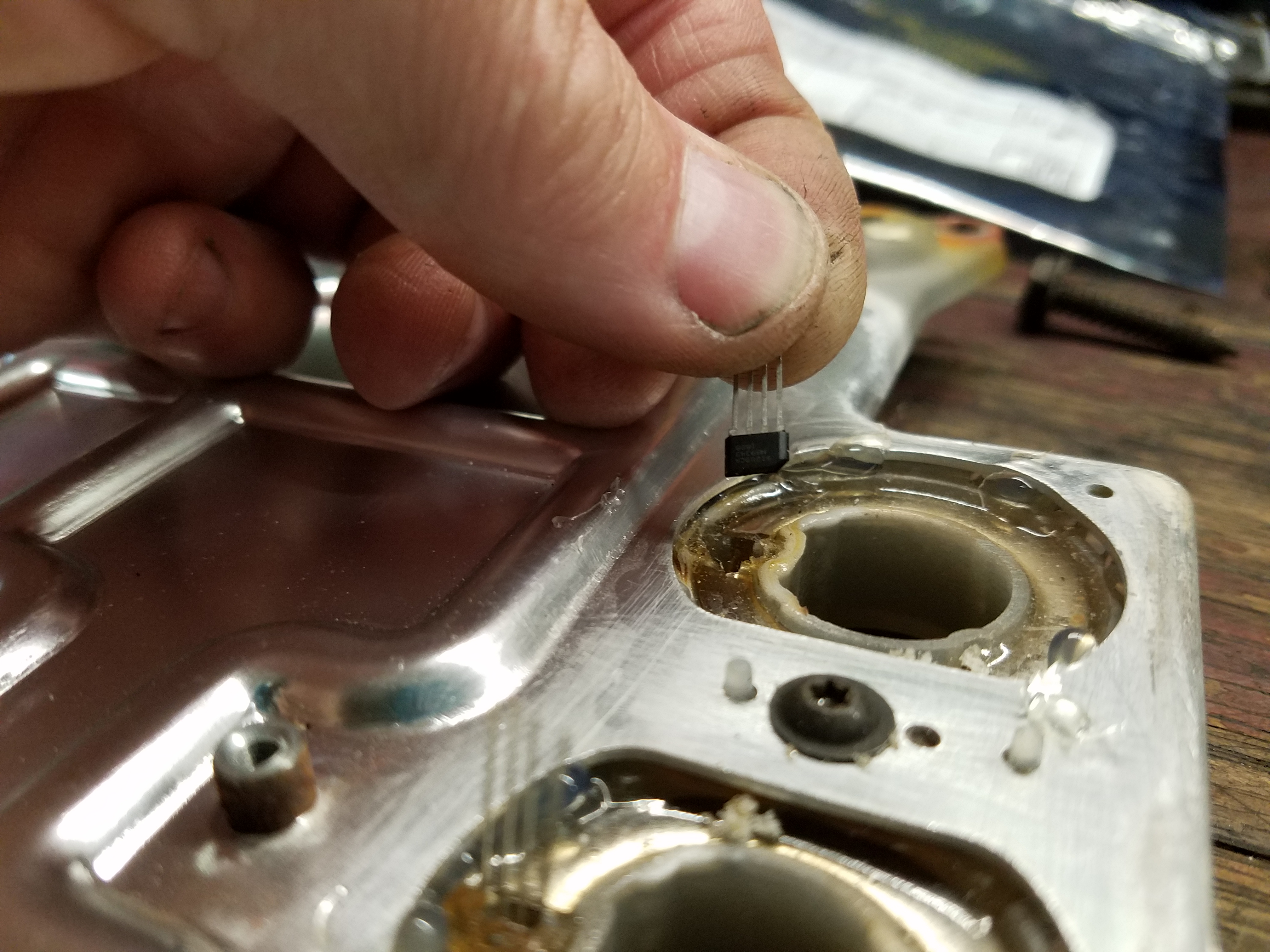

Lee Malo
Posts: 47
Post by Lee Malo »
when I replaced the sensor I took a few pics . This is how the 2 sensors are oriented in that camel snot . lol
Lee

iak78612
Posts: 7
Post by iak78612 »
Lee Malo wrote: Wed Sep 25, 2019 5:01 pm when I replaced the sensor I took a few pics . This is how the 2 sensors are oriented in that camel snot . lol
Lee
Thanks!
Got em in. Should we refill the void in the "camel snot" left from pulling out the old sensors? The new sensors seem pretty secure as is.
