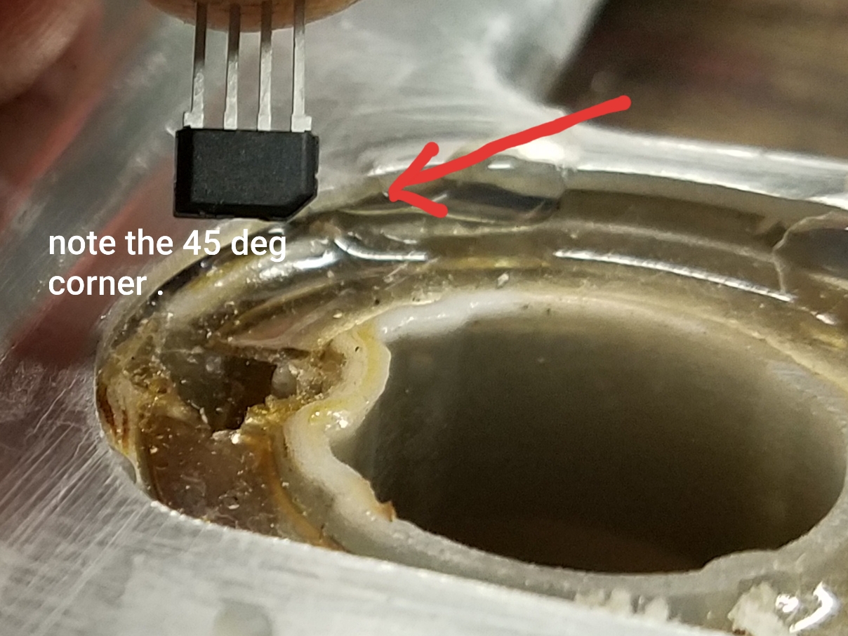

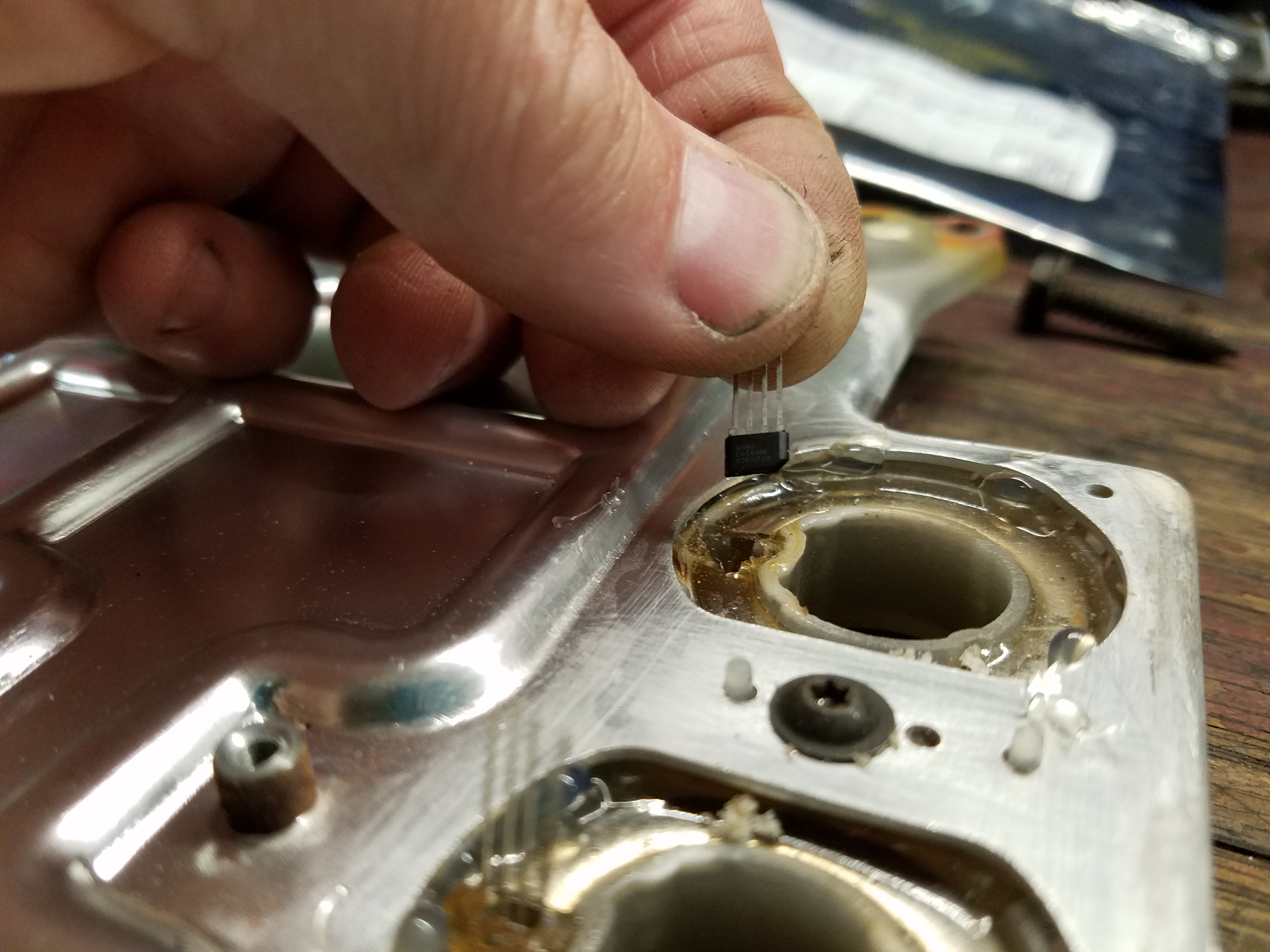

iak78612
Posts: 7
Joined: Mon Sep 23, 2019 12:10 pm
Re: Tesla Small Drive Unit Support Thread
Post by iak78612 »
Just busted my current sensor :( and if you can't tell from my question then I'll say it explicitly. I'm a noob.
My replacement current sensors will be getting here in a couple of days. Do I just pull out the old sensors from the "goo" and drop the new ones in? or is there something more involved?
Thanks!
Posts: 3661
Has thanked: 10 times
Been thanked: 334 times
Yes they go back into the goo. Just be aware of the orientation mark on the device.
Lee Malo
Posts: 47
Joined: Thu Mar 21, 2019 6:09 pm
Location: Gloucester MA , USA
Post by Lee Malo »
when I replaced the sensor I took a few pics . This is how the 2 sensors are oriented in that camel snot . lol
Lee
Poor quality lingers long after the cheap price is forgotten.
iak78612
Posts: 7
Post by iak78612 »
Lee Malo wrote: Wed Sep 25, 2019 5:01 pm when I replaced the sensor I took a few pics . This is how the 2 sensors are oriented in that camel snot . lol
Lee
Thanks!
Got em in. Should we refill the void in the "camel snot" left from pulling out the old sensors? The new sensors seem pretty secure as is.
