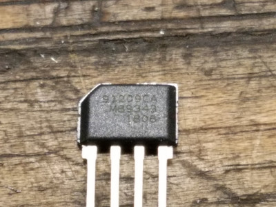

The current sensor used on the small drive unit is the Melexis MLX91209.
https://www.mouser.ie/ProductDetail/Mel ... 4jl%2Fc%3D
The 7.3mV/mT version.

current sensors from the manufacturer
When replacing a current sensor does it need to be programed ? The manufacturer states the sensor is programmable . Is the current sensor a drop in and solder or does it need to be programed ? Here is a link to Mouser stating it is programable - https://www.mouser.com/ProductDetail/Me ... DN4jl%2Fc=

I'ts drop in, just make sure you have it in the correct orientation.
- Lee Malo
- Posts: 47
- Joined: Thu Mar 21, 2019 6:09 pm
- Location: Gloucester MA , USA
Re: Tesla Small Drive Unit Support Thread
Are both current sensors oriented the same way ?
Poor quality lingers long after the cheap price is forgotten.
- Posts: 4003
- Been thanked: 1122 times
They do not need programming and yes they both go in the same way.

Just busted my current sensor
and if you can't tell from my question then I'll say it explicitly. I'm a noob.
My replacement current sensors will be getting here in a couple of days. Do I just pull out the old sensors from the "goo" and drop the new ones in? or is there something more involved?
Thanks!
Thanks!
- Posts: 4003
Yes they go back into the goo. Just be aware of the orientation mark on the device.

when I replaced the sensor I took a few pics . This is how the 2 sensors are oriented in that camel snot . lol
Lee
Lee
Thanks!
Got em in. Should we refill the void in the "camel snot" left from pulling out the old sensors? The new sensors seem pretty secure as is.
