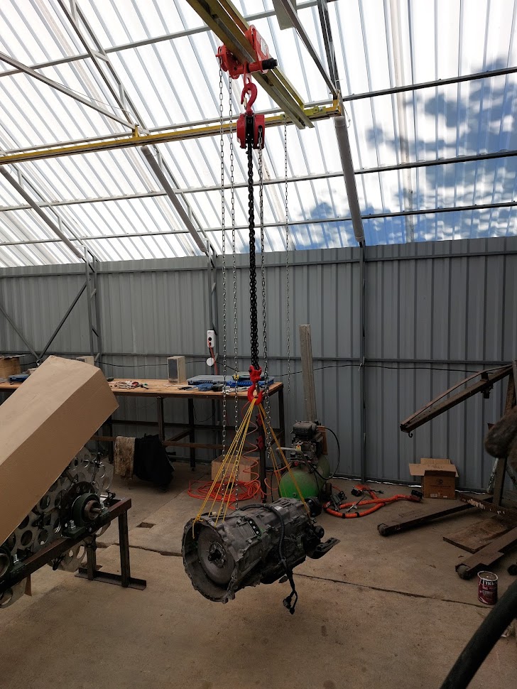

Unfortunately, I don't know if solenoids need economizers or PWM signal. Anyway my intention now is to get rid of all hydraulics and only left mechanical pump for bearings lubrication and better cooling. I want to replace high range clutch with two-way solid toothed ring.
Today I disassembled my gearbox and welded carrier. When I turned oil pump both ways by hand it rotates freely. Only when it rotates backwards it makes woop-woop sound

Continuing torturing the transmission.
I disassmbled that two-step planetary thing with hard to pronounce name, and took measurements of clutch discs of high range. I will not place a dxf drawing here yet. First I need to make sure that measurements are taken correctly.
Clutch pack thickness is 32mm, so I'll make three 10mm steel rings, to replace the pack.
