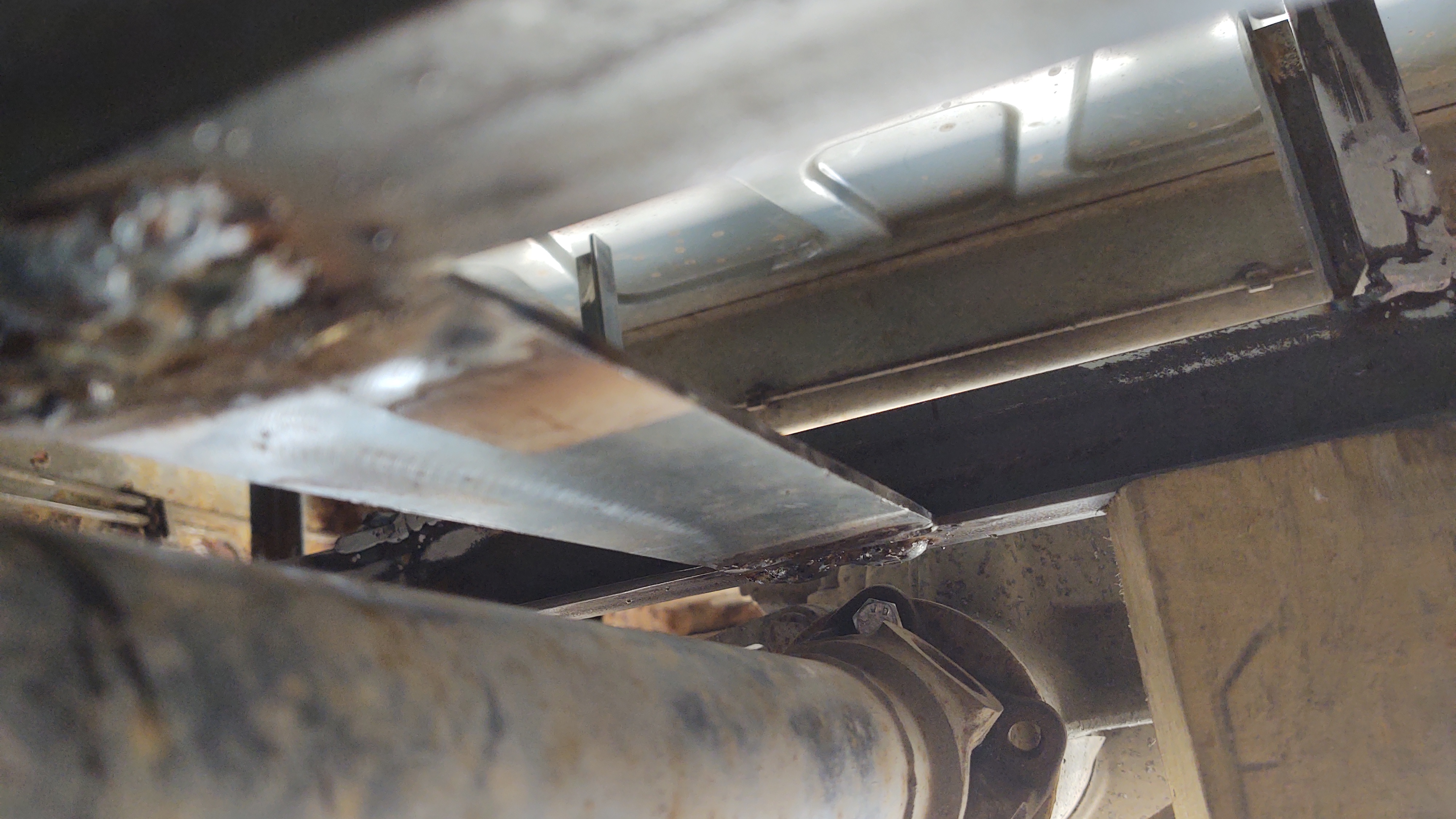

Bigpie wrote: Sun Jun 13, 2021 6:24 pm I'm redoing my fibreglass battery box. Cladding it with pvc sheets. Im really happy with the stuff. Lightweight, pretty tough and easy to work with. It's sold as hygienic wall cladding.
I had considering using fibreglass for my box but was concerned it is very flammable. PVC wall cladding sounds better, maybe not so bad that way.

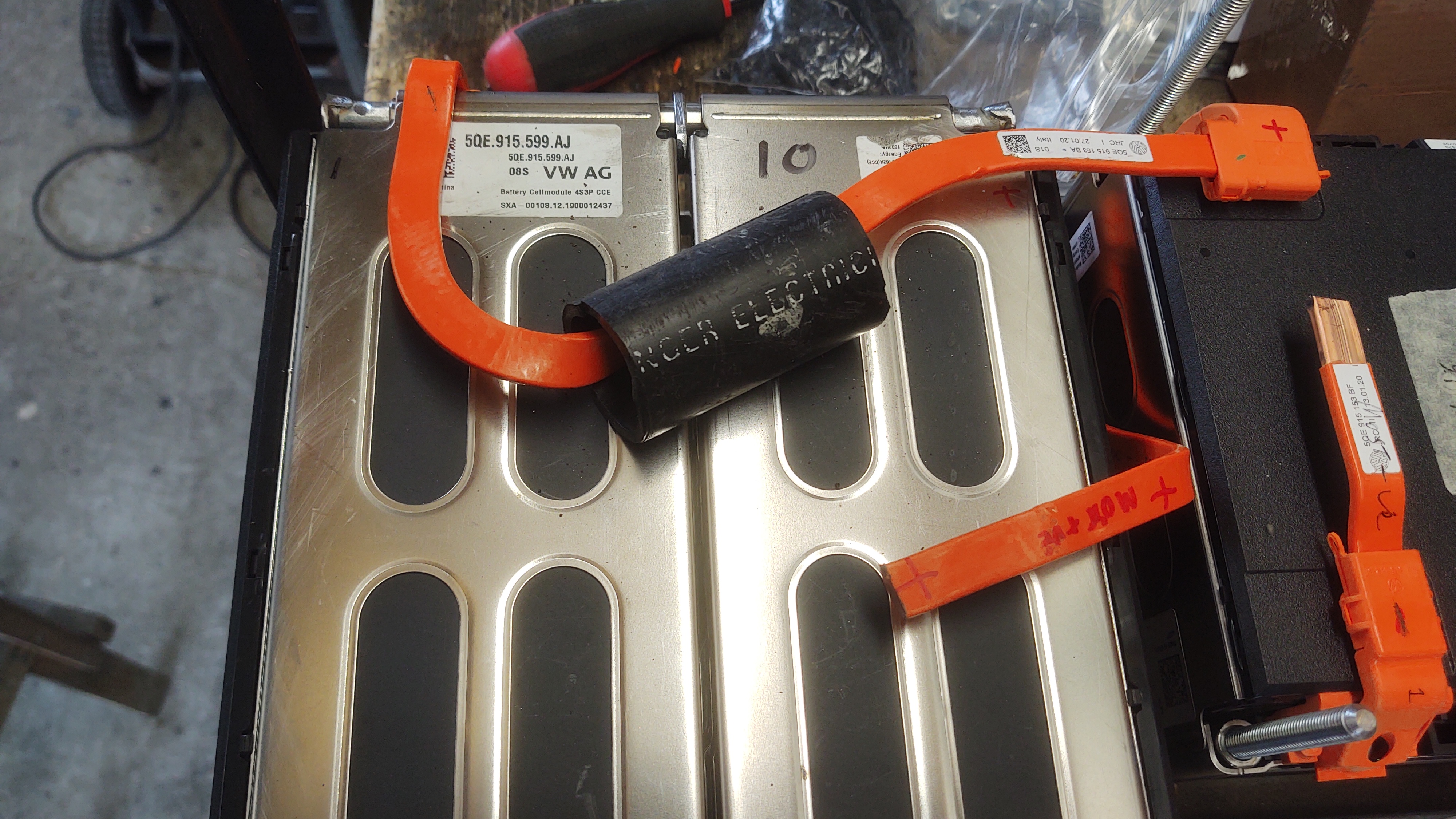

At the weekend I managed to get another couple of hours at this and have the connections for the battery box sorted.
You can't see it in these photos but I also have the studs welded in for securing the four large modules and nuts for the smaller.
I bought a bag of M5 high tensile 10.9 bolts and I think the nuts are 8.8. I used spring washers on both sides as I am a little concerned about the copper crushing and loosening over time and I have some lock nuts to put on to prevent the nuts loosening.
To be sure to be sure to be sure. :p
The plastic pipe just happens to be for protecting buried electrical cable, it has danger high voltage on it :) and I'll probably do something to block off the ends but it is very strong as it is. I'll also cut the bolts back and use a couple of layers of heat shrink.

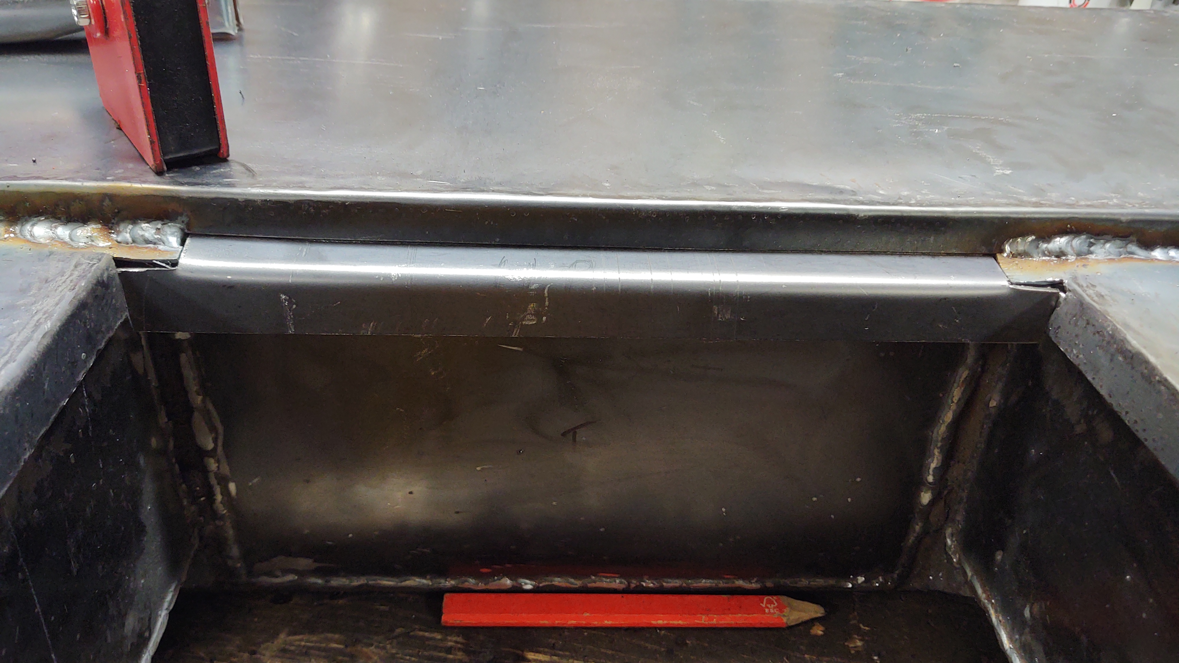

I have to admit I'm a bit embarrassed to admit this battery box frame is still not finished after many hours working on it. The space available is very complicated with lots of curves and bits sticking out never mind a rear diff that is mounted on rubber and can move so a simple box will not fit and I have to allow enough clearance for normal diff movement.
This means every time I think I have the shape sorted I realise I need to change something. On Sunday I finally I got it to the point where I was ready for a trial fit once the uprights were welded in. I lowered the rear subframe, secured it in place and found the bottom was a bit too close to the propshaft.
I cut another 15mm off the height when I saw how close it was but this meant I had to change the way the small modules are secured. Originally I had welded nuts on the inside of the frame but this left the gap at the top of the modules too tight, so I had to cut and grind the nuts out and drill through the angle, tap it and weld nuts on the bottom.
To make matters worse I started with the intention of using M8 bolts or threaded rod but they fitted so tightly in the modules it left zero room for error in my marking and drilling. So after doing the usual mark it, drill it, find the hole has somehow moved, wiggle the drill around to make it fit then give up and use a bigger drill, I was left with big ugly holes and no easy way of welding the nuts to the bottom of the frame without possibly overheating the module. After messing up one side like this I decided to stop, weld up the holes and use the original M6 bolts. This gave much more room for the inevitable drill wander and I also had the sense to drill the holes the correct size to allow them to be tapped.
You can't see from this photo but after tapping the holes in the Angle I screwed bolts through the holes so they poked out the bottom a little, fitted nuts and then welded the nuts to the bottom to increase the thread depth and make it a little easier to seal the holes.
So now I finally have the modules secure I can finish the top of the frame and think about fitting the sides, after welding in another two uprights on the sides that is. The front of the lid will be higher than the back to allow for sticky out bits in the car.

With the welder now working properly I got a lot more done to the battery box.
Then made the lid
Alibro

Post by JaniK »
Is this also going to be 3mm angle iron frame?
Alibro
Posts: 1112
Location: Northern Ireland
Has thanked: 504 times
Been thanked: 322 times
Re: Freelander EV With Gen1 Leaf electrics and EVBMW VCU
Post by Alibro »
JaniK wrote: Sat Sep 11, 2021 6:13 am Is this also going to be 3mm angle iron frame?
All the angle I have is 3mm but some is wider than others so yes the frame will be 3mm angle.
I don't think I need it to be quite as overengineered though and may not have a complete skeleton. I might try to cut out the box in a single sheet and bend it at the corners, a bit like a cardboard box is made from one piece.
Having said that having a battery box at the very front of the car is not ideal from an accident point of view so it would be better being stronger.
I'll probably just make it up as I go along like usual. 8-)
On the power steering front I've been bouncing ideas off a mate in Landyzone and have decided to carry on with the ebike alternator and the Freelander OEM PS pump, It might prove to be stupid but it has a at least one advantage.
We talked about using a Corsa EPAS steering column but we felt it might damage the Freelander steering rack as it is not designed to have the steering forced from the column in that way.
So then the choices are a Zafira pump a commercial motor or my altimotor. The Zafira pump is very noisy and is a drain on the 12V system which ultimately means it shortens the range. Plus the one I have is now damaged due to a wee accident with a soldering iron. :?
Suitable commercial motors are hard to find so I'm going ahead with the Ebike Controller and Altimotor and for that I bought a new alternator last night.
It is a 180A VW alternator which is like new. I plan to add Hall effect sensors so that I can use it with a Sine Wave Controller and a permanent magnet so it is less drain on the battery.
