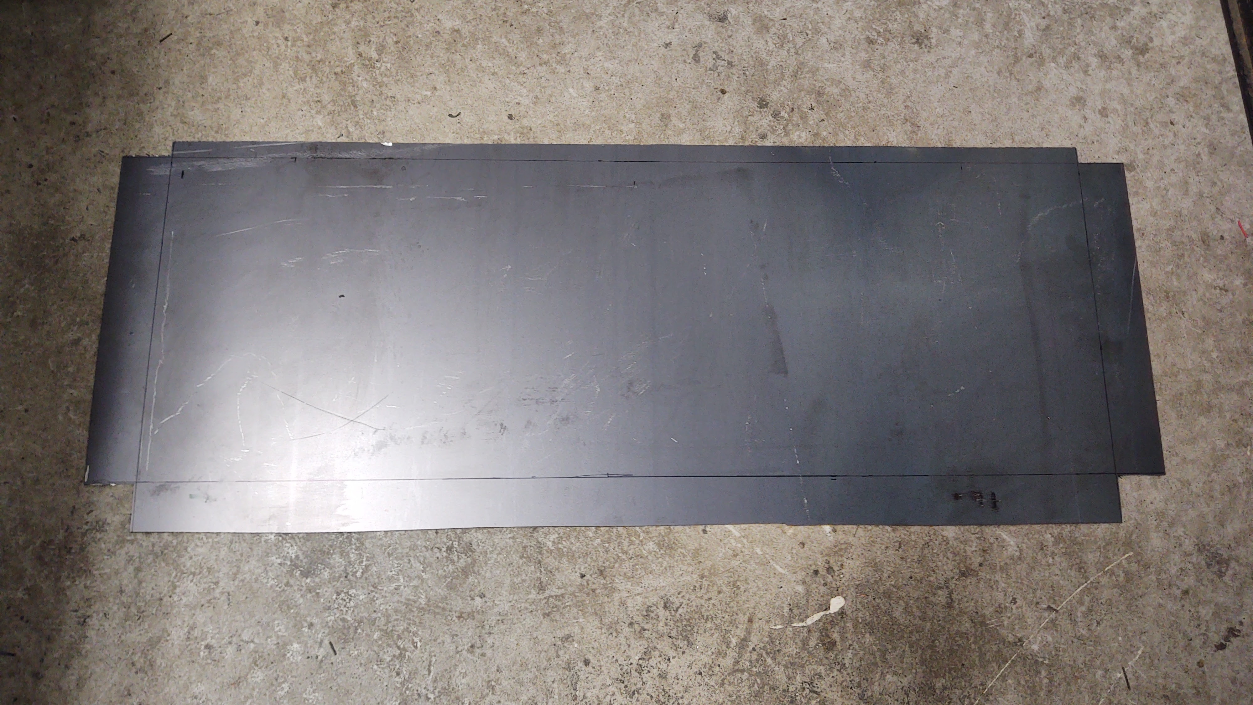

With the welder now working properly I got a lot more done to the battery box.
Then made the lid

The battery box is now painted and I'm now officially board of battery boxes so I decided to try and mount some of the stuff required under the bonnet.

I'm trying to figure out where to place stuff under the bonnet now and have started with a frame made from angle steel.
I think I have room for two large modules on this level with maybe two more above and two below but this is still to be confirmed.
In the pic below I have an alternator in the approx position I plan to have it. The idea is to use it to drive the Freelander PS pump with a short belt using an ebike controller and 48V battery. This might prove to be a dumb idea but I'm going to give it a go, it seemed to work well when tested being much quieter than the Zafira pump.

Is this also going to be 3mm angle iron frame?
Alibro
- Posts: 1112
- Location: Northern Ireland
- Has thanked: 504 times
- Been thanked: 322 times
Re: Freelander EV With Gen1 Leaf electrics and EVBMW VCU
All the angle I have is 3mm but some is wider than others so yes the frame will be 3mm angle.
I don't think I need it to be quite as overengineered though and may not have a complete skeleton. I might try to cut out the box in a single sheet and bend it at the corners, a bit like a cardboard box is made from one piece.
Having said that having a battery box at the very front of the car is not ideal from an accident point of view so it would be better being stronger.
I'll probably just make it up as I go along like usual.
